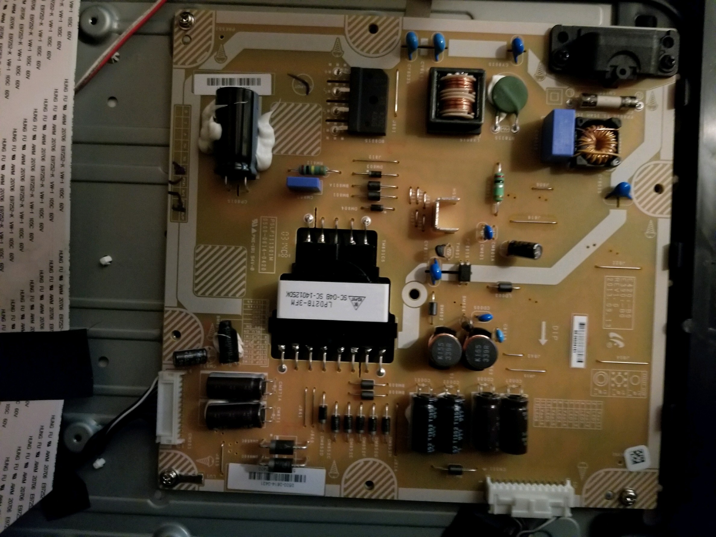

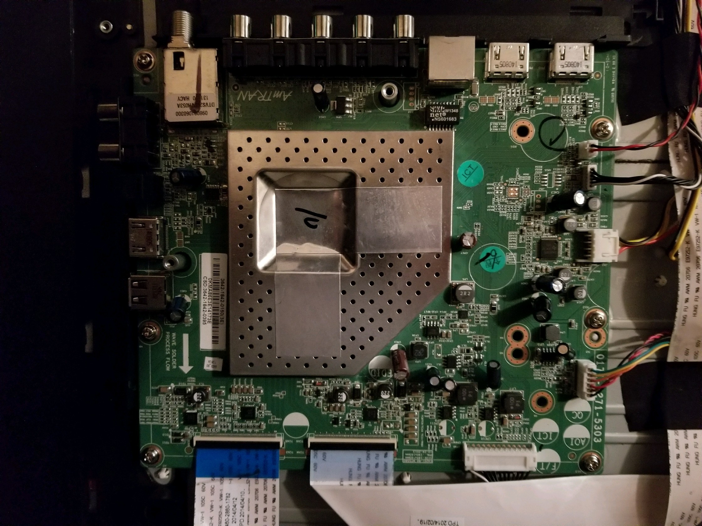

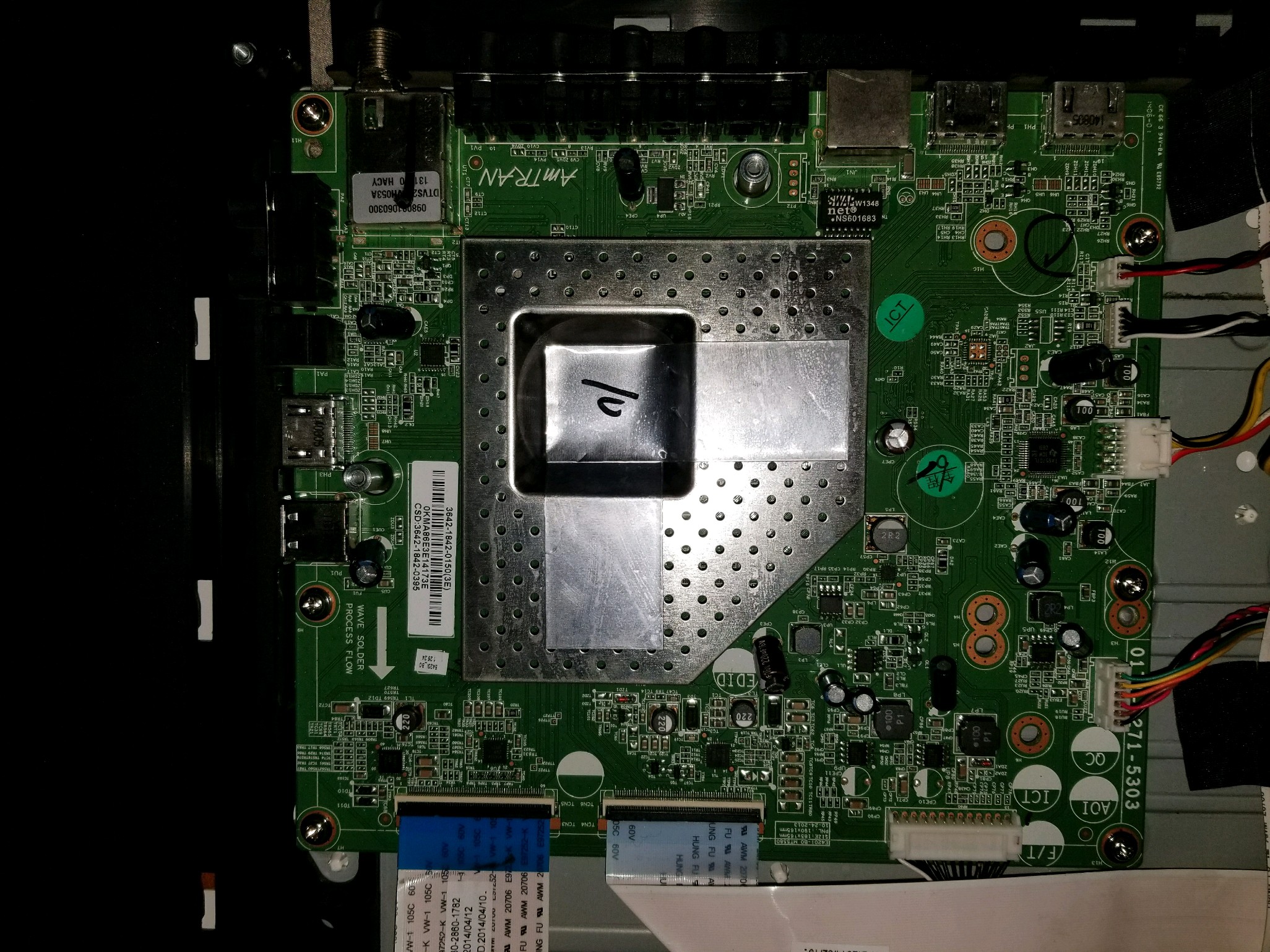

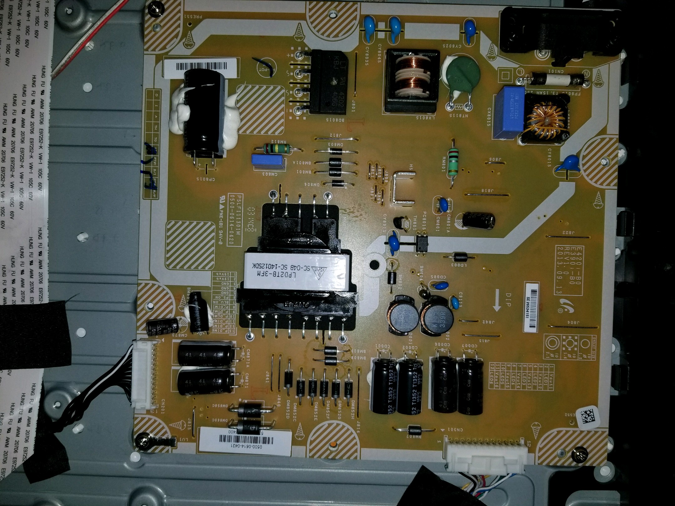

    Vizio e420i-b0
    Hello Im having trouble with this TV wont stay on turns on for about 2 seconds shows vizio logo then turns off the standby white light fades away shortly after I have replaced the main board 2x (used) with the issue still remaining i even changed the supply board still have the exact same issue i have cleaned around the power button making sure it wasnt stuck is there another component i need to check or test? any help would be appreciated attached are the main and supply boards..
  • Andrew F. Ali
    • Jan 2014
    • 2450
    • Trinidad & Tobago
    Re: Vizio e420i-b0
    Sounds to me you have bad LED backlight issue. Not Main Bd or PSU.
