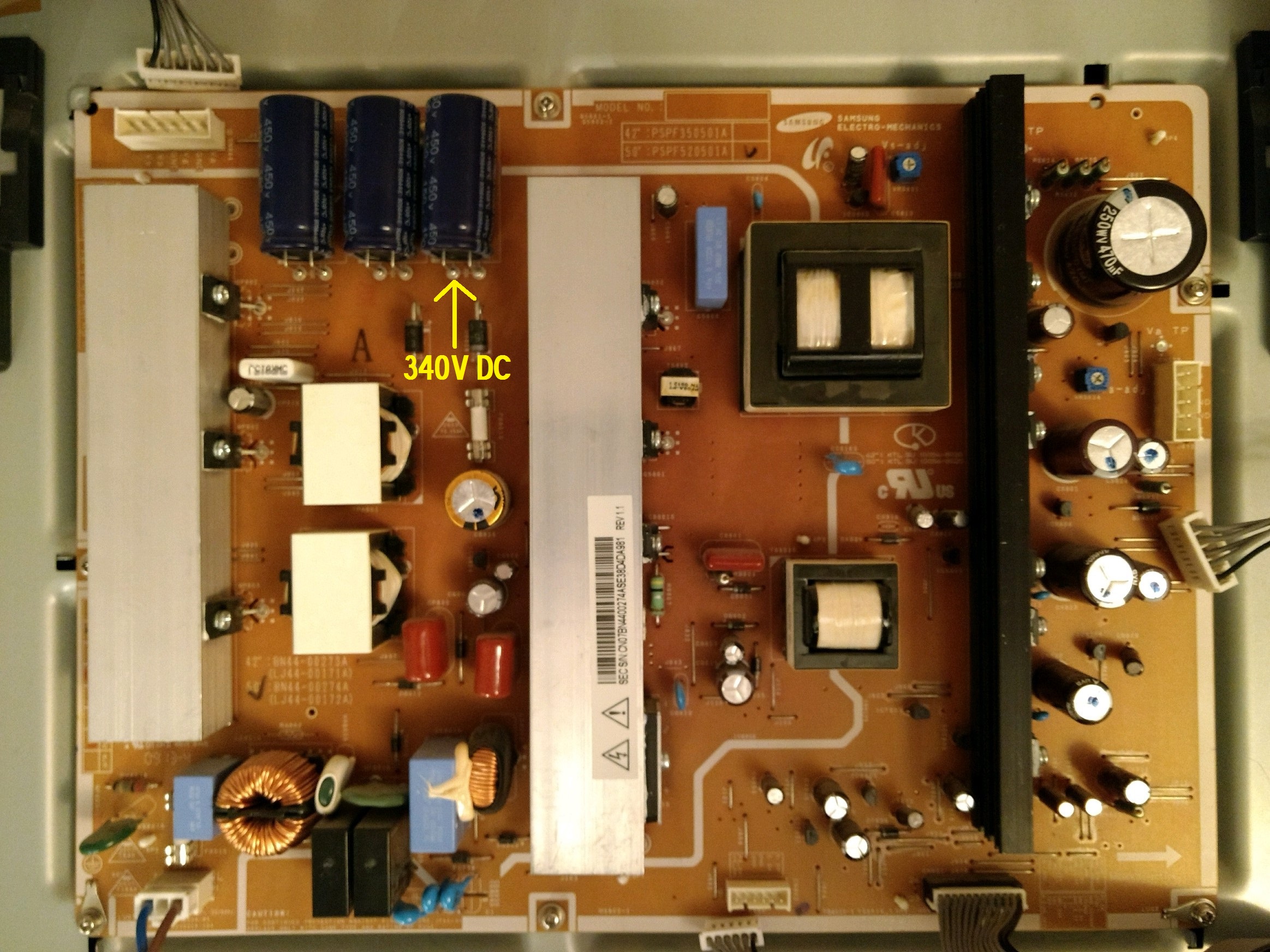

                            Okay so while I'm asking for help I'm also trying to self-help.
                            I found this video: https://www.youtube.com/watch?v=VtbrQhwBiOc in which the person is testing the exact same SMPS I have. I followed this procedure as outlined in the video:
                            The board was connected to 120V AC, like in the video. All other connectors were unplugged.
                            Ps ON and STBY voltages are present and correct.
                            Jump Ps ON to ground: all voltages noted on the SMPS to main board connector are present and correct.
                            Jump STBY to Vs: All voltages are present and correct at Vs and Va, Vg is 15.1V DC but when voltage is read at the capacitor leg noted in the picture, voltage is only 340V DC, as compared to the 396V DC seen in the video.
                            Does anyone think this voltage difference may be a part of the problem?

                              Your set has ps board #BN44-00274A. Shopjimmy has a repair kit for that board which contains the following parts:

                                  I don't know. Most of your recent test values seem okay except for the 340V.

                                    Agreed. Watched the video. Thanks for posting that.....very informative! He even said 390V was about the correct voltage at that point.

                                      I'm not too sure but you should be getting proper output voltages sense you can see those proper voltages at sustain boards when the power supply comes up before the restart.
                                      On your Connector going to the main board you will have a pin for PS_ON. Can you monitor this pin and see if voltage goes to 5v with an drops off when power supplly restarts?
                                      Even though you watch the video yes you can ground PS on and you can also ground VS on. This should make the power supply come live and not re start.
                                      And if it does come on with no restarts I would say that your main board is faulty.

                                        Okay I just did that. Here's what I see:
                                        The instant the plug makes contact with the prongs PS_ON voltage of 3.28V DC appears. When I hear the first click click PS_ON volts drop to 0.16V DC and return to 3.28 after the second click click, lather rinse repeat.
                                        With the SMPS unhooked from everything but AC volts (wall) and PS_ON grounded the unit remains powered up and does not cycle. Same with VS_ON to STBY, no cycling.

                                          Power supply is good. Do an ohms test on both sustain boards. You will be checking the vs pin to ground on each board. Do this with those both disconnected from power supply.
