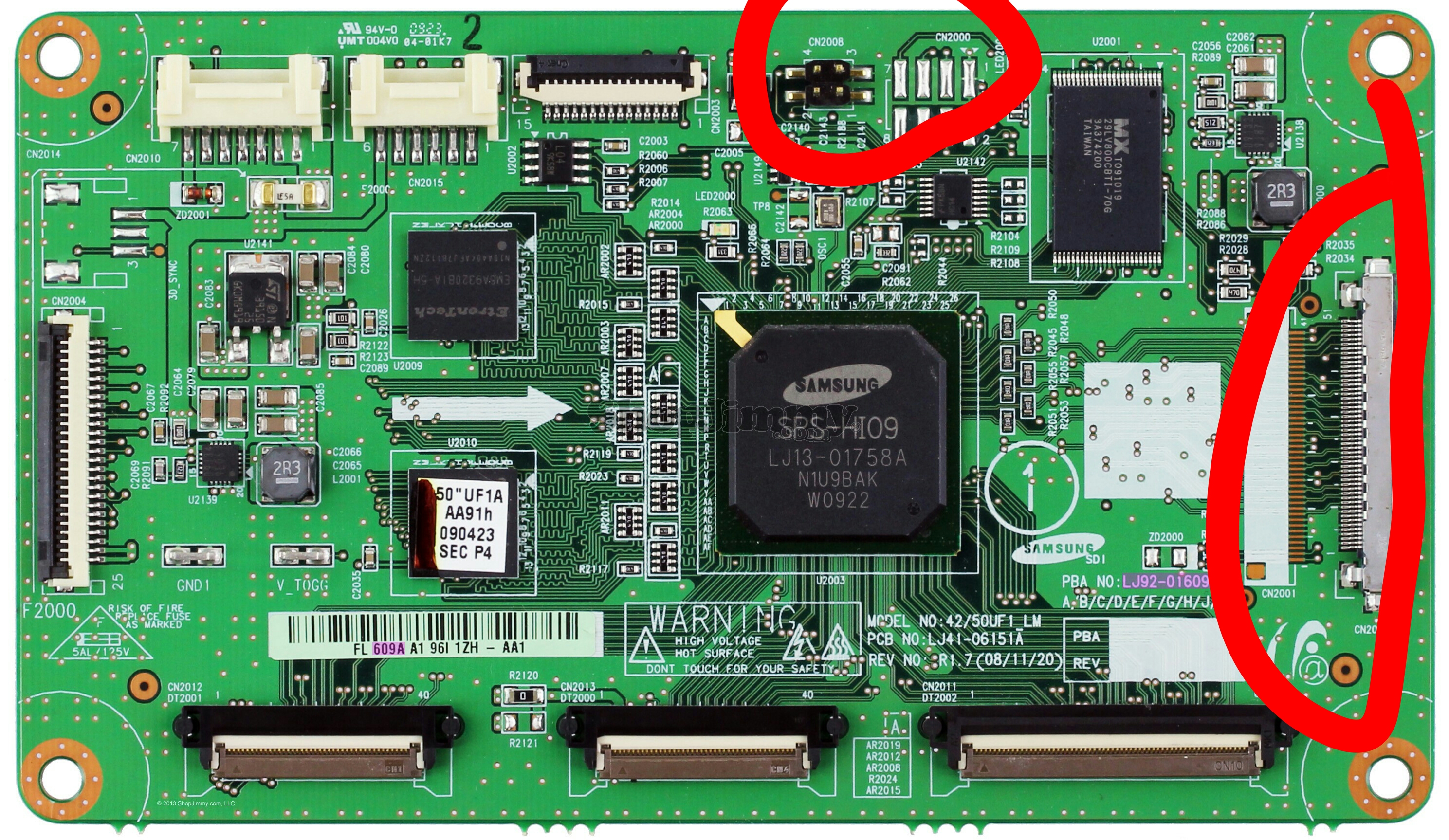

                          Ok, plug everything back in. Then unplug the cable going to the control board from the mainboard and take a small clip or something to short pins 3 & 4 on control board. Plug in tv and look for test patterns on screen. If you have them the mainboard is bad.

                            The parts in red.

                              Re-solder? The circles surround multiple components, are you talking about the ribbon connections? Thanks!

                                Re: Samsung PN50B650S1F clicks on plug-in with flashing voltages
                                Circle on the left is the ribbon to unplug. Top circle has 4 pins. You have to short them together temporarily to test. You can use a piece of wire and wedge it in between pins 3 and 4.

                                  OK great I will try that and let you know what happens. Seems like we're testing the logic and input boards. I may have the names of those wrong?

                                    mainboard has all the hdmi ports on it. Logic control board is the pic with the red circles.

                                        Okay disconnected that ribbon cable, shorted pins 3 and 4 together with an alligator clip, plugged it in and no change. So are we going to disconnect a different cable, short the other two pins to check another board? Just guessin'
