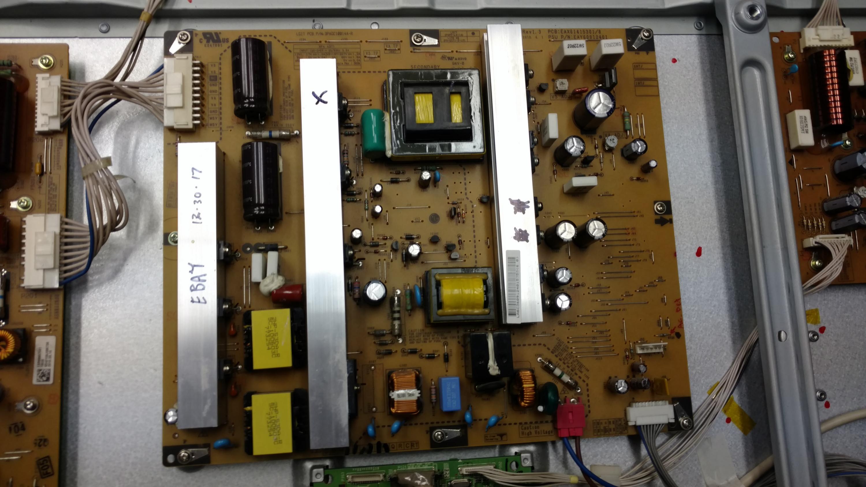

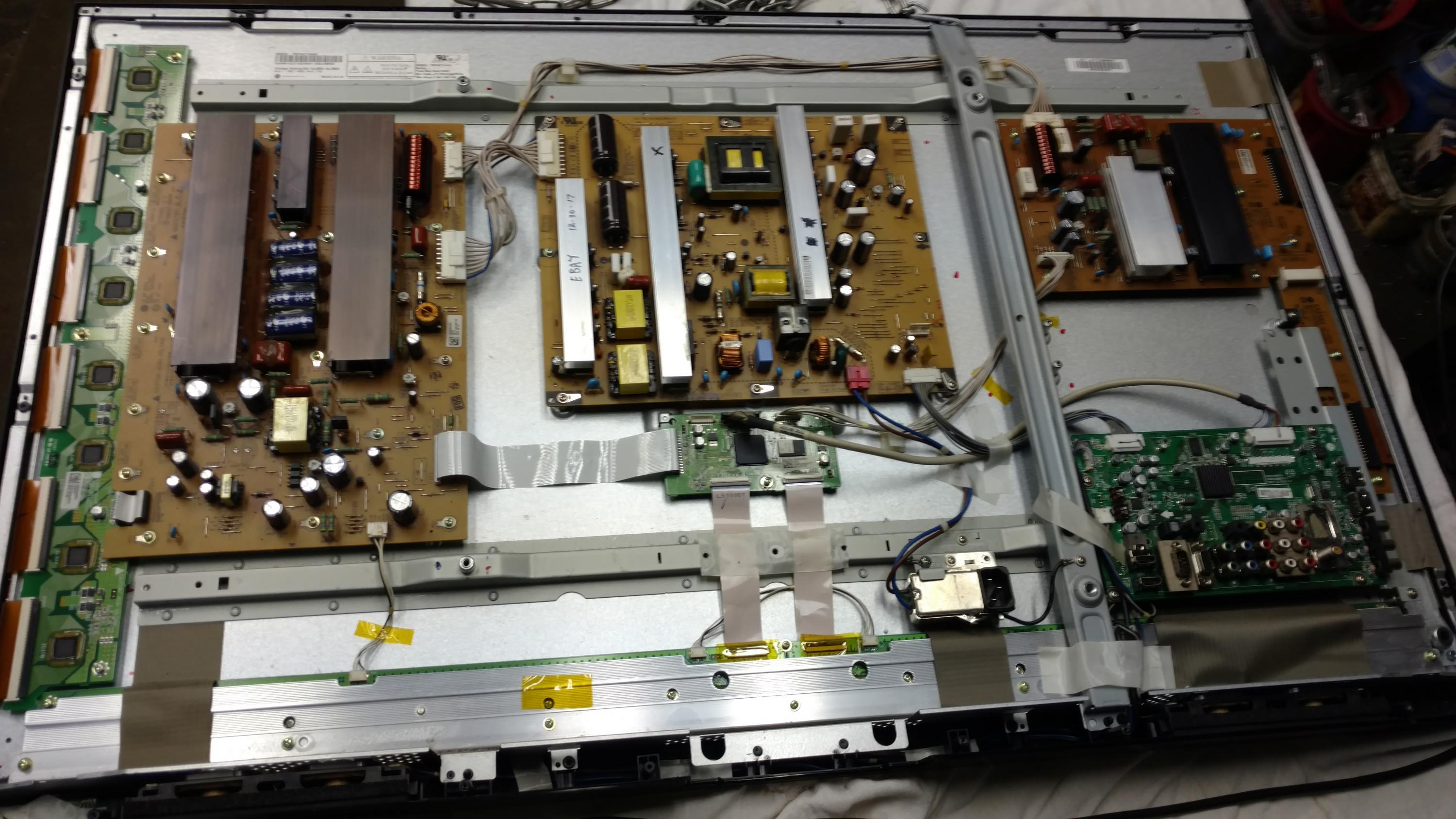

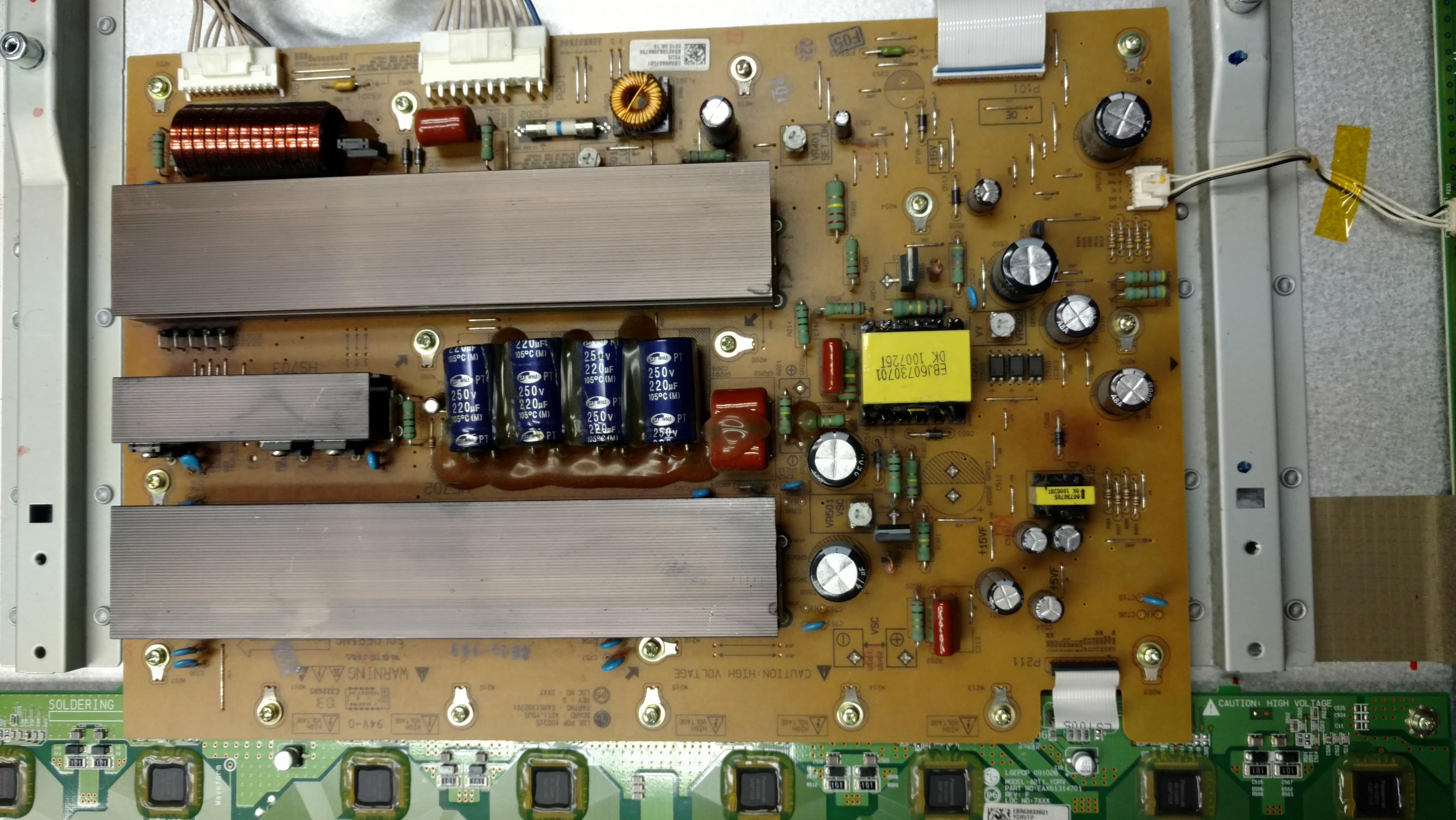

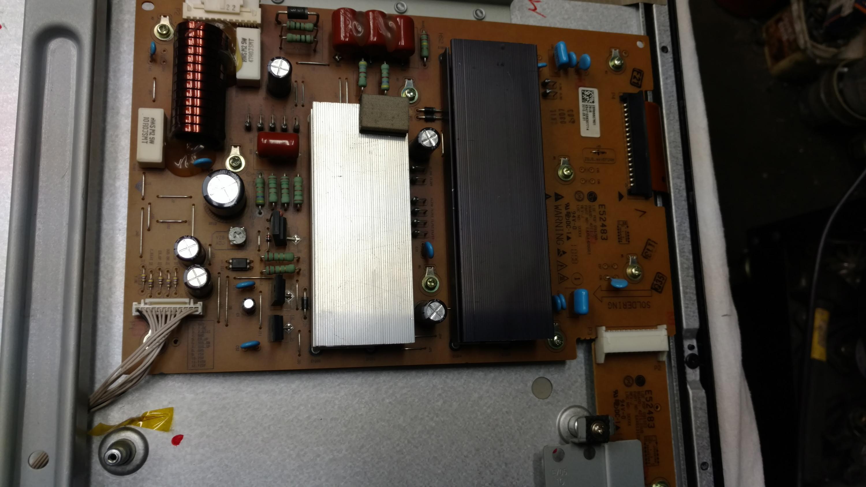

    Have a LG 42PJ350 that has all PSB voltages after 2 clicks. The 15V that is generated from the YSUS bd comes up to 18v and then slowly drops down to 4.1V. The 5V from the PSB is there solid - also on the Ysus bd to the logic bd. Have checked buffer bd, Ysus bd, Zsus bd, logic bd, PSB. Have replaced Ysus bd, PSB, buffer bd, logic bd, and no luck. Remote works good - set turns on and off. When first turned on - set makes a buzzing noise for about 3 seconds (same amount of time the 15V line is around 18.1v). anybody seen this symptom ? About ready to dump this set.

    pics of boards

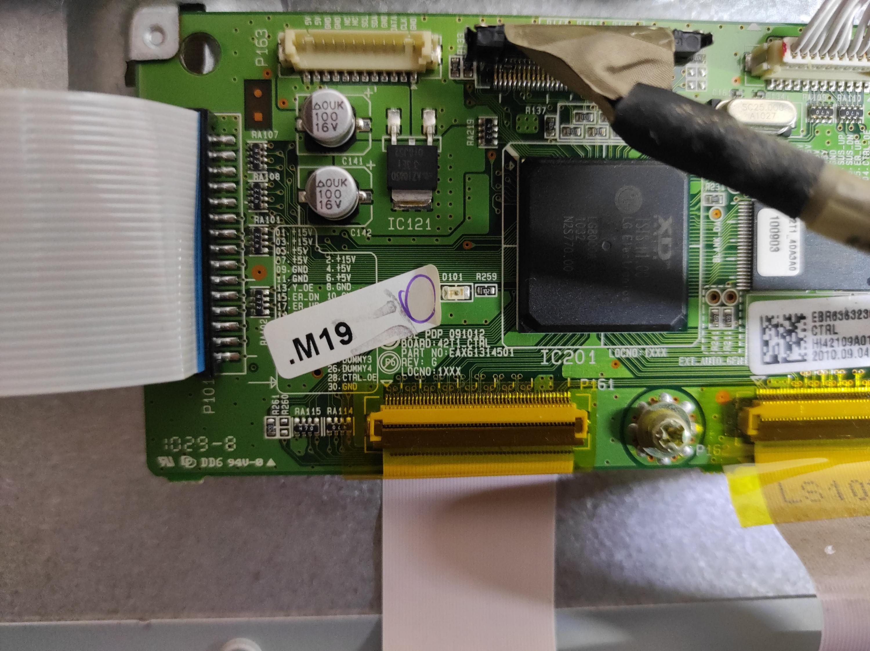

                        Sound and everything works but no image. Voltages on the panel are correct and 15V has 18V ok. Looking for the control board and the led don't light up, so with the set working, i tried to put some pressure in control board XD IC and suddenly the led on ctrl board started blinking and image appeared. I must assume this is a ctrl board with bad XD IC bga joints and it should be replaced.
                        This is only another testemonial to confirm that when you have all voltages and no image it must be ctrl board fault.
                        Regards and thanks for all the sharing!

                          Yes , your quite possibly looking at poor ball connections on B G A chip .
                          Unless you have a re-ball station , a replacement control board is required.
                          Also , normally there is some sort of blink code with L E D S on control board , that may give indication of faulty board , for future reference .
