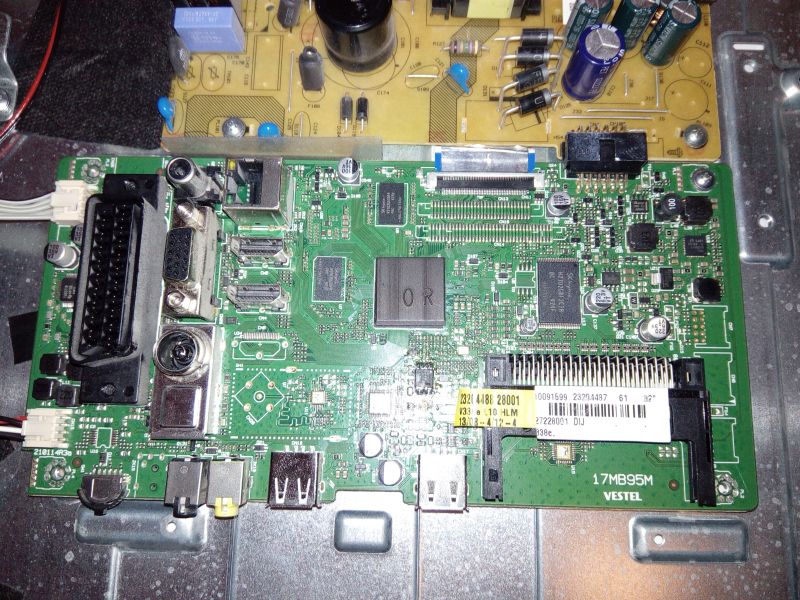

    Hello gentlemans,
    sorry for my bad english.
    I would like ask you for help to find the proper firmware for the LED TV GOGEN TVF32157WEB. This TV had an opened LED diode on backlight strip - fixed.
    Than I found that firmware is broken also. So my first step was looking for the SPI FLASH content. I found exact one on some russian web. I flashed this dump to my U10 memory. Now I am able to load the firmware from USB. I found some on Toshiba web for the same display but slightly different main board 17MB95S. TV can start and display is working correctly. Unfortunately tunner not recognize the channels, no sound from the speakers and in service mode I am not able to make changes.
    MAIN: VESTEL 17MB95M
    DISPLAY: VES315UNDL-01
    Thanks in advance
