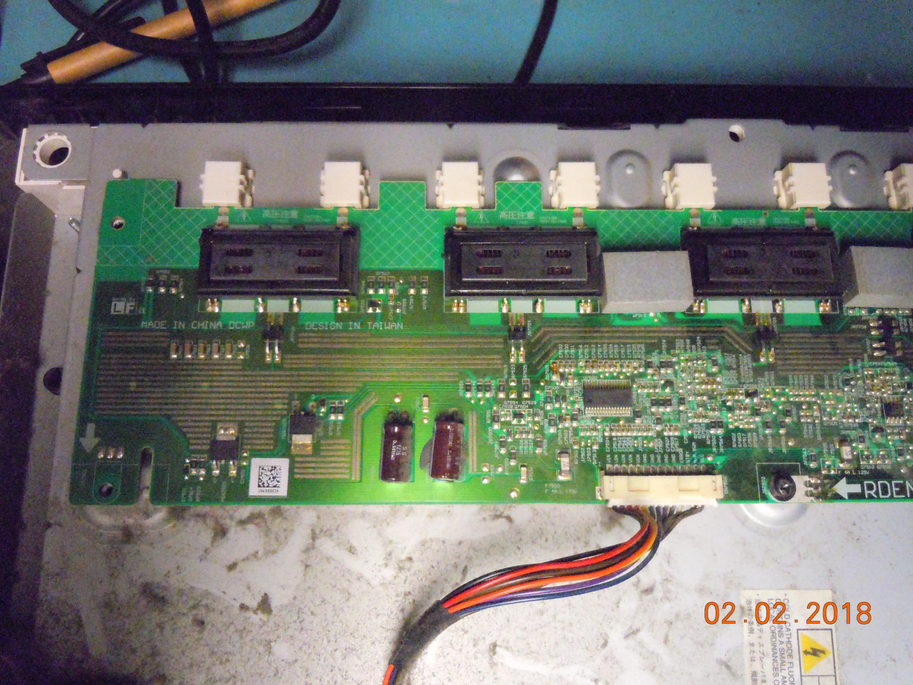

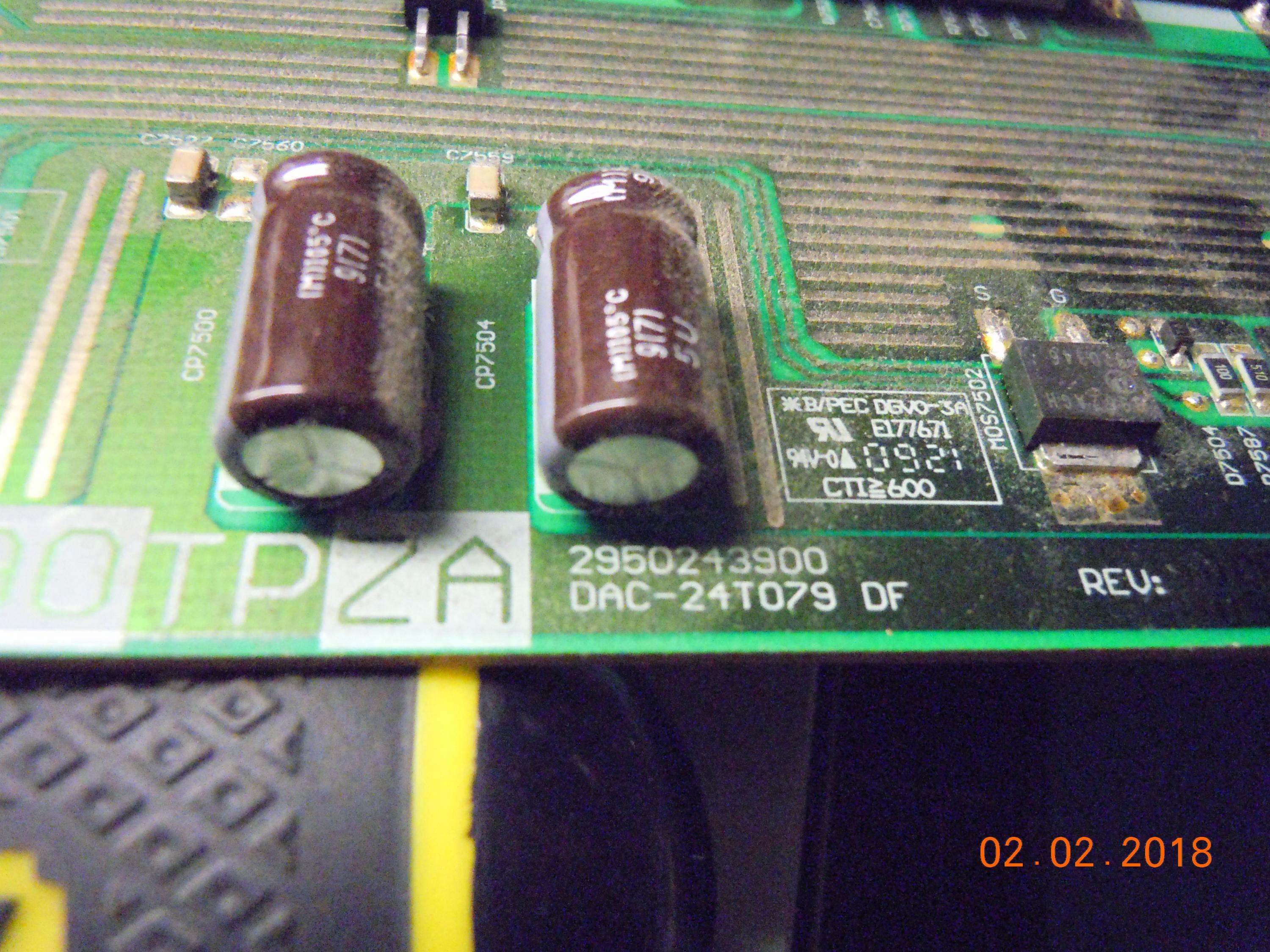

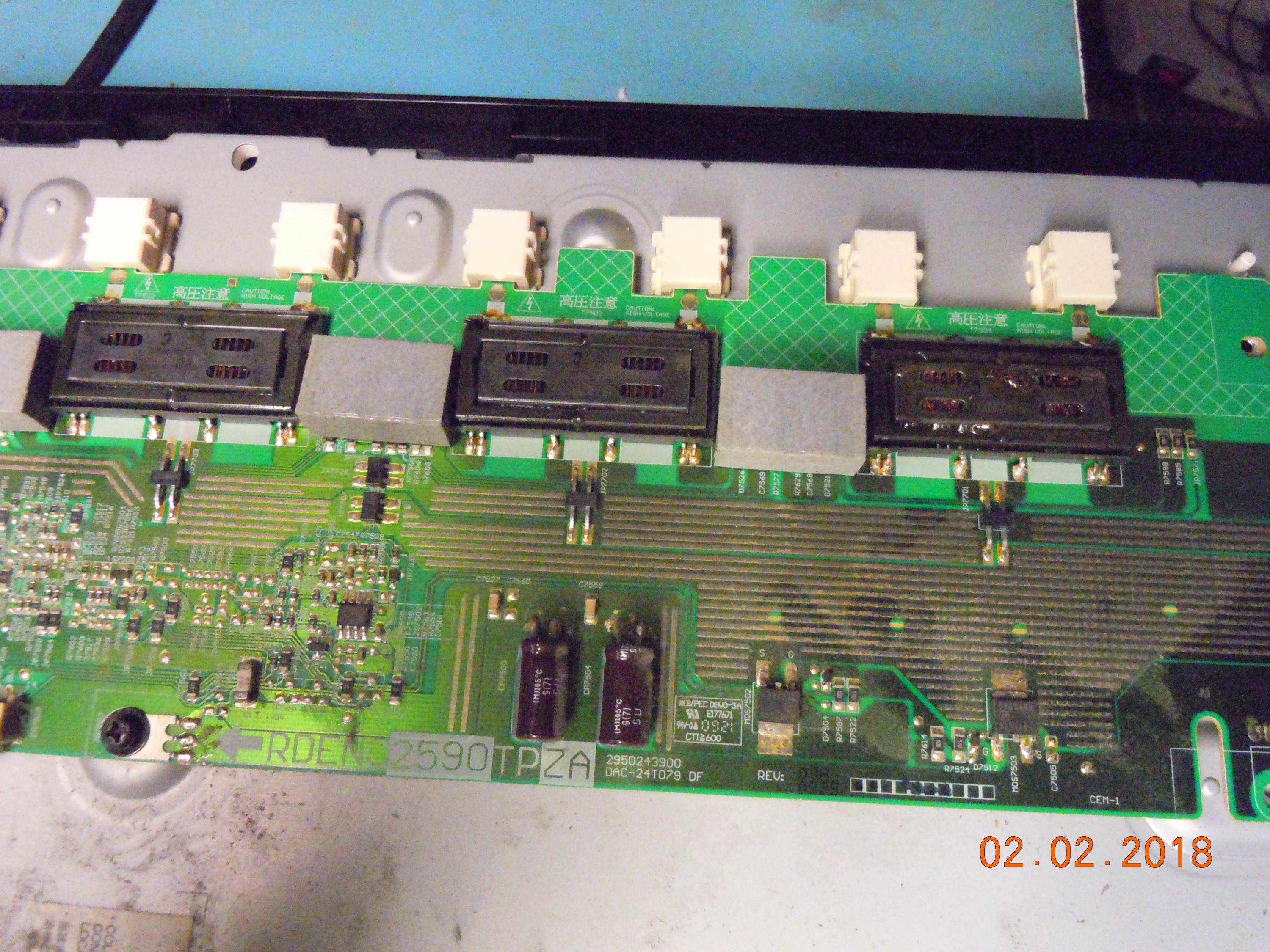

    Having trouble nailing down the issue on this. I'm pretty sure it's the inverter board but want to be sure. Voltages from the power supply to the inverter board are all good (24v, 5 and 3) and stable even after the backlight goes out. I can't find the service manual. Only thing I found was the SMART troubleshooting guide.
    All backlights appear to turn on. Is there something else I can check on the inverter board to be sure there isn't any other issue?
    Thank you!!

    Check the resistance of the HV secondary winding of the transformers to see if they are within 3% from each other or not.

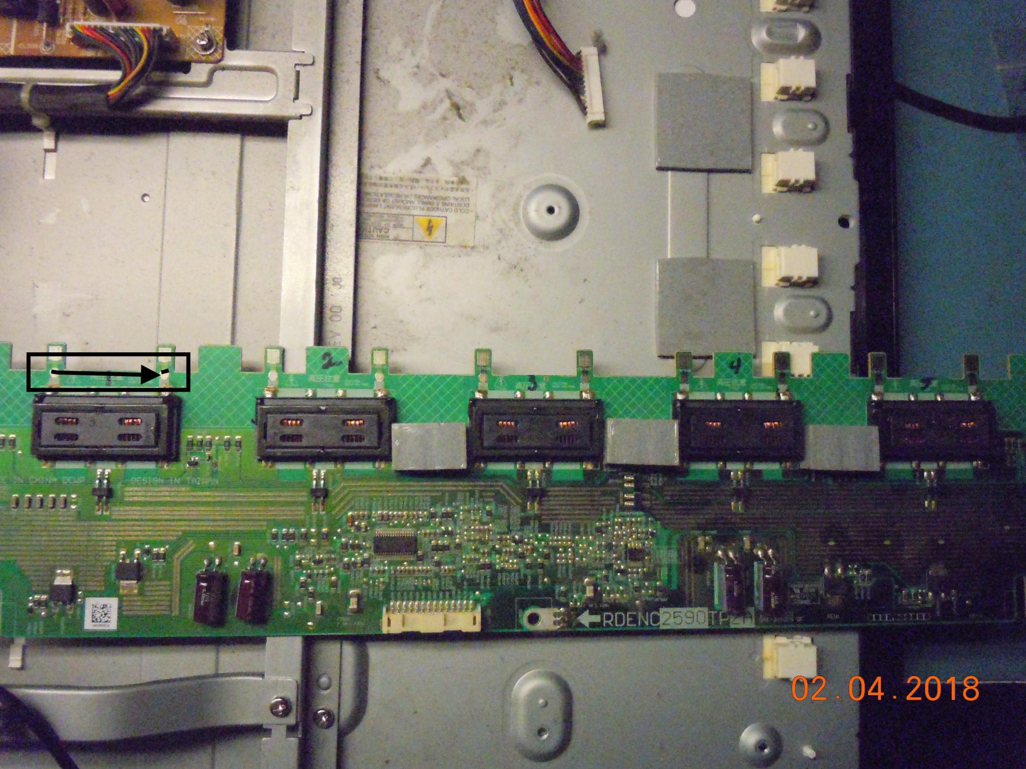

        Bumping this up. Can someone confirm I'm testing the secondary coil at the right points? Thanks!!
          Re: Toshiba 32AV502R Backlight comes on and goes off

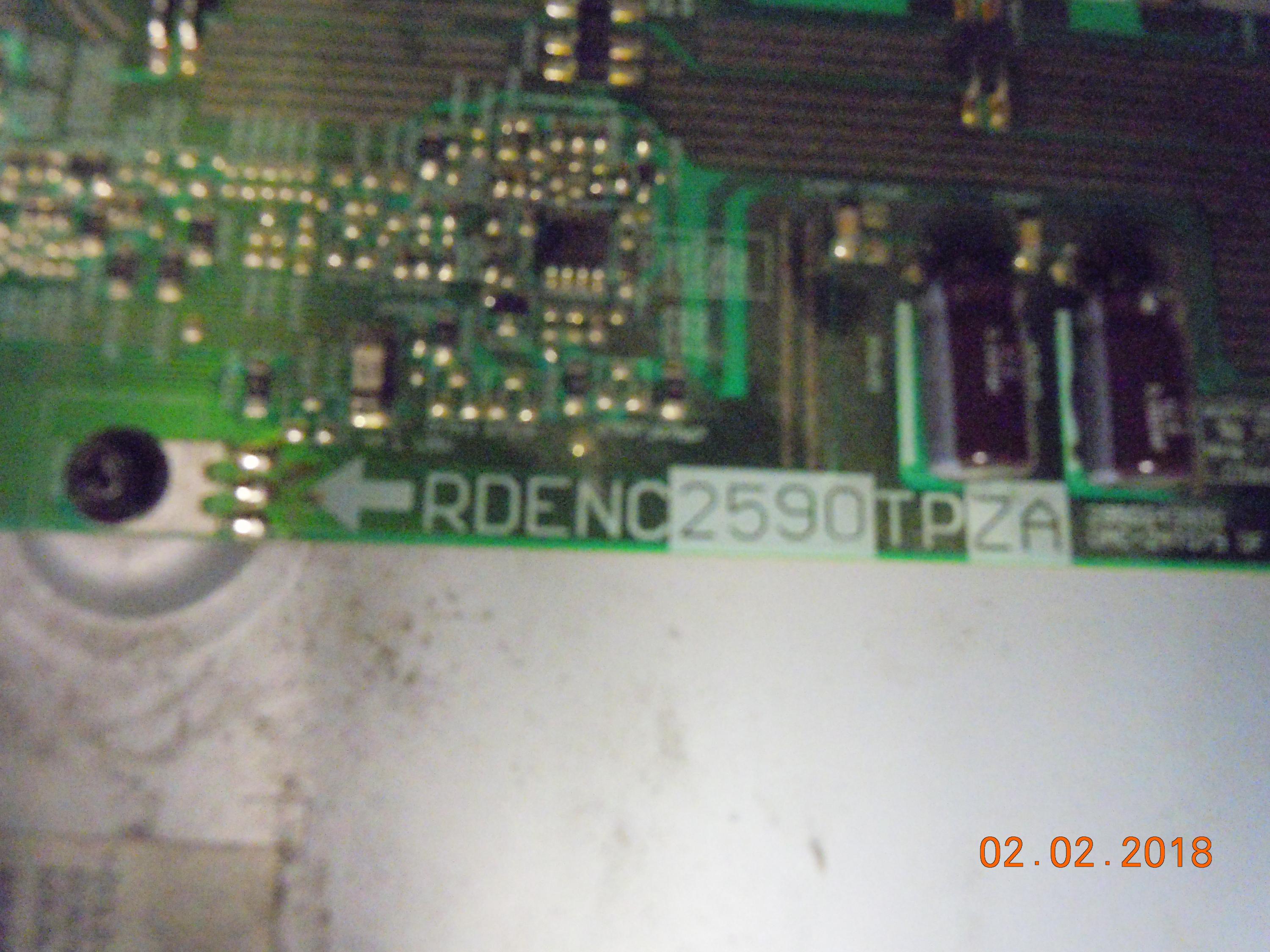

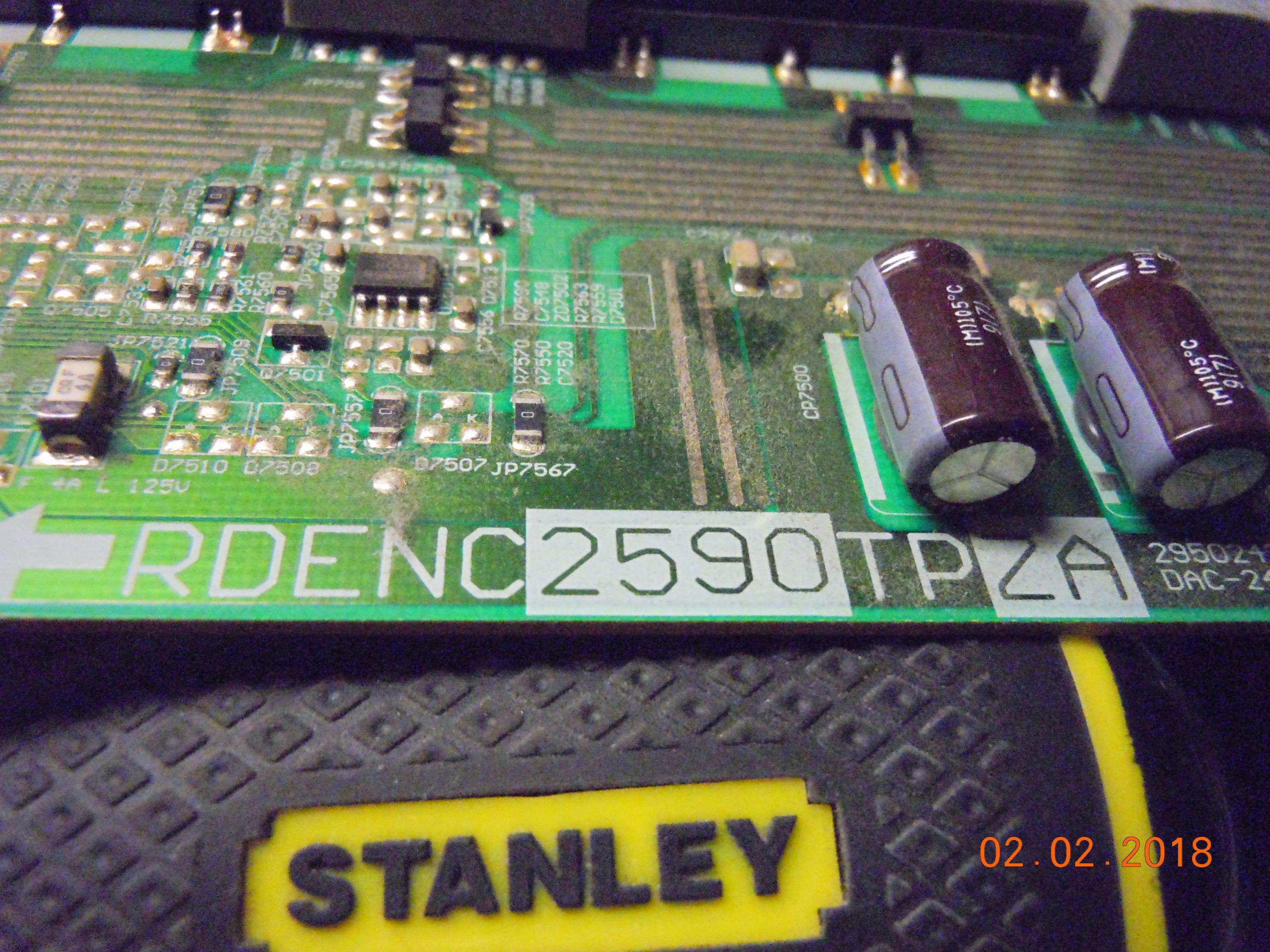

          Looking at the traces layout, it looks like it has one secondary winding between the top left corner pin and bottom left corner pin, then another secondary winding at top right corner pin and the bottom right corner pin.
          I cannot read P/N on the transformer to get the pin-out of the transformer.
          Can you read the numbers on the top of the transformers?

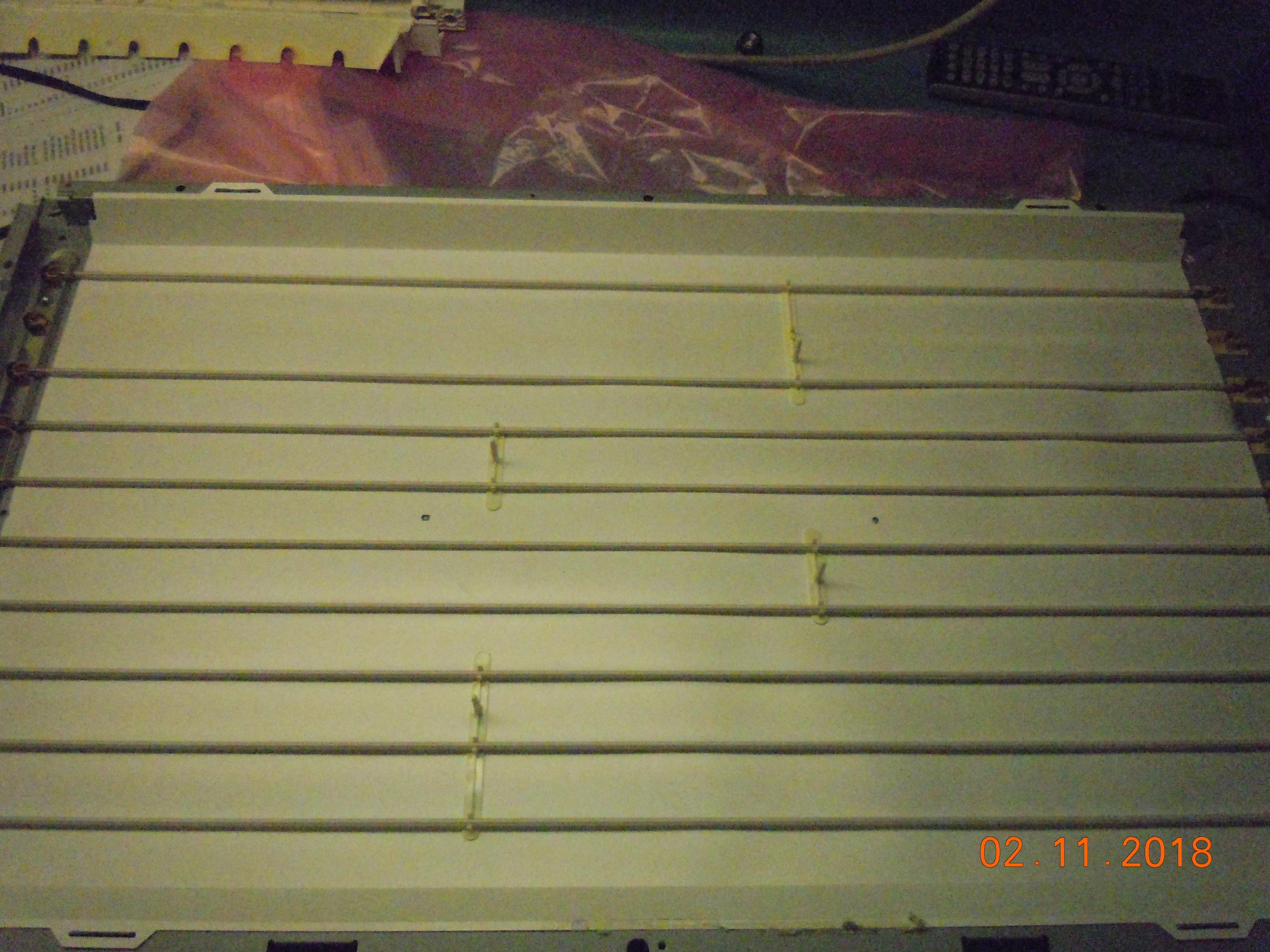

            Sorry for the delay Budm. My curiosity go the best of me, I wanted to make sure all the lamps were coming on. I removed the LCD, and it is indeed a bad lamp!! I would like to replace them all if there is a reliable source.

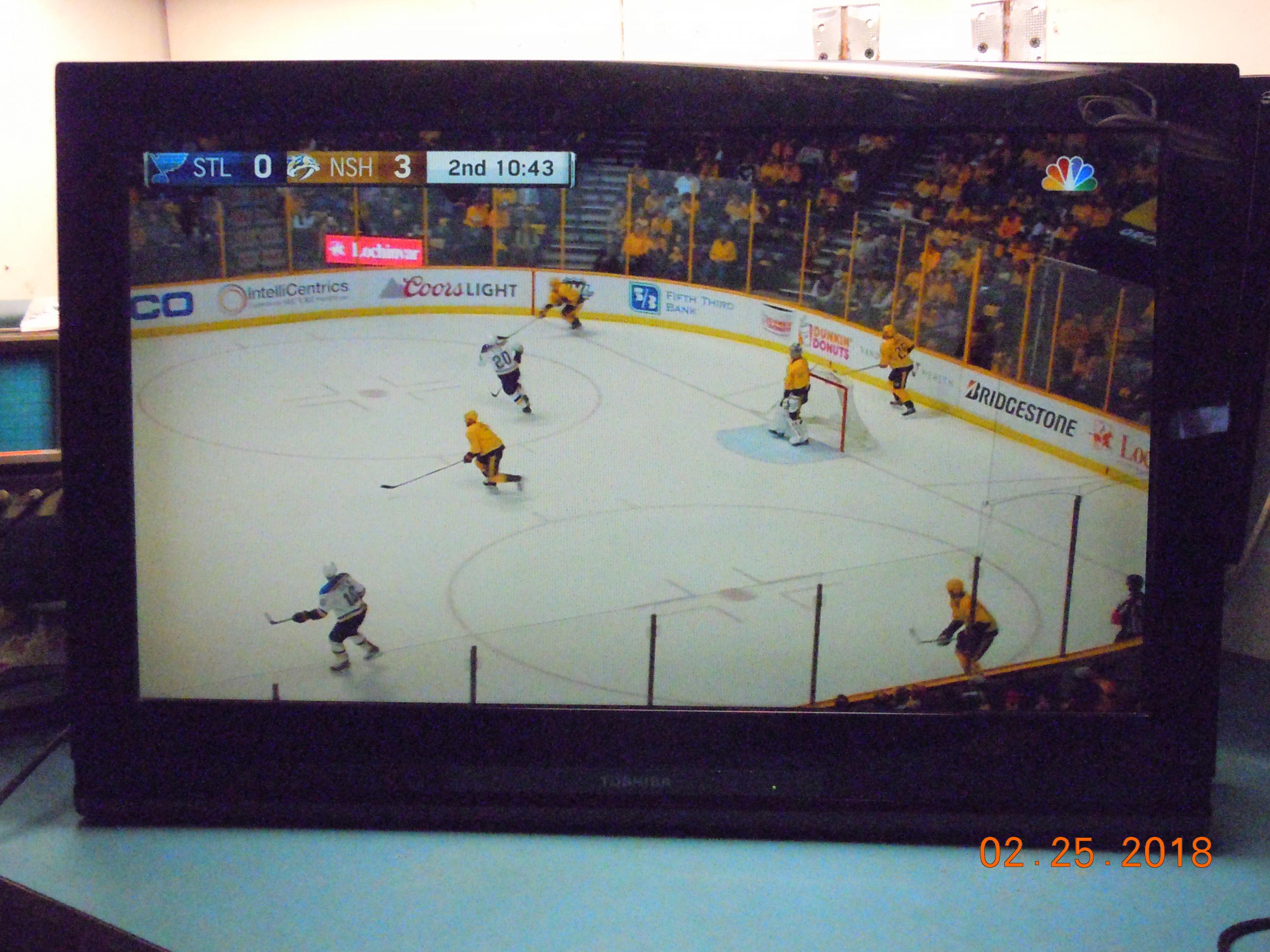

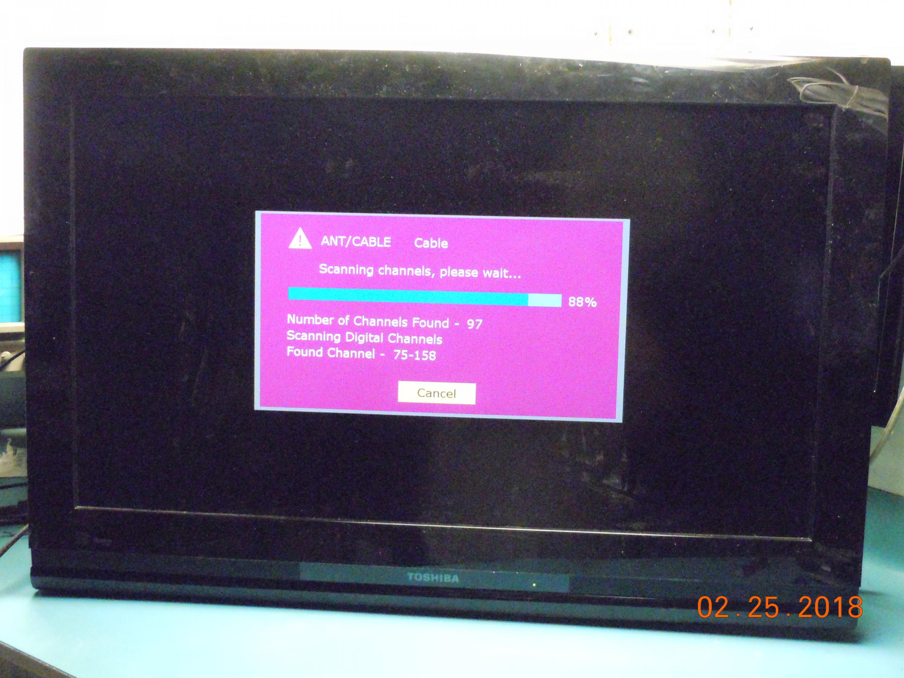

                                Forgot to update. Received the new lamp from CCFLWarehouse. Side note, they package lamps SUPER SUPER well!! It had three layers of padding. Color me impressed. Only down side with the replacement lamp is the leads on either end were pretty thin gauge compared to the OEM lamp.
                                Happy to say, saved another TV from the landfill/ecycling bin.
                                Thanks to all that helped!
