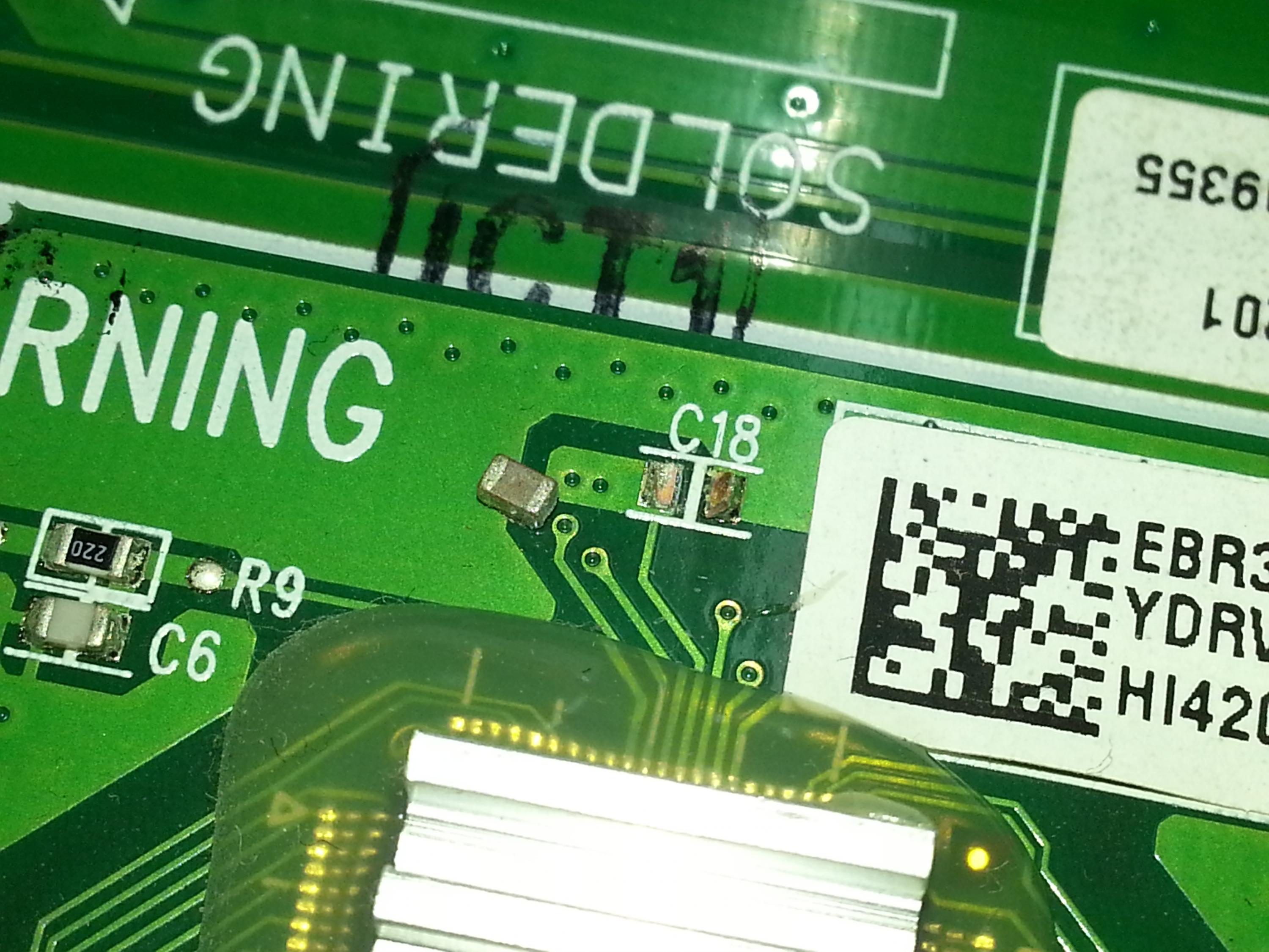

    I made another discovery: upon close inspection I noticed THIS on the Y-buffer: C18 was completely torn off and only hanging onto one pad, while the other one was up in the air (picture was taken after I removed it entirely)....I have no idea how that happened, but it's certainly not ok. I thought I somehow touched it when I removed the back panel, since it IS very sharp on the edges and could've easily done that sort of damage, but I dismissed the thought because the board is lower than the edge of the cabinet, so there's no way the edge could've scraped on that part, plus there are no scratch marks. I highly doubt it would cause the WHOLE picture to lack, but it shouldn't be like that to begin with, so I shall solder it back and see what happens. And no, neither the cap nor those pads are shorted.

      Unfortunately no, soldering back that cap had no effect at all...
      Also observed those LEDs on the main board more carefully: they all come on and remain steady after the TV has powered on (despite not having picture). I read somewhere that one of them should be flashing or something...

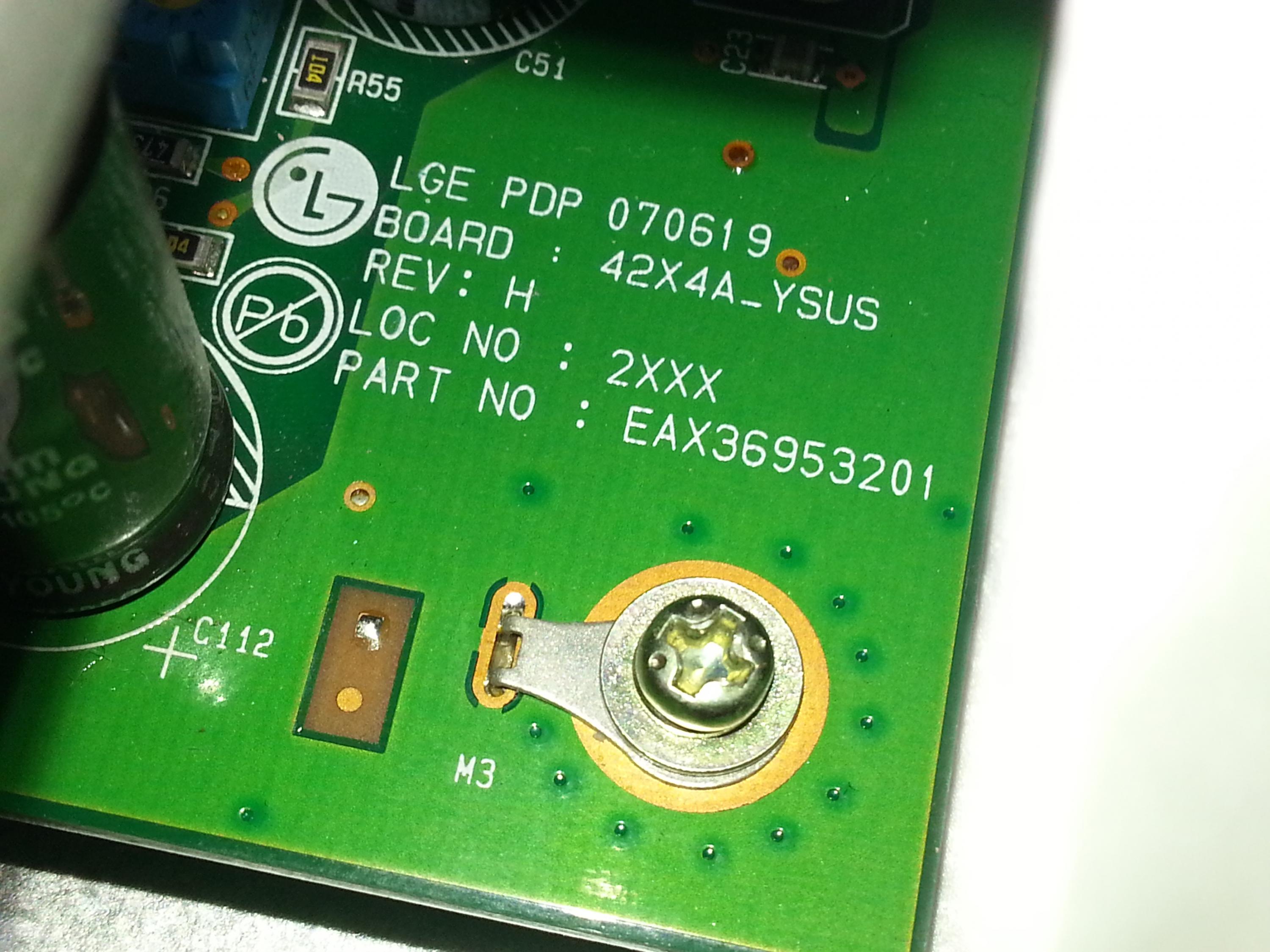

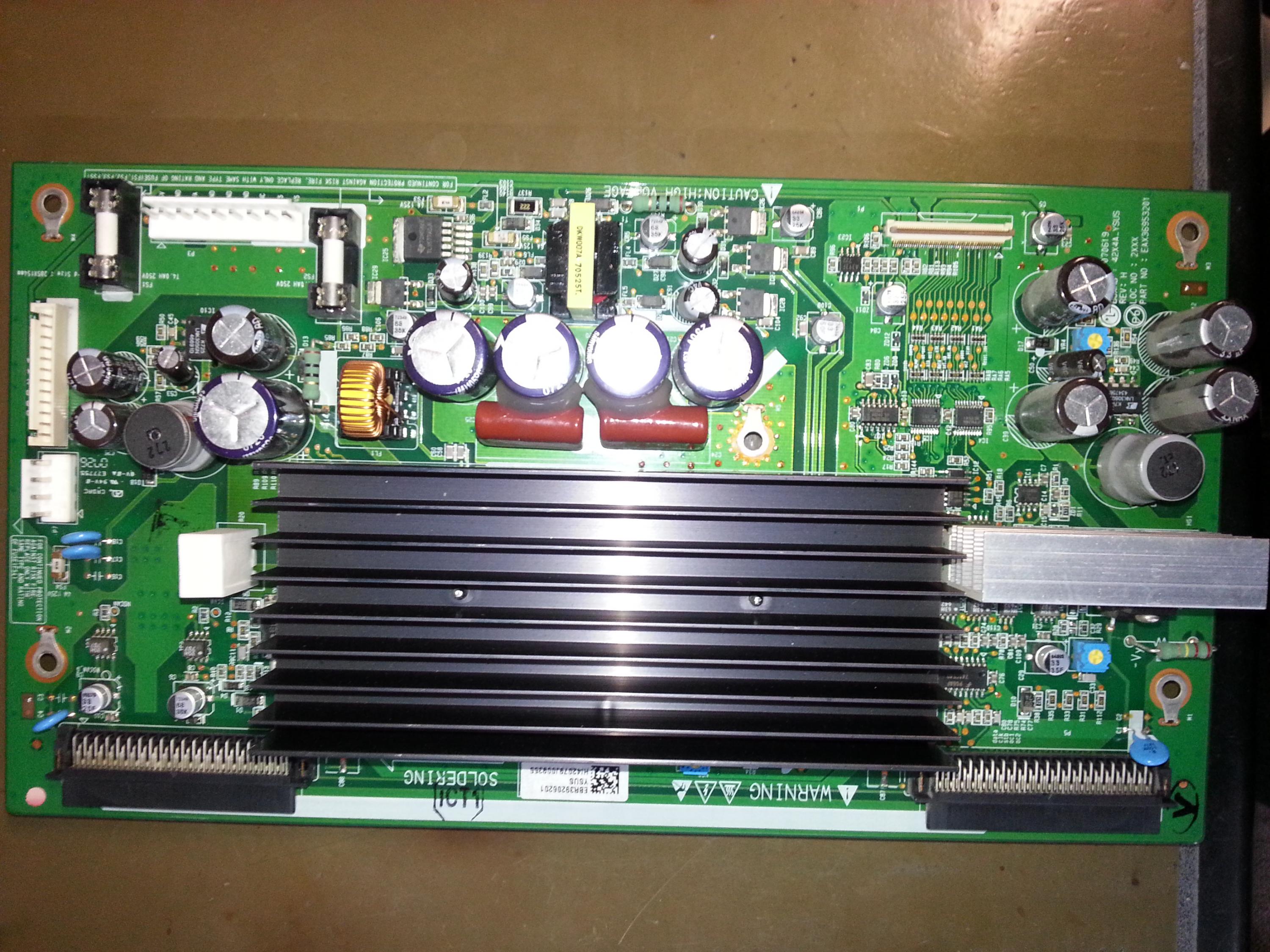

          Figured it was about time I provided some pics. Here's the Y sustain which I believe is faulty.
          Some more details: the PSU doesn't seem to want to turn on without a load attached to the Vs line: the relay closes, Vs goes up to around 206v then goes back down to 0 (despite the relay staying on). If I connect an incandescent lamp between Vs and GND, the PSU stays on and I get 60v on Va and around 180v on Vs and all of the other correct outputs, so I think we can safely say the PSU is fine.
          However, if I leave everything connected, the relay clicks once, I briefly get Vs, then everything shuts down and the LED goes back to red.
          If I remove the flat flex cable going between the control board and the Y-sus, ironically, everything stays on, even Vs, despite not wanting to turn on WITH the flat flex in place, so it's as if a control signal to the Y-sus is causing an overload of the PSU causing it to shut down, or a LACK of enough load to make it stay on...confusing AF, I know...
          Control board seems OK: I get 3 lit LEDs, plus a flashing one the bottom corner.
          I have thought of a trick but am not quite ready to pull it off: lamp between Vs and GND with Y-sus still connected, but I fear that might damage something if the Ysus is indeed busted and I force voltage into it....
          Starting to think more and more that the Ysus is somehow faulty, despite not having any blown fuses or shorts, that's the main issue here: everything seems fine and it's downright impossible to track down.

            Re: LG 42pt85 plasma TV turns on but has no picture
            Have you tried disconnecting the buffer boards from the y-sus board to see if it stays on?
            If it stays on with the flat flex cable removed do you also have -Vy voltage on the Y-sus

              This is OVP, the PSU cannot work without a small load on Vs so voltage goes up then it trips out.
              Do you have an oscilloscope or access to one?
              You should also check Vsc, -Vy and Vzbias and compare.
              Use a multimeter to test output of Y-sustain and Z-sustain on DC volts. Also check across energy recovery caps (should be 1/2 of Vsus).
