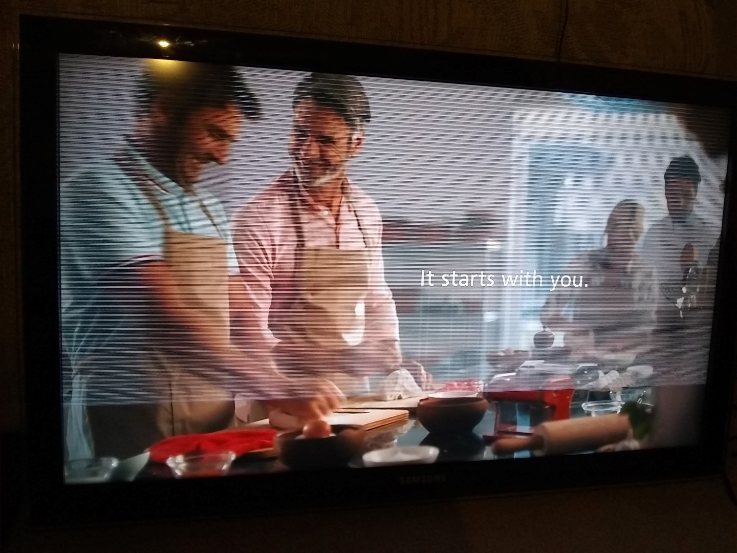

    Samsung LN40D630 Lines - Bad Tcon?
    Got this TV thinking it had solid lines so a bad panel and would have to be scrapped. Bad tcon? Tab bonds? Lower 1/8 of screen is ok.
    Found this as well. Tape on Tcon ribbon cable fix https://www.justanswer.com/tv-repair...-vertical.html

    Re: Samsung LN40D630 Lines - Bad Tcon?
    That is a bad panel and irreparable, I'm afraid....
      Thanks for saving me the money of not trying another tcon board. Quickly tried the tape fix but made it worse. Back to the original plan of salvaging the boards.
        Keep your board, it has a lot of value.
        For everyone to be aware, these TV very often will get lines across the screen, and most often they are due to a FAILED MAIN BOARD. However when the main board causes lines it will create lines universally across the entire picture. In the picture uploaded at the beginning of the threads you can see that the bottom portion of the picture is not affected by the lines. This is why we are able to say that the panel has failed.
