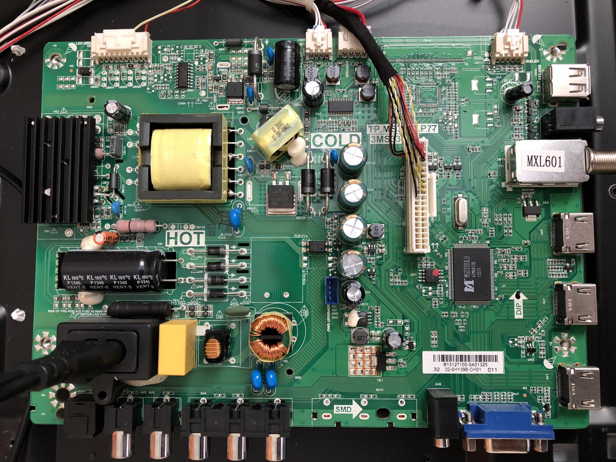

    At first it would turn on if I reseated the LED connector then stopped powering on all together. No response
    170vdc at main cap
    55vdc at led connector and never increases when attempting to power on.
    Bl_on stays at 0v
    12v measures 12v
    3.3v measures 3.3v
    K0/AD measures 3.3v = tied to power button goes to 0v when pressed
    5v_M measures 5v
    5v_STB measures 5v

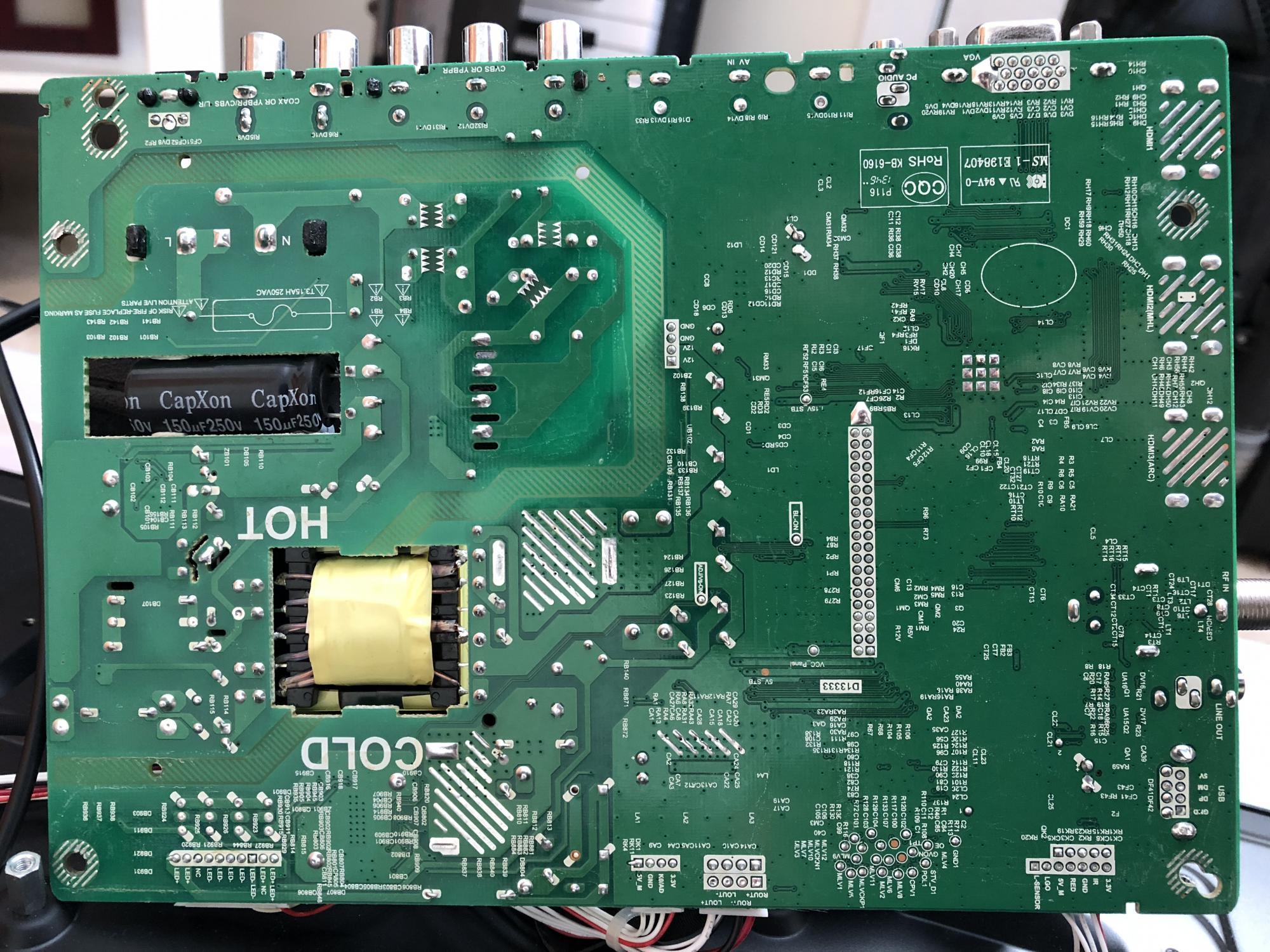

    Board isn’t labeled to well on the underside to help me probe for other voltages
    What should I look for next?

                  I found this pdf with the processor used https://cdn.badcaps-static.com/pdfs/...eb32b3af66.pdf
                  All voltages are there on the processor except the power on/off connected to. GPIO never changes from 0v
                  Would this be an eeprom issue? If so how do I go about trying to upgrading it? Where would I get the software?

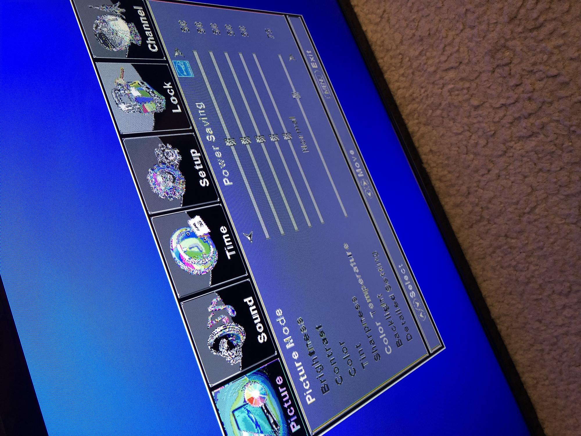

                                  So I ordered a replacement eeprom from shopjimmy. Tv now powers on everytime, however there is now weird discoloration and the image is upside down. Could it be a bad replacement eeprom?
                                  • freakaftr8
                                    • Oct 2012
                                    • 3743
                                    Re: Sanyo DP32D53 - No Power
                                    The eeprom is good However the eeprom is program to a different LCD panel than the one that you have.
                                    Did you make sure that the full model number including the suffix and prefix were looked over when you ordered?

                                      Model numbers is, but I just noticed the sticker on the board shows 02-SHY39B-CHS1 and the one I purchased is listed as 02-SHY39B-CHS0
                                      Is there a setting that can flip it or I need to get the right eeprom?
                                      • R_J
                                        • Jun 2012
                                        • 9588
                                        Did you have a look in the service menu?, not sure how to get into it but on some sanyo's: unplug tv, hold vol (-) on tv and plug in tv, others its Press & hold MENU on tv and press `1' on remote
