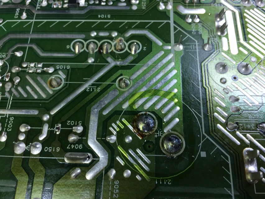

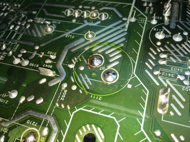

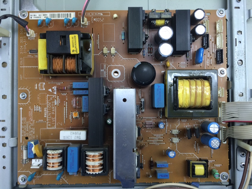

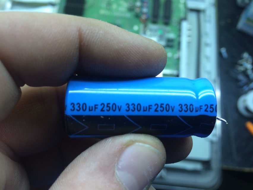

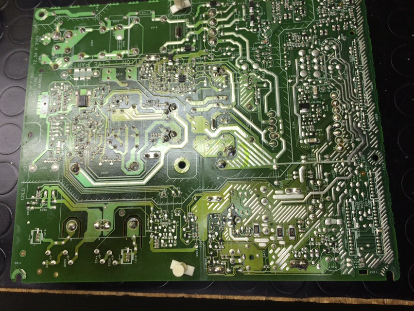

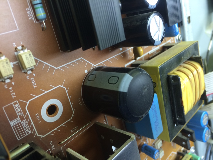

    Merry Chrismas and a happy new year to everyone. Im facing a strange problem with my TV. Its a Phillips TFT-LCD42PFL7433D/12.It used to work normally until the day that it started turning itself off after a long period of viewing (about 3hours). I dissasembled it and found out that the big capacitor in the center of the psu, a 330uf 200V was bulged. I thought thats the problem and after measuring the cap which showed 130uf value in my multimeter i was sure this is it. i went to my local store and found available only a 330uf 250V and though it should be fine. I went ahead and replaced it but now TV doesnt turn on at all. When i try to power it on i hear a 1 click noise from the psu the frond led flashes twice but it doesnt turn on at all. I tried to put back the old capacitor back but it still doesnt turn on. Does anyone have any idea what went wrong? I will also attach some pictures.Thanks in advance.
    PSU partnumber: 310432852762
    Input Voltage: 250V

    Re: Phillips LCD TV 42PFL7433D/12 weird problem
    did you put it in with the correct polarity ?
      Yes i definetely did. Now the old capacitor is on but TV doesnt turn on at all. Before that it used to run for about 3-4hrs shut itself down and i could turn it back on instantly. Now even with the old cap in place and nothing else touched its dead. If i did put the new cap in wrong polarity dont you think it would explode instantly?

              I also checked the board with my magnifying glass at all its solder points and again everything seems normal.Should i resolder everything anyway?

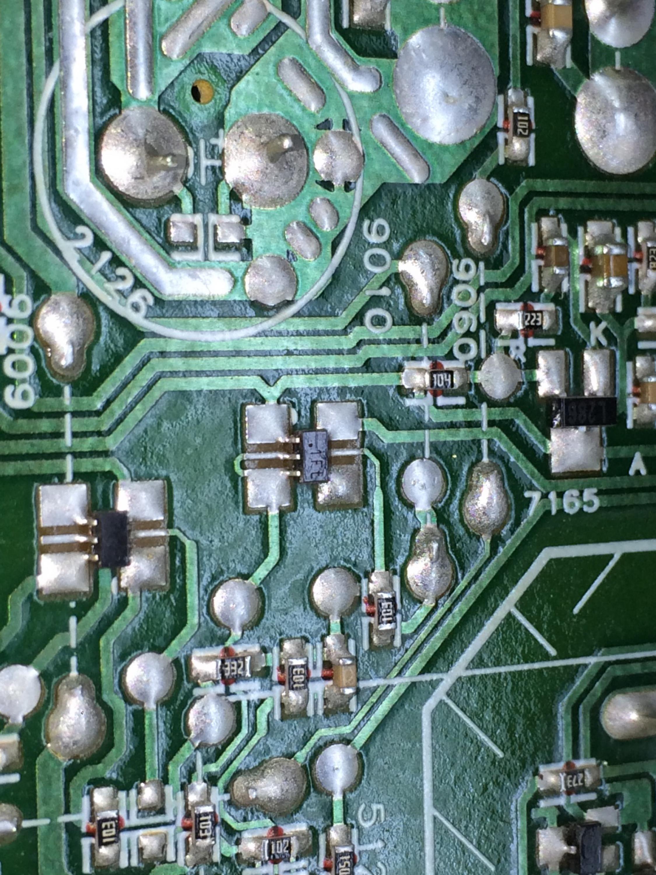

                  Hello again and sorry for my delays, ive been through some other problems. Anyway, i did found 7140 which is not shorted and i also checked 7126 which is also not shorted. I dont get +24v for a sec i get about +20v for i sec.

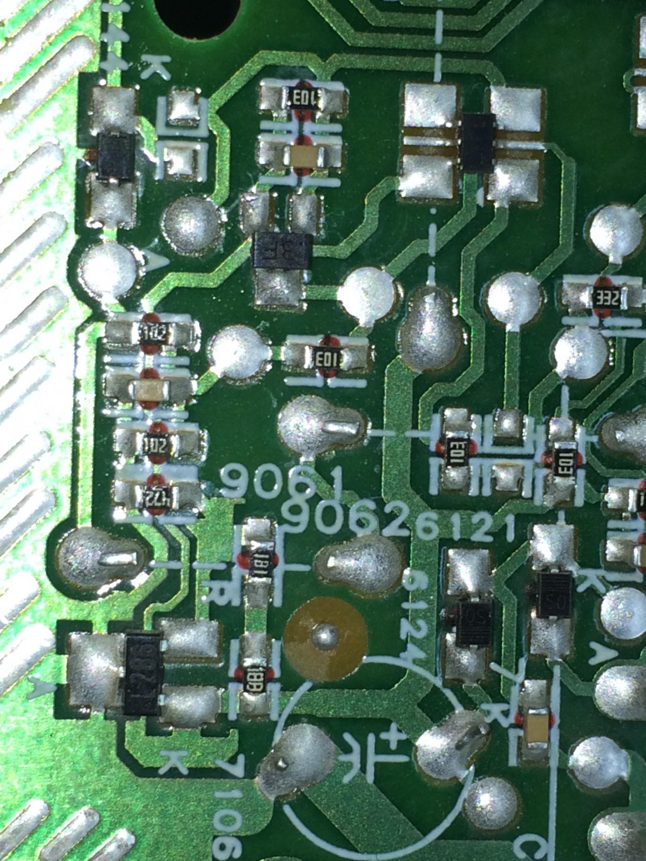

                    I also took a picture of them and they seen both fine. nothing shorted or so.
