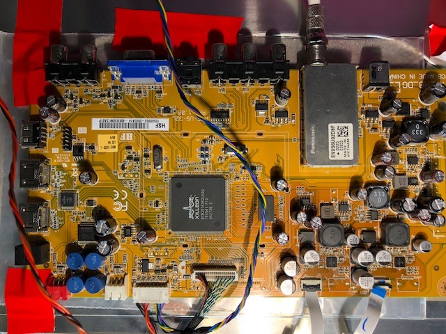

    Hello: As the title says I have acquired a Westinghouse LD-3255VX for free with the issue that the right LED (looking at it from the front) will not illuminate. I have narrowed the issue to the Main board. It is not the LED strips. How do I know (I think), I swapped the LED cables for the left and right LED strips and both LED strips will work if I source the output from the left output (CON2,CON19,CON1)). Other than the right LED channel not working, the TV works fine, but dim on the right side.

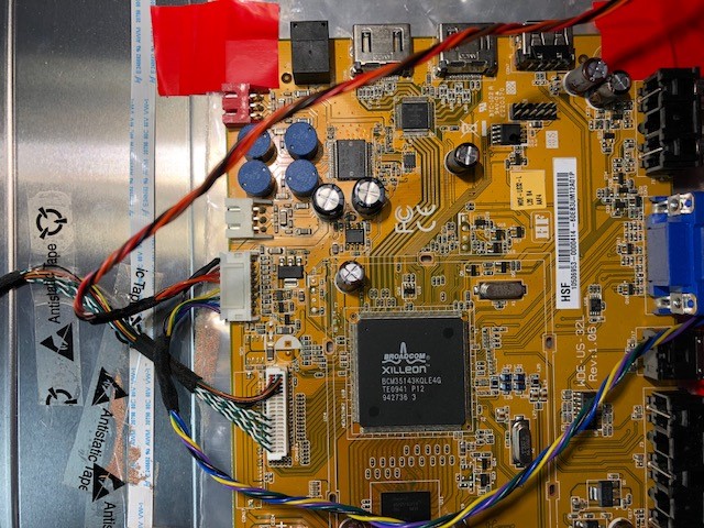

    I have attached four pictures. 1) is of the left half of the board, 2) the right half, 3) a close up of what area I think is having issues and 4) the entire board.

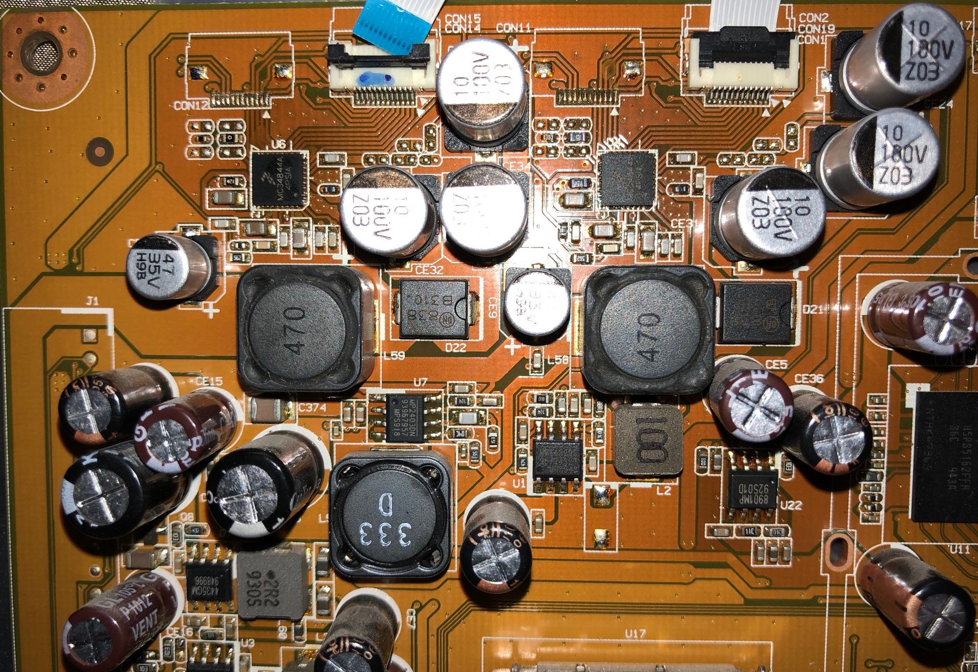

    Looking at the third picture "Close up", The cable connector labeled CON2,CON19,CON1 works. If I run either the left or right LED cable to this cable connector the corresponding LED channel will work. But if I try this with CON15,CON14 either of the corresponding LED channel will not work.
    From this I deduce CON15,CON14 channel is out. In the picture I have the LED cable removed but showing for the bad channel.
    Anyone want to provide some guidance on what and where I should try to get some readings? I can not source this board as they are not available.
    Can I move the cable connector attached to CON15,CON14 over and resolder it to CON11 as a work around?

    If you did move the cable you might end up overloading the good led drive ic, why don't you trace the fault in the bad section, there is a pdf for the MC34844, which gives pinouts etc. You may get lucky and its not the ic thats bad?

      1) Turn the TV off and leave everything all connected. Set the meter to 200V scale then keep the black probe of the meter on the chassis, red probe of the meter on D22 Cathode, then turn on the TV while watching the meter to see how high the Voltage goes up to and then wait 5 seconds to see how low it goes down to.
      2)Repeat the same procedure as in step but this time put the red probe of the meter on the Cathode of D21.
      3) Report the readings to us.
        Re: Westinghouse LD-3255VX Right LED issue
        Thanks for the responses and suggestions.
        I took the dimple side on the diode and wider white stripe on the board to be the cathode.
        For the working side D21 I got 54.1V on Cathode and 18.8 on Anode.
        For the nonworking side D22 I got 19.1V on Cathode and 19.12 on Anode.
        D21 goes from about 50V to 54.1 where it settles when turned on.
        D22 stays at 19.1 or so when turned on.

          So the boost converter circuit is not working in that bad section.
          Need to get the spec sheet of that IC MC34844

              We know at this point the Boost converter section is not working, so check the RESISTANCE of D22 in both direction to see if it has low leakage resistance or not.
              Then also check the EN signal to see if it is getting the command signal or not.
              You can also do resistance comparison reading between the good and the bad section.
              It is important that you read that spec sheet of the IC since it explains how it works, otherwise you can replace the IC or the whole board instead.
