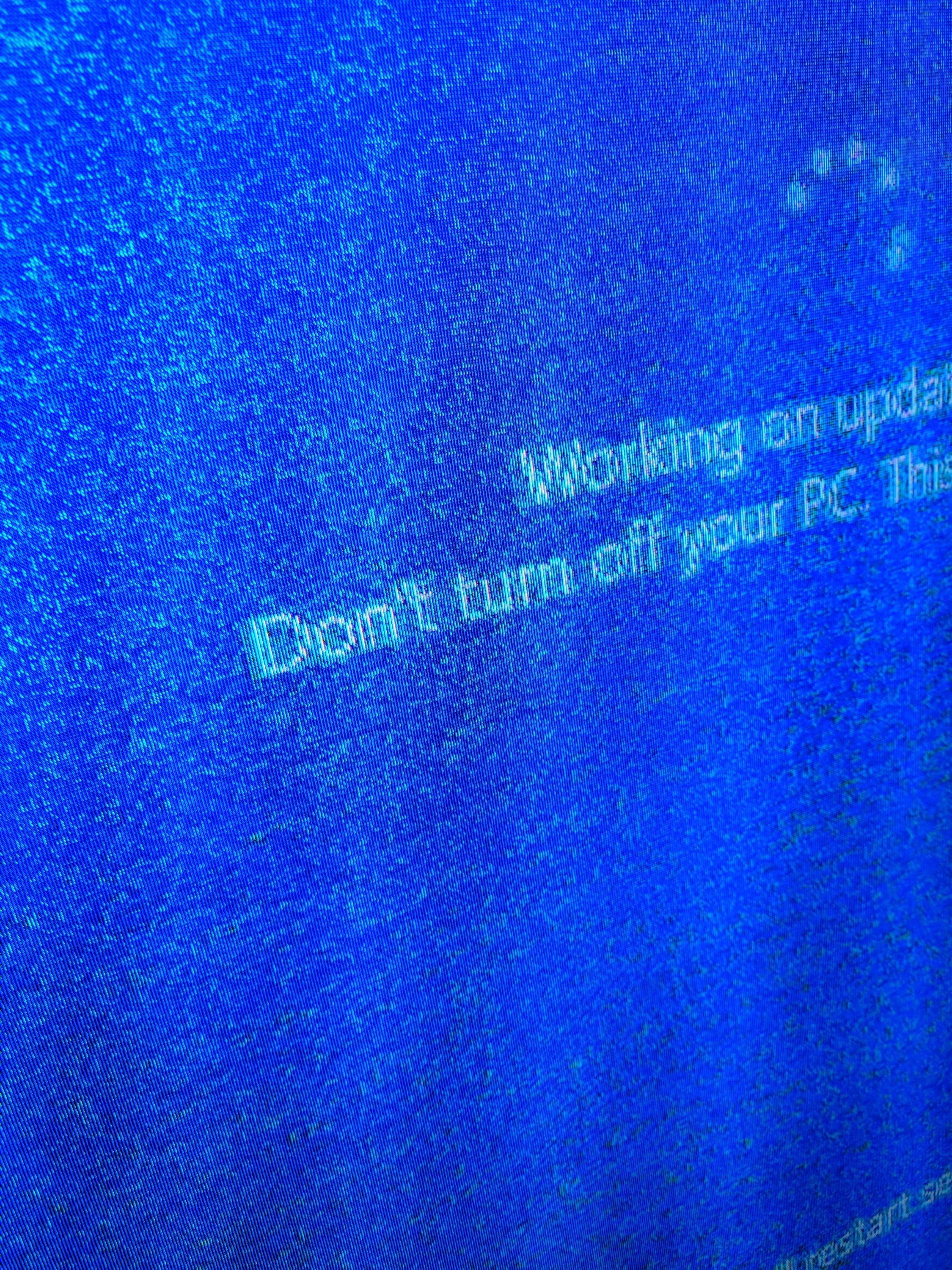

    Sanyo FW65D25T with blue pixel picture?
    I have a Sanyo FW65D25T that has a blue pixel screen. I have attached a piceture. Would this be a bad T-con? The TV takes a good 45 seconds to come on after pressing power on.

    Re: Sanyo FW65D25T with blue pixel picture?
    That looks like you should try cleaning and reseating LVDS cable to start. Also looks more like mainboard fault. Is this problem present through the whole screen and not just part of it?
      It's through the whole screen, Would it matter if the mainboard came from a different model tv? Cause it did, would I need the eeprom chip from old main board?
        How does the OSD or menu of the TV look like?
          It's the same, doesn't matter the input or menu. All is blue pixels.
            Then panel ID is different than OEM board so VESA, and lvds tx rx signals are different as well so mos likely you cannot just swap eeprom, as the design and format of the board is different. Possibly someone here knows how to access service menu so we can try to make some changes to how mainboard drives the panel if possible.
              Swapped eeprom chips and got it fixed!
                Nice! So mainboard must have been the same Just driving different panels
                  Yea was the same board number just came from a different brand tv.
                  I probably should have mentioned that before.
