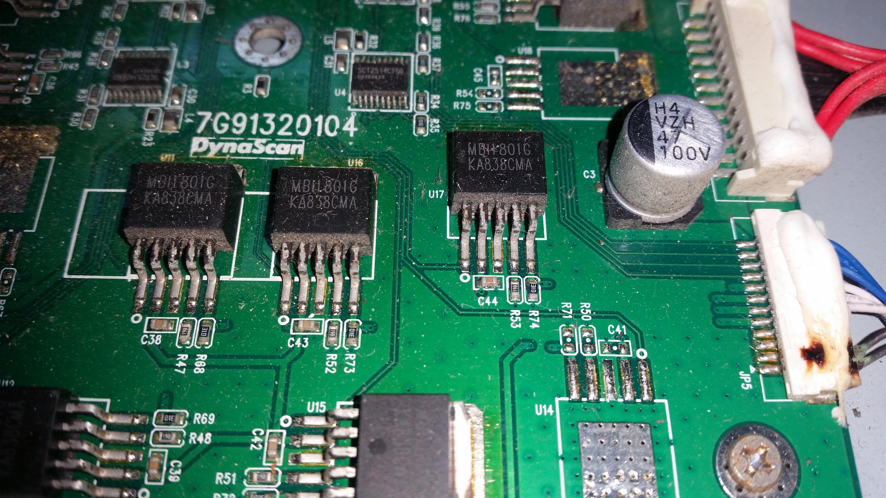

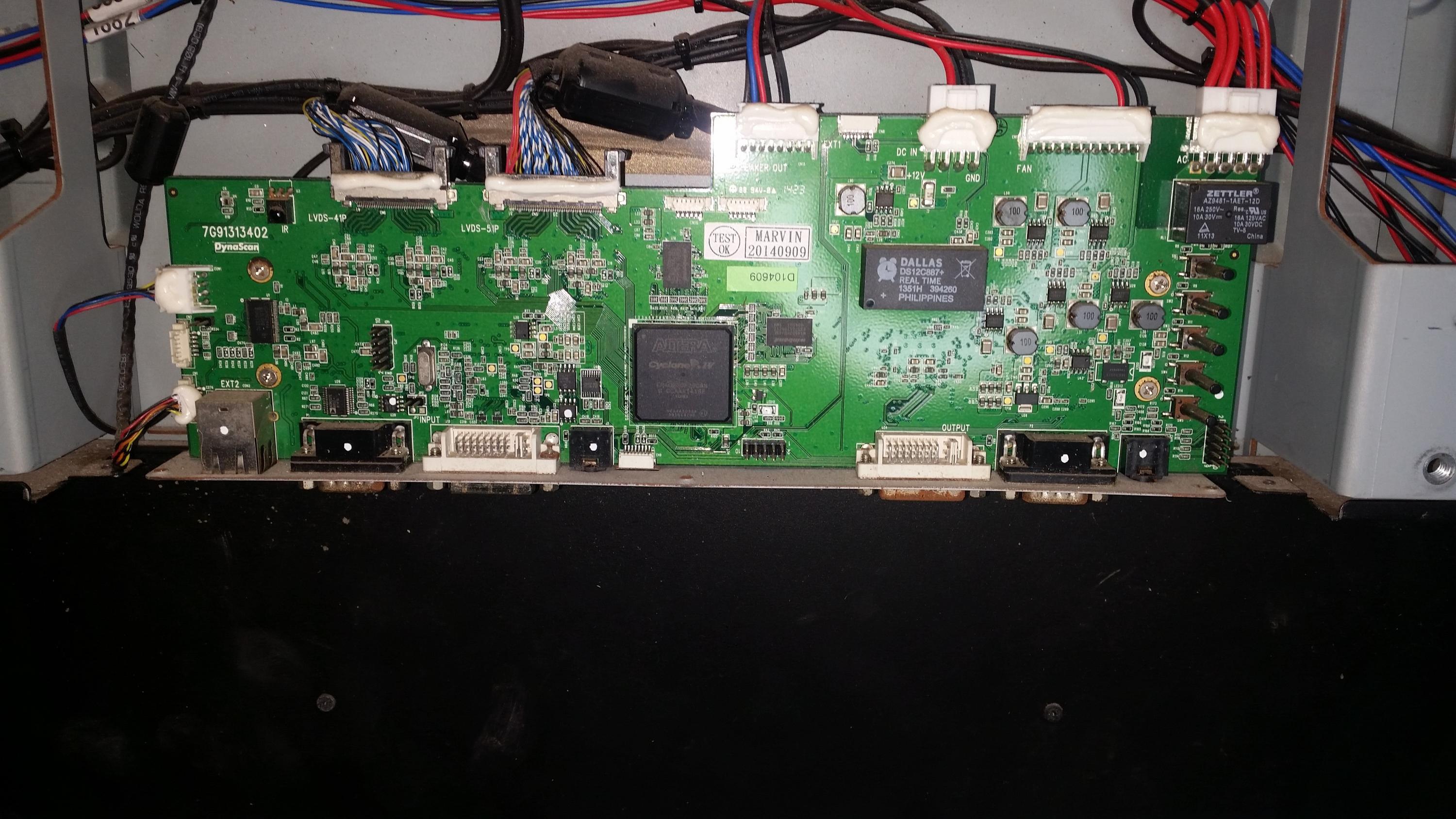

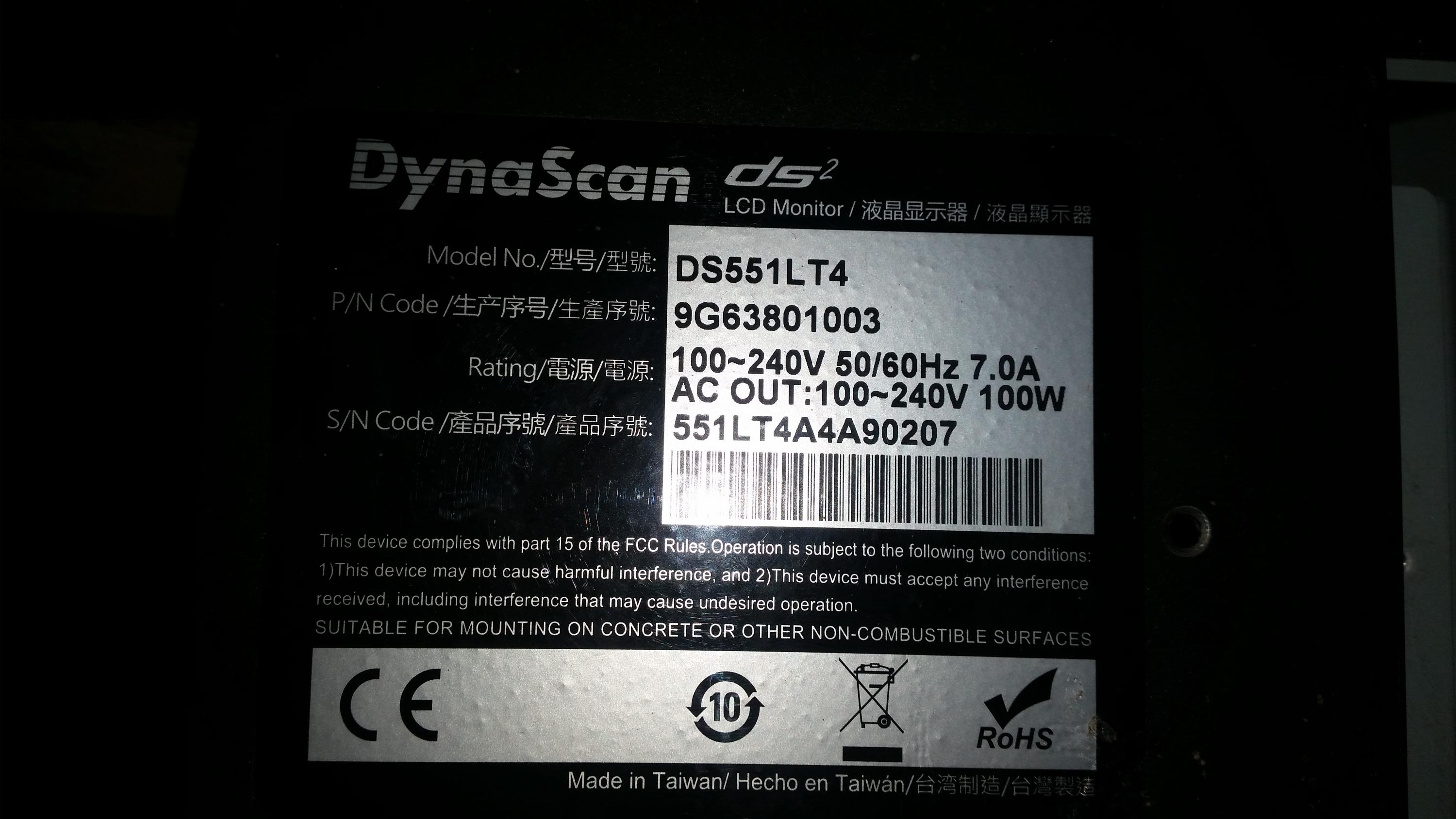

    OK so I have a Dynascan DS551LT4 on my bench
    http://www.dynascanusa.com/product/5...ezel-ds551lt4/
    Anyone here familiar with these? It powers up, I have 12V from the little smps supply, and LED the backlights are working.

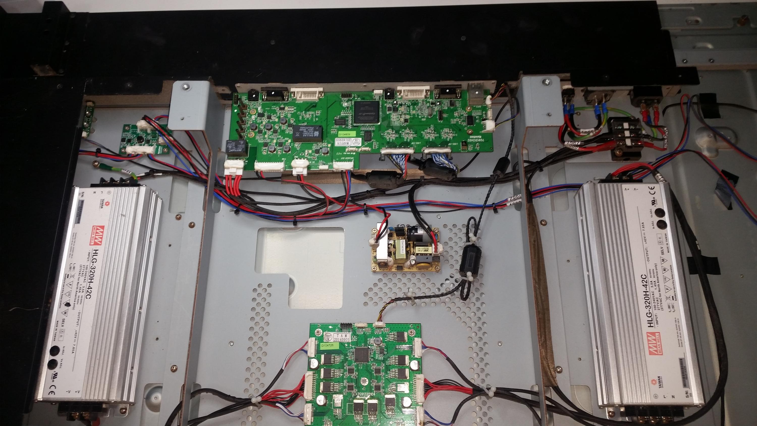

    It actually goes through a sequence of a green LED lighting on the logic board, then a green LEd flashes on the other board, then a red led flashes on the logic board, a relay clicks and the backlights come on. So it's not 'brain dead'.
    However I get no video, not even menu from the remote or the 'no signal' box. The hotel has two of these so I know the external hdmi converter box is working ok.

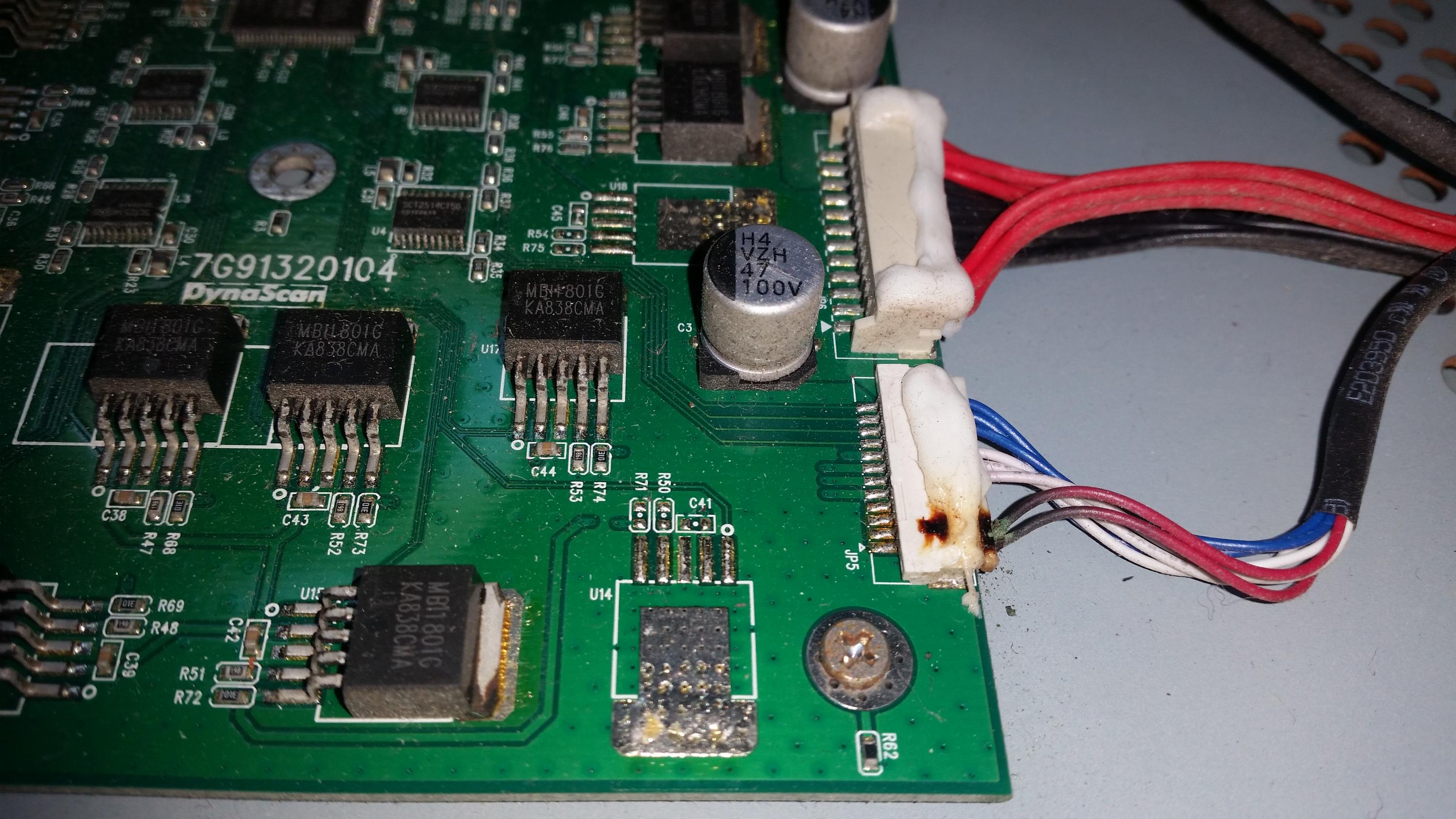

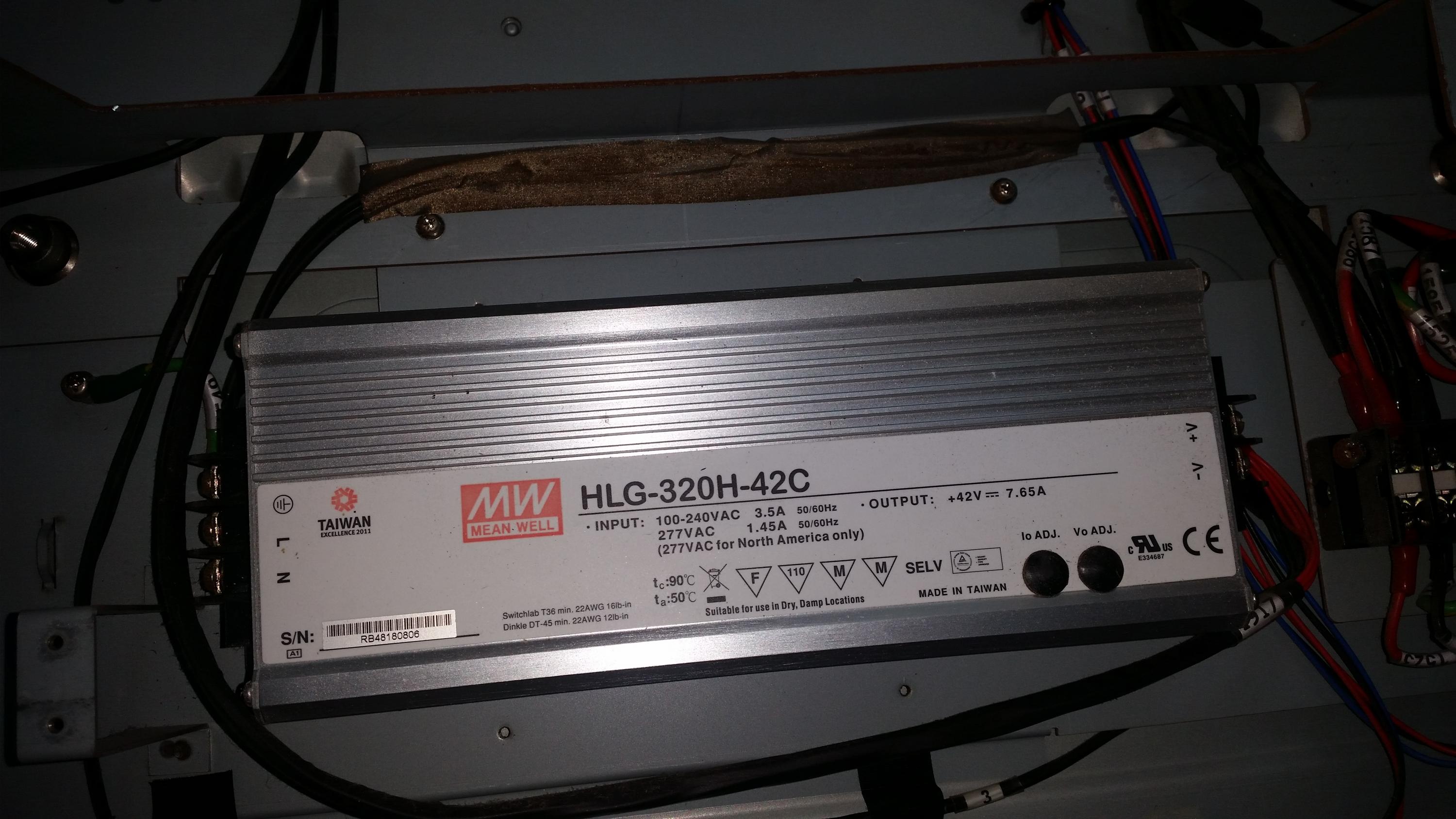

    Something has burnt out on a connector on one of the PCBs (the one where a green LED flashes once on power up) - but I don't know what this PCB does as I have not seen anything quite like this in LCD TVs. It looks more like a plasma X buffer or Y buffer board to me but this is LCD
    The two wires from the burnt out connector feed with some other wires into a cable and the other end of this cable disappears under the metal work at the corner of the LCD panel. There also looks to be a bad cap on he PCB near this burnt out connector. There seem to be similar cables going to other corners of the panel.

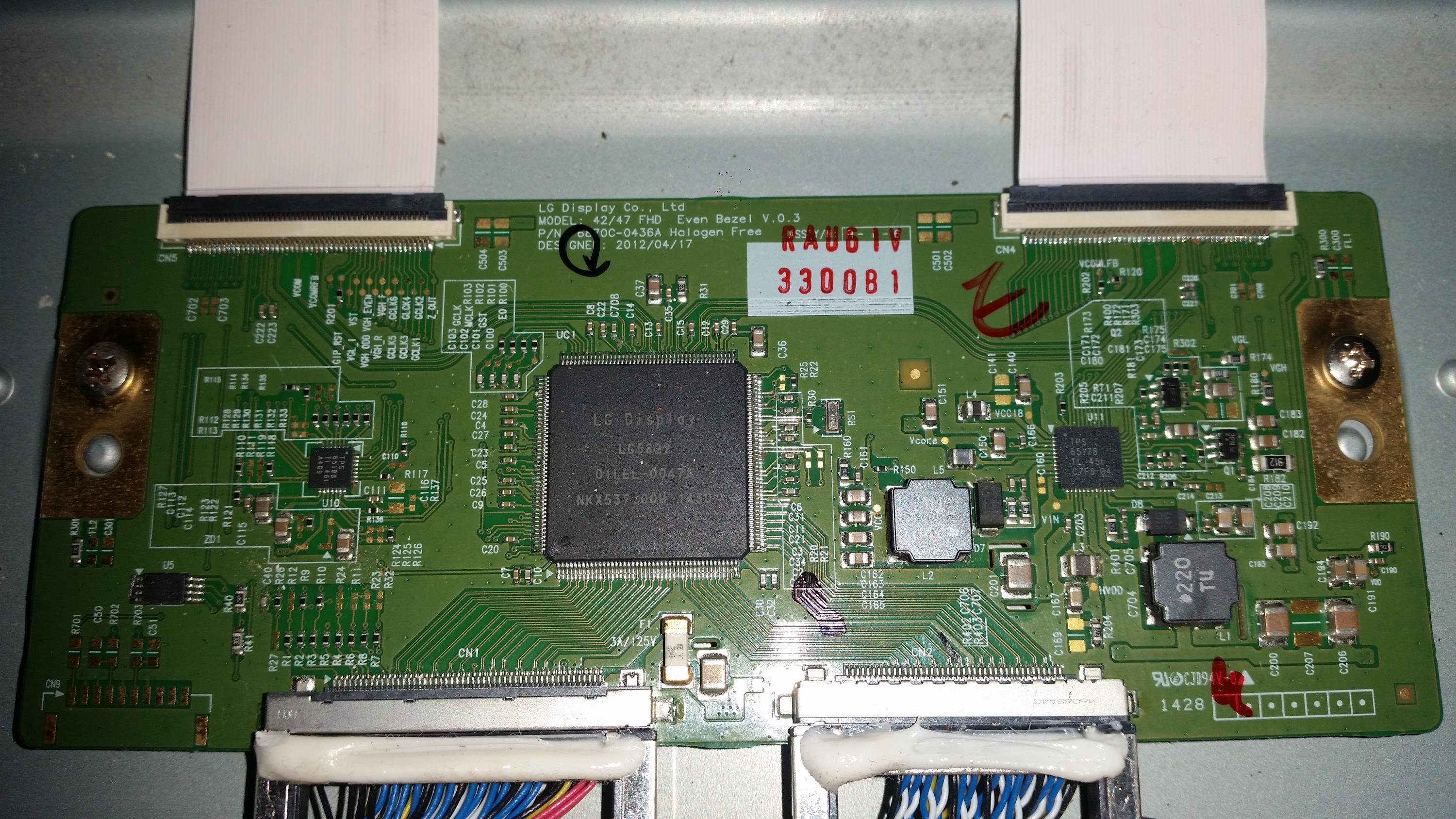

    There is another board maybe Tcon underneath the main logic board right at teh front of the panel, it's hard to see as it is partially obscured by metalwork.
    Please see pics and any advice welcomed, I'm a bit out of my experience with this one TBH.

    You need to fix the burnt wires first.

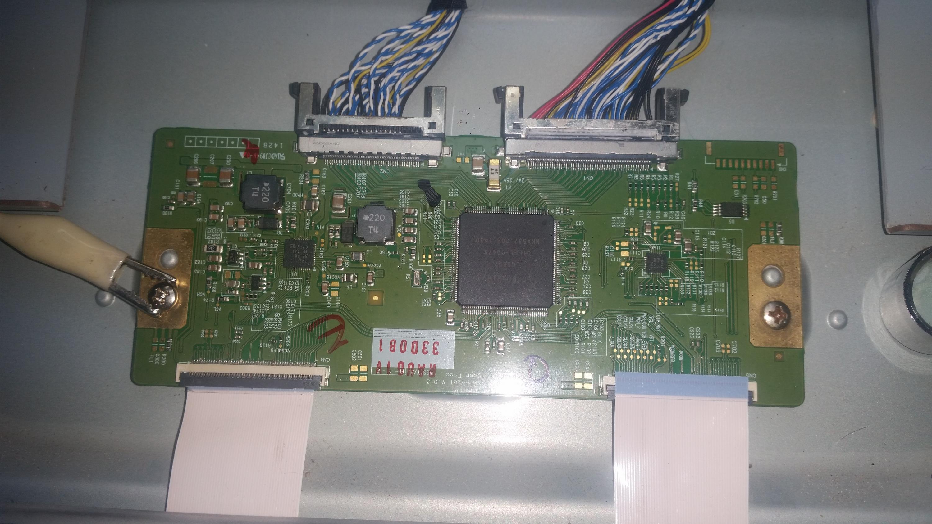

    Yes, the T-CON board is under the metal works, you need to find out if it is fuse on the TOCN board is good or not and if you do have 12V feeding the fuse or not.

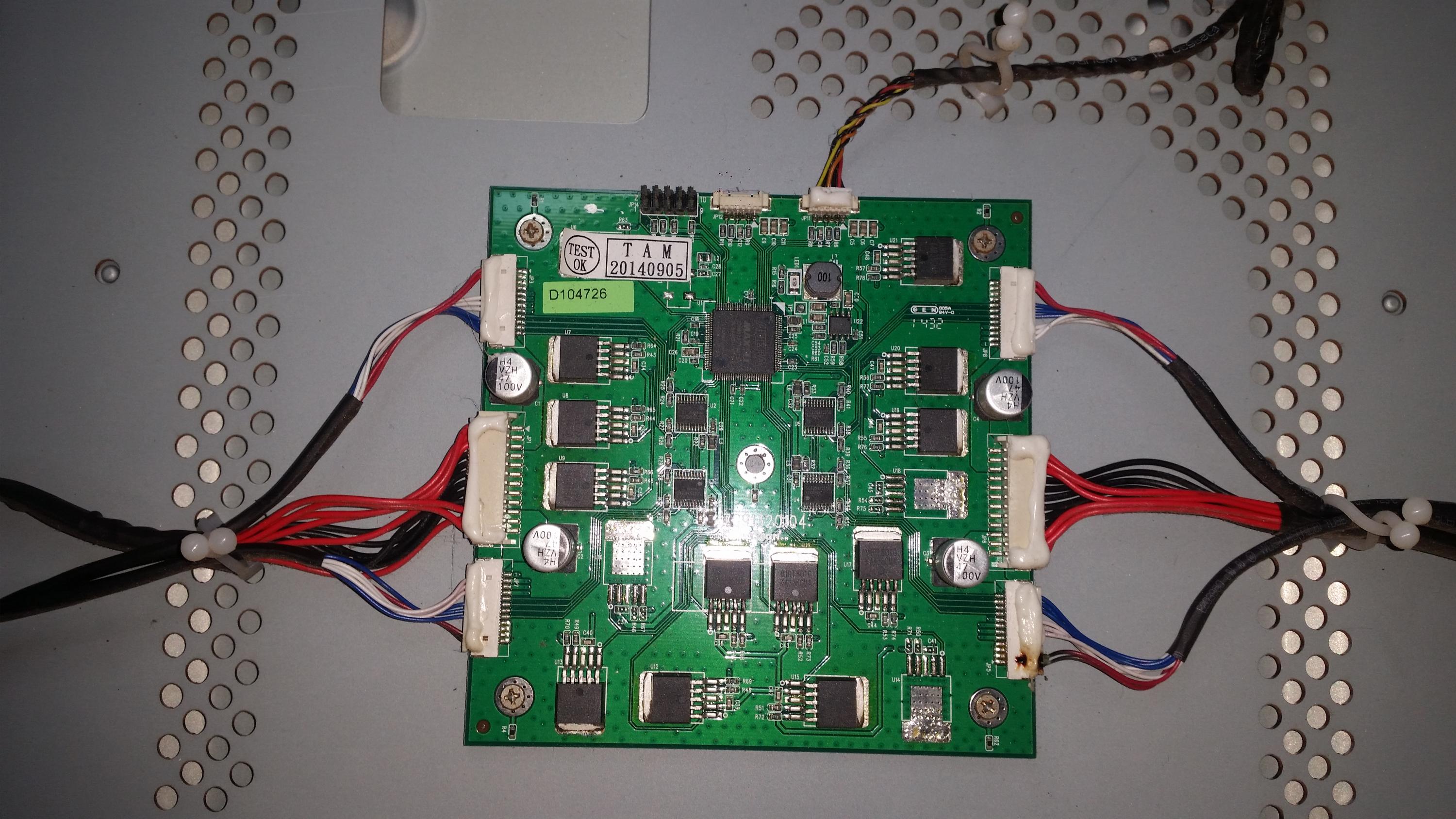

      Thanks Bud that's more stuff to strip down them. On further reflection that board with the burnt wires appears to be something to do with driving the LED backlights.

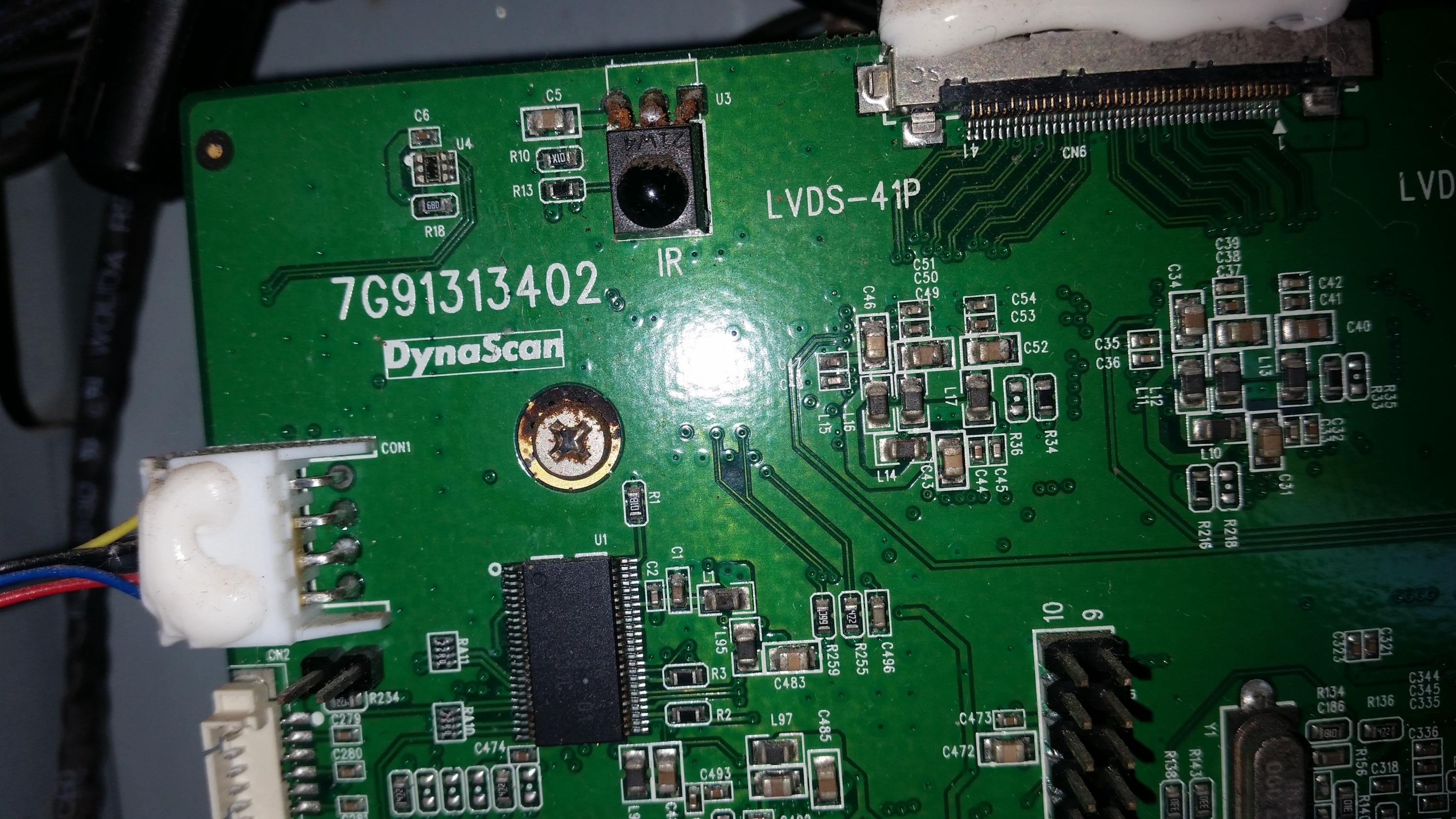

        I cannot tell from the pictures as to where the burnt red wires go to, the picture is cut off.
          Re: Cynascan DS551LT4 backlights working but no video or menu
          https://www.badcaps.net/forum/attach...0&d=1513106807
          I see two LVDS cables,you should check for 12V on those red wires of the LVDS51P , they should be for switched 12VDC that feeds the T-CON board.

            Didn't fix the burnt wires just yet but I removed a load more metalwork and checked F1 on the TCON board. It is intact and has 11.56V on it

              TCON board

                Next test is to have one ribbon cable between T-CON and LCD panel connected one a time to see if you will get image on half of the screen.

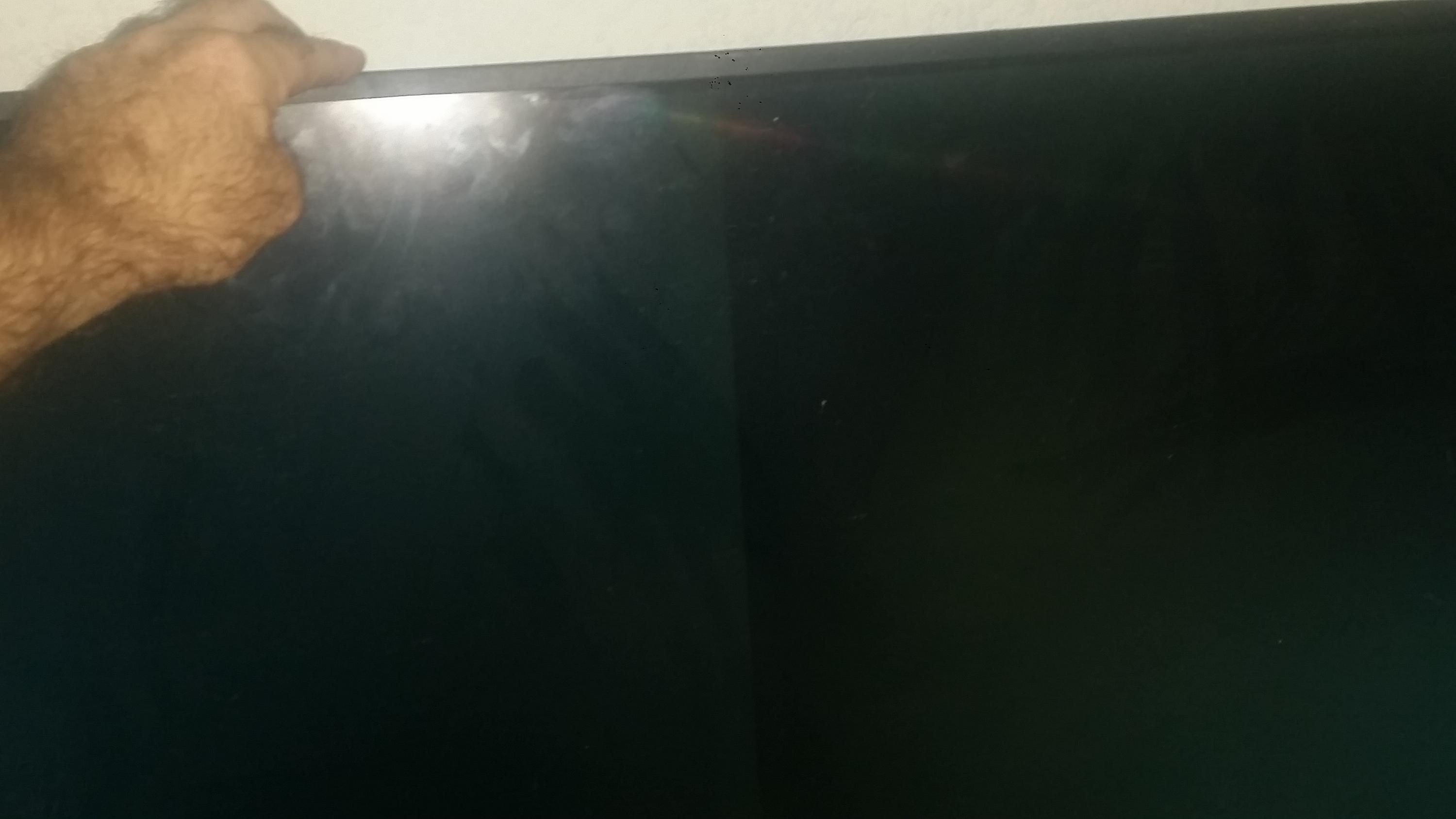

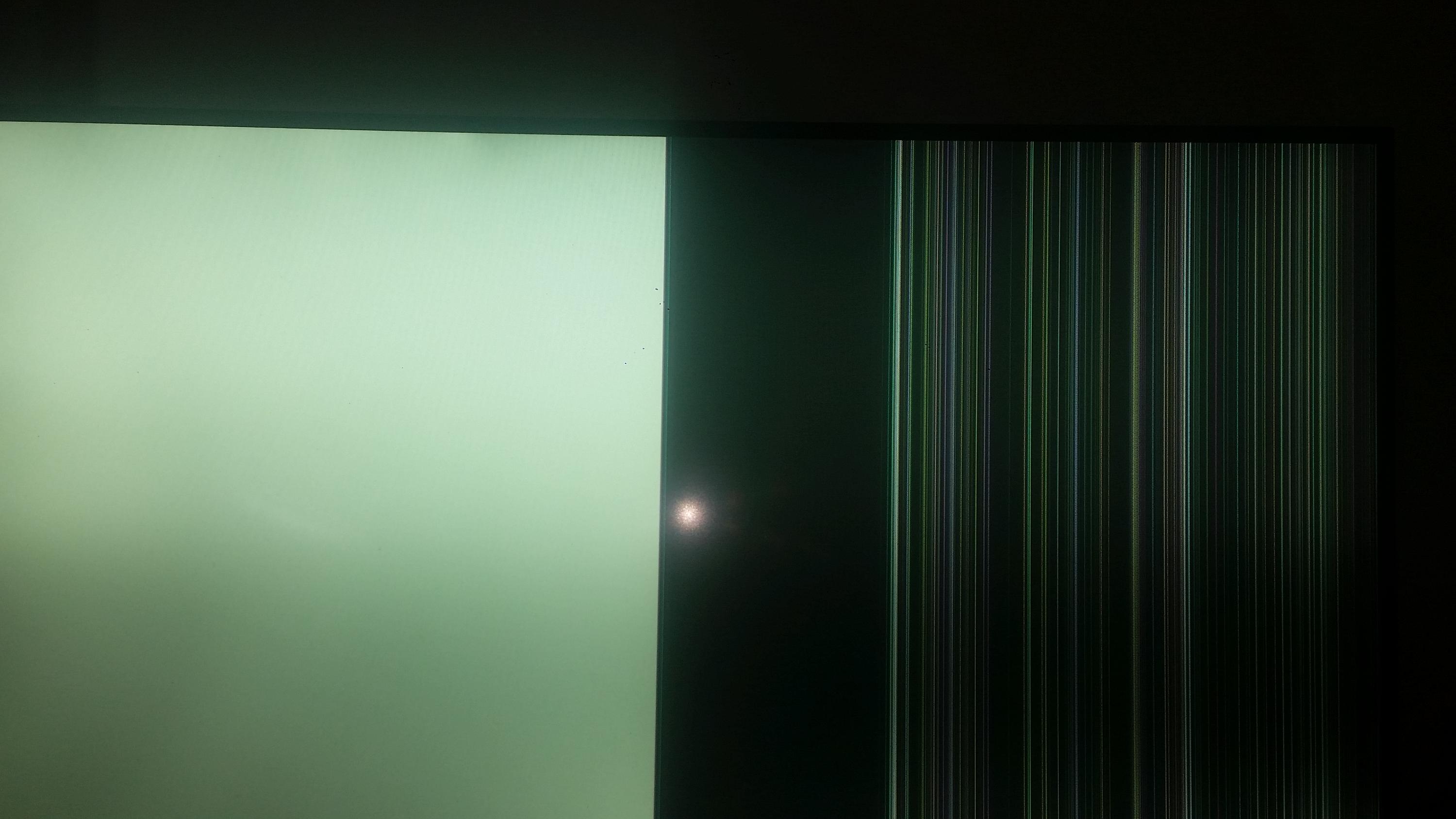

                  With one cable diconnected (the left hand one looking at the screen from the front) I get a plain screen, one half slightly brighter than the other, though I tried this a few times and am fairly sure a least one time I got the whole screen evenly and brightly lit white
                  With just the other cable disconnected I get one side bright plain white and vertical stripes on the other.
                  I didn't see any video when I connected a hdmi-dvi adapter and a video source.
                  Even with no video input I should see a blue box on the screen saying 'no signal' as that is what the other one does at the hotel

                      That board with the burnt out connector - must be the dimming control for the backlights as it has connectors from the two big 42V 7.65A supplies, and a cable running to each corner of the panel where it vanishes under the metalwork. The only other connector on it is a 6 pin lead from the mainboard. The big 42V supplies don't connet to anything else so this is the LED driver.
                      The two burnt out connections, though they look bad they actually check out for continuity OK. So that is not the problem. I will of course fix them if I get the screen working.

                        I see some Voltage test points on the T-CON that you should check:
                        Vin
                        Vcore
                        VGH
                        VGL
                        VCC18 (1.8V)
                        HVDD

                            Vin 11.53V
                            Vcc 3.319V
                            VGH (Odd/Even/R/F) all -5.01V
                            Vcc18 1.8V
                            HVDD 0.862V
                            and I spotted another test point VCOMLFB -0.130V

                                  I disconnected the tcon cables in turn
                                  When I remove this one (see pic) I get a bright white background on the same side half of the screen and vertical lines on the opposite side half but HVDD goes to 8.25V
                                  So something on the panel or the PCB at the bottom edge of the panel is dragging HVDD down
                                  I still don't get any video on the screen
