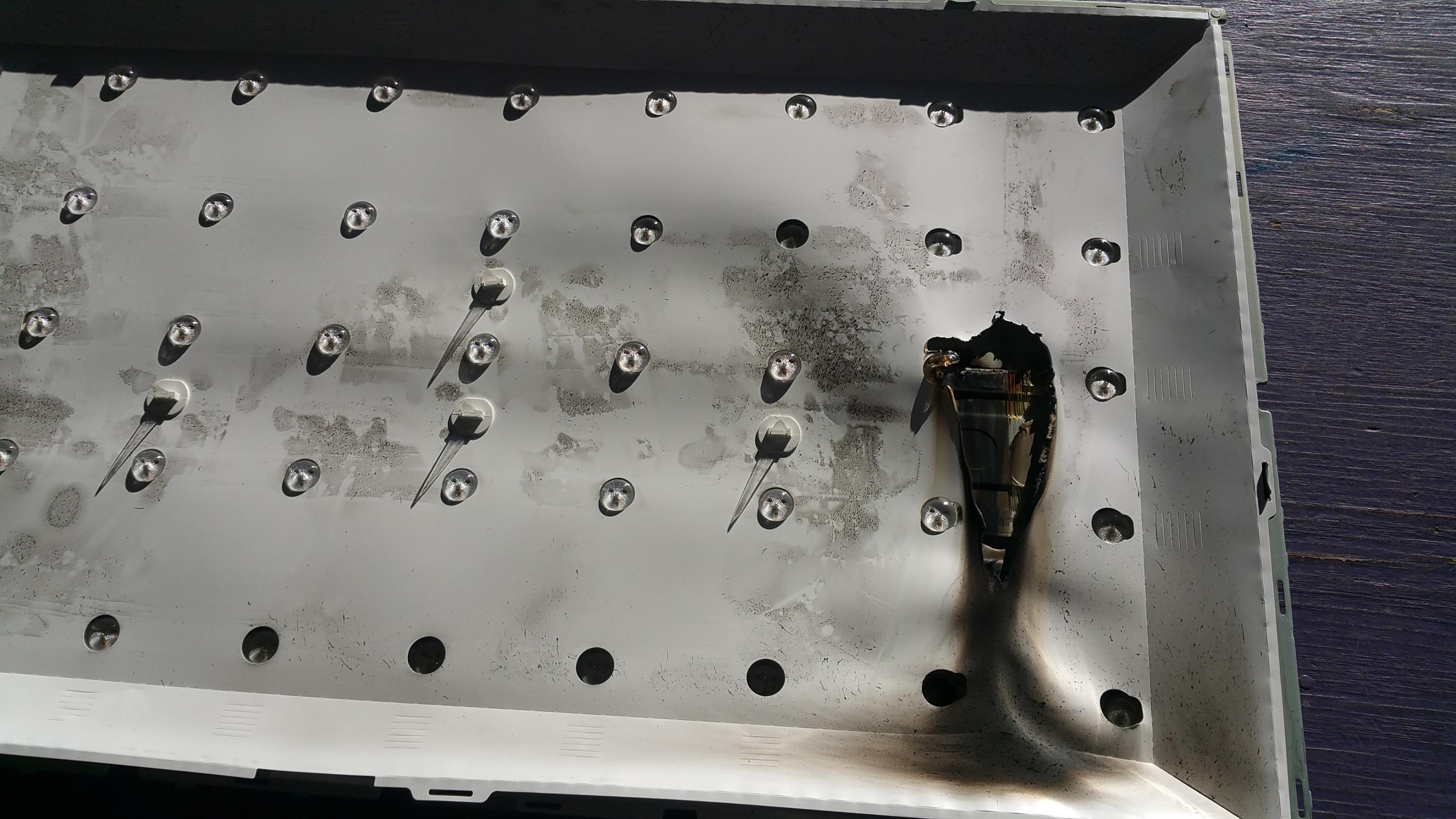

    Samsung Hospitality HG32NB690PF No Backlight
    Not sure, but I think an LED Strip went bad....
  • Andrew F. Ali
    • Jan 2014
    • 2450
    • Trinidad & Tobago
    Re: Samsung Hospitality HG32NB690PF No Backlight
    My goodness...luckily that TV didn't burn the place down....Anyway, do you have a backlight tester or are you checking each LED separately? Is the LED Driver producing the correct voltage to power the backlights? I would recommend replacing all the strips instead of replacing individual LEDs on the strips. With that kind of damage I would think the other LEDs took quite a lot of strain and would fail sooner rather than later.
    • freakaftr8
      • Oct 2012
      • 3743
      Seen this before. Last year. Samsung 40 inch led.
