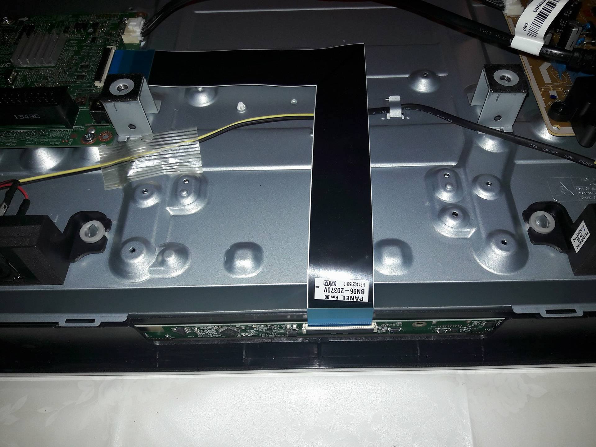

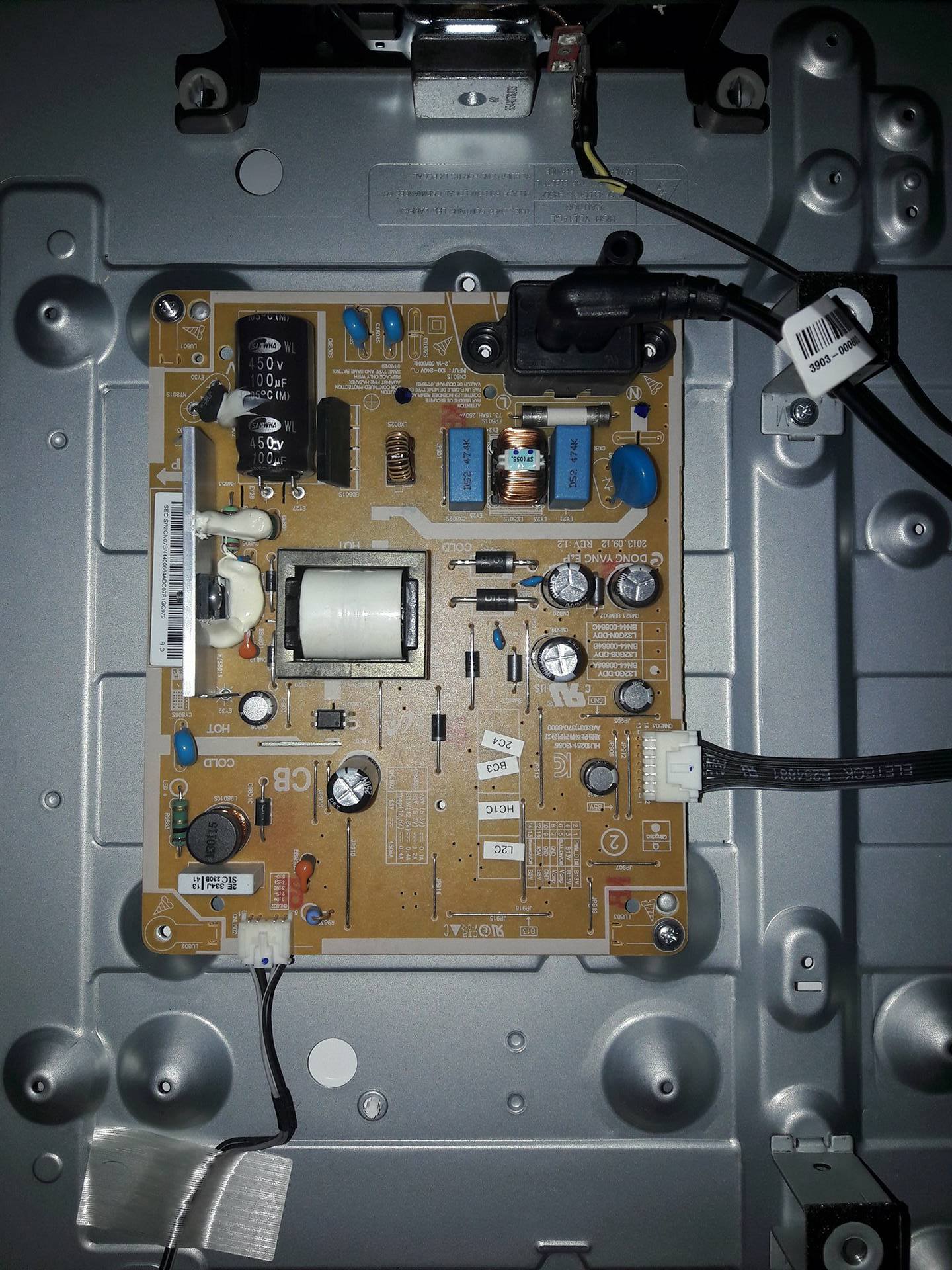

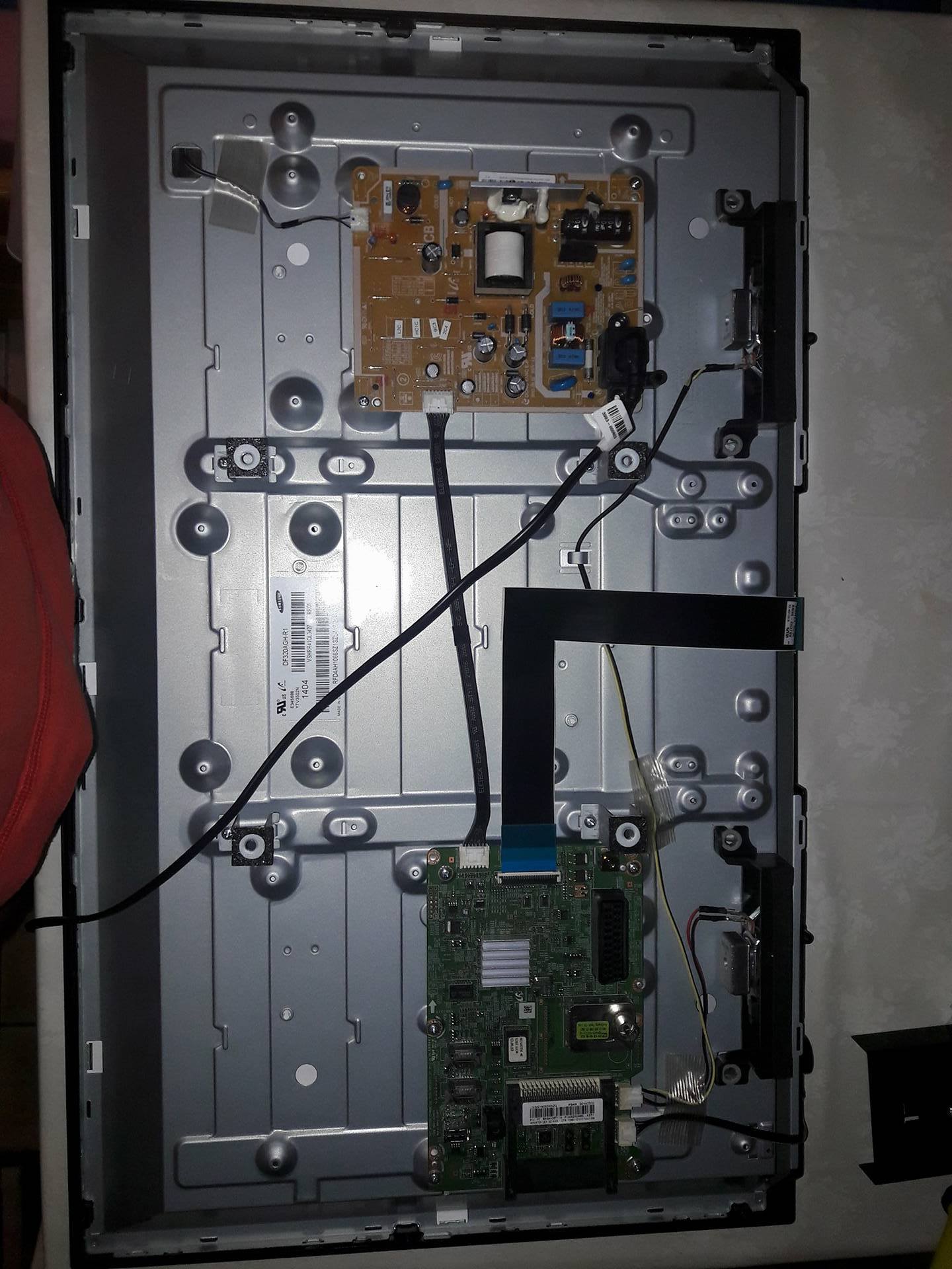

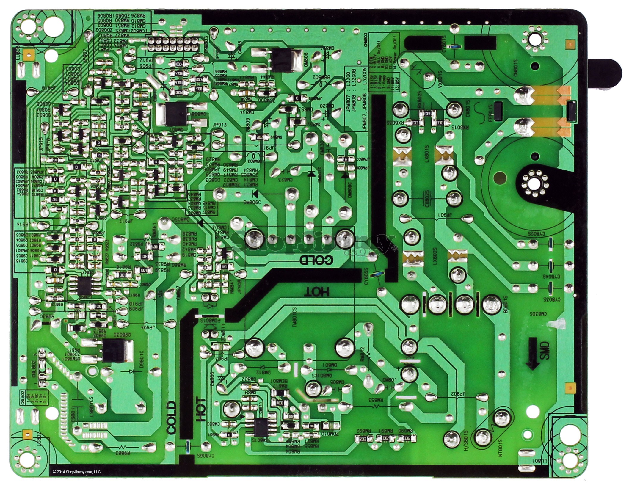

    I have sound but no backlight, I put the led of my smartphone in the front of the Tv and I imagine on the tv so T-con it's fine and also I checked with 12V the led for the backlight and they are fine. I checked the voltage, the cable which goes to the main board, I have 5.2 on the pins and 0 on the other 5 pins. The cable which goes to the backlight has really small voltage 0.03.
    I need some suggestions, either the power supply or main board but I don't know what to check the discovered where is exactly the problem.

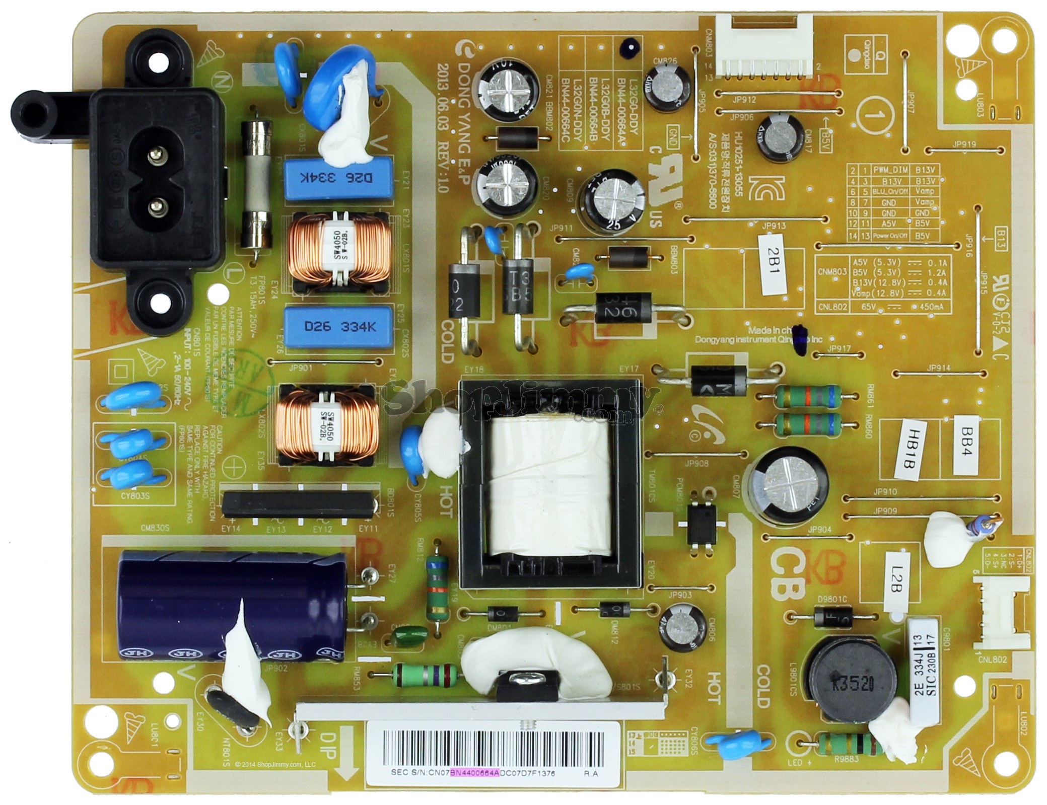

                  Re: Samsung UE32UH4003
                  The power supply/LED driver board board is BN44-00664A.
                  All the boards connected then check the DC Voltage between GND and the the Cathode of DM805C. If you get no Voltage then you need to resolder all the pins of that power transformer TM801CS.

                    I think my multimeter sucks, I changed from auto range to mV and I measured high voltage, now If I measured the voltage over 30V my Voltcraft 830 shows me "warning", in the manual of the multimer when that pops up there is a mistake with the lines. I suppose I blow up the fuse for low voltage.
                    I tested with another multimeter much cheaper and I have voltage.
                    DM805C AND TM801CS tested and I constantly have 180 V.
                    I tested the pins which go to backlight and there I have:
                    1 D+ 180V
                    2 S- 0.323 V
                    3 NC
                    4 S- 0.331
                    5 D+ 01.9 mV
                    When I touched pin 1 with 2 the tv works, I really haven't got what could be broken in that case.

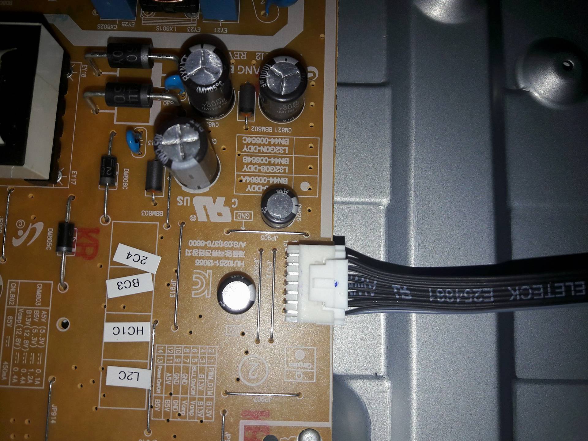

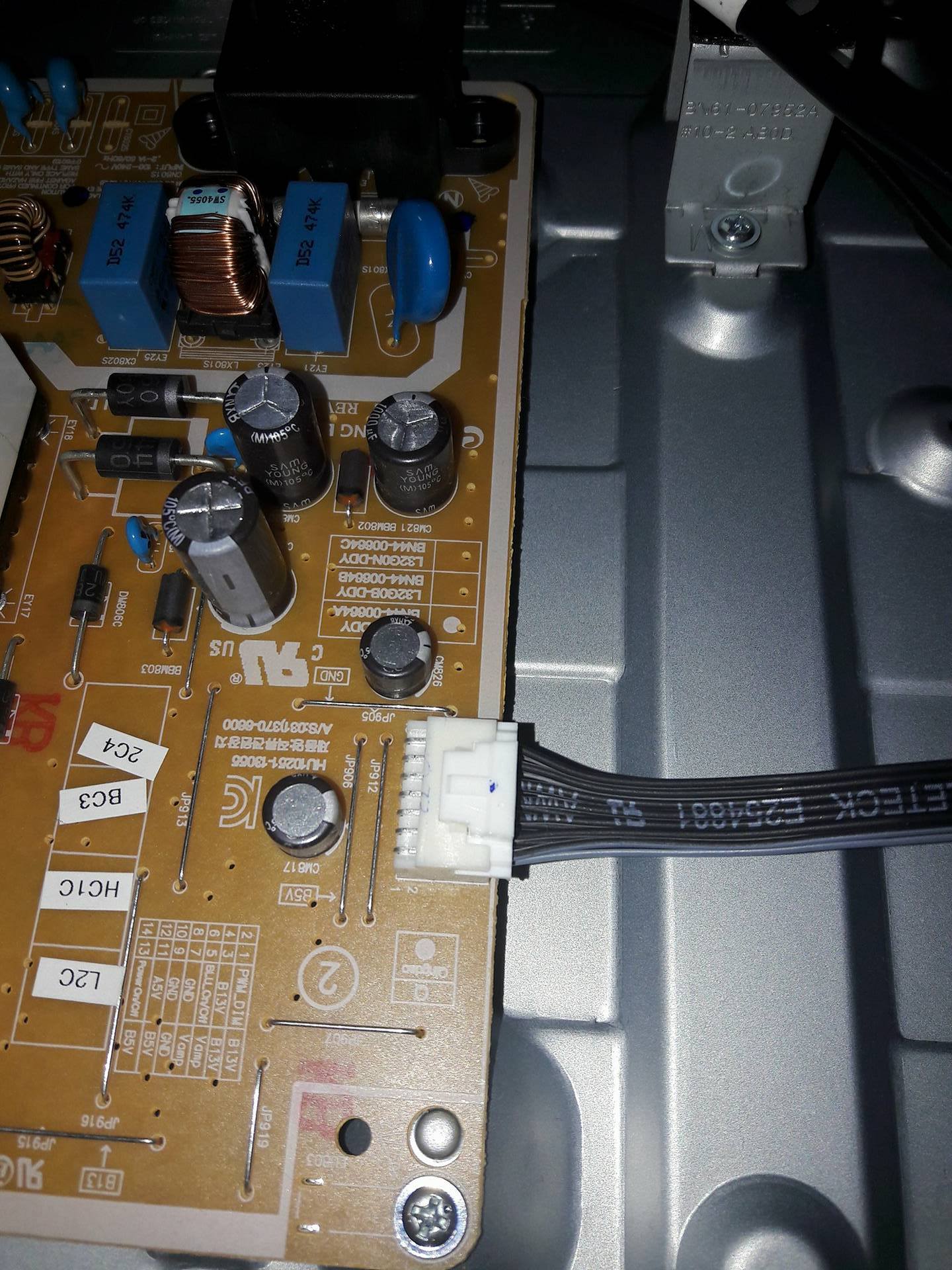

                      Hello claudiuandrei2010,
                      Can you please check the voltages of the connector as shown in your modified picture below:
                      You need to check and record the voltages with the connector connected, and also with it disconnected.
                      EDIT:
                      Could you please also check the components marked in the two modified pictures below:
                      Check for shorts, as well as a punch-through test on the diode.
                      Please let us know your results.
                      Regards,
                      Relayer
                      Last edited by Relayer; 11-29-2017, 05:31 PM. Reason: Additional Information Added
                        1 D+ 180V
                        2 S- 0.323 V
                        3 NC
                        4 S- 0.331
                        5 D+ 01.9 mV
                        You have open circuit in the LED string, that is why it went up to 180V! and S- (the Cathode of the first LED string) only shows 0.323V.
                        "When I touched pin 1 with 2 the tv works" do not do that again or you will damage the second LED string.
