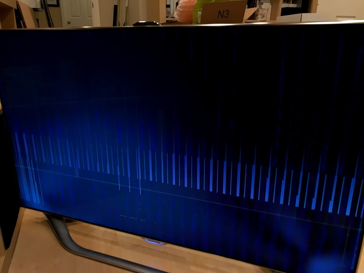

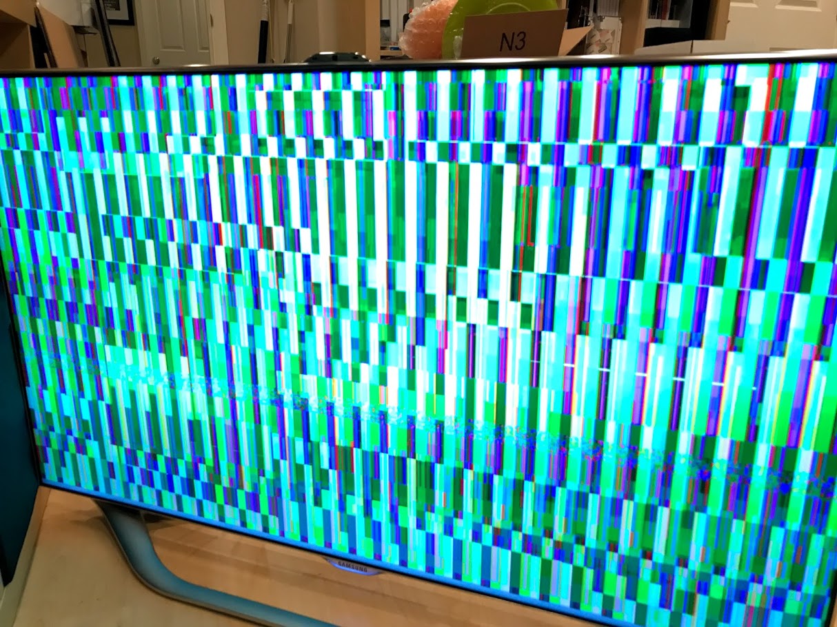

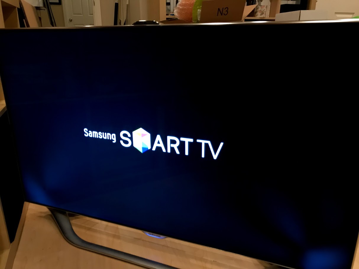

    I picked up a Samsung UN46ES8000 today. All the caps appear to be fine, but the unit powers up and displays a funky pattern, then it turns off and rinse and repeat.

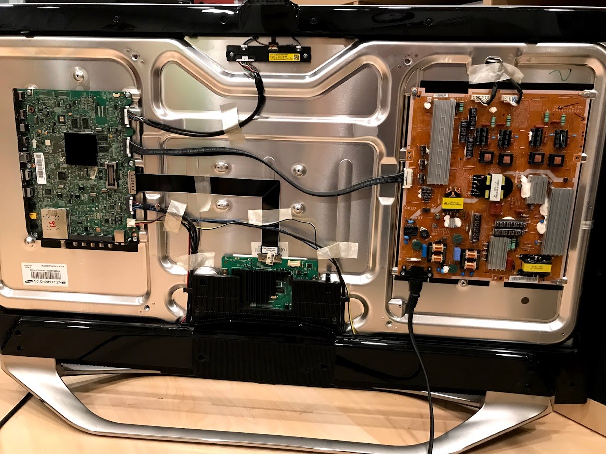

    I looked at it closely. It appears the two 5V pins on the power board side are burnt on the 20pin ribbon cable on pin 17 and pin 19(See pics). On the power board side, it measures 5.12V, on the main board side it's closer to 5.0V. 100mV of drop across this cable was enough to cause the TV to turn off.
    I ended up cleaning the cable pins and the power board pins to remove any corrosion. I also ended up rotating the cable 180 degrees which connects these two pins on pins 1 and 3 -- these are low current pins (PS_ON and BL_ON).
    If needed, eBay sells this cable for ~$30.
    Alternatively, if this problem shows up again down the line, i'll just solder the 5V ribbon cable leads directly to the 5V pins on the power board.

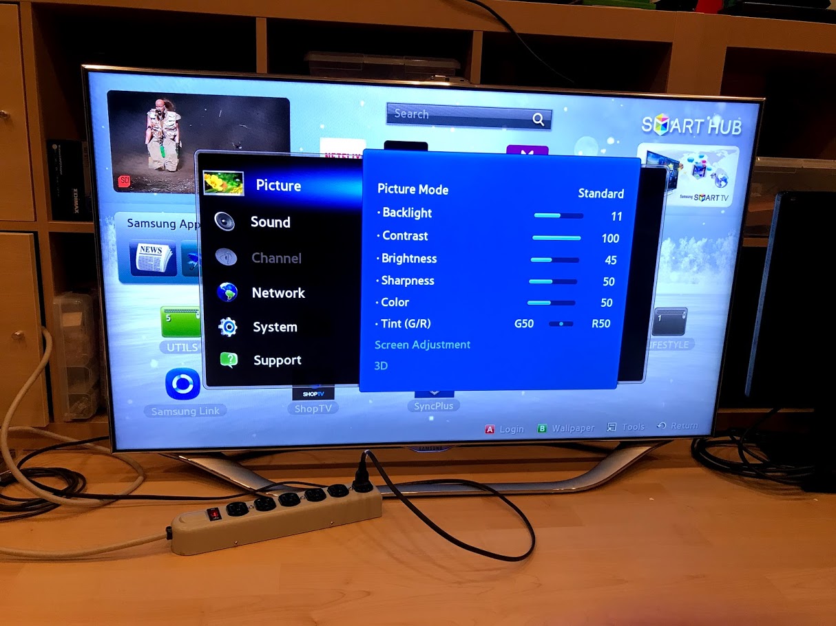

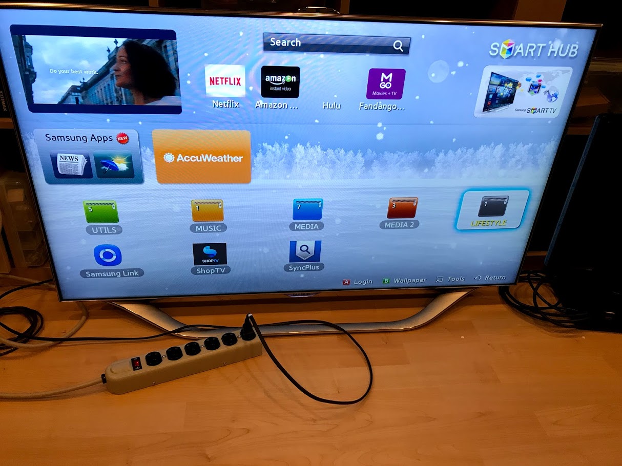

    I now have a TV that was $2699.00 MSRP in 2012 for free. And it only took 15 minutes of investigation.
    Time for hours of burn in testing!

          6 month update: I still own this TV and it works great. It's used as our picture album TV above the fire place.
