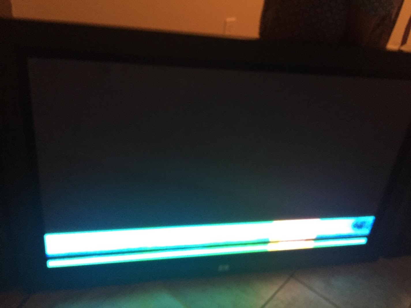

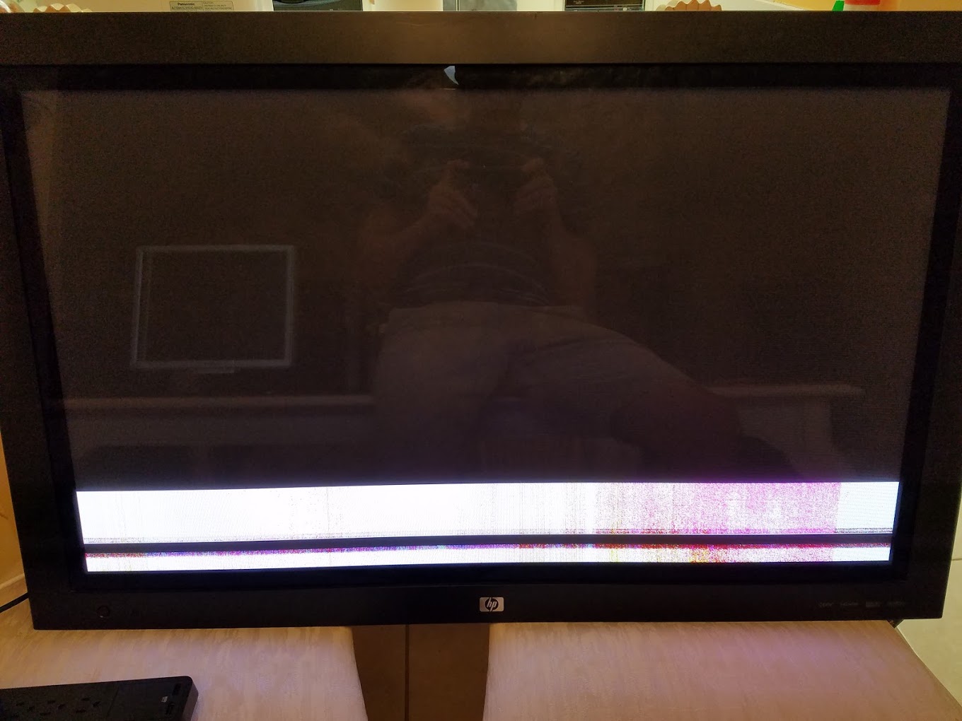

Don't have much experience with plasmas, please estimate chances of this to be repaired.
HP PL4260N worth looking at? (photo inside)
Re: HP PL4260N worth looking at? (photo inside)
Upper or lower buffer Bd? I would look at both Bds. and probably replace them. If you work the TV too long in that condition you may burn out and damage the Y-SUS Bd.Comment
I would replace the single Y-buffer Bd. if the replacement Bd. is affordable.Comment

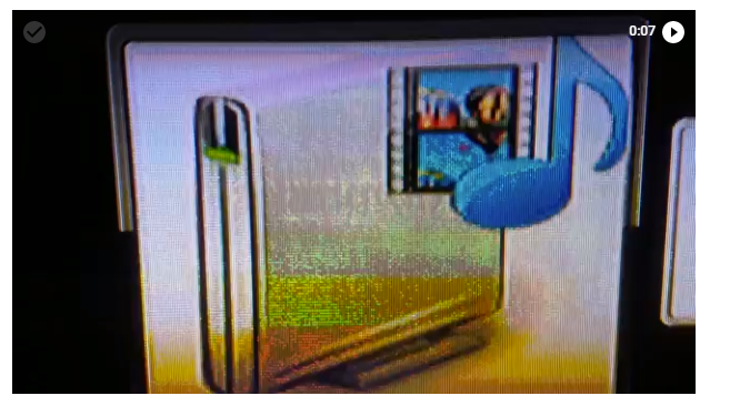

Well not completely fixed.
I now noticed fuzzy red-greenish color spikes (starts after ~20 minutes, mostly on white parts of the image)
See video and pic attached
https://photos.app.goo.gl/TZb6VJFiNDgyFsMx2
Should I check caps on the power board or this is some known plasma specific problem?

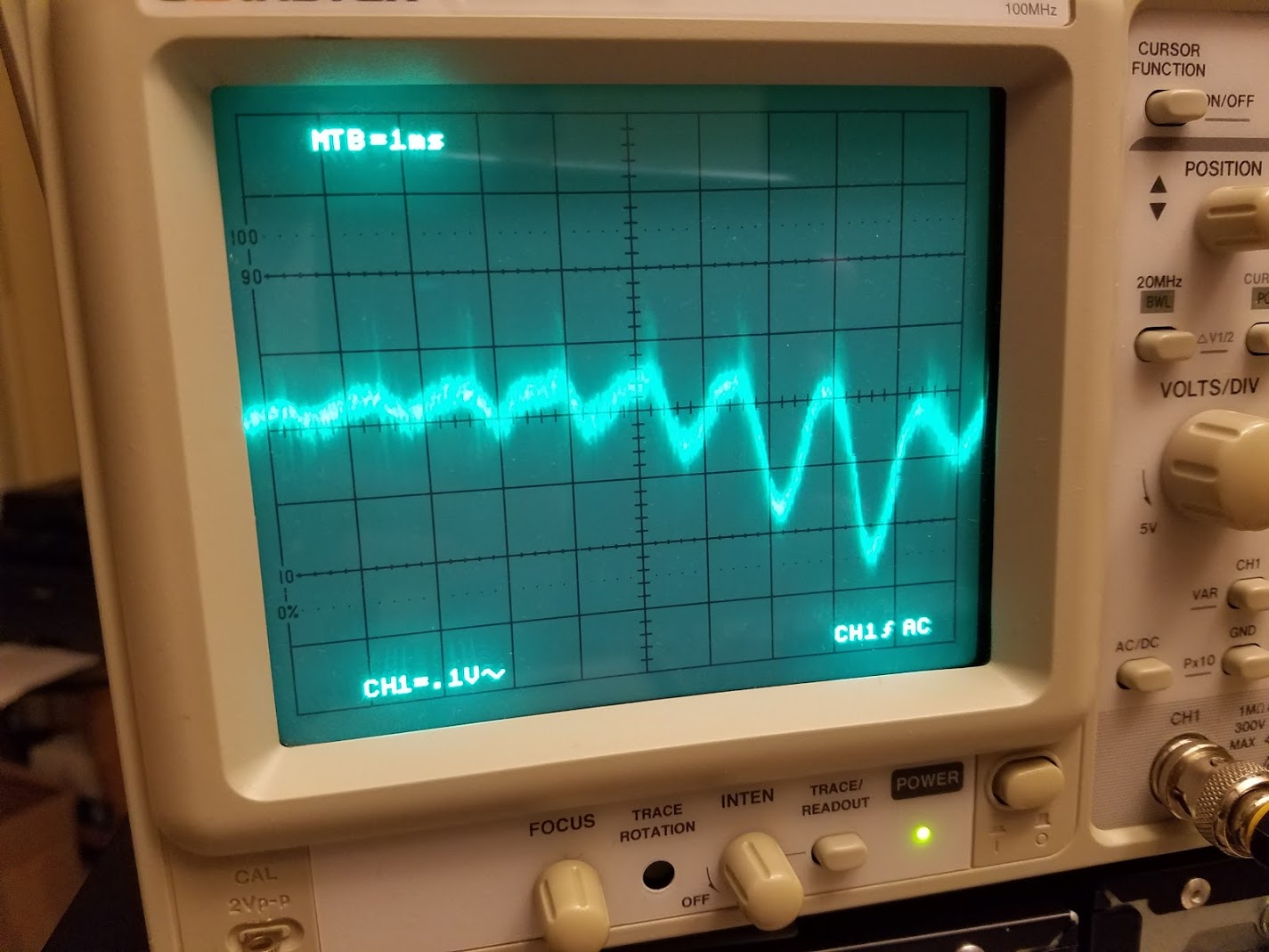

Checked Vs with a scope and ripple level is at maximum 3-4v, varies on the picture
Vs is 188v so it is around 2%
And it does not change over time. so I guess this is OK.

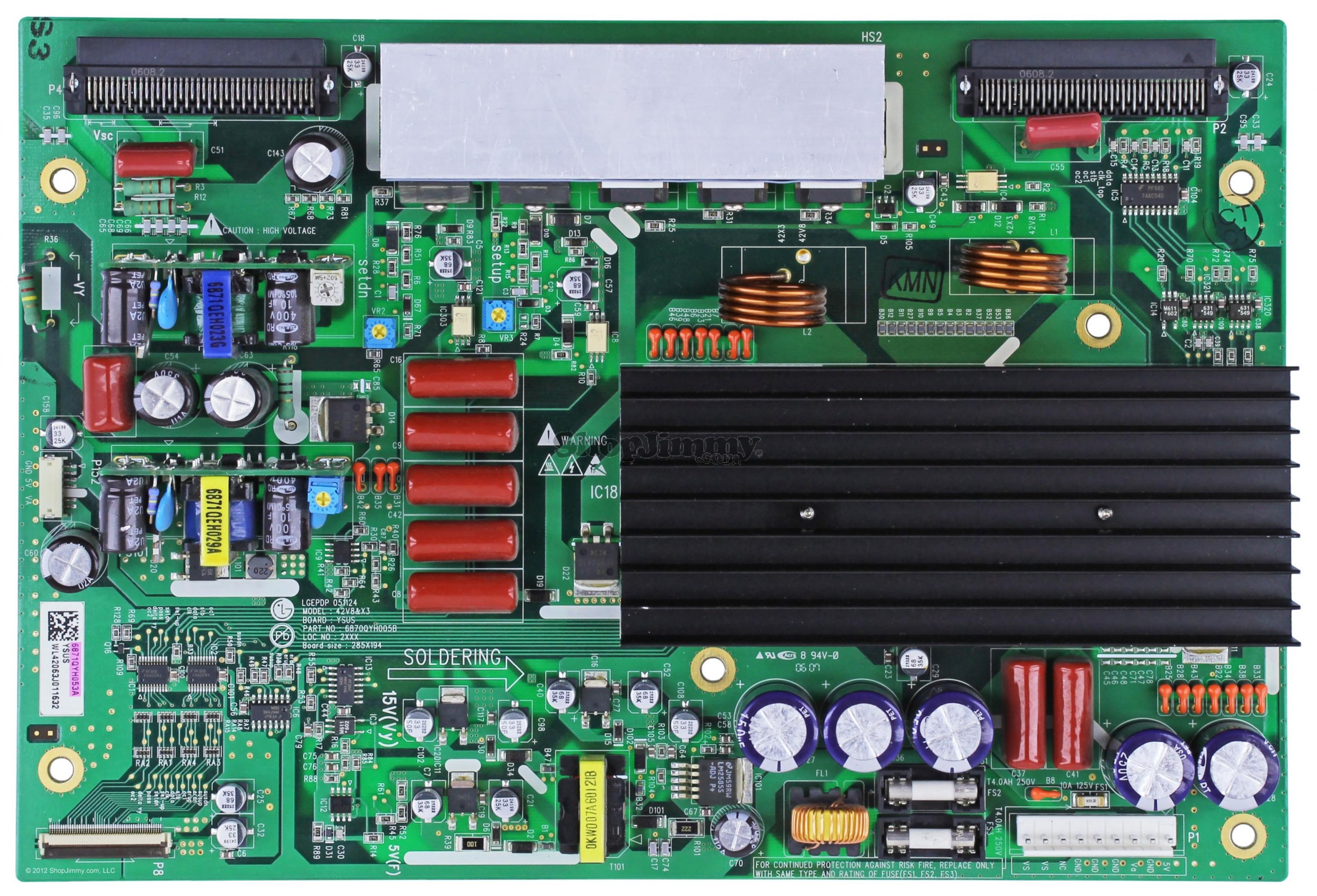

Can't find any test points on the Y-sus board (attached)Comment

The colour fuzz is caused by panel ageing, it is known as maldischarge.
There is a firmware update available for the control board which updates the drive waveforms which can resolve this problem.
The problem is LG did not get the compensation correct for the panel so over time the panel drifts faster than the control board can compensate.
You can try by adjusting Vs down by 10V, and Vsc down by 10V, and Vset-up and Vset-down, to get an acceptable picture, but the only true fix is a firmware update.Please do not PM me with questions! Questions via PM will not be answered. Post on the forums instead!
Thanks!
Lowering Vsc and Vs did the trick!
I did not adjust Vset-up and Vset-dn though, I was not sure what to look at and the picture looked ok.
