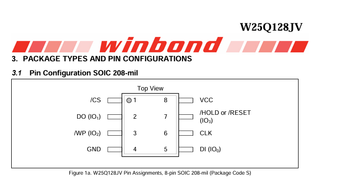

    Hi everyone
    Somebody has a photo of the correct order of this resistances?
    I made a mistake and moved 2 resistances, I put them like I guess they goes but I'm not sure and not boardview or schematic is available

    Based on the 25Q128JVSQ flash to the right side of these parts, very likely the resistors are there to stop ringing noise on the communication SPI bus lines.
    Remove all power. Meter in resistance mode. Measure the resistance across the contacts of each of these resistors that are unknown. What are their values in ohms?
    Meter in diode mode. Touch your meter probes together and you should hear a tone beep. Touch one of the resistor pads with one meter probe - keep it fixed; hunt for the other side of the trace with the other meter probe on each pin on the flash IC. Test each pin till you hear a tone beep.
    Make a table of each pad to IC connection and post the list here.
    Guessing that the resistors will be 22 - 33 ohms each and they are applied onto the signal lines to dampen the ringing noise.
