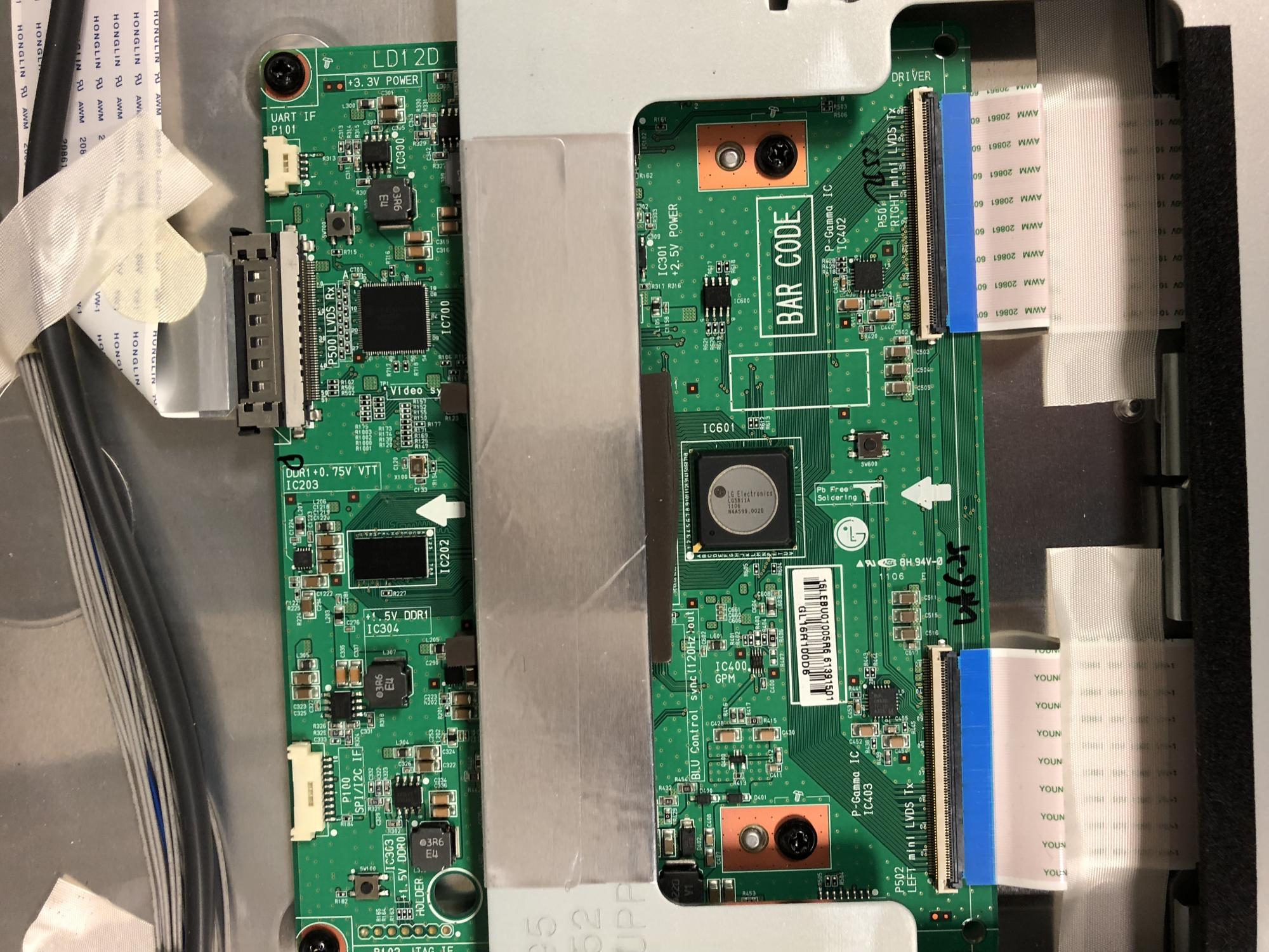

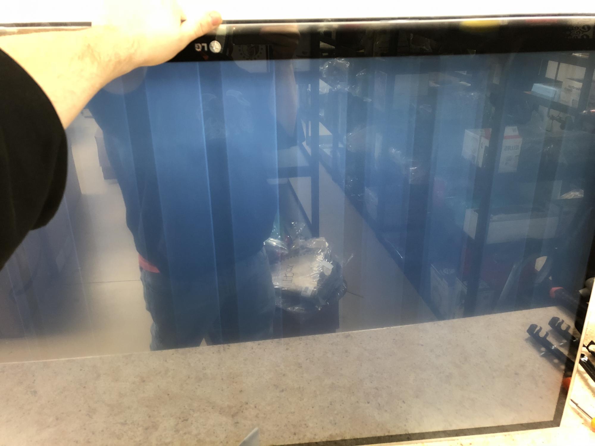

    LG 55LV9500 no picture wide vertical lines
    Started doing this intermittently until the TV would be on for a few minutes then picture would display. Now it just looks like this regardless.

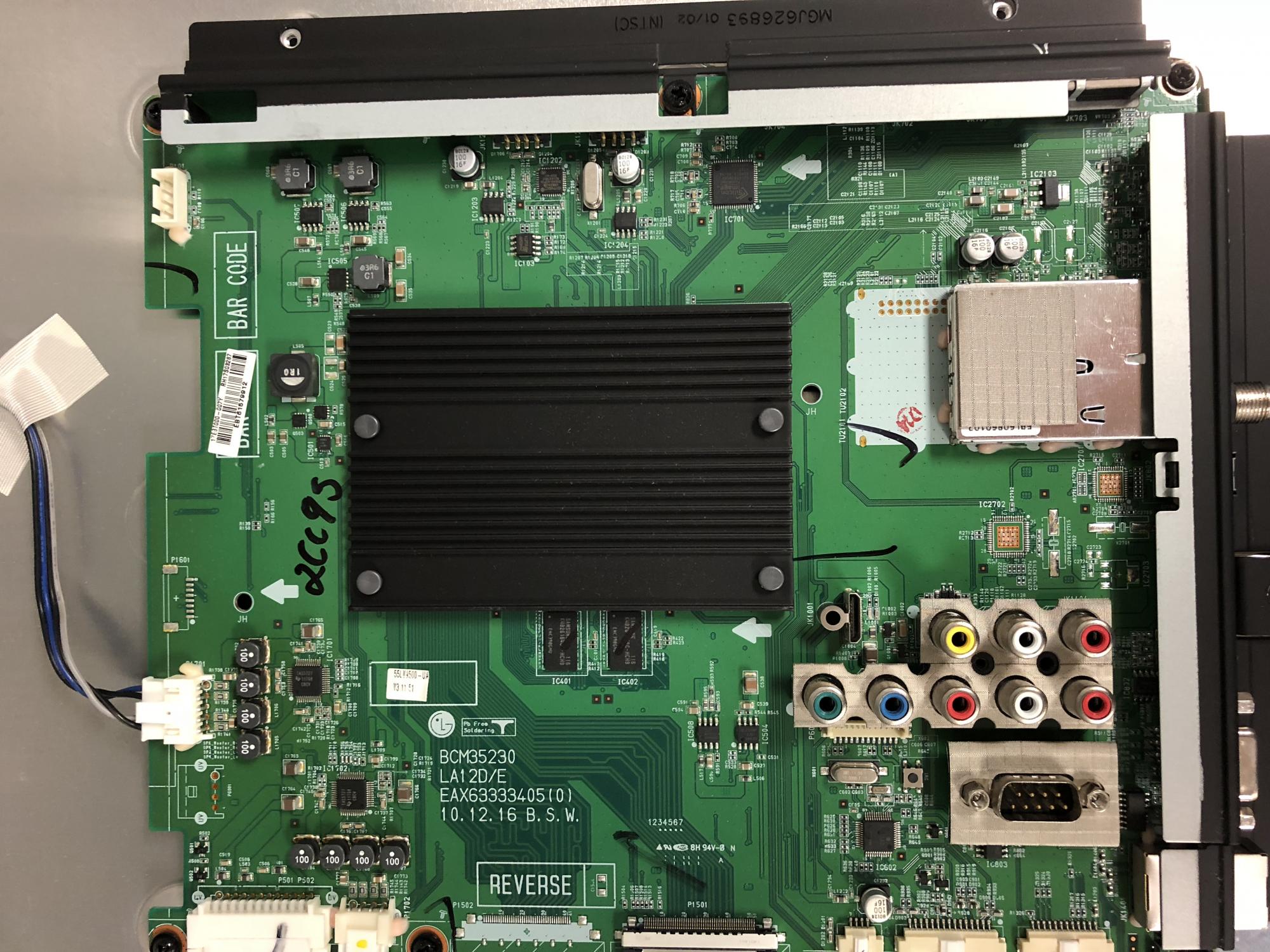

    Re: LG 55LV9500 no picture wide vertical lines
    take the black heatsink off the mainboard BGA chip and heat it up with a heat gun on LOW for 45 seconds. get all of the chip hot and try not to get anything else. It probably will come back to life, for how long........?
      so you are saying the processor on the main board needs reworked/reflowed. I can take it off and re-ball it. Is there anything else it could be? Would like to rule out less invasive stuff first.
        yes. Re-balling would be the best thing you can do. I have half assed re-flowed 15 of the edgelite led tvs. Only one has gone bad. He had it re-balled somewhere and its fine again. You might want to offer a re-balling service, you would get a lot of work from me and others on B.C.
