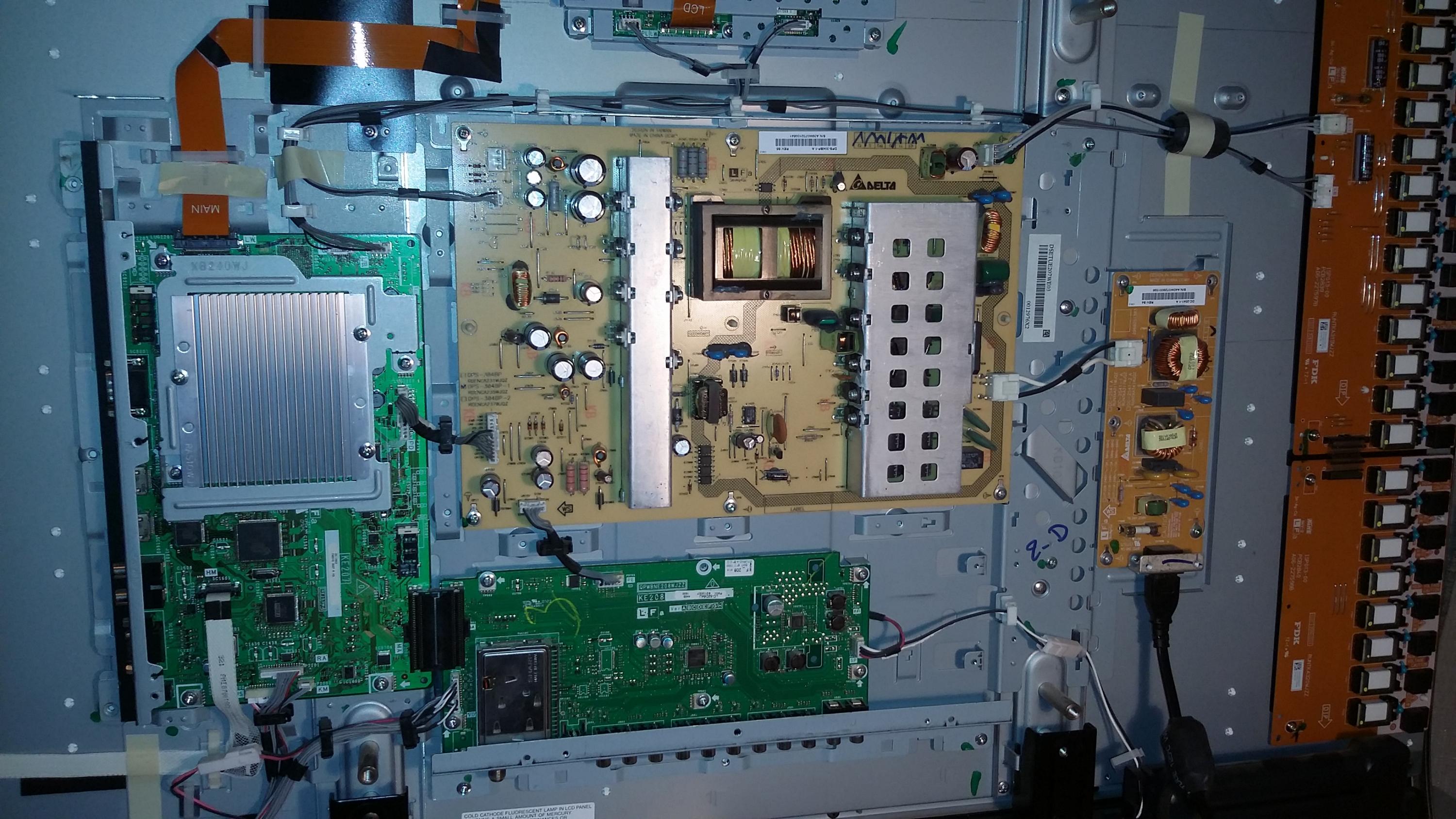

    Helping a friend that has a Sharp LC-42D64U that the display is good but none of the video inputs work as is no video (3 hdmi, component, rca video) but the OTA input works along with rca audio inputs. No audio from the hdmi. Menus display fine.
    There are no "flash codes". Tried reloading the firmware. According to display, the Old is u0708071, the new on usb is u0905131. The set moves thru the update menu and in accordance to the last "ok", the set is supposed to turn off, then begin loading / reading firmware. It does something, light blinks on stick. But in about 3-5 seconds, the set turns back on. Nothing has been updated and no "error message" shows to indicate an "update failure".
    Checked the voltages arriving to the main boards, they are as expect with the ur15v and bu5 there. Grounds are measured as good / connected.
    It would appear that the thing isn't happy about doing any switching controls.
    Possible a main board failure. Is there anything else to check before trying to find a replacement main board. Although shopjimmy is out, there appear to be a few on ebay.
    I don't have any "reflow capabilities" in terms of the main board "big chip".
    Will start going thru the service manual to see if there is anything in the control path that might be worth tracing back to somewhere.

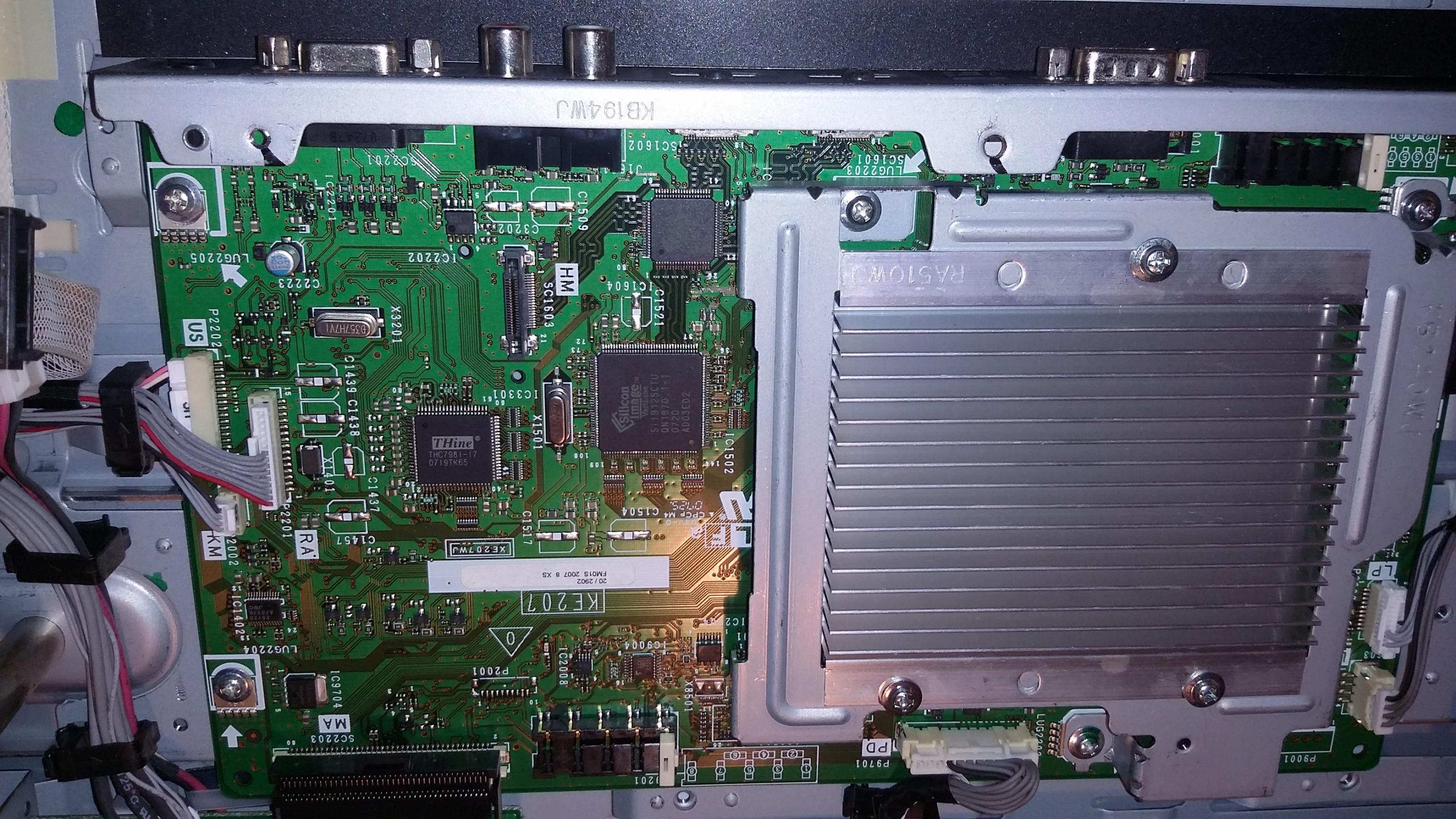

            One thing that I am remiss on is the history of the TV. My friend bought the tv privately from a seller who said that their son was using it as a gaming set and it lost all the video inputs except for the OTA connection. My friend was OK with that because that's what he was initially going to use it for anyways... but as time has gone by, he / I thought we should look and see what's up with it... especially since I am a "pro" at fixing sharp 70 inch tab failure sets... :-)
            Anyways, that's the lack of history story. Now for something interesting. Based on your responses to my thread, I started slowly going thru the service manual to find out things like input assignment and such. Then, in the service manual, I find that there are things called "model number id plugs" which appear to be "bonded jumper pairs" that get inserted into two connectors, sc9201 and sc9202. For a 46 set, sc9202 is supposed have the jumpers set in position 3 on the "array", while sc9201 should have the jumper at position 1. If you look at the picture of the main board, I think both are at position 1. hmmmm????
            Can any one tell me what these things actually do? Is it possible that the owner may have replaced the main board with another set and didn't have these set right?
            I guess my question is: can I move them or are there more things around clearing / resetting things like firmware, etc before this can be done successfully?
            Another learning experience... fun fun!

              Re: Sharp LC-42D64U... no video inputs work, OTA works
              "Can any one tell me what these things actually do? Is it possible that the owner may have replaced the main board with another set and didn't have these set right?"
              It is highly likely
              "I guess my question is: can I move them or are there more things around clearing / resetting things like firmware, etc before this can be done successfully?"
              On all PC/TV boards i've seen settings are made via software or via jumpers, never both...
              Bye.

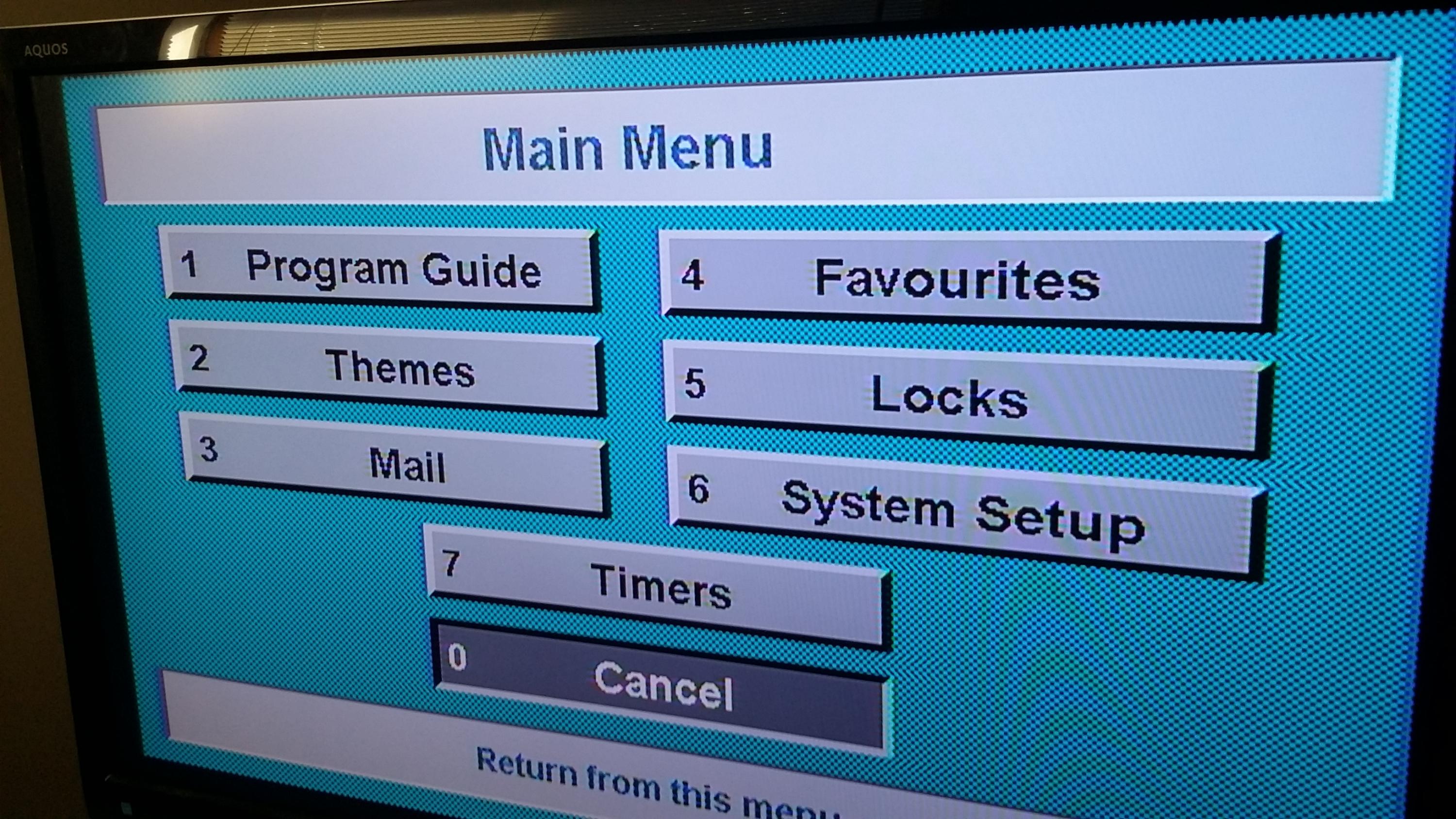

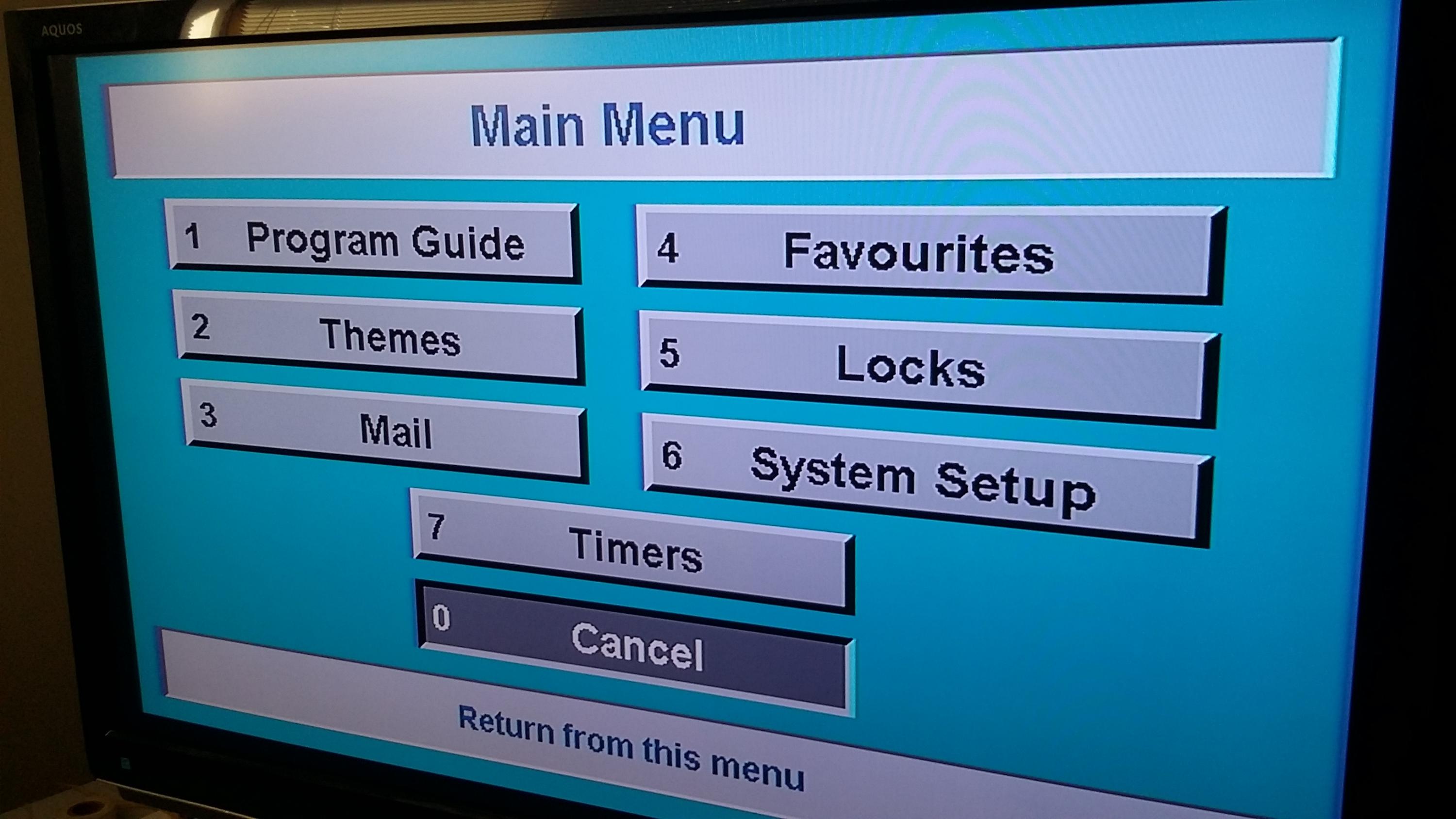

                                  ok... some more fun. Since I don't know much about video signals (technical specs / makeup), I was hoping someone could point out what might be the issue on this.
                                  Attached are two pictures. The first is menu straight from svid out of sat box to svid in on tv. Display is good. Next picture is rca vid out thru plug adapter to svid cable then to svid in (same input). Display isn't so good as you can see there is "bits missing" which I think is some level issue.... maybe. The reason for asking / showing this is that out of two dvd players (one of which is old and has an svid out), I get NO video from either svid direct or "rca vid adapted". To me, that points to some sort of level issue or timing issue maybe but was hoping someone might provide a bit more direction on this / these signal "expectations" based on what those pictures are showing.
                                    I think you have problems on software basis or cpu, i have not gone in deep read of the s.manual, to reset to defaults you must go in service menu and put ON on the menu item 2 at page 2 "industry init" and unplug mains, but this seems to reset only few values, if doesn't work you can try option 2 at page 32 "Eep recover" then option 1 page 32 "eep save" , bye.
