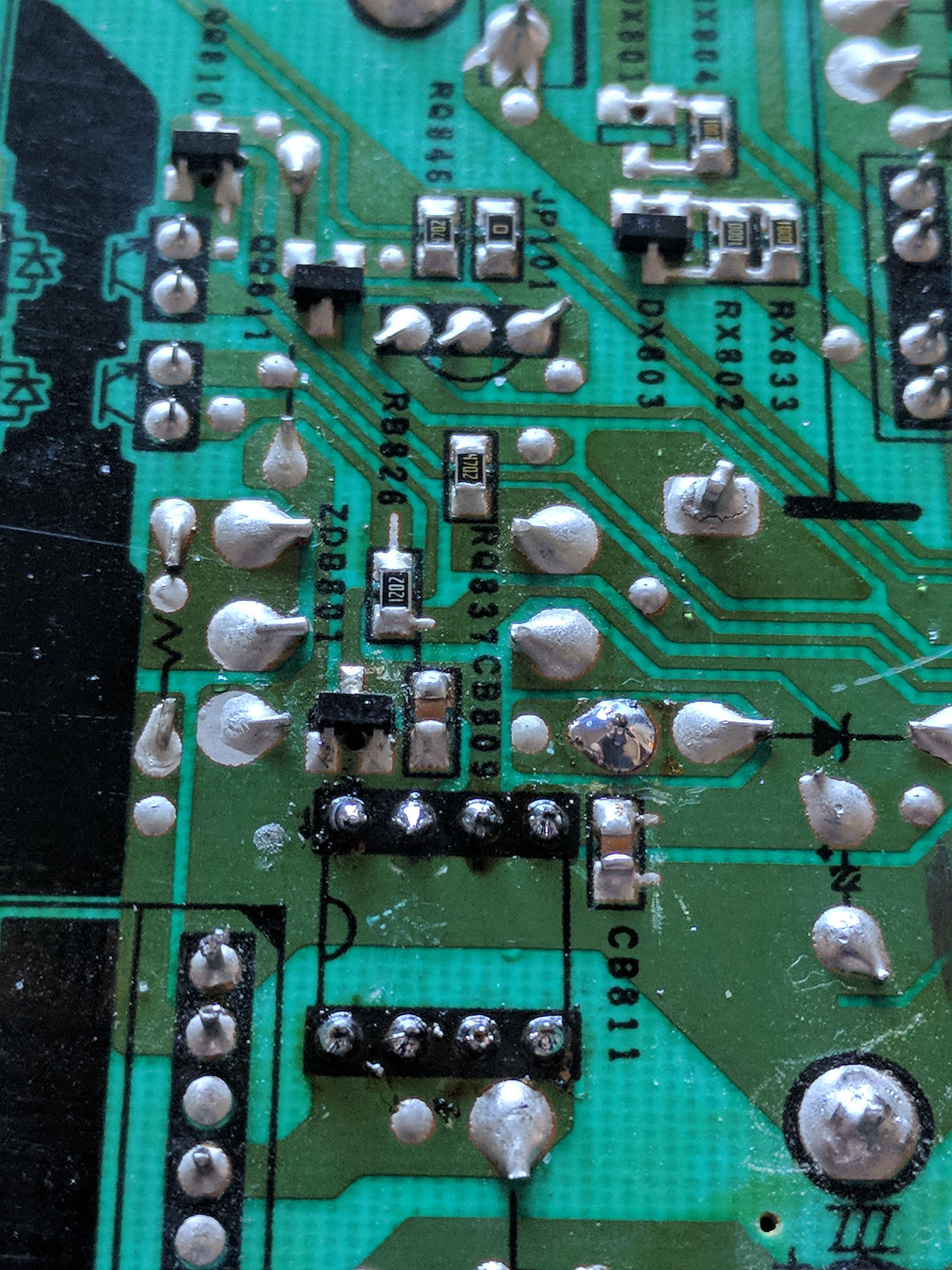

Hello tmlfan,
Please refer to your modified picture below:
The component shown in the red box is from your original photos (your first post) and I assume the same one is in Post#6, therefore I'm not sure if its your original PSU or the (so called) refurbished one.
The SMD transistor seems to be damaged compared to the photos shown in budm's Post#11.
So which is which?
Regardless though, that transistor just doesn't look healthy.
Regards,
Relayer
Re: replacement hp-t5054 replacement power board no power
Any pics that were posted are from the refurbished board that I bought to replace original board, I retook the pic from where you suggested, and yes black probe to chassis ground and red to whatever I'm measuring, meter set to dc
