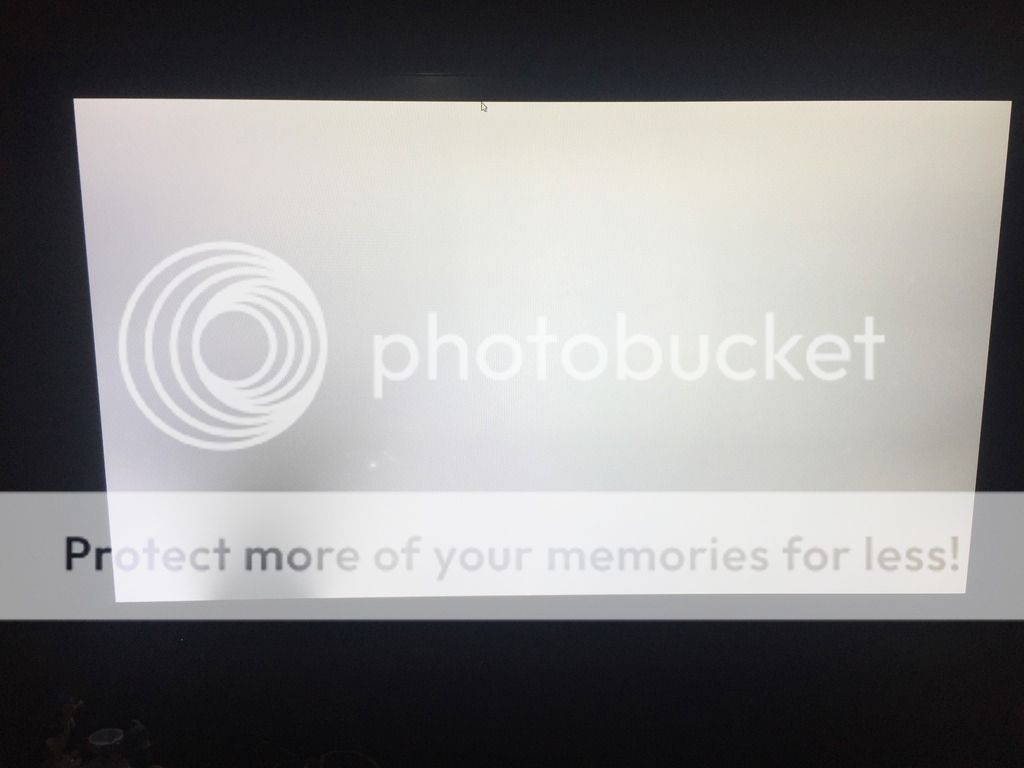

Sony LED 60" KDL with dark spot along bezel on 2 TVs
  • PlayDoh
    • Sep 2017
    • 33
    Sony LED 60" KDL with dark spot along bezel on 2 TVs
    I have 2 Sony 60" LED TVs that are roughly 6 years old that amazingly both developed these spots within 2 weeks of one another. I'm thinking it's a backlight / edge light bulb out. After days of searching I can't find anything on a identical problem.
    Both these TV's are kdl-60ex645 and the other TV has the exact same issue just like 10 inches to the right. From what I've read so far is that the backlight bulbs on this model are part of the display panel and cannot be repaired or replaced by themselves.
    After 6 years of good use I can't be too upset since it's livable for now. If I can fix it I'm down for it. Any help would be greatly appreciated.
  • PlayDoh
    • Sep 2017
    • 33
    Re: Sony LED 60" KDL with dark spot along bezel on 2 TVs
    I should note that there is an image under the dark spot, and in some instances it's barely noticeable. Letterbox movies almost hide it completely.
    I'm sure I'll be TV shopping soon though.
    • dskall
      • Oct 2016
      • 2905
      • usa
      Re: Sony LED 60" KDL with dark spot along bezel on 2 TVs
      Looks like bad led. Should be repairable. Will have to remove panel
      • PlayDoh
        • Sep 2017
        • 33
        Re: Sony LED 60" KDL with dark spot along bezel on 2 TVs
        Do you know if all the LED's are part of the panel or are some around the edge? I did manage to find some used strips for sale, so thats hope.
        • heavymachines
          • Mar 2011
          • 1028
          Re: Sony LED 60" KDL with dark spot along bezel on 2 TVs
          Looks like edge lit, if so then it is attached to heatsinks with adhesive.
          • PlayDoh
            • Sep 2017
            • 33
            Re: Sony LED 60" KDL with dark spot along bezel on 2 TVs
            kdl-60ex645 Features;
            "LED edge backlight"
            Now I feel dumb, lol.
            Thanks for the replies.
            • Davi.p
              Hobbist Tech
              • Sep 2009
              • 4318
              • Italy - Milan
              Re: Sony LED 60" KDL with dark spot along bezel on 2 TVs
              The fresnel lens may be burned. Apart the leds.
              • NolesFan
                Sony XBR-75X800G - Android start up only and dark blue screen
                by NolesFan
                Hello all. Sony XBR-75X800G - Android start up only and dark blue screen. Back lighting works. Music just repeats itself. Remote has limited function. Ive search for model # here but I did not find anything. Thinking its T-con but I dont have what type of numbers Im to have when reading on a MM. Any help would be great. TV is 5 years old. Thanks
                07-07-2024, 10:13 AM
              • Rozp
                70LE660U dark cloud or black screen with sound.
                by Rozp
                Hello Everyone,
                This is my first post so I will try to be as precise as possible without making this post too long winded. Unfortunately I don't have pictures of the original problem but I included images of the TV internals.
                I have a Sharp 70LE660U. The problem started a few months ago with the bottom row looking out of sync and was dark on the left side and then fading to transparent on the right side. Shortly after, a dark cloud appeared in the center of the screen. The dark cloud started small and shaded but the image was visible. It also affected the menu area....
                08-29-2023, 05:25 PM
              • Carlos#2003%
                by Carlos#2003%
                02-15-2024, 07:52 PM
              • syedshueeb@gmail.com
                Black spot and vertical lines on Sony KD-55x9300C
                by syedshueeb@gmail.com
                Can experts please share their opinion on this issue where i have a black spot and vertical lines all over the screen.
                Is this fixable or needs a new panel?...
                03-31-2023, 01:29 AM
              • dkneyle
                Sony KDL-46HX850 Can't upgrade/update firmware
                by dkneyle
                Diagnosed this TV as having a failed main board which I've replaced with one from a KDL 55HX850. They are (supposedly) the same board.
                Being 'Smart TV' it requires a firmware reboot when you swap out boards such as T-Con or main board. It starts with a black screen and flashing yellow and green LEDS, indicating it needs that firmware boot. The procedure described all over the web is to put the software into the root directory of a FAT32 formatted USB drive and it should load that up once plugged into USB1 port. But not for me. I can see the LED on the USB chip flash for about...
                09-25-2024, 10:44 PM
