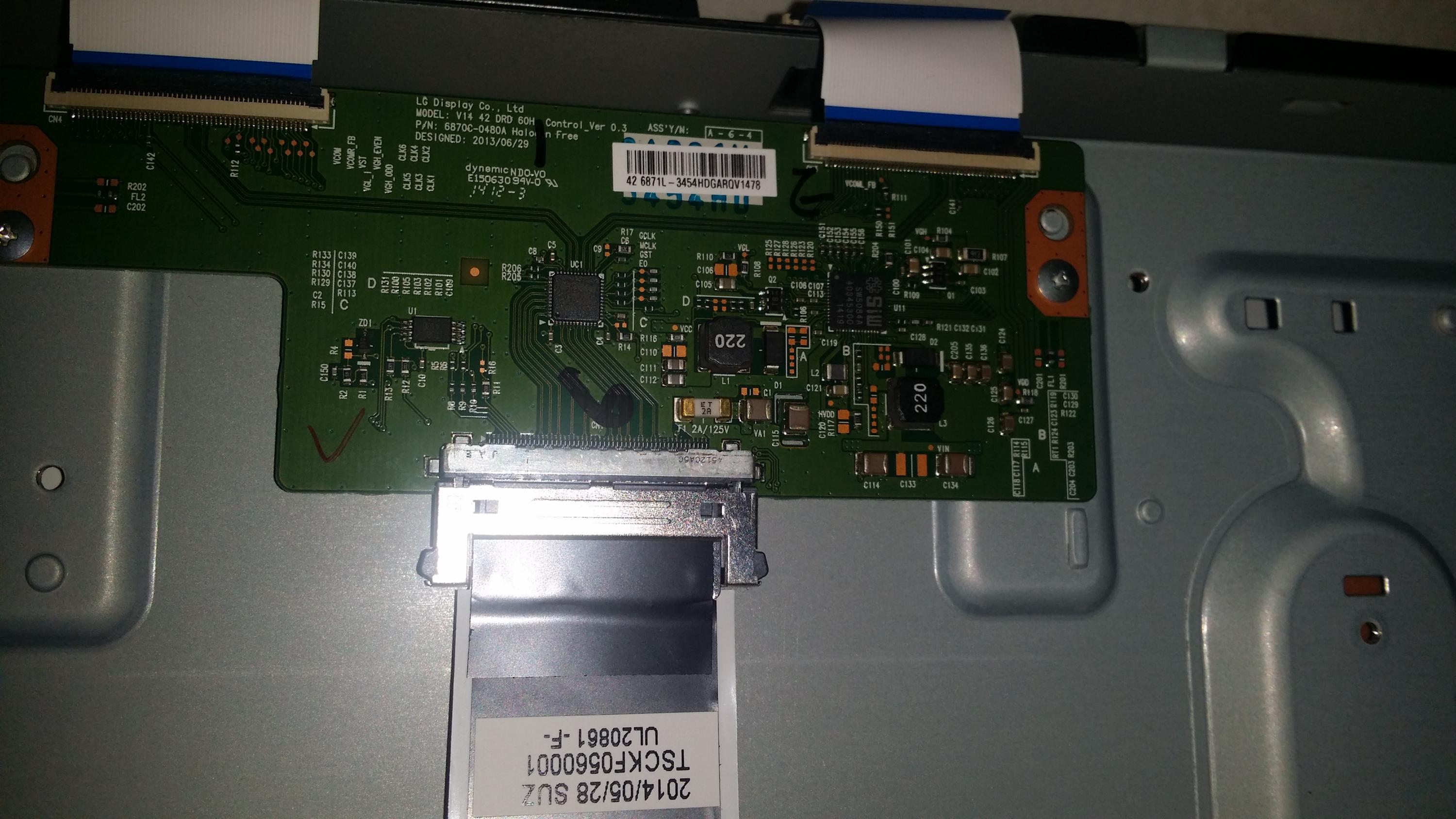

      I have took some picture of the rear of set to show the labels and connections but unfortunately I cant measure for signals as my scope is to old for this type of work?

        It may be worth trying to read as many voltages as possible marked on the TCON. There could be a fault on the interface strip between the panel and the tcon or even the COF chips that is loading or even shorting one of the tcon supplies.

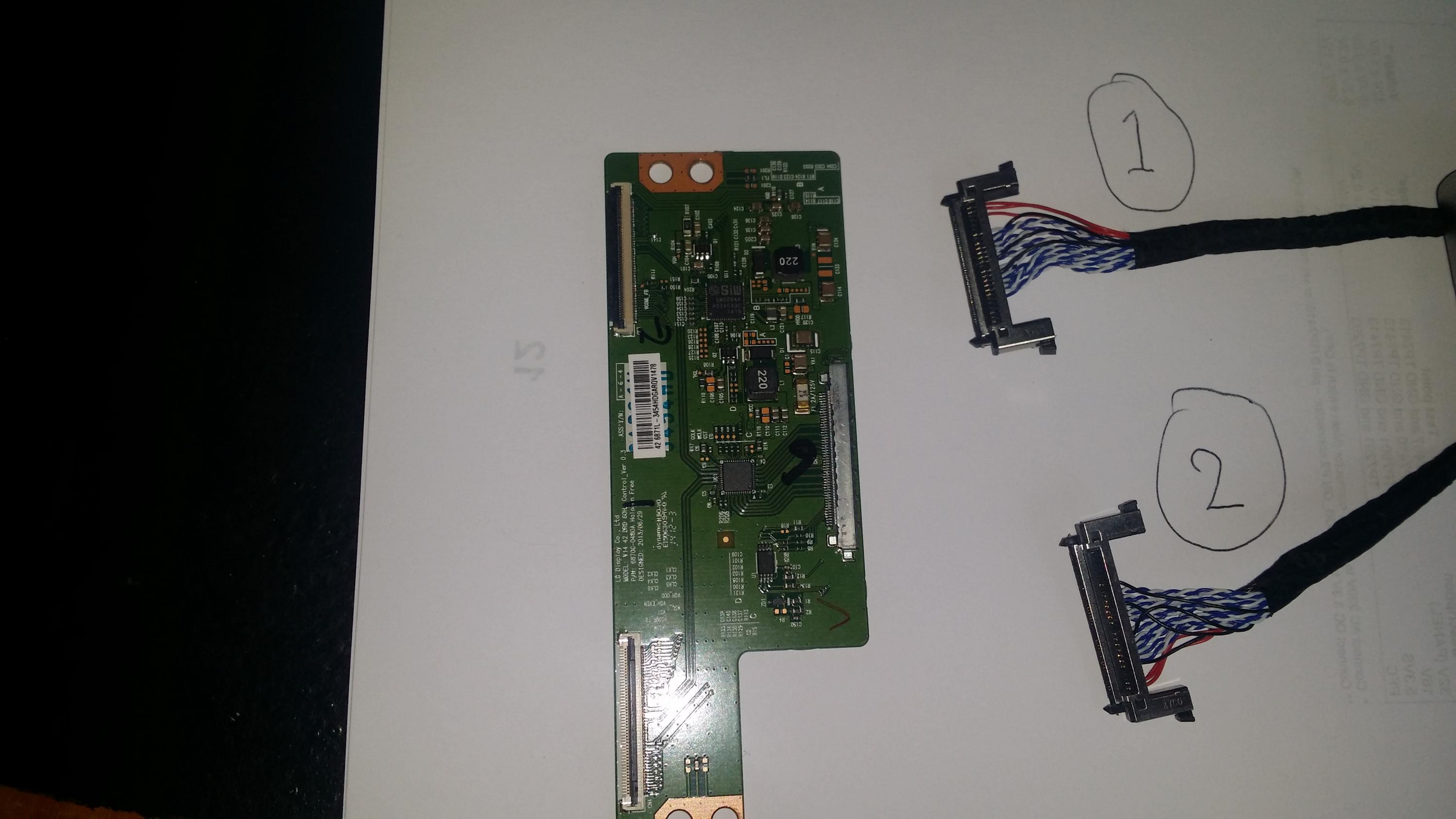

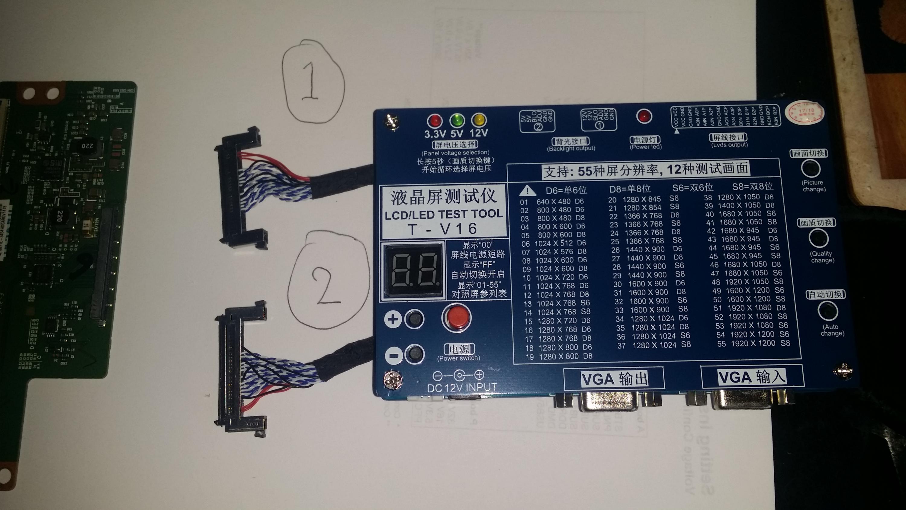

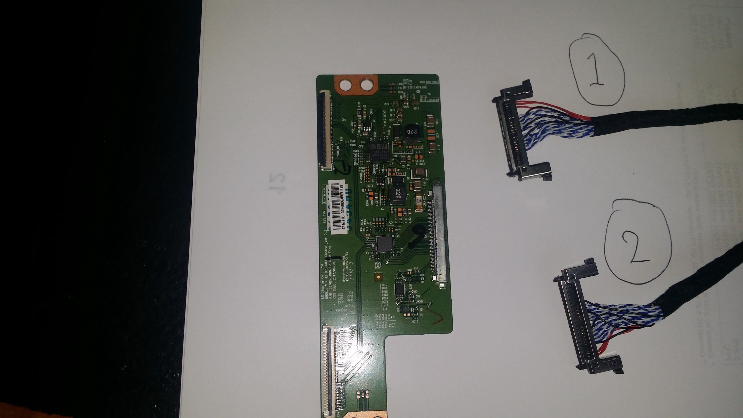

                  this may be a stupid request but maybe someone could help !!
                  I have purchased the LCD test tool as recommended by Vinceroger69.
                  Now it has arrived and as you can guess the user instructions are quite vague to say the least.
                  It came with four discs but having trouble using them.
                  I have checked the video's on YouTube and have a good idea on how to use .
                  Now if some one could kindly look at the pictures I have attached to this message maybe they could help !!
                  There are only two connectors that fit the t-con board and as you can see number 1 has the power connectors on the right and number two has the power connectors on the left.
                  now looking at the service manual as kindly supplied by Dick_Barton on page 10 it states lcd screen is 1920x1080
                  And in the service manual there is no info on the t-con board but from when I tested the f1 fuse I got 12v .
                  So I am sure looking at the tester I think I would need to use the lead number one and set the tester to 12v and the display to 51,52or53.
                  If someone has used one of these before and can look at the attached pictures and confirm this for me it would be much appreciated.

                    #29
                    Re: Panasonic TX-42A400B
                    It would look like lead number 1 because as you say that lines up the fuse on the Tcon with what appears to be the supply wires (Red) of the connector. No 51, 52 and 53 match the screen resolution.

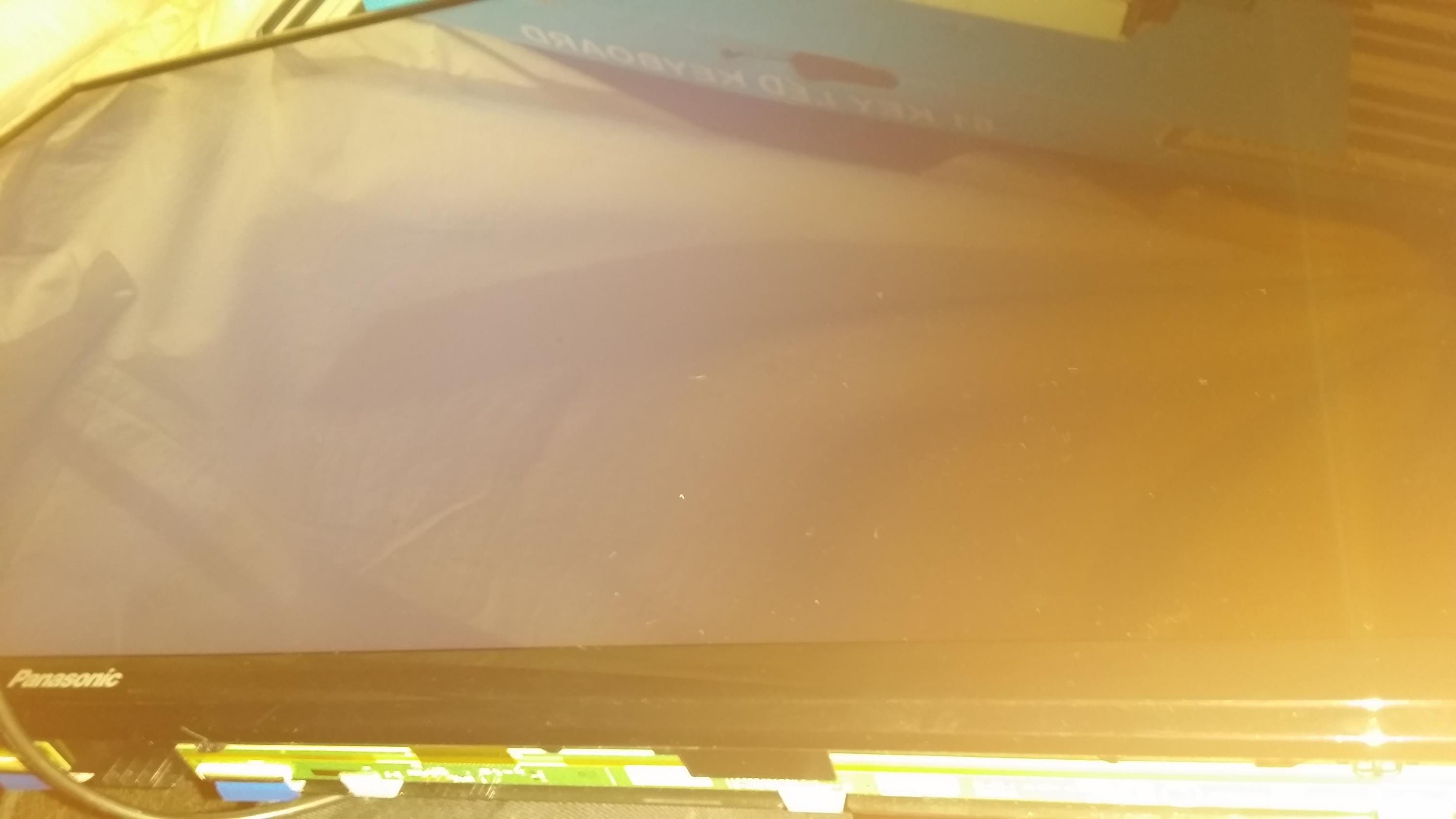

                      #30
                      Thank you dick
                      I have now carried out the tests
                      I have done this test with three t-con boards and get the same results with all three no display back lights on but no colour bar displayed.
                      Now according to the test tool if no display t-con faulty if display colour bars then fault with logic board.
                      Now when I first looked at this TV I assumed the fault was the t-con board, So I sent for a replacement t-con board when this failed to give me a display I sent for another but still the same issue. now I find it hard to believe that three t-con boards are faulty so I now think that the LCD display is faulty!! now I know the connections are at the bottom of the TV and someone suggested that it could be water damage? I have looked very closely at the LCD boards at the bottom of TV and can see no signs of water stains at all.
                      It would seem the this LCD has just give up very strange this is the first I have looked at with this issue.

                          #32
                          Yes I have applied pressure to all connections along both boards but not even a flicker!
                          I also unclipped boards from their position very carefully I must say as not to damage the connections to see if any water damage with magnifier glasses but all looked fine.
                          That's why I think the Lcd screen has gone down but must admit never had this before ?

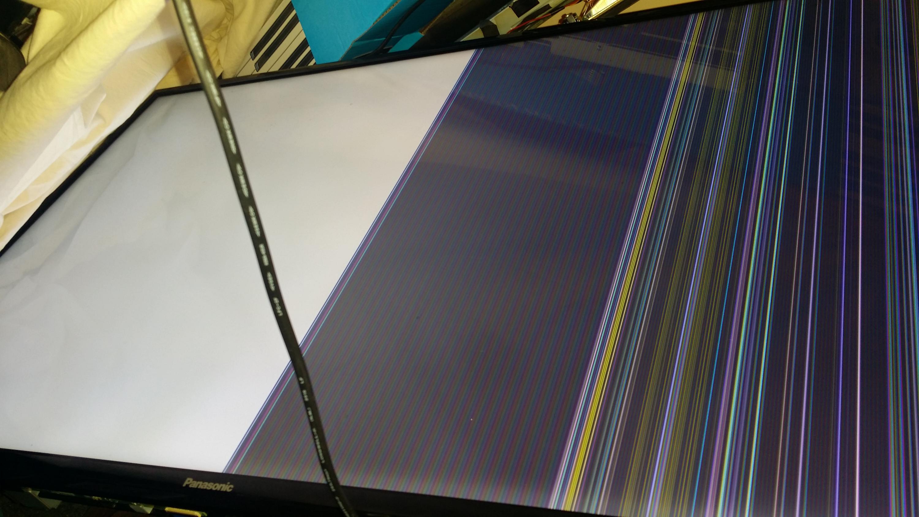

                                  • ronhayes
                                    TV Engineer
                                    • Mar 2014
                                    • 458
                                    #37
                                    I have just tried toggling the tester through 3v3.5v and 12v and nothing on 3v3 nothing on 5v but when it goes to 12v you get a flash of colour at the top left hand side of the screen about 6" long and 2" wide for a brief moment ?
                                    • ronhayes
                                      TV Engineer
                                      • Mar 2014
                                      • 458
                                      #38
                                      I have tested screen with removing connections from panel here are results !
                                      Pict 1 is with R/H connection looking from back of set pict 2 is displayed for a split second then goes to pict 3 with the L/H connection removed as the tester is switched on
