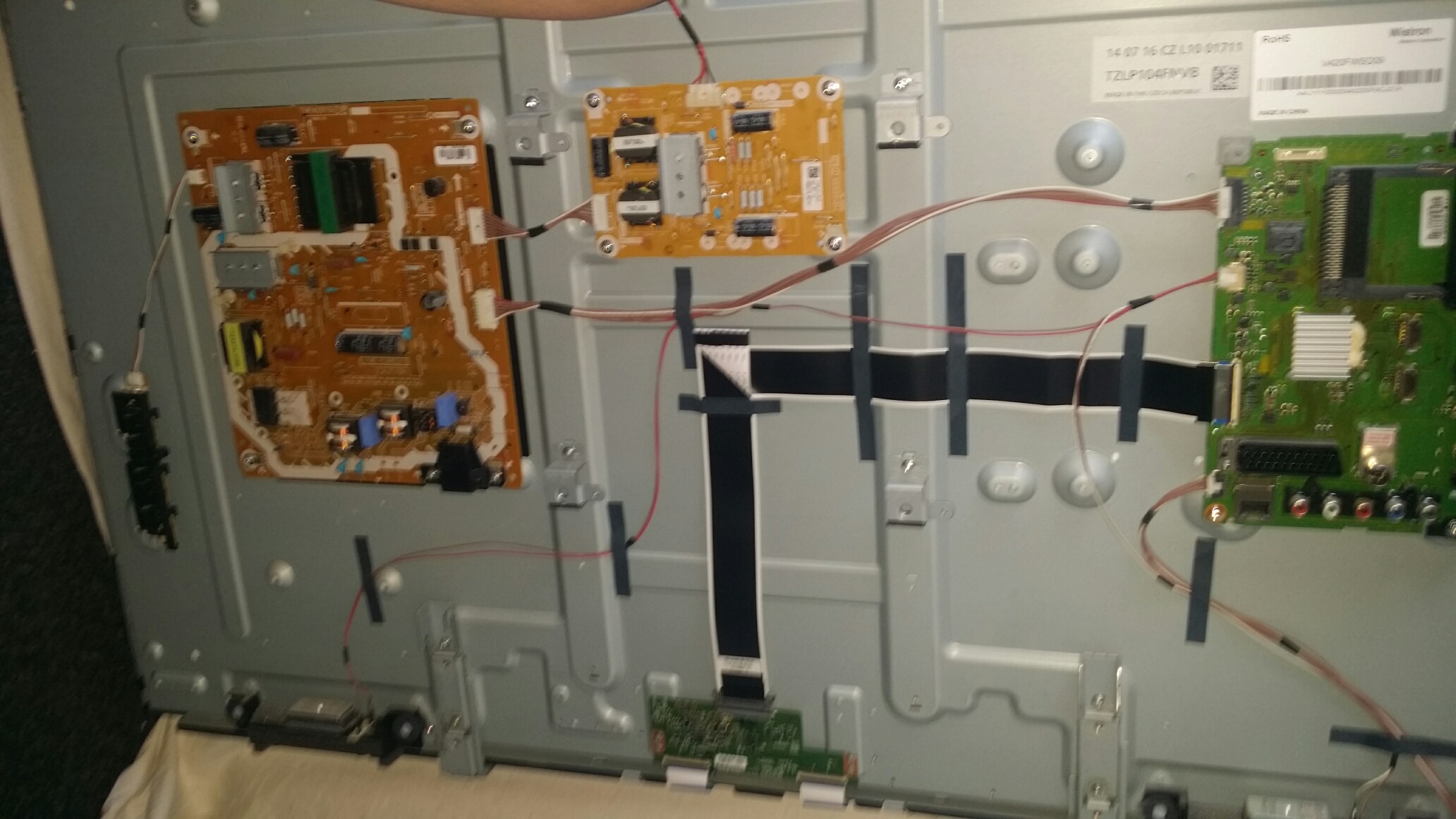

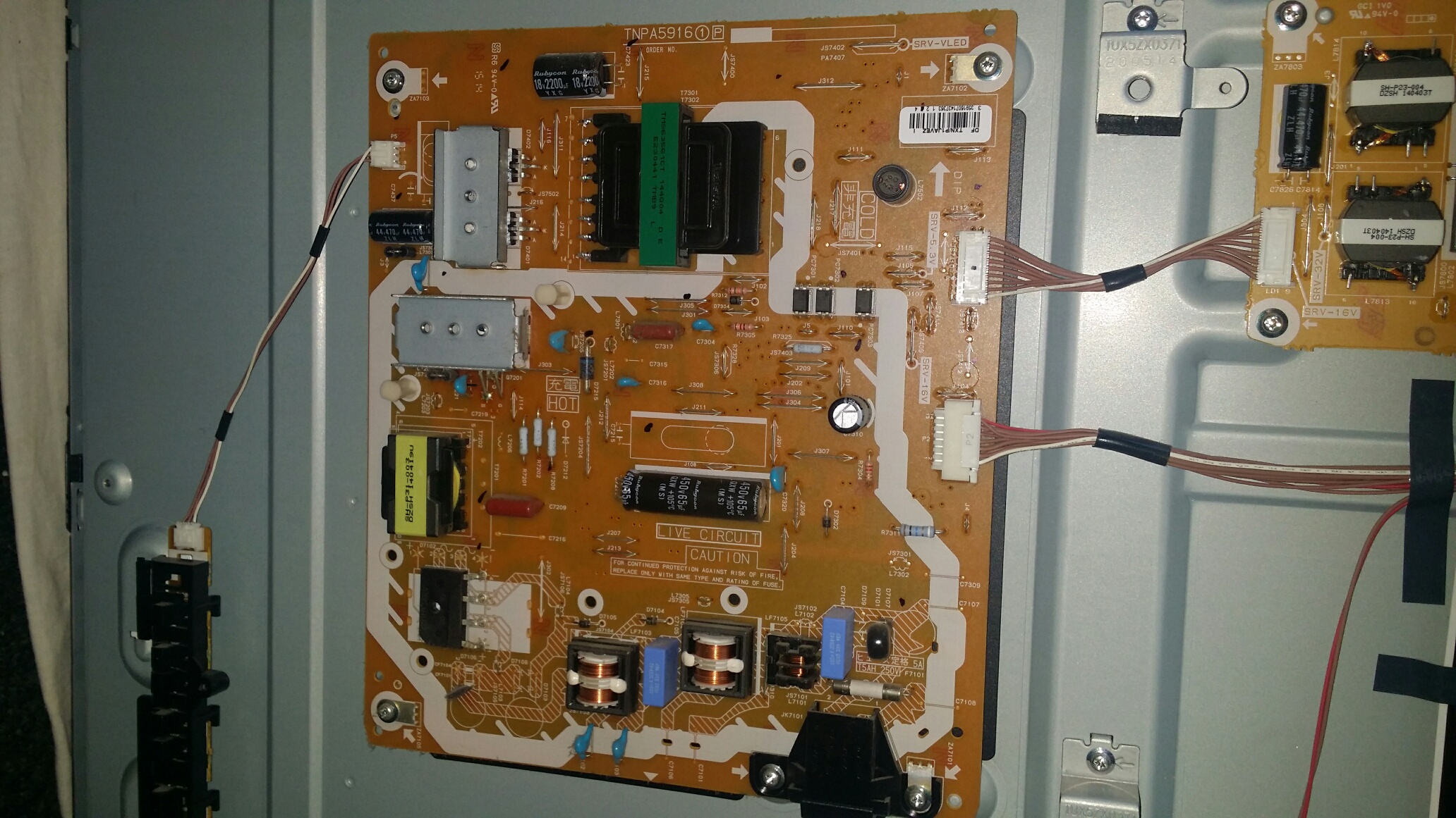

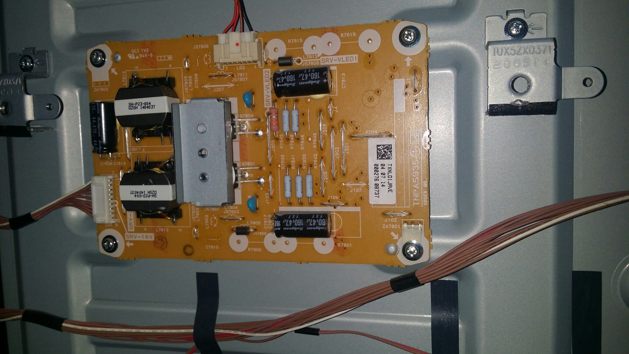

    Hi All
    I have this Panasonic in with no picture but has sound and backlights are on ?
    I have took some pictures of the panels but I have not removed any as yet all caps look ok on all panels.

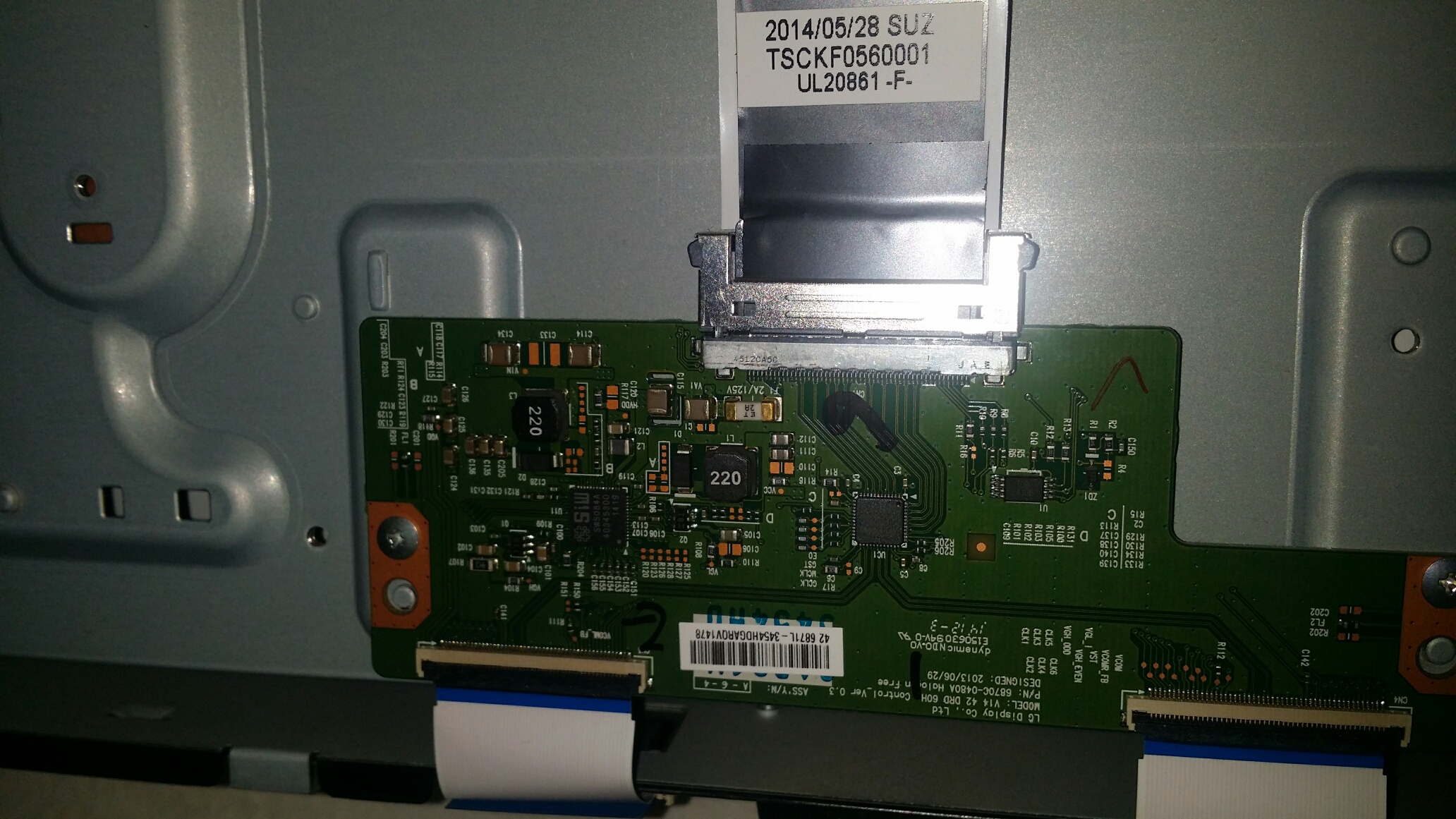

    I am thinking the fault will most likely be with the T-Con board?
    Unless someone has had this fault and knows different!!
    Any help much appreciated.
    Ron

    Re: Panasonic TX-42A400B
    I have checked the fuse F1 on the T-Con board and that seems ok.
        I get 12,2v both sides
          what about it you remove one side of the tcon too lcd panel ribbon cables, do you get a image on half of the screen? try this on both sides of the tcon

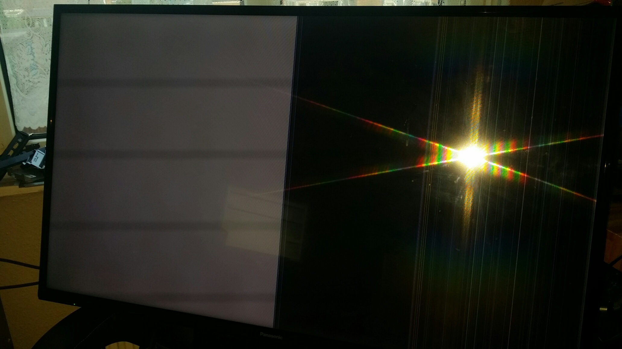

            Here are some pictures with the ribbons disconnected .
            The half white and half black with lines in it is with the right hand ribbon disconnected and the two blank screen pictures are one with the left hand ribbon disconnected and with both ribbons connected.

                Going by the results of removing the ribbons it seems that the T-con board is certainly faulty ?
                  i think that you have a panel fault with the alternating picture status that you have shown.
