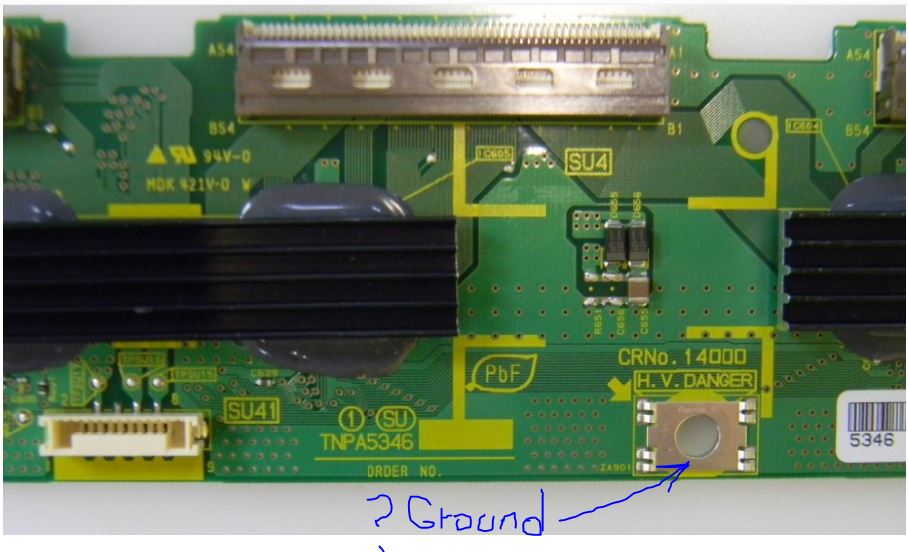

                    I am getting a lot of shorts, in both SU and SD, almost for every 3rd or 4th pin. What do I need to use for Ground? I currently use a spot where 4 screws are sitting that connect SU/SD with SC. I removed the screws before testing.
                    Just need to make sure I am checking for shorts the correct way.
                    I added a pic to show what I am using as Ground while testing pins on SU/SD. Please advice if this is a correct spot for Ground. Thanks.

                      That should work. Did you remove the su to sd ribbon connector? Check your screen very carefully for any cracks. I never had both buffers have shorts before.

                        No, I did not remove the SU to SD ribbon connector before measuring resistance. Now I did, and got the same result: shorts in both SU and SD, all over. I just ordered new SD and SU boards [$62 for both], but now I feel less confident, since you told me that this situation with both boards being bad is rare. I cannot check screen for cracks now, because the TV is laying face down. I recall, there were no cracks when I put it on the table 5 days ago.
                        What else do I need to check before the SU/SD boards arrive?

                          Re: 7 blinks of death for Panny Plasma TV, Viera, TC65PST34
                          There is nothing left to do but wait for new buffers to come in. Make sure you test them before you install them. Check that you have all parts hooked up and screwed down before you turn it on.
