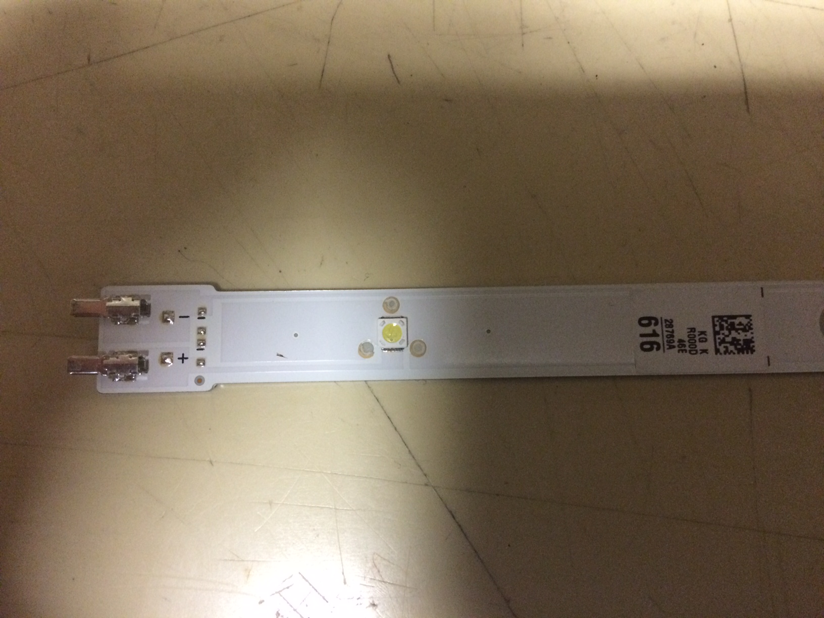

    I tested the 4 rows of led strips. I have 10 burnt out led's. I can't find full strips to replace. So I am removing the burnt out ones. So here is my question. Does anyone know the digikey number on them so I can order a bunch?
    I guess I need the lumen size and color?
    The size of them are 3mm x 3mm

    You also need to pay attention to the bottom of the LED as the layout of the anode/cathode varies.

      I'm ok with that. But if you look on digikey, there is over a hundred of different types! But there is Samsung ones. I wonder if those are them?

        Possibly LM301Z looking at the data sheet pictures.

            You will want something in the 6500k

              I'm thinking this is the ones I need
              https://www.digikey.ca/product-detai...3-1-ND/7562285
              • dskall
                • Oct 2016
                • 2905
                • usa
                Re: Samsung LED Strip burnt out Model UN46EH5000
                Should work. Don't see which pad is anode/cathode in specs.

                  Ya I noticed that. But I'm willing to blow a couple to find the anode. 25 of them are only 9.87 Canadian. I only need 10.

                    data sheet page 13 shows the anode and cathode large pad is cathode

                      Should be good. Usually on Samsung cathode is large pad

                              dskall was dead on. I repaired two tv's with the digikey bulbs. I got 25 for under $20 shipped. The China ones were cheaper but it would take a month to get here. The digikey ones showed up 2 days later. Now I can have my pool table back. They were sitting on there for way too long.
