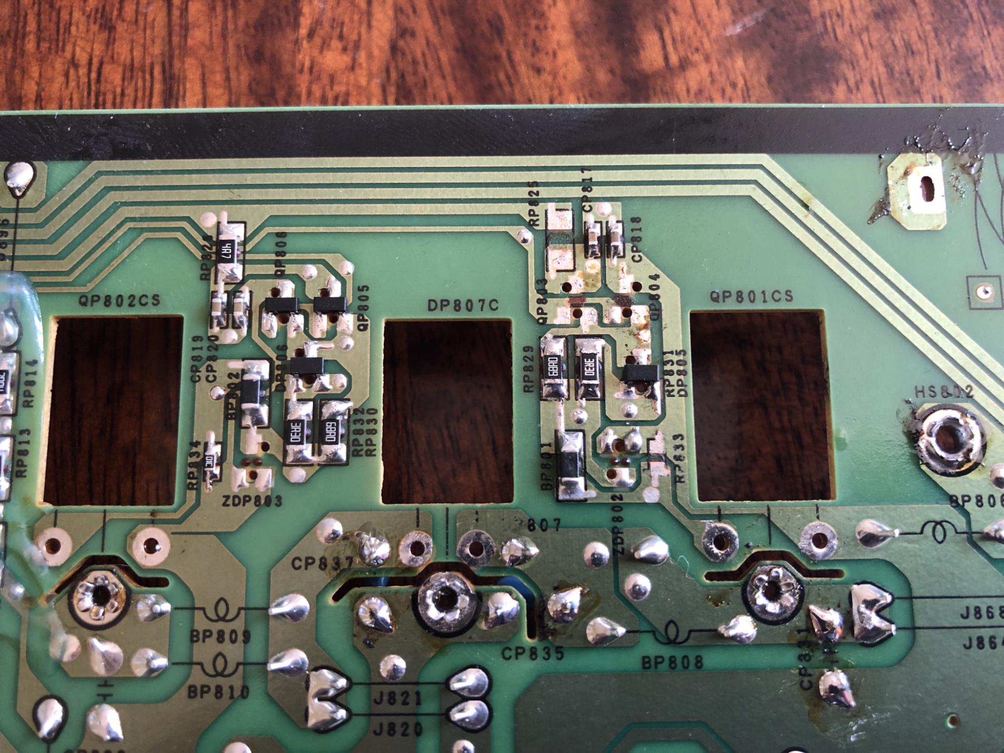

    Hi there,

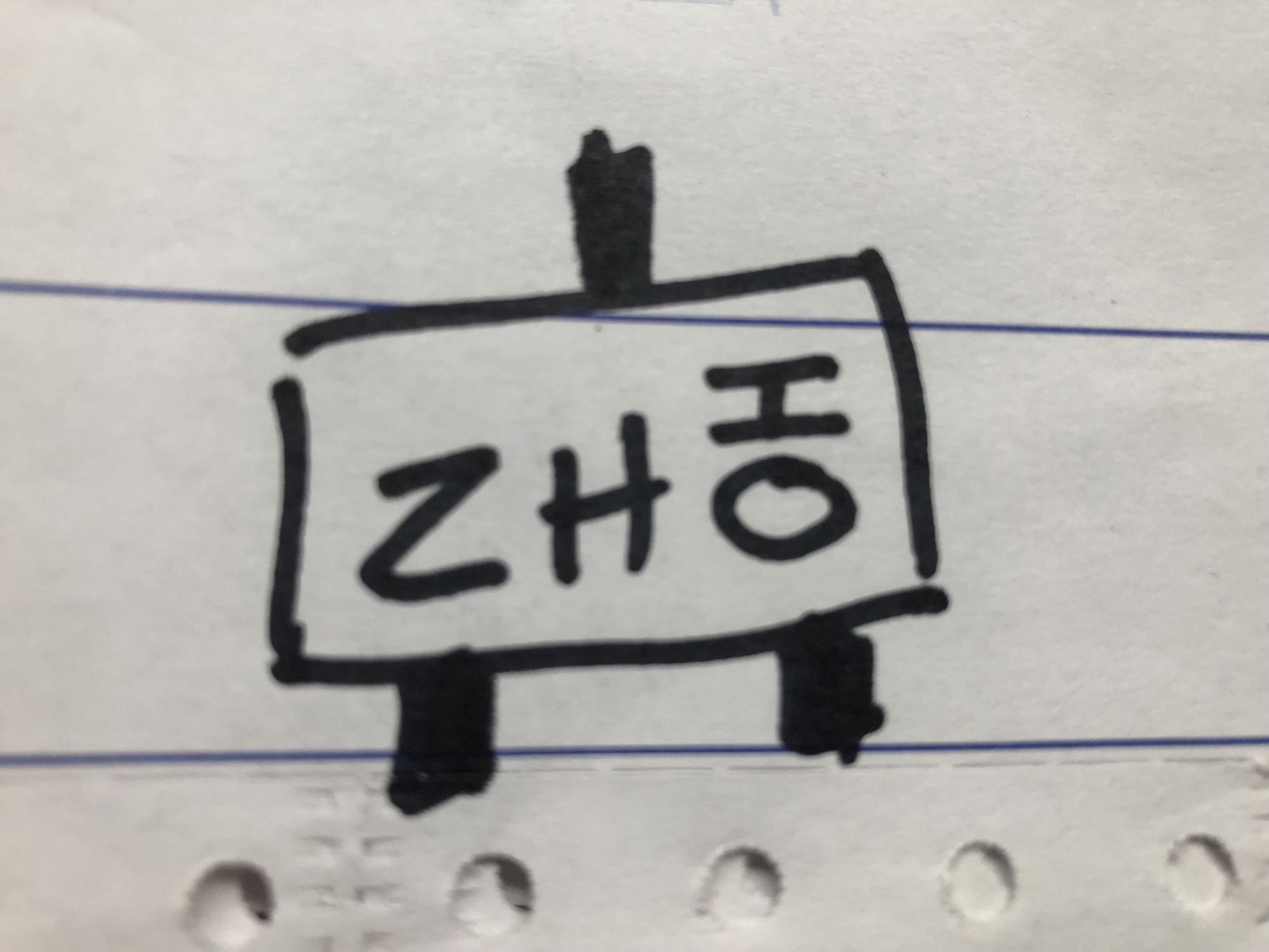

    I'm working on repairing the power board for this TV UN55JU7100.
    Power Board part number is BN44-00811A. I have found two diodes shorted but not sure how to order a replacement. Can you guys help me understanding this part number. I wrote it down as camera can't focus well on this smd diode.
    Something like: ZH 0H (shows written vertically)
    See pic

      Re: Need help with my Samsung UN55JU7500 random "flickering" in the middle of the tv
      I found another shorted: ZG 0F
      Thanks in advance!

                  [QUOTE=Louis82;813721]Hi there,
                  Are you sure the diodes are shorted
                  The 2 legs at the bottom are common and will show a short , the diode is between the top pin and any of the bottom pins

                      Thanks for the SMD Code Book gents - Still wondering if the numbers written vertically mean anything. I been going through my scrap boards and I have found ZH diodes but they also show 1F, 1H written vertically. Thoughts?
                      @chrismurphy - Yes, It test shorted from pin top vs any of the two bottom. I removed them from circuit board an they seems to be bad.

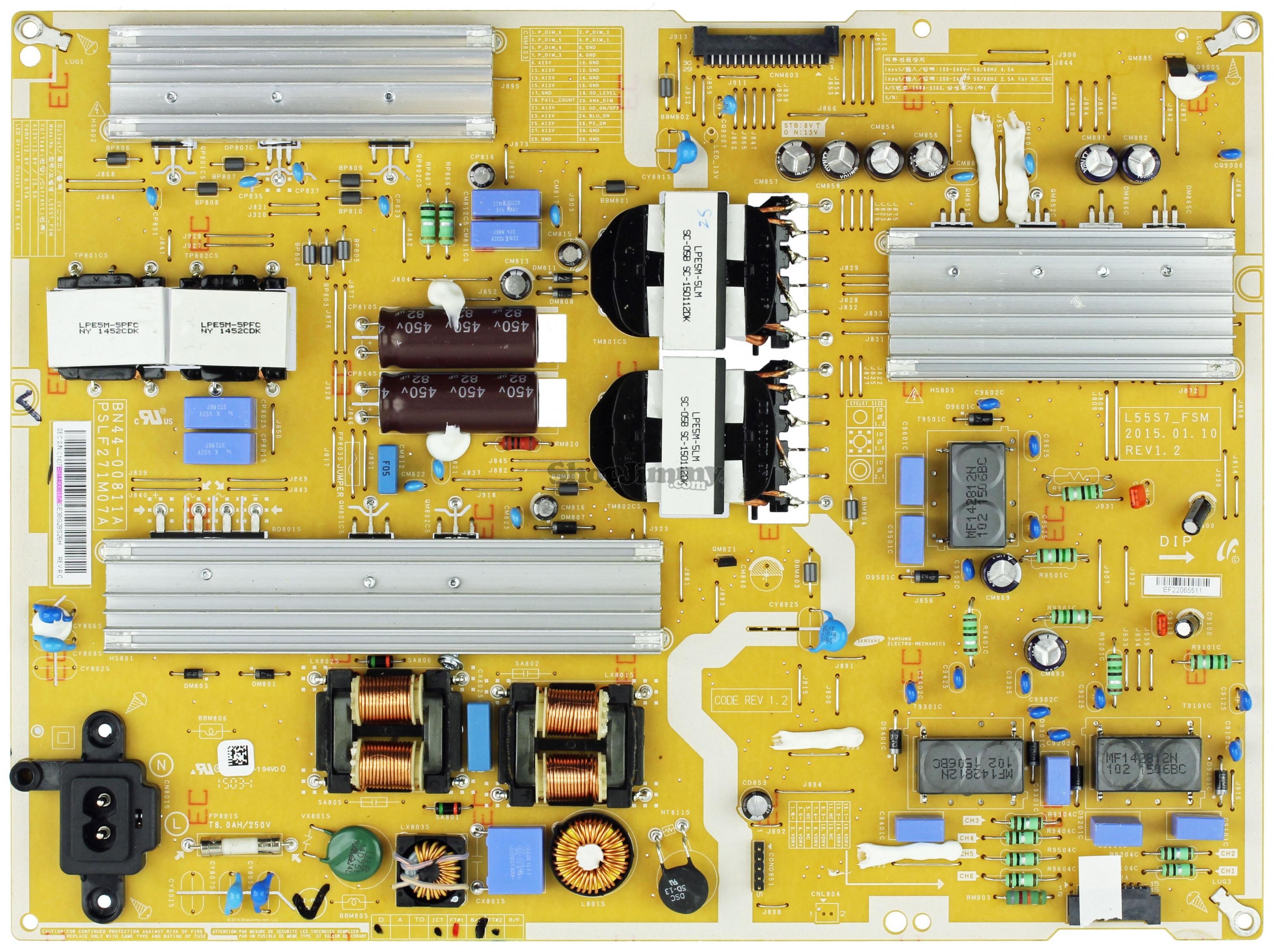

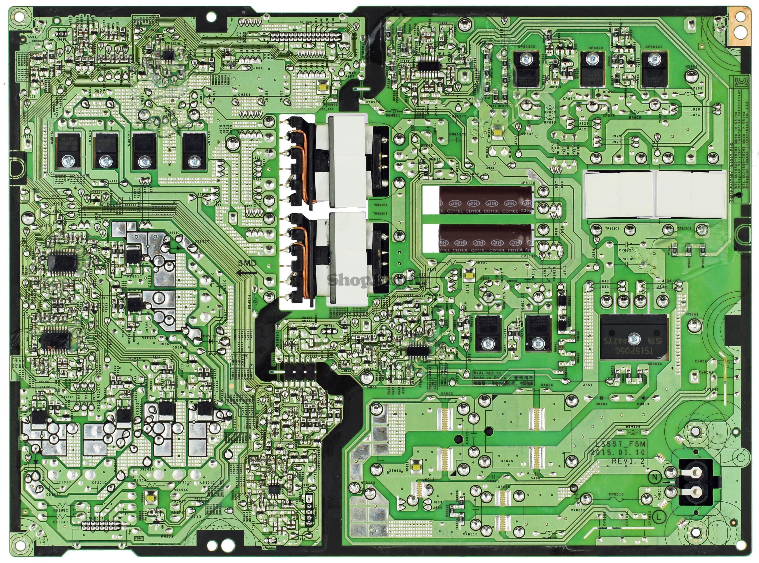

                        So whcih section of the board where those parts are bad?
                        PFC, LED driver, main supply, standby supply?
                        http://www.shopjimmy.com/samsung-bn4...led-board.htm#
                        Pictures provided by shopjimmy.

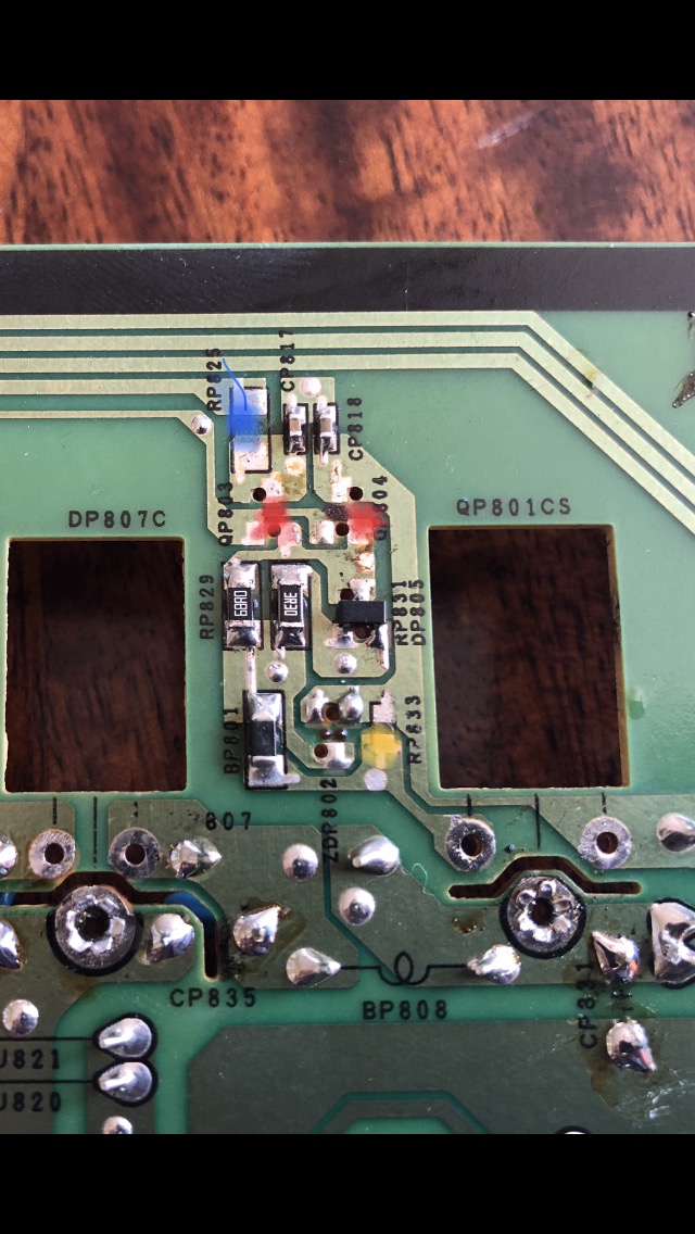

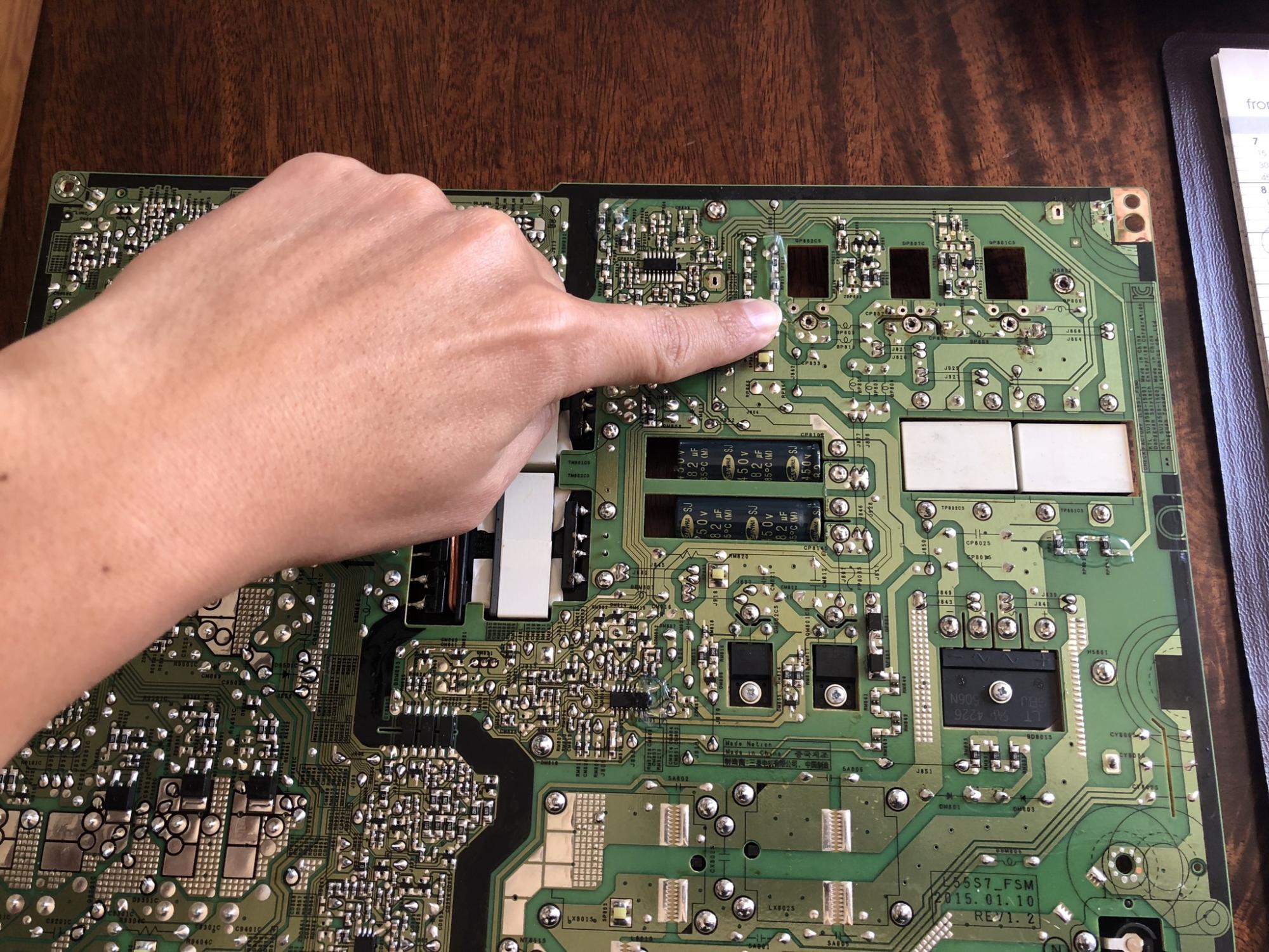

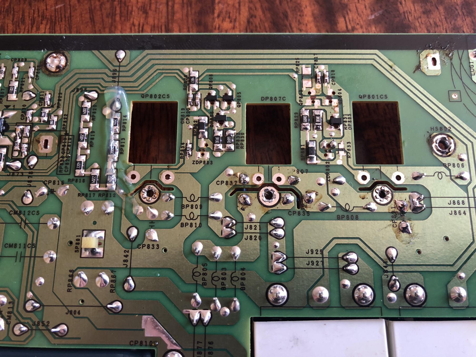

                          The blue dot is a 4.7 ohm that I found burned.
                          Red dots are the ZH and ZG diodes.
                          Yellow is a 10kohm resistir that test good but looked a little bit up so I removed it to replace it anyway.
                          Wonder if the DP807 diode I put in was bad (ordered from AliExpress) and it actually caused a worse mess.
                          As I said initially it was just the QP802, DP807, QP801 RP829, RP831 bad.
                            So you had problem in the PFC Voltage booster section, more likely the PFC IC got damaged when the PFC MOSFET went bad, I always replace the IC at the same time as the MOSFET since you can damage the new MOSFET if the IC is bad.
                            BTW, the part designator with 'P' indicates part related to PFC circuit: I.E. QP802
                                  I found NT811 cracked, replaced all burned parts except PFC Ic and still the same.
                                  Last try will be the PFC IC but I can't tell the part number of it.
                                  • Louis82
                                    • Feb 2012
                                    • 240
                                    Replaced PFC IC SPC1012T and the same, diode location DP807C keeps blowing.
                                      The two MOSFETs QP801, 802 did not blow?
                                      Did you replace that Common Cathode DP807 with the exact same type and isolated case?
                                      For that PFC Diode to blow, the Cathode must be seeing very low resistance to GND.
                                      See the diagram showing how that diode being used in the dual PFC circuit.
                                      Check the resistance between the two legs of the main filter cap CP810 or 814 to see what you get.
                                      • Louis82
                                        • Feb 2012
                                        • 240
                                        Correct, MOSFETS still measuring fine. Diode is shorted. Replaced with exact part number. Wonder if this Diodes are chinese fake components.
