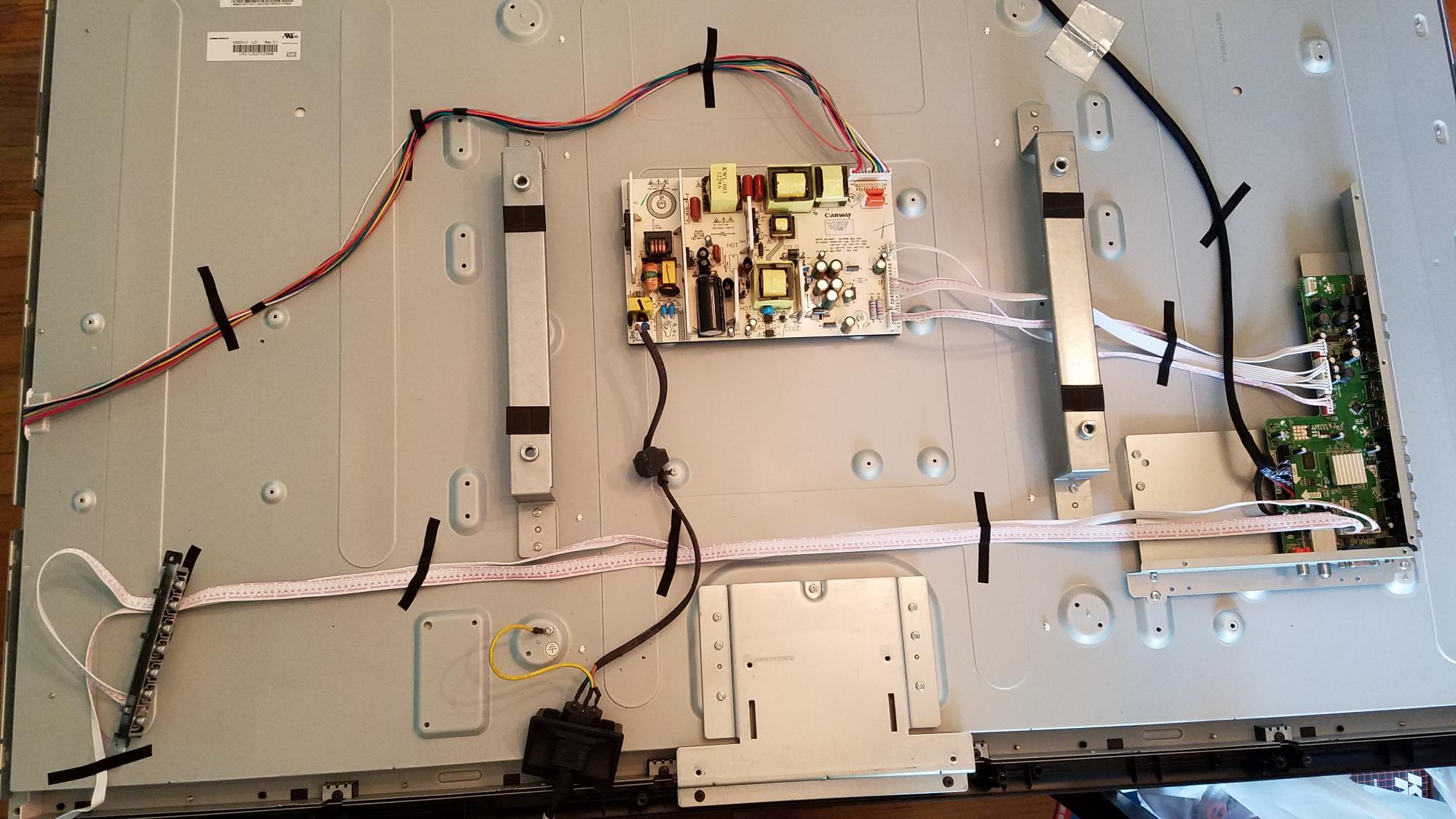

    Here is a picture of how it's connected

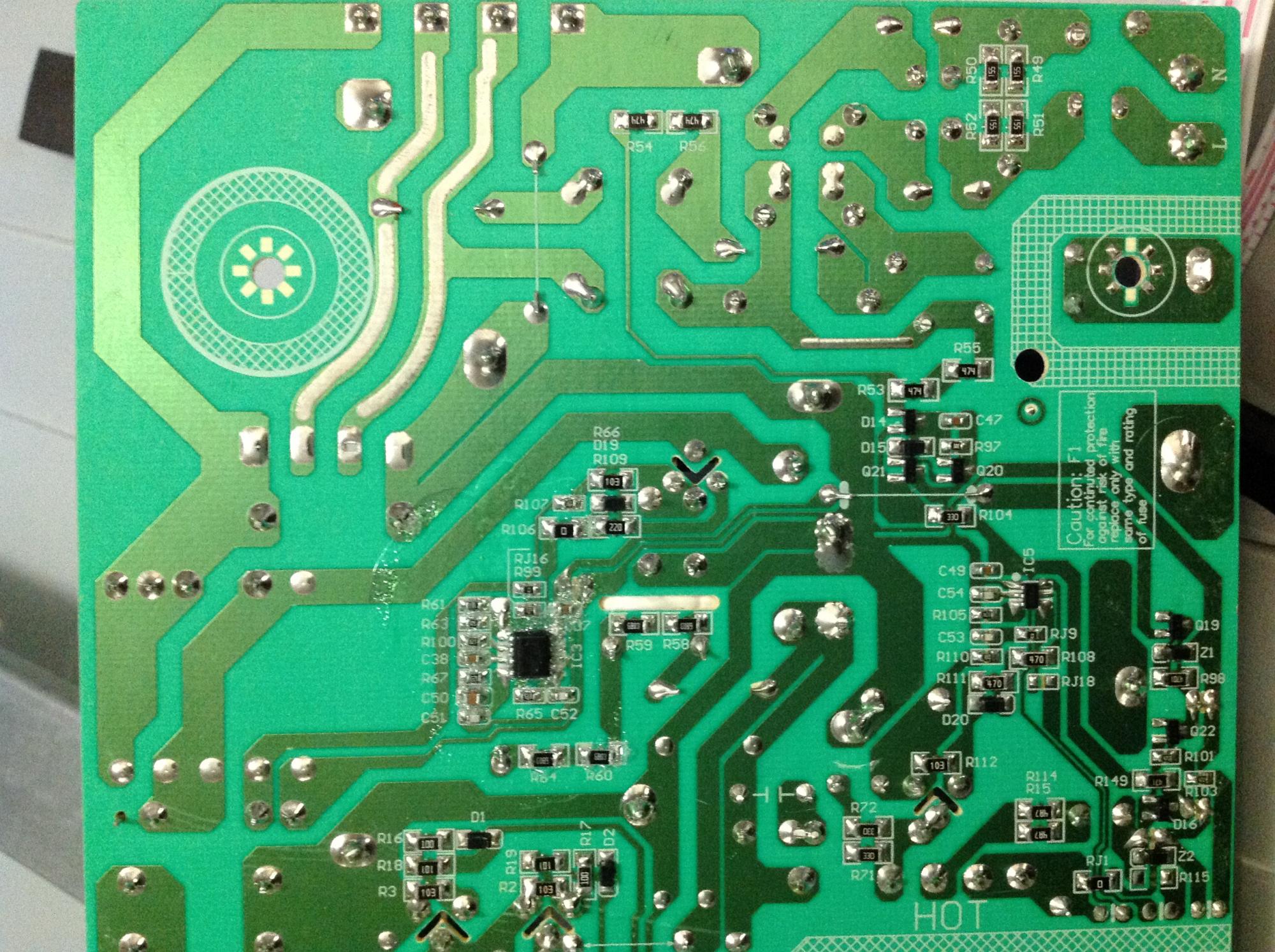

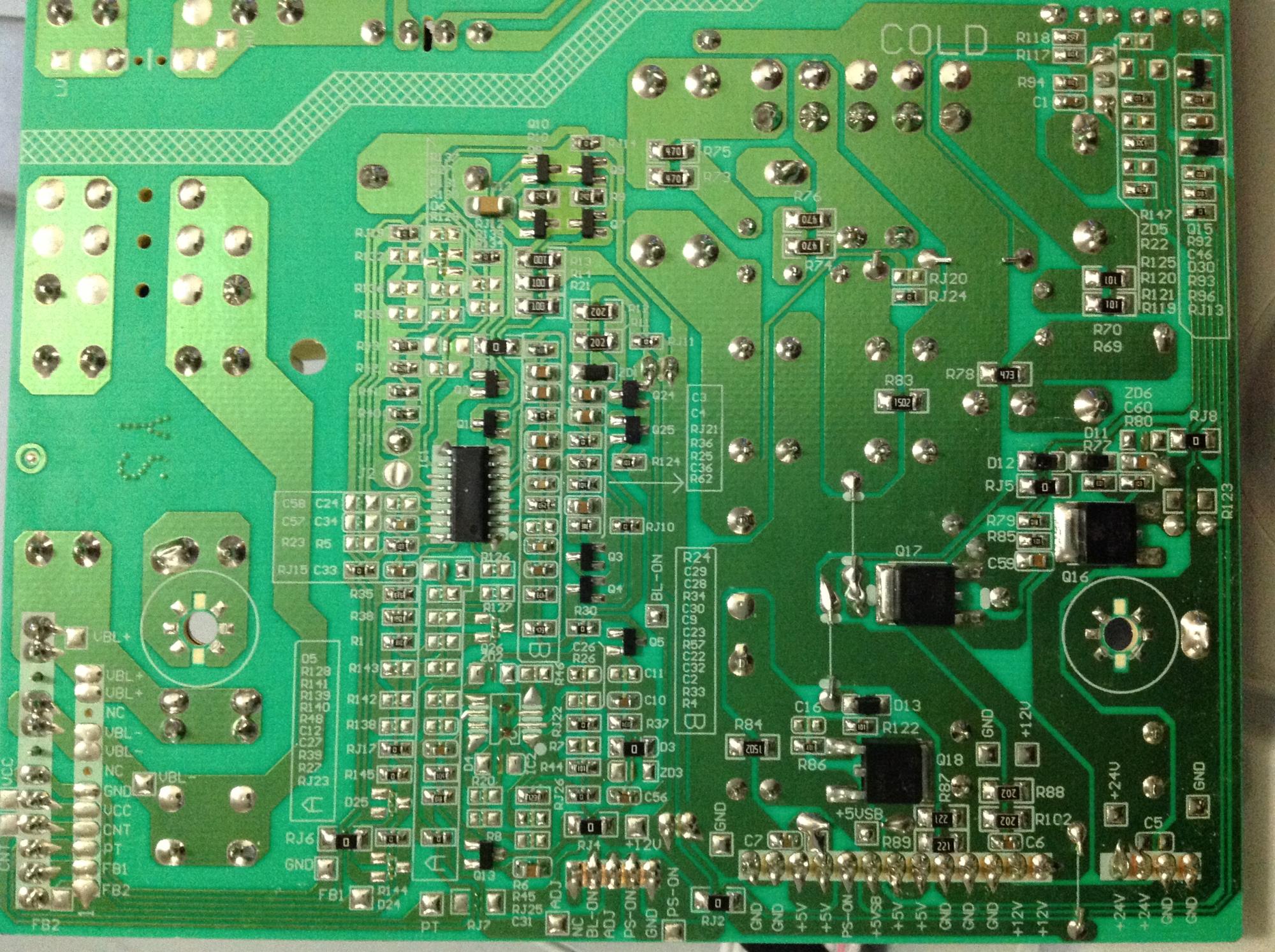

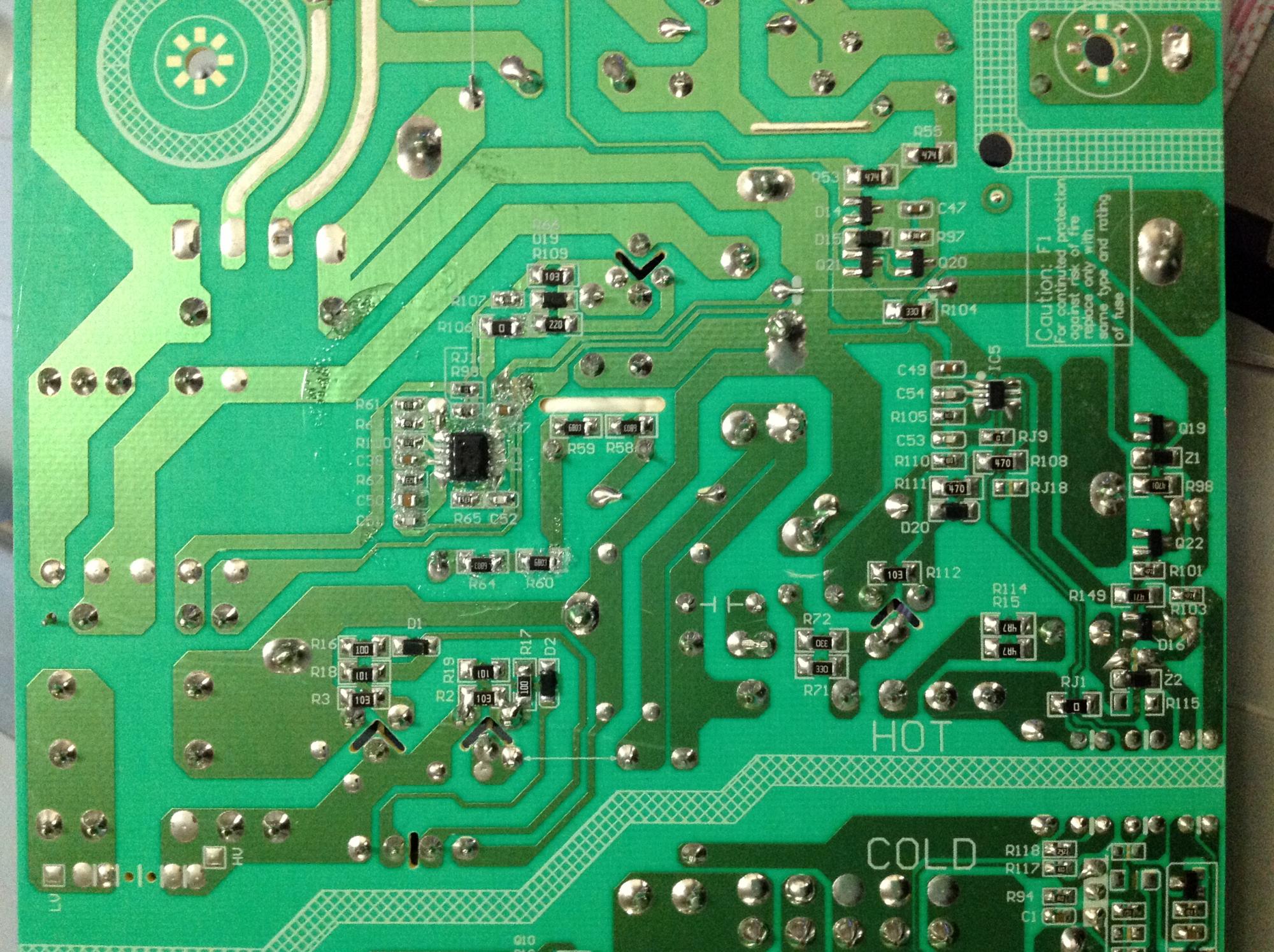

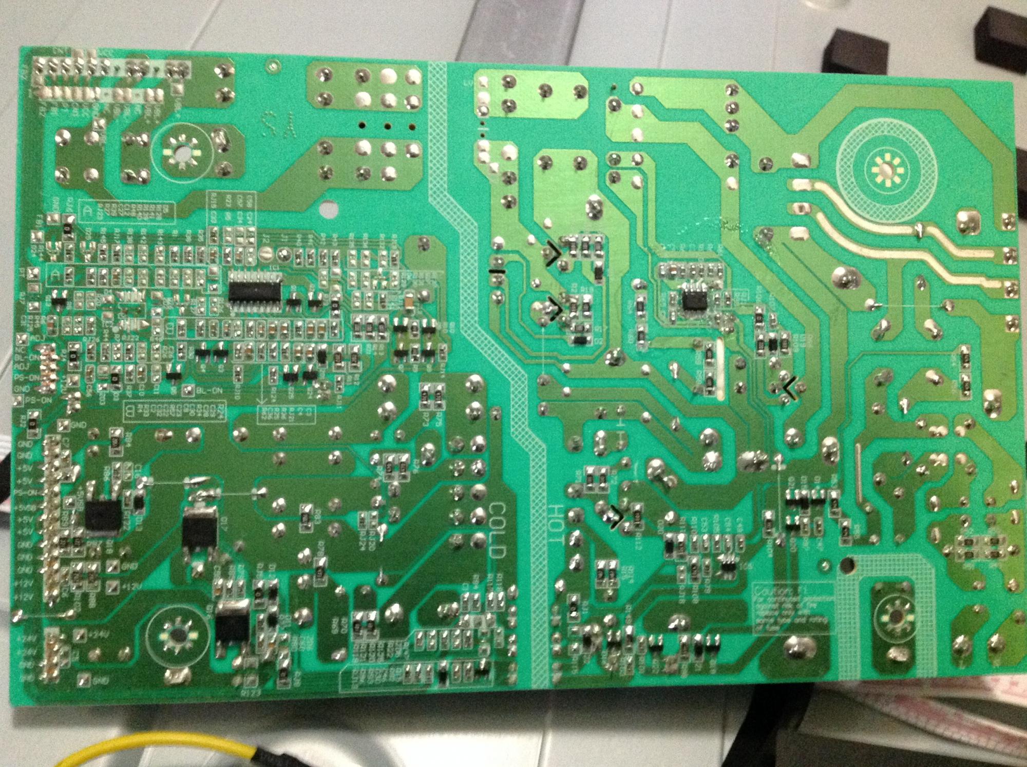

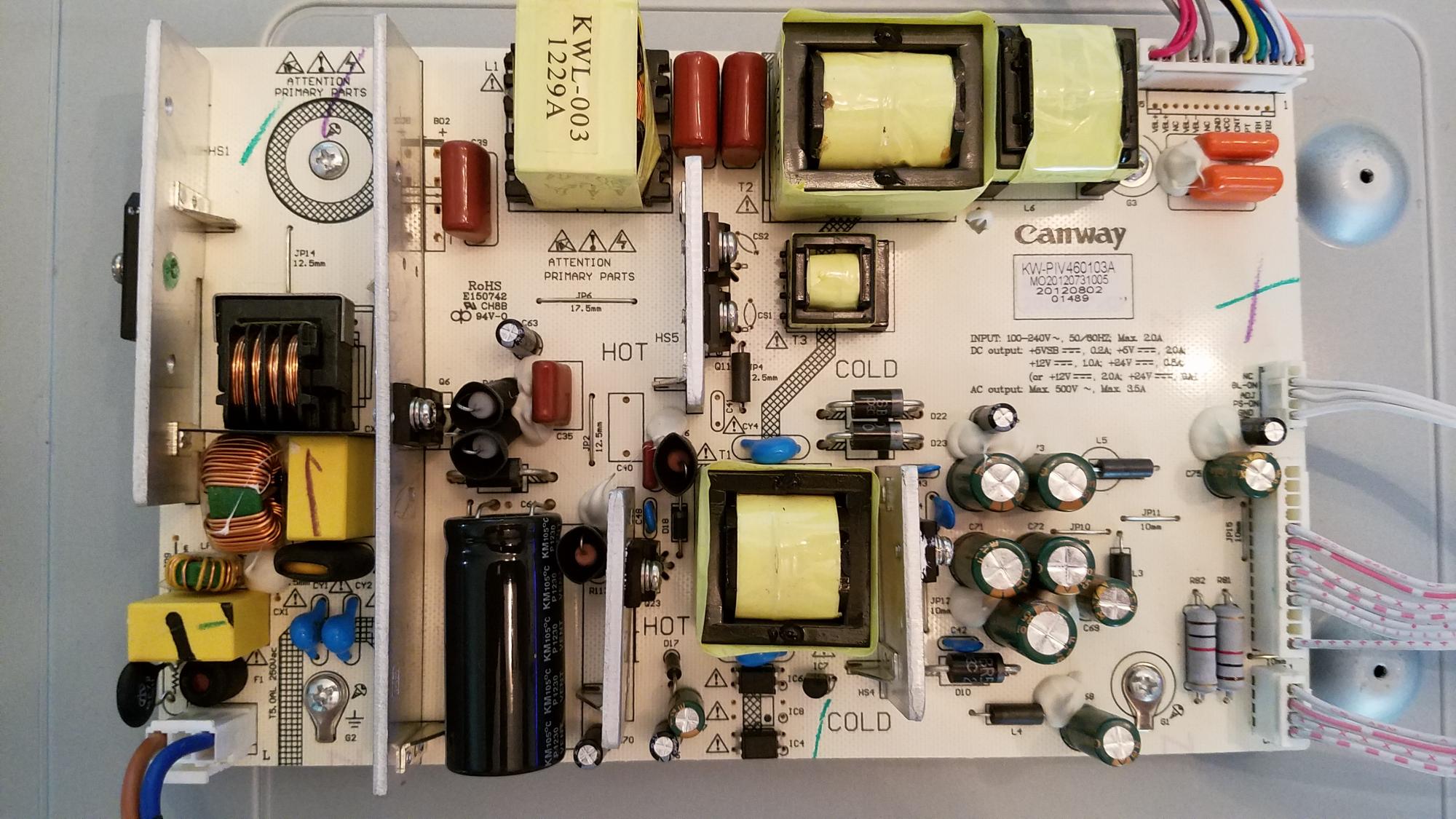

                That does look as though it's a bad power supply. Can you post a good picture of the underside of the power supply. Can't find a schematic for it so may be a difficult one to fault find.
                • Lrojas
                  • Aug 2017
                  • 23
                  Re: Sceptre X505BV-FHDU8HJ1L01
                  Full board
                  • Lrojas
                    • Aug 2017
                    • 23
                    Slit toe closer, 3 parts.
                    Bottom right is 120v in
                    • Lrojas
                      • Aug 2017
                      • 23
                      Part 2
                      • Lrojas
                        • Aug 2017
                        • 23
                        Part 3

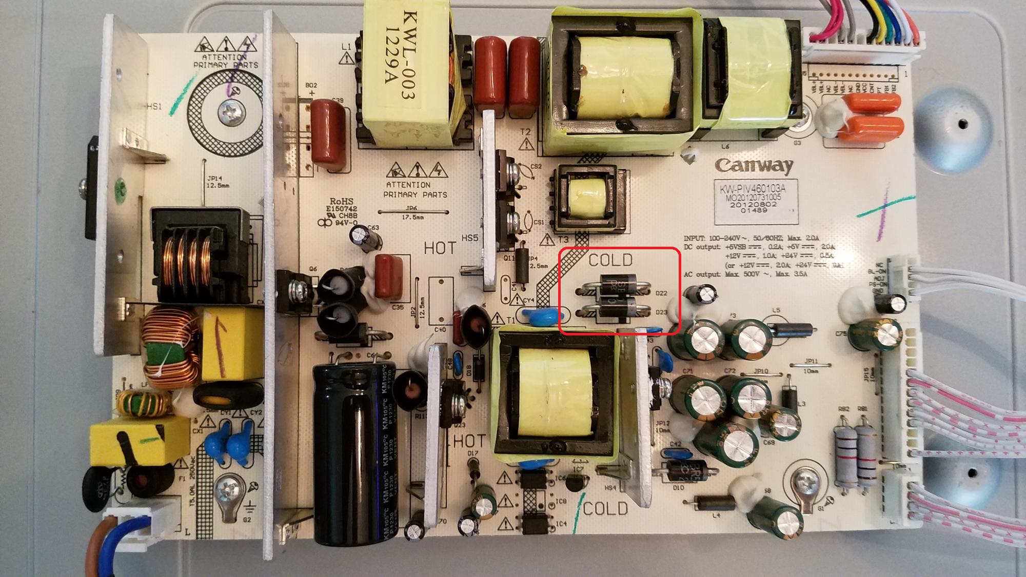

                          There are a lot of RJ resistors on the underside of the board. With the set off, check with your meter set to ohms, that they read 0 ohms or close enough.
                          With the set on, what dc voltage do you have on D22 & D23, black probe to chassis.
                          • Lrojas
                            • Aug 2017
                            • 23
                            Ok so in my frustration and non patient self. I turned in the power supply board that I thought was non-functioning and received another. It didn't fix it.
                            I admit that I couldn't find D22 or D23 anywhere. I found D21, but not the others.

                              D22 & D23 location

                                  D22 & D23 location
                                  Oh hell, I'm a dummy I have been focusing on the backside lol. Now I really feel dumb.
