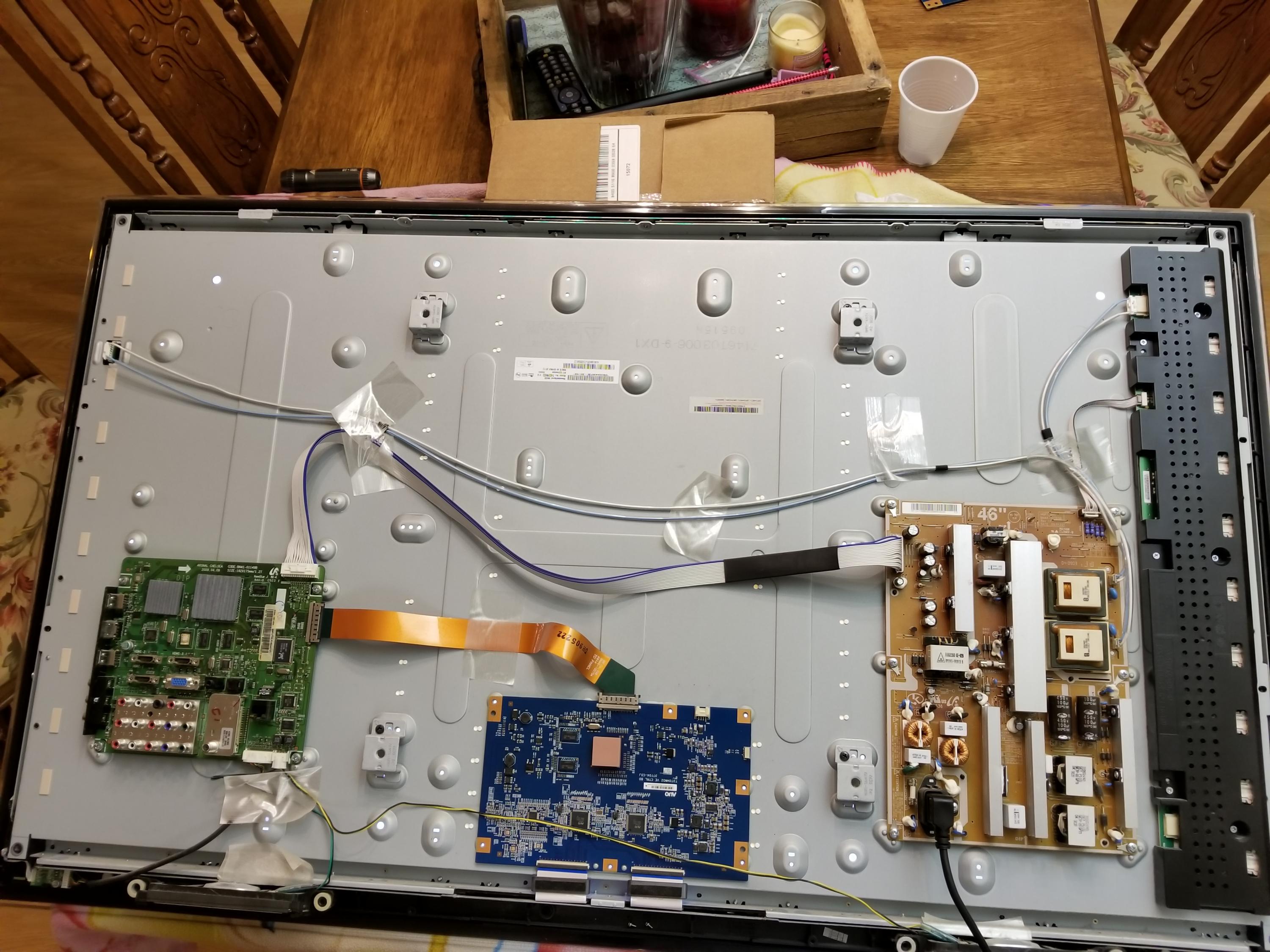

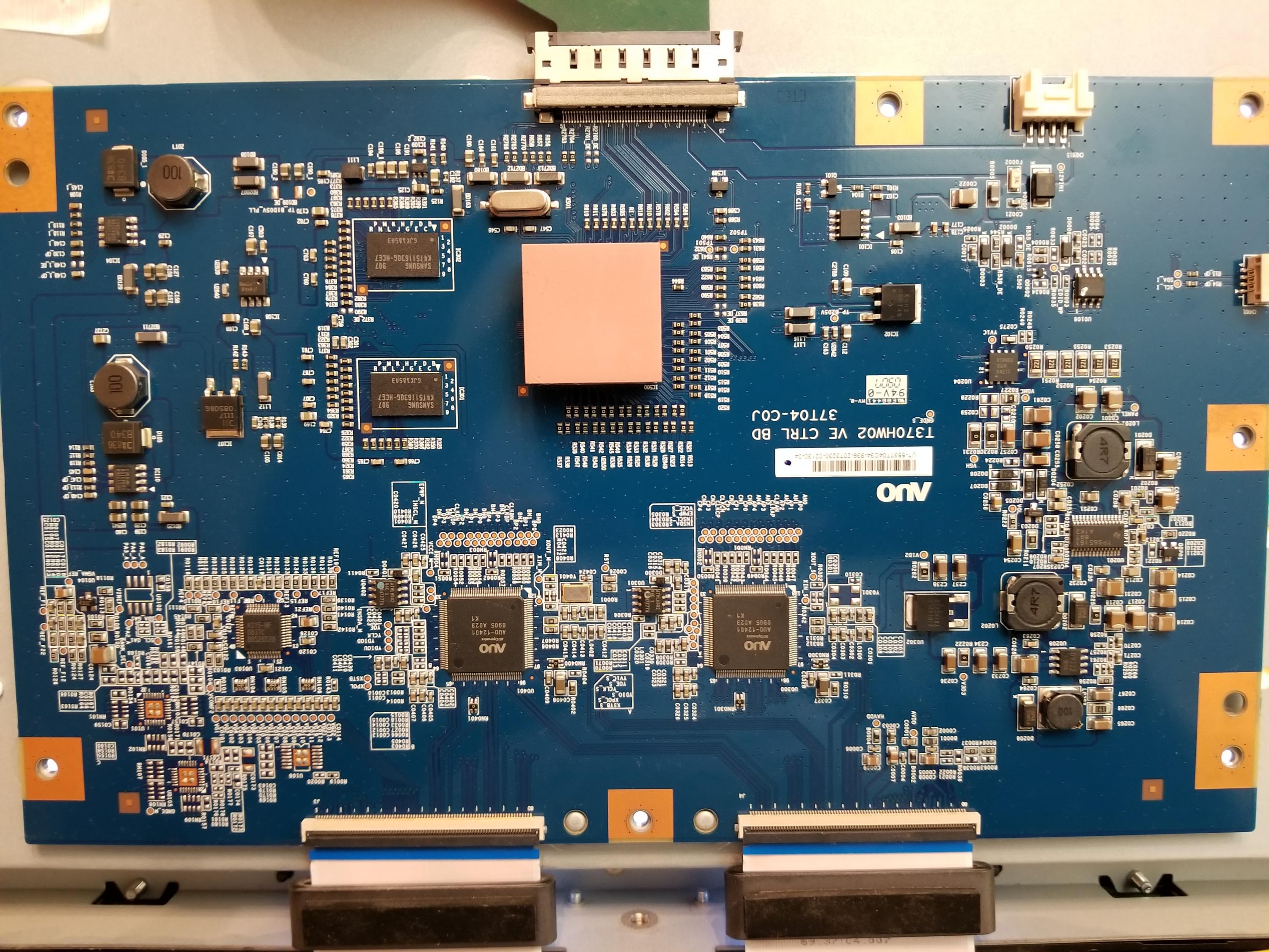

    Reaching out once again to you TV gurus, I picked up this Tv from a friend and the picture worked great starting out but then would start becoming white washed, (negative image). After reading on here I decided to try and replace the as15 ic chip. So my limited experience caused me to fail as when I put it back together I lost the picture, I still had backlights but no more picture. I'm guessing I had bridged pins or incomplete solder joints on the pins. I then decide just to order a new tcon board. I got it today and nothing changed. I have backlights but no picture and nothing shows when pulling up source or menu. I disconnected the lvds from tcon to panel and I got words on the side still connected (though it was completely whitewashed). Got the exact same when I tried disconnecting the other lvds cable from the panel. Not sure where to start troubleshooting because I fear me messing up the as15 chip I may have caused another problem. Thanks in advance I will post pictures from my phone.

    Re: Samsung LN46B640R3F NO PICTURE
    Here are the boards

          Do you have 12v on the tcon fuse ?
          • Redrebel10
            • Jun 2017
            • 89
            I see no fuse on my tcon board, which one are you referring to using the picture I provided.

              ok, lets start with the voltage readings of the vg test points. from 1 to 22 in dcv. they are next to the as chip. these are your gamma voltages and will let you know if your as15 chip is working properly.

                your t-con fuse is f0002 and is just below the 4 pin connector to the t-con. i would expect it to be good though since you have partial screen operation.
                  these are the only test points I saw, grounded to chassis
                  1 7.3
                  2 7.8
                  4 7.8
                  6 7.8
                  8 7.8
                  10 7.8
                  11 7.6
                  12 7.1
                  13 7.2
                  15 9.3
                  17 4.9
                  19 12.9
                  21 15.7
                  22 15.8

                    12.4v on f0002 fuse
                      that is a bad AS chip. just out of curiosity, can you disconnect the ribbon cables that go to the panel and retest.
                        sure can
                        1 7.3
                        2 7.8
                        4 .01
                        6 2.6
                        8 7.8
                        10 7.8
                        11 7.8
                        12 7.1
                        13 7.2
                        15 9.6
                        17 1.1
                        19 13.1
                        21 15.8
                        22 15.8

                          bold are the changes with both lvds ribbon cables disconnected from panel
                              unfortunately the voltages are still bad. the voltages should form a curve if graphed out and these results are far from that. looks like you got a dud board.
                              you can always link this thread to them to show that you have actually tested the board.
