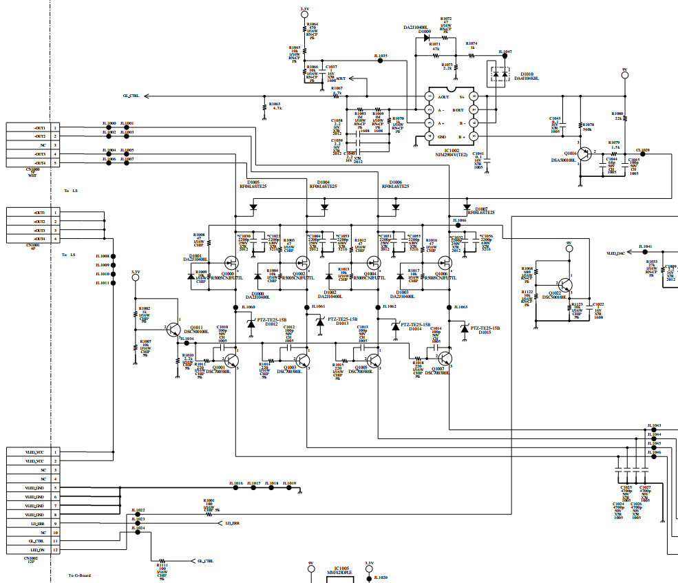

    Connections on LD board:
    CN1001 (4pins)+122V each
    CN1000 (5pins) four pins+28V each
    What confuse me is CN1001 voltages. They suppose to be negative but it is +122V each.
    I think the problem is somewhere around here.
    I appreciate any opinion.

    Re: Sony Bravia KDL-40EX720 no backlight
    There are no negative voltages. The "+Out" indicates the power to the leds and the "-Out" is the return connection from the leds.
      Thanks for the clarification.
      So it looks LD board and screen leds are okey.

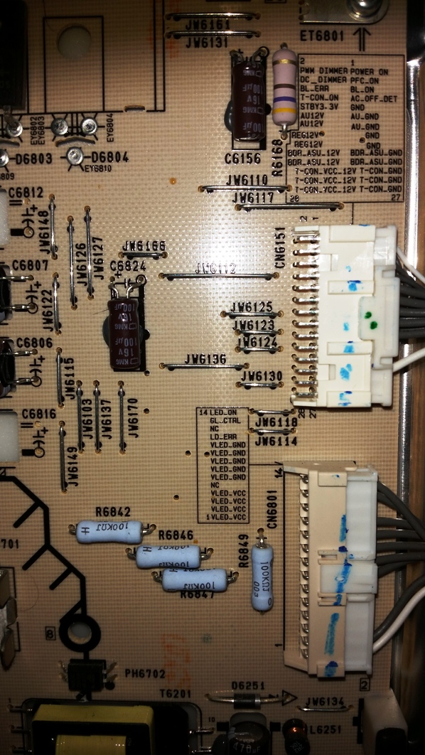

          I checked supply 12V on conections CN6151 and CN6801. All of them 12.5V.
          Power on/off 3V/0V works.

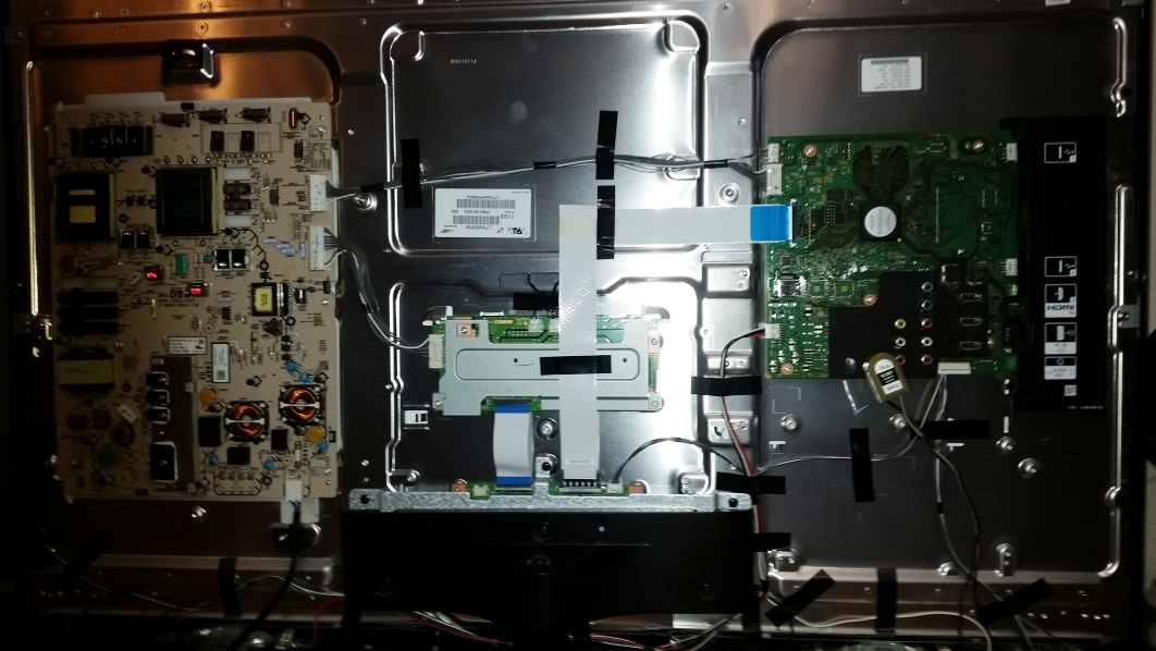

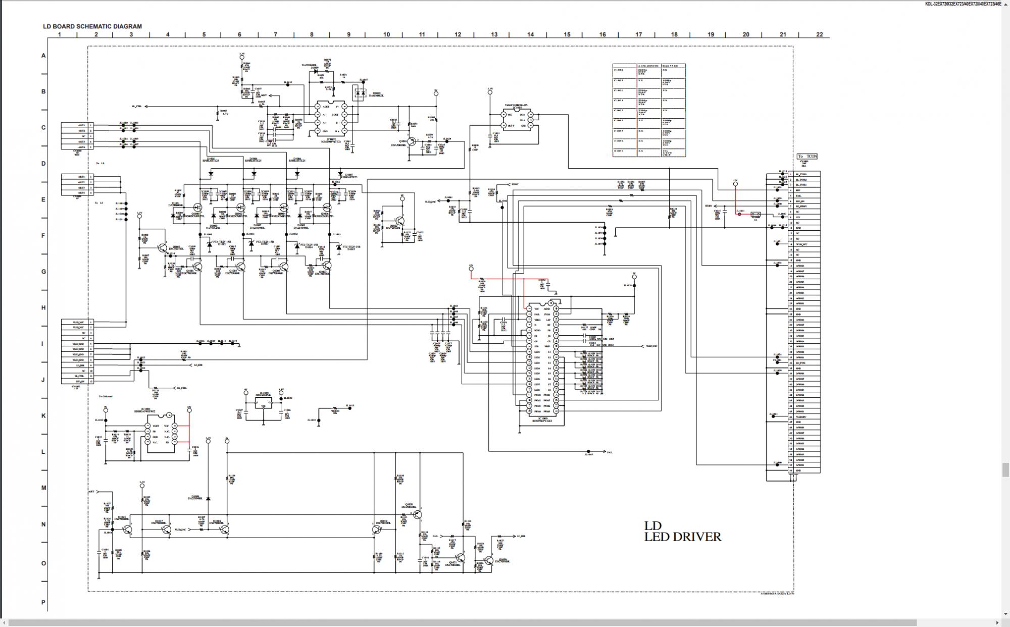

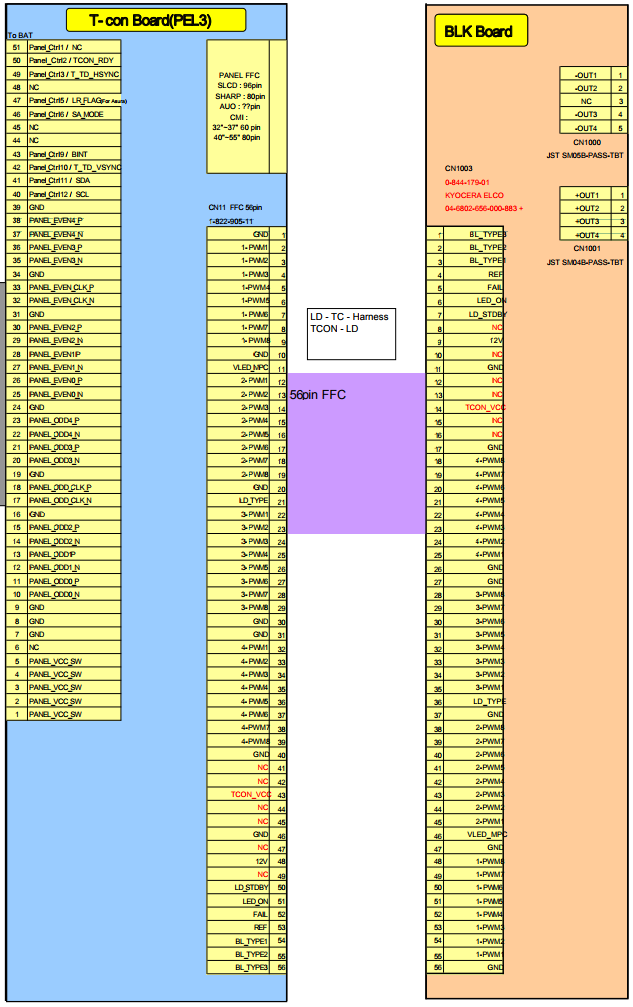

                Can we see the pictures of the whole back side of the TV showing all the boards?
                What DCV do you have on
                CN1002:
                LD_ERR
                LED_ON
                GL_CTRL
                CN1003:
                1-PWM1
                2-PWM8
                3-PWM1
                4-PWM8
                Also leave the probe on one of the (+OUT) and record what you read when the TV is OFF and when the TV is turned on to see if it goes up to more than 122v and then drops down to 122V or less.

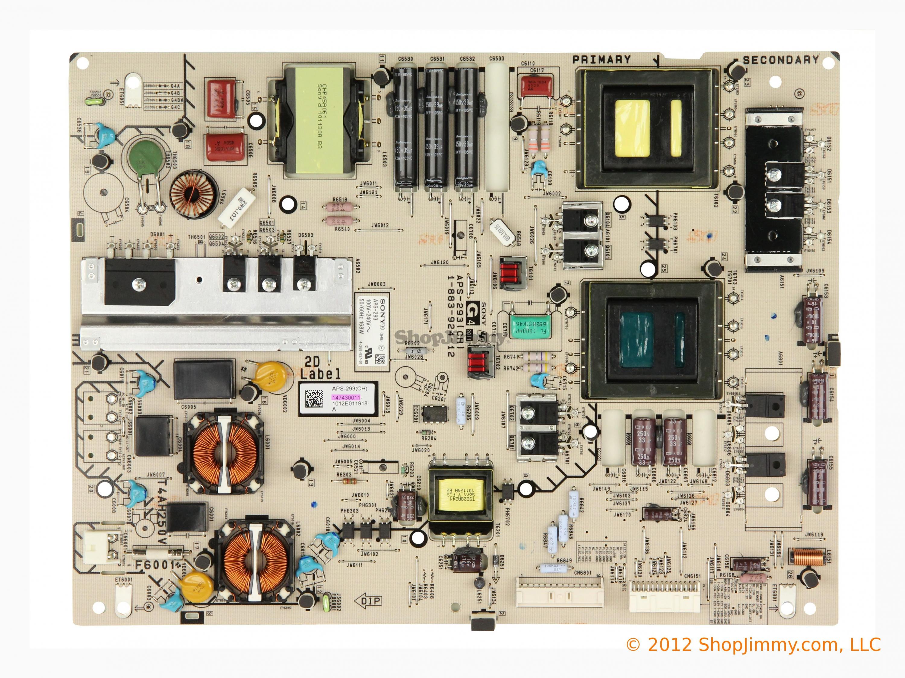

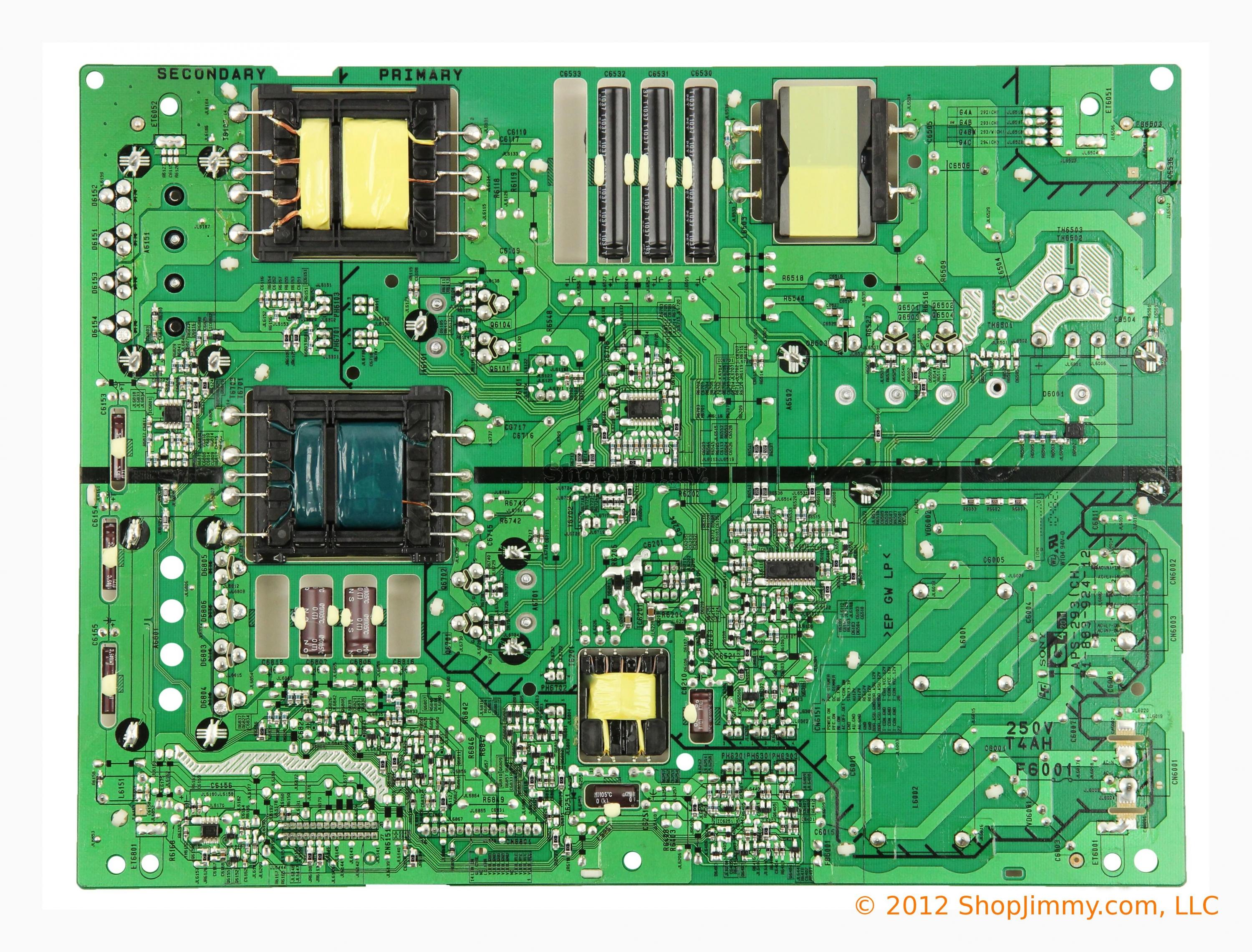

                  Is this your power supply board?
                  Sony 1-474-300-11 (APS-293, APS-293(CH)) G6 Power Supply.
                  Pictures provided by shojimmy.
                  • olegau
                    • Aug 2017
                    • 15
                    Yes, that is my power supply board.
                    • olegau
                      • Aug 2017
                      • 15

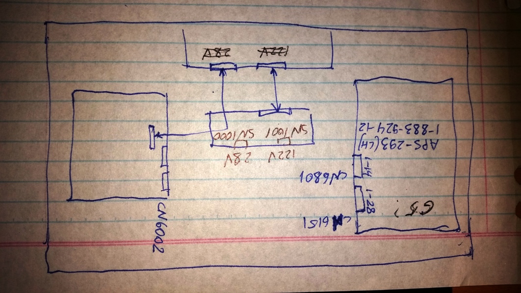

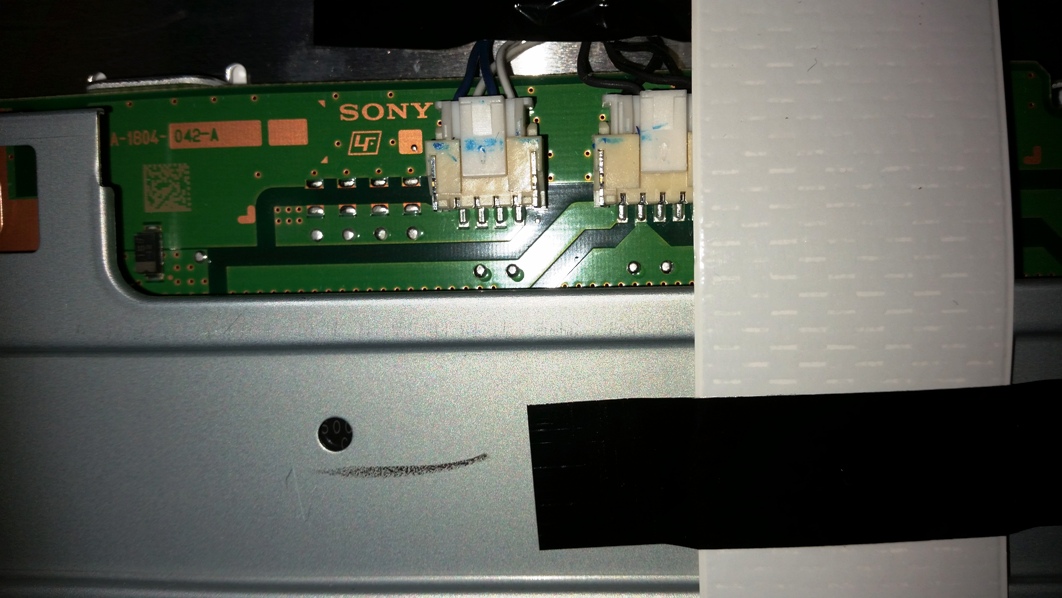

                      Pics of the TV:
                      General view
                      Connections of PCU
                      Connections of T-CON
                                Measurements:
                                CN1002: off/on
                                LD_ERR 0/0V something moving around 0 Volts
                                LED_ON 0.1/3.3V
                                GL_CTRL 0.7/0.0V
                                CN1003: off/on
                                1-PWM1 0/3V goes up slowly from 0V to 3.0V
                                2-PWM8 0/3V goes up slowly
                                3-PWM1 0/3V goes up slowly
                                4-PWM8 0/3V goes up slowly
                                "Also leave the probe on one of the (+OUT) and record what you read when the TV is OFF and when the TV is turned on to see if it goes up to more than 122v and then drops down to 122V or less".
                                All measurements of connection SN1001 show quick jump voltage from approximately 0V to 140V and then quick down to constant 122V.
                                  The booster circuit is working, I need to look at the LED driver board circuit in more details to give you the test points.
