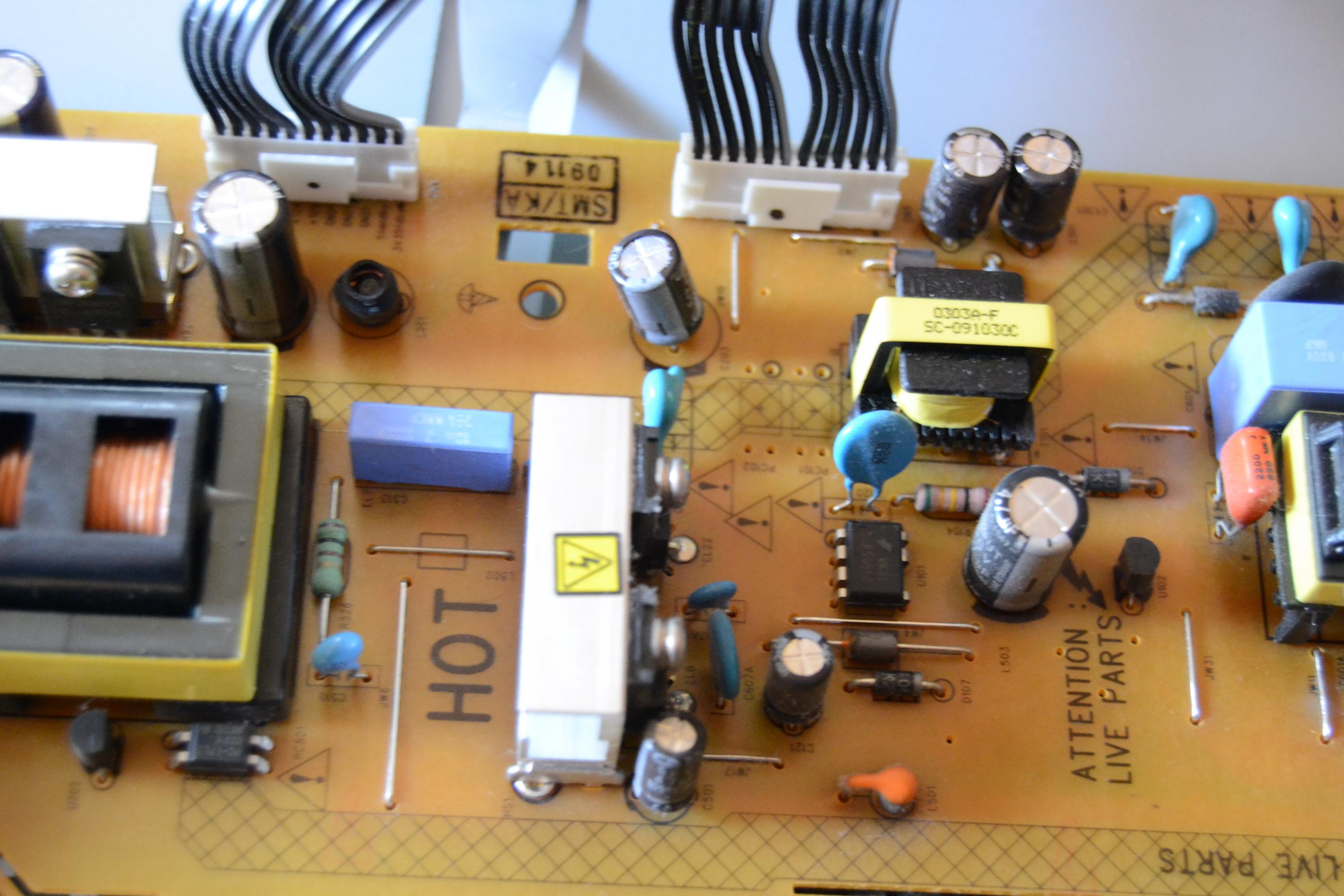

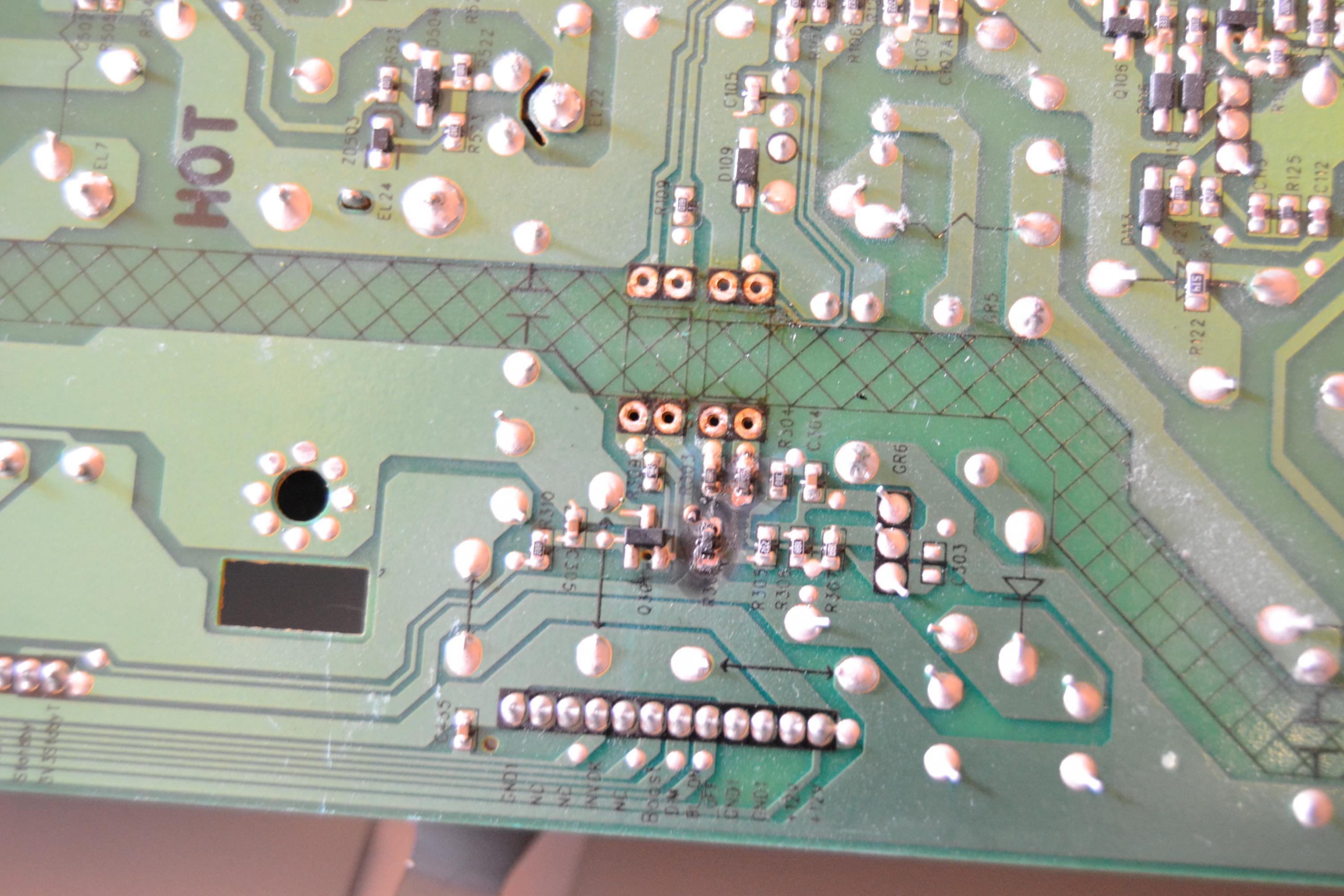

    Thunder flash kill my TV. 2 PC-17 optos are dead , PC101 and PC 102.
    Opposite side is 2 SMD component black, resistor I suppose.
    I didn find shcema for this power, another pcboard on tv yes.
    Does anybody have this power schematic diagram with component layers on board.
    I removed optos already, these black components are same place but oppositside
    Thanks, and I stay waiting
    Ismo

    If you are asking for id of resistors they look to be readable under magnification.

      Re: Philips Q43.1E LA and PLHL-T807A power
      I do not have schema where values of components are listed.
      • dskall
        • Oct 2016
        • 2905
        • usa

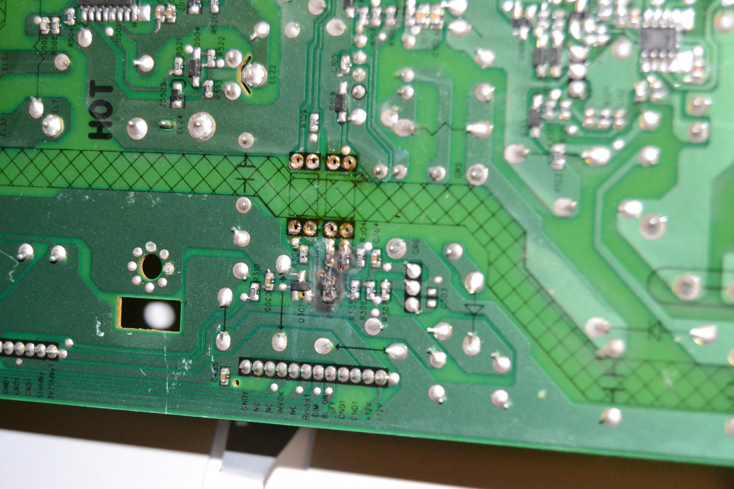

        Can you take clearer picture?
        • ila6910
          • Aug 2017
          • 7
          • Finland
          I hope this is enaugh.
          • R_J
            • Jun 2012
            • 9624
            This schematic is for a PLHL-T827C but that part of the circuit looks close so it might help
            • ila6910
              • Aug 2017
              • 7
              • Finland
              Ok thanks.
              It seems to e same.
              Must next clean PCB and check
