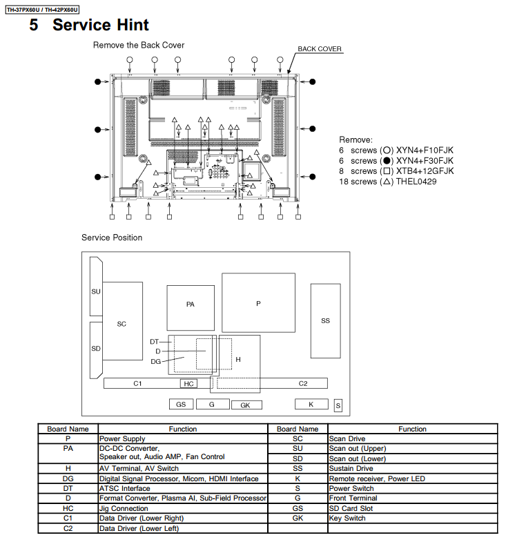

    Tried to upload the service manual I'm using but it exceeds size limits. It's available here: https://elektrotanya.com/panasonic_t.../download.html

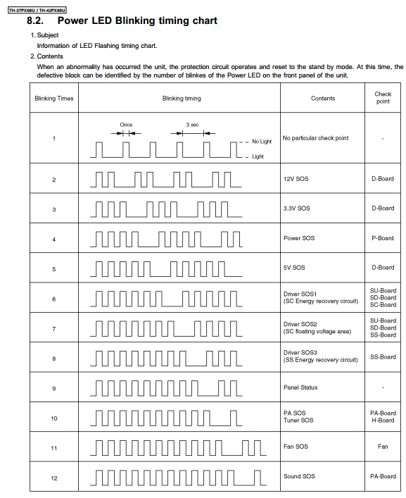

    The blink code in the manual states "no particular test point." I took measurements from the power board.

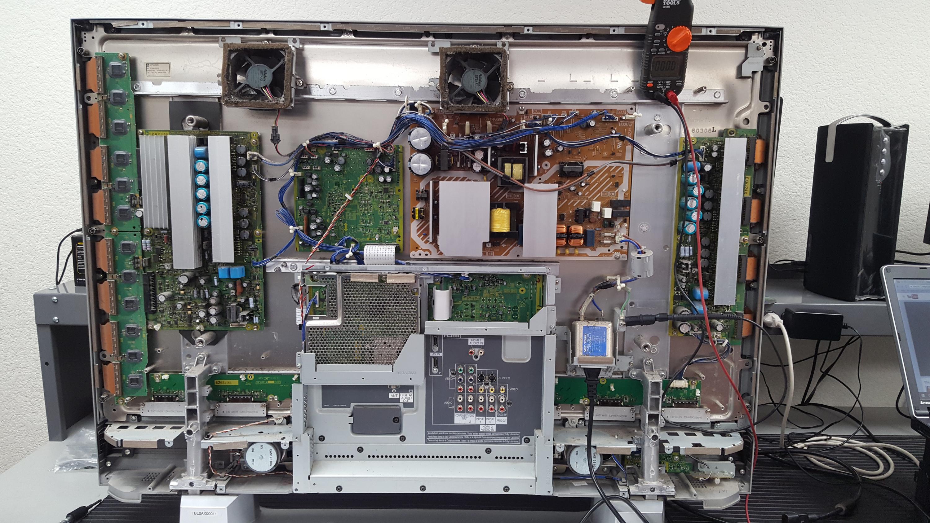

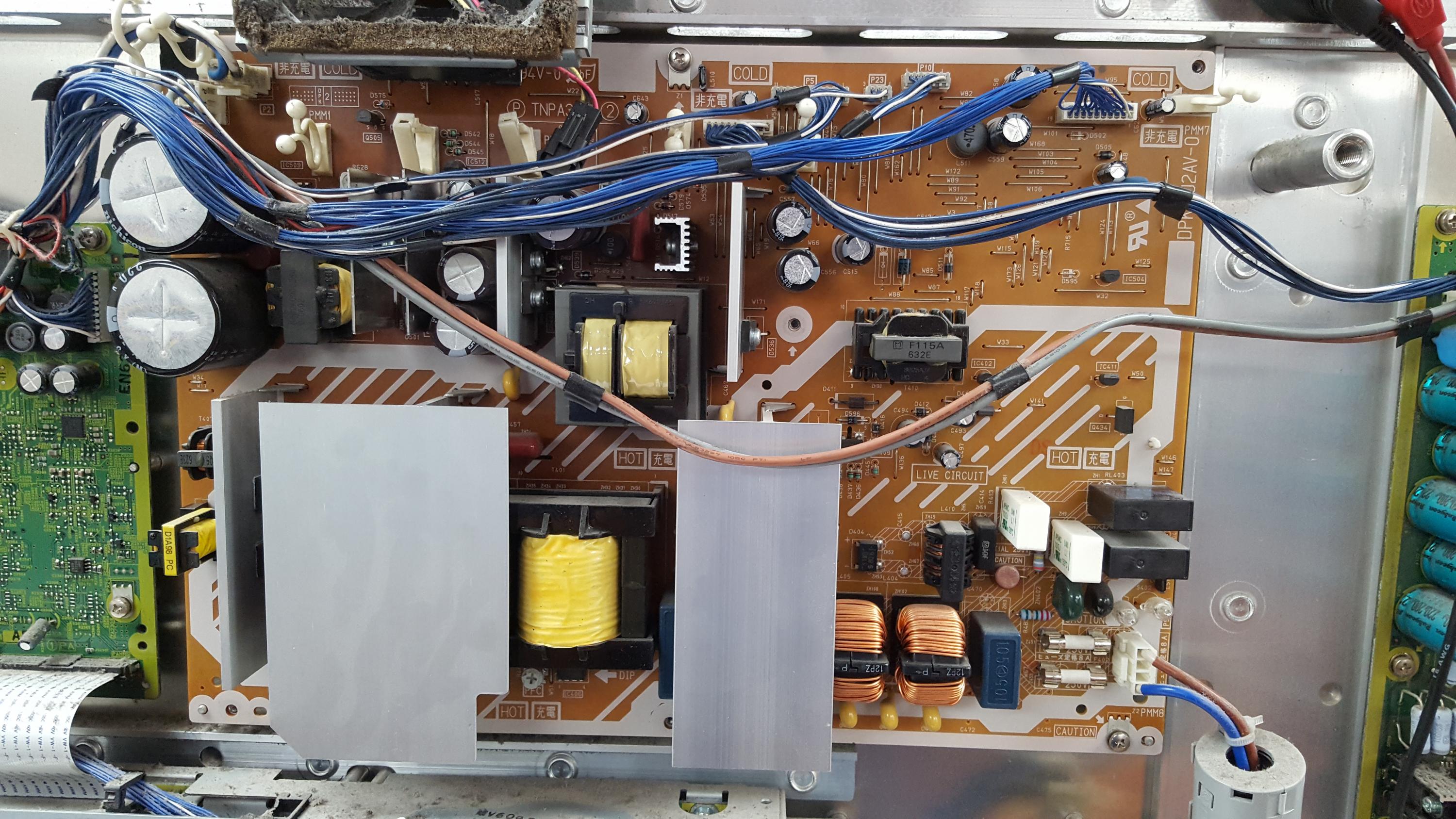

    Re: Panasonic Plasma TH-42PX60U - red LED blinks every 3 secs (no picture/sound/light
    Pics...
      In the TH model I'm working on 3 blinks means loss of 15v rail.

        Thanks, brother. I'm also lacking 15V. However, I don't have 3 blinks, I have 1 blink every 3 seconds (see attachment).
        Bit the bullet and bought a "working" P board on eBay for ~$50 (couldn't find another TNPA3911 in stock anywhere else).
        I'll report back if this solves things. I wouldn't mind giving you the old P board if you want.
        EDIT: Forgot to mention I disconnected SU/SD boards from SC board and the same problem persisted. Re-seated EVERYTHING. Problem persisted.
            The repair kits they sell on eBay, and at Coppell, consist of 2 fuses, a RJK5020 mosfet, (Q406) and a 10 ohm 139°c resistor. About $13. I don't know if that is for the 15v rail.
            Check your parts and report back.
              I bought the whole P board from electroparts_warehouse on eBay. I just put it in and the same problem persists.
              I saw the kit, but the fuses are all good (there are 4 on the board). I'll test the MOSFET.
                Generally 1 blink is an A board issue. The "no particular check point" refers to an unknown problem with the A board initialisation. Could be a problem with other boards, but those tend to trip up the other error codes. Most commonly would be a software or hardware issue with the A board that prevented it fully booting so you are having it fall back on the "general error" part. I guess it's the same as a PC blue screen. "I'm not sure what went wrong, but something did!"
                  Ah, very good to know! The BSOD analogy makes sense. Thank you. I'll try ordering the A board.
                  EDIT: Forgive me, but which would be the A board in this case? The H board? The D board? The attachment shows boards/functions.
                    Hard to say, I'd think the set should trip an other code if H is bad, so DG seems likely...I guess which has the big main processors on it? The D board is for the panel only so not likely to be that.
