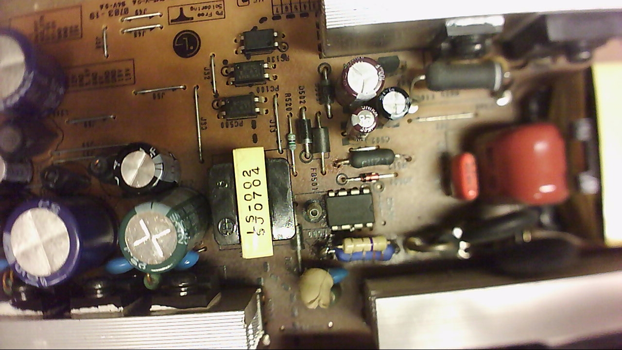

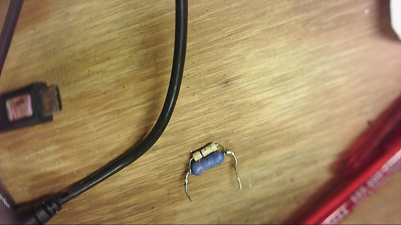

    Looks like a 1 watt flame proof

      I can put one 1/2 watt 2R2 or 2 -1/2watt 4R7 whats your thoughts on that?
      I got 10,000 resistors here, 1/4 watt 1/2 watt, 1 watt, 2 watt, 5 watt, some 10 watt, couple of 20 watt..... and another 4000 SMD various sizes and NO MATTER WHAT I NEVER HAVE THE ONE I NEED ARRRRRRRRRRRRR!!!!
      I can't even pair the 1 watts to even get close.. OMG I'm about to rip a few power supplies from my pile apart... back in a few

        Re: LG 23LS7D - DOA nothing.....
        try the 2.2 1/2 watt, if it survives, then either install the correct one or put the 2 4r7 in parallel
          used a 4.7 1/2 watt piggy back on a ceramic 1 watt 3.3 ... I used the meter till i found a pair that's 2.1.....
          About to give her the old try... if magic smoke?.. well I just wish I had video...
          only thing missing is duct tape.. LOL West Tennessee style right!!

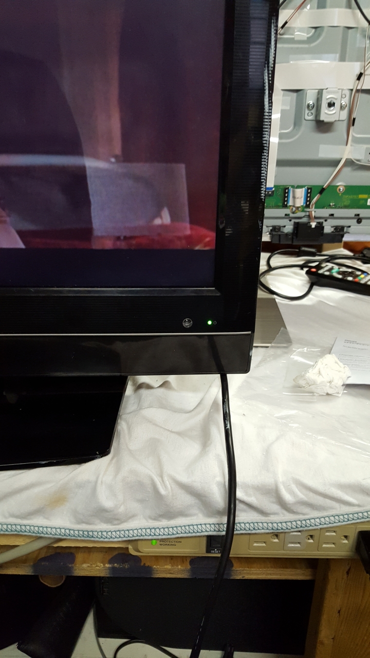

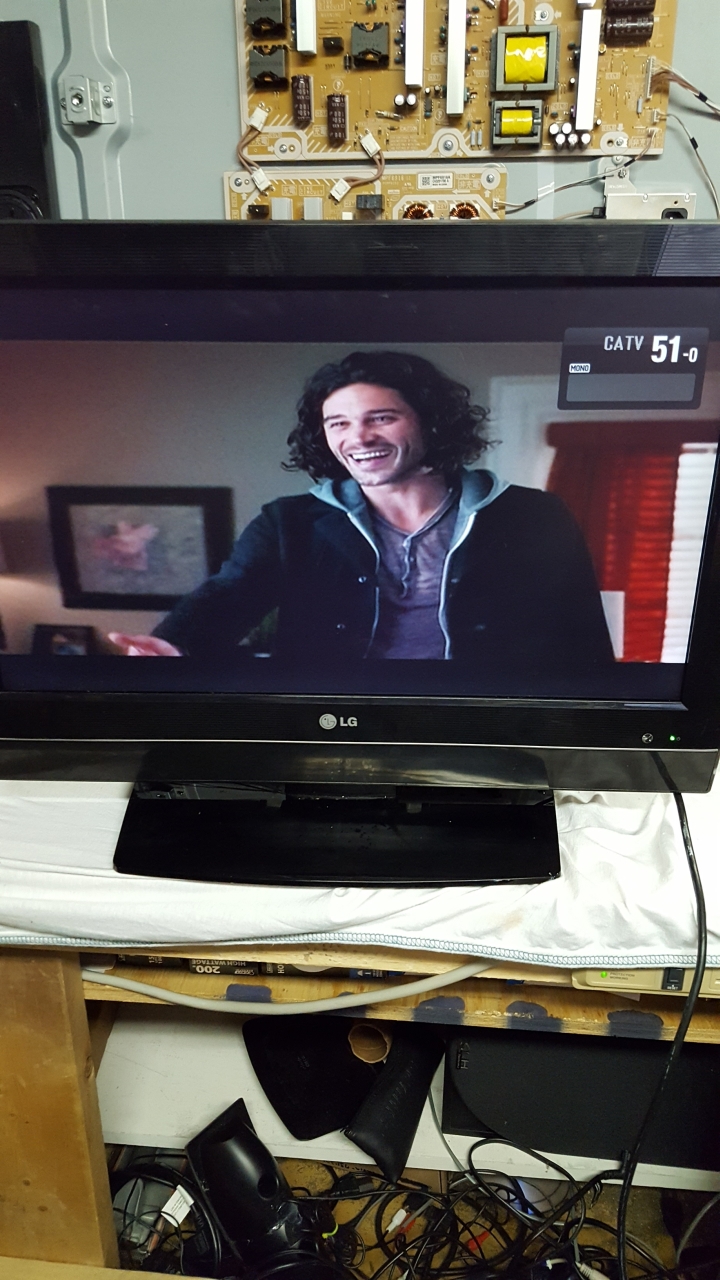

            HEY GUYS!!! We got standby and no funny smells!!!!
            Putting the screen in now
            BEAUTY!!! You guys are all badazzes!!! Thank you!
            I learned a lot today and I really needed a win if you know what i mean.
            Plus this young woman will have more to use for her kids school stuff (she did not ask or complain when she brought it in but you can tell when $30 is a lot to somebody)
            It looks good for it's age we got-er-done fellas!
            I post all this hoping it will help or encourage the next person who needs help so....
            Until next episode...
