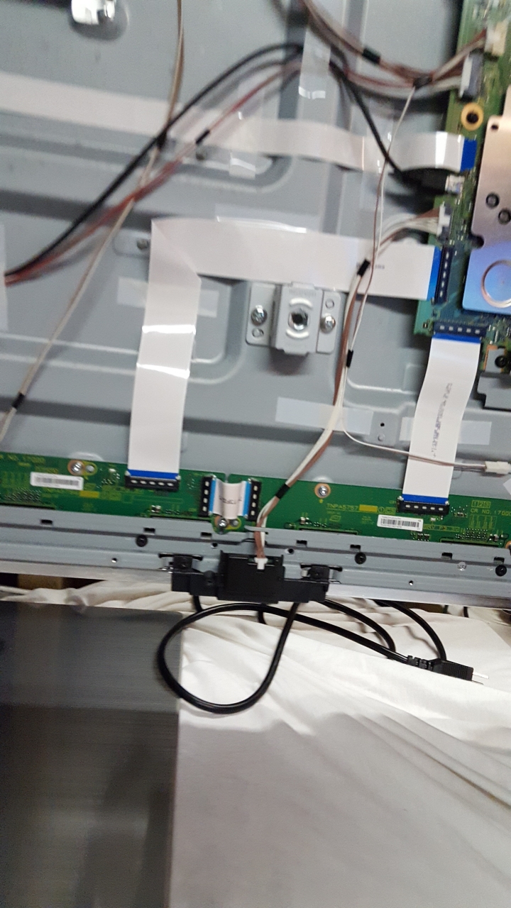

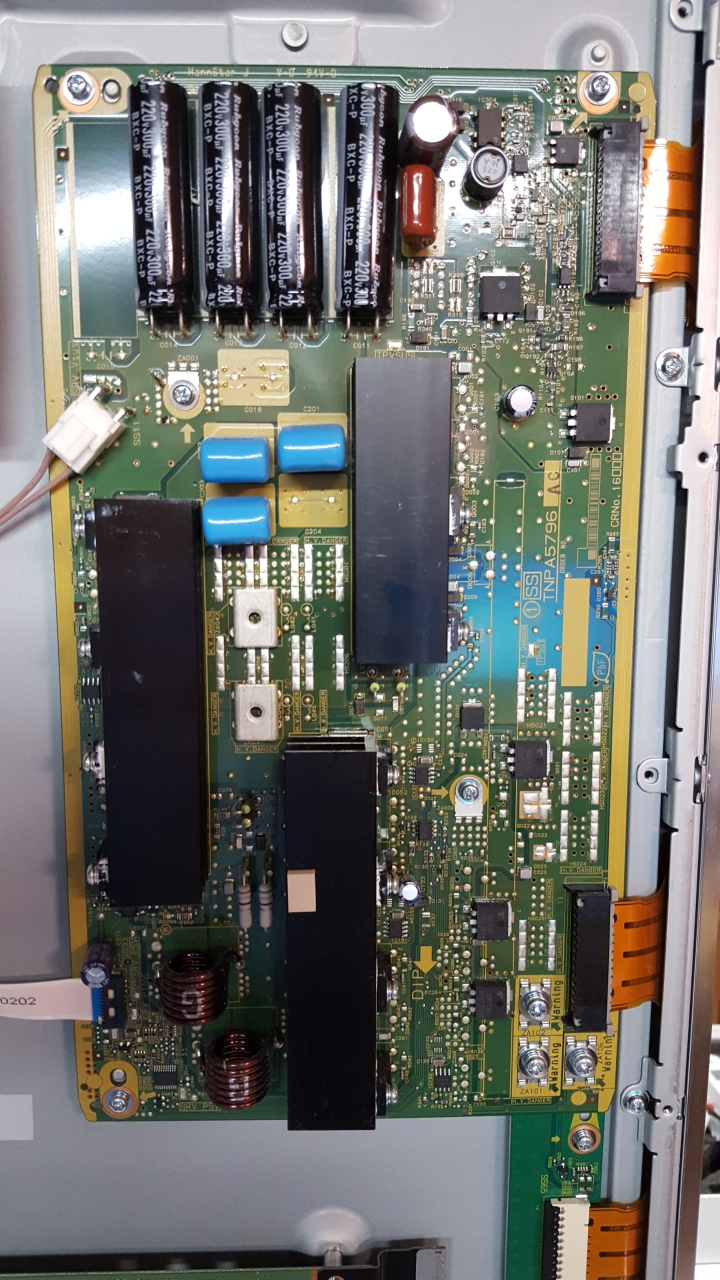

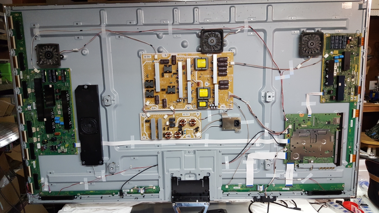

    Got this beast (literally) in friday evening. Did the routine disco of SC board.
    Blinks change to 6. When I disco the SS board Blinks change to 8. when I disco both blinks also go to 6. when all is connected blinks are 7. Just wanted to get this post started so i have not searched for a service manual yet and am just about to check voltages. I see a lot of these panasonic plasmas having these issues. This is a last gen so the screws have washers and lock washers BUT some were as much as a half turn loose. Did not help this case. I will post more info as I test things.

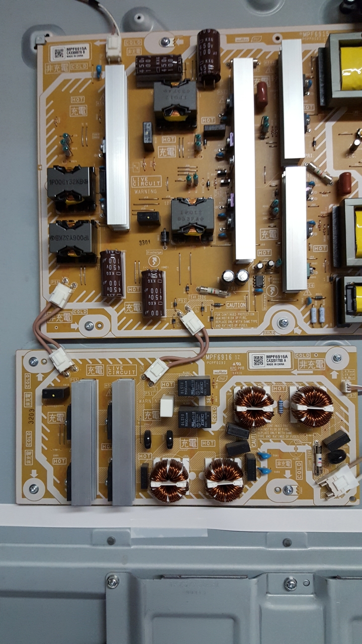

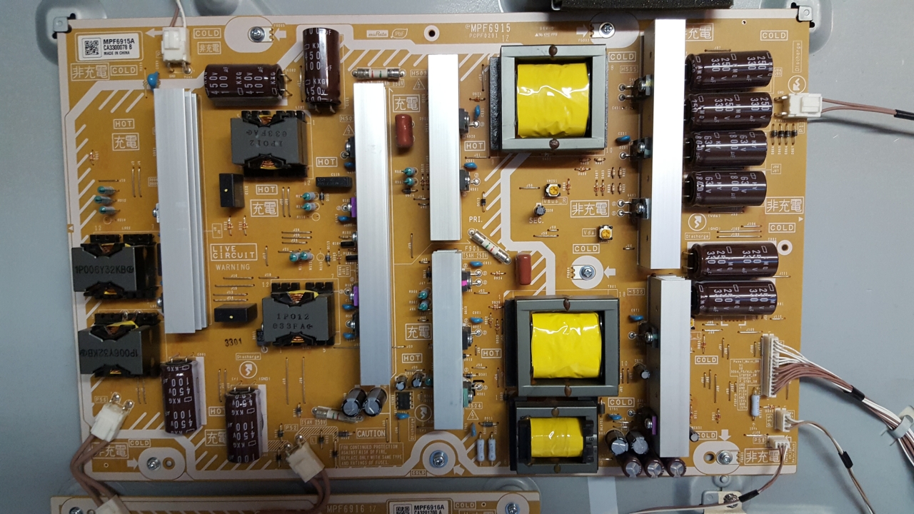

    When I plug it in. Relays click on then back off. The voltages to SC and SS board connectors go to 180 V (maybe more it spikes the starts drifting back down to eventually 0v) Same with 15.v on the P5 connector to main board. 5v stdby is stable but 4.5v instead of 5v. Also noted there is 15.5V at the P57/P58 jacks (runs from lower PWS to Upper and are marked Relay_main, EV_15v, Relay_Rush (three pin connector)
    When SC/SS board power connectors are disconnected no change in voltages.

            OK there is NOT a dead short on the SC board. Some of the octo couples read funny though but there are several on here but i (in diode mode - in circuit these are 4 pin smd)
            red on pin 1 blk on pin 2 - .9 on some 1.0 on some a couple were like .7 one was .6
            blk on 1 red on 2 - some read open (like I'd expect on a normal diode) others and several read almost the same as when reversed 1.0 .9 and such. These are all the smd 4pin 356T.
            I think the readings are ok being they are in-circuit and they were from locations all over the board.

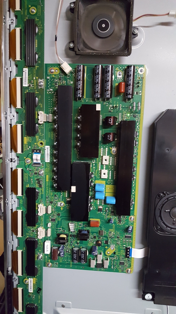

                Out of the rabbit hole and up for air.... I think it is one of the buffer boards. I can't tell which one but the signal to and from the main board are switching and the flow chart has me at SD/SU or Bad Panel. On the jack that connects the ribbon cable to the main
                There is a jack marked SC50.
                You MUST DISCONNECT SU and SD buffers COMPLETELY from the SC board then jumper that jacks pins together and plug in the machine. The chart says if light still blinks it is "possibly" the SC board. If it turns on and fires the back lights it is SD/SU or Bad Panel. I know I know just enough to be dangerous and am not to proud to ask for "experienced input" at this point. Would really like to make the right call on this diagnosis rather than buying two boards one of which i do not need. (my usual old way)
                These boards have that crappy epoxy seal over the chips but if it was a different component fail I could fix it, including the tiny 605 SMDs. While I await some kind assistance I will remove both buffer boards and begin my microscopic search for ???
                I attached the Panasonic diagnosis help sheet, it just has some helpful information and would benefit many other models and other guys like me.

                    so follow the instruction s, isolate the buffers and jump sc50. Make sure the Vfg bolts are also removed from the buffers.
                    Now if it stays on, SC should be ok, then get your meter and set diode, on each buffer board place one lead on the gnd plate and slowly slide the other across the face of each and every pin of the output ribbon connectors watching for a dead short.

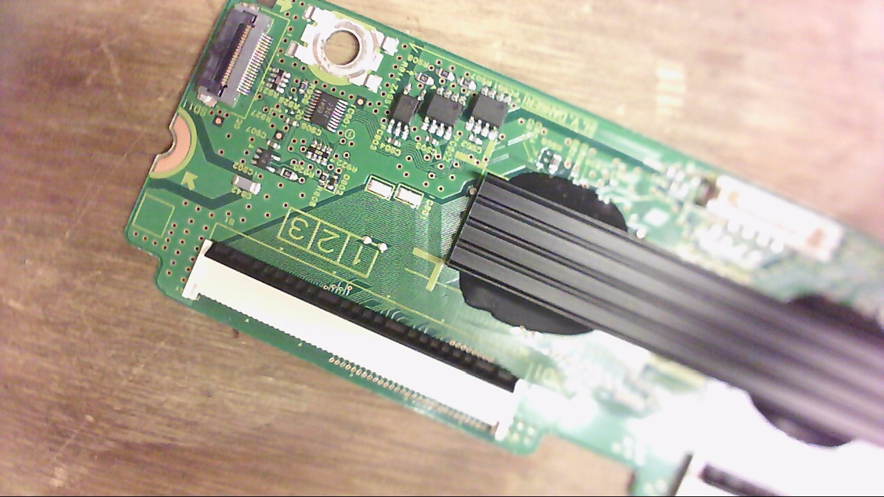

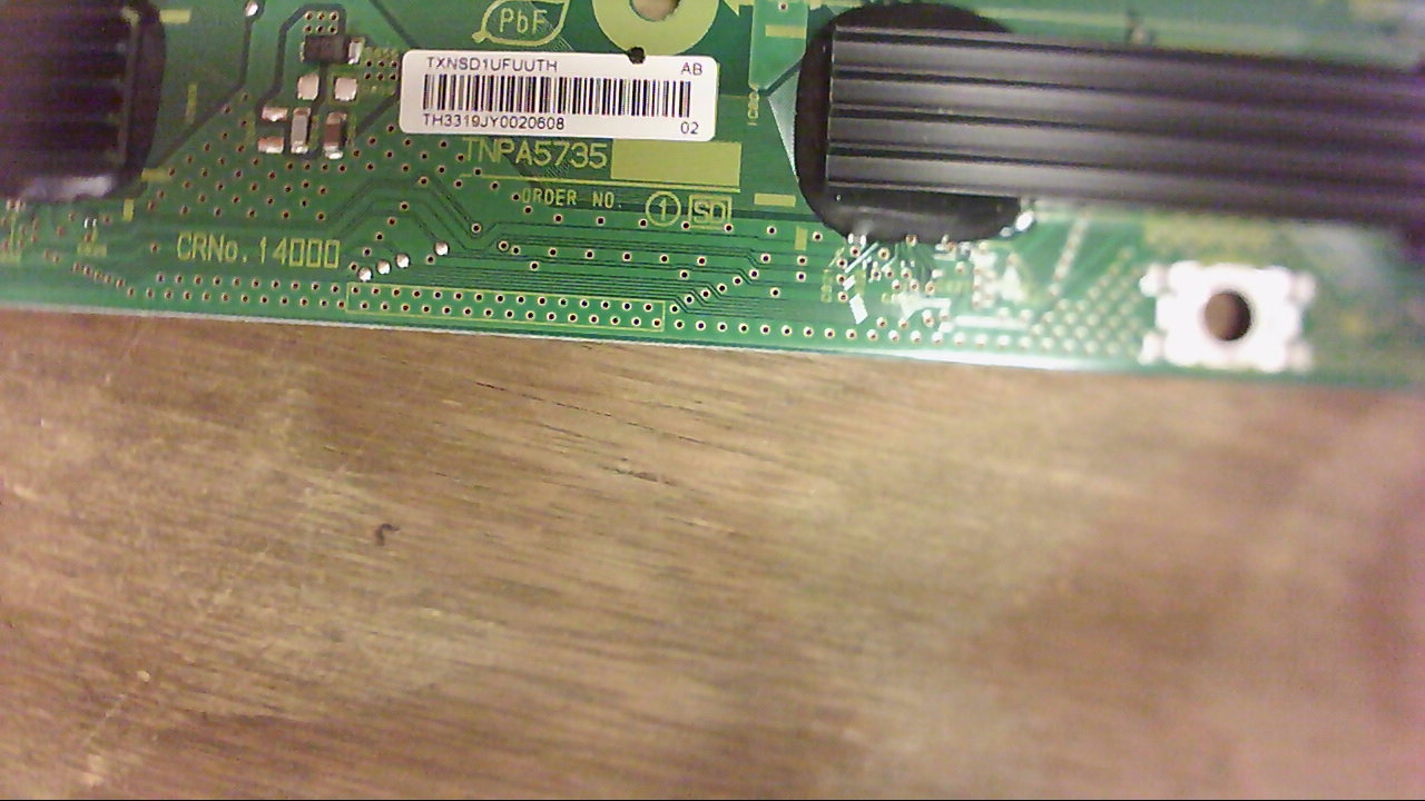

                            Yes I did the jumper before i posted and yup it turned on and back light was on. One question though. It came on immediately when i flipped on the power strip, is that normal for this model?
                            Thanks for the tip to rake the pins, all were ok EXCEPT the top one on the SD board. I had already tediously and with the microscope tested every single tiny speck of a cap or other parts and found no short. A lot of times a SMD cap will short when bad. I could not identify PC901, 902 and 903... no datasheets came up on google search so I do not know if their good.
                            About 5 or 6 pins beeped and read full short on the top plug and under the scope it look like those traces go directly under the black epoxy to the IC Top one. Also bottom half of the pins to the other IC were not shorted.
                            I am going to order this board with a little more confidence than usual. I'm just sad I couldn't repair the board itself, but not worth the trouble with the epoxy and all.
                            Thoughts??

                                It's the chip that has failed , not the caps/resistors etc! The chip is relatively cheap , around $20. Its a lot of work to replace it.

                                  As per Moreno, sounds like the top buffer IC failed. Very tricky replacing those and getting all that sealant off keeping the tracks intact. I've done several 2011 boards, couple of disasters destroying the tracks and a near miss

                                    FINAL UPDATE:
                                    The new lower buffer board finally came from SJ so i installed it this evening and am very happy to say we have a beautiful picture, no blemishes and shes' burning in well right now.
                                    A good diagnosis is great and while I may have made more effort to change that IC, after scraping at that epoxy crap for two days I am actually glad I didn't.
                                    It's good feel reasonably sure when you buy a board for these plasmas. I've been burned by more than one.
                                    Thank you folks for all your help as always you ROCK!
                                    Status = Fixed.

                                          Did a few checks like hold the power button on for 60 seconds, hold the - Volume while holding the menu button, no luck, still@ blank grey screen as the screen lights up very vague.
                                          I also hear a few clicks.
                                          I also think my parents said there was a thunderstorm and the TV failed after that.
                                          Section 6 in the service manual talks about power and no screen,...
