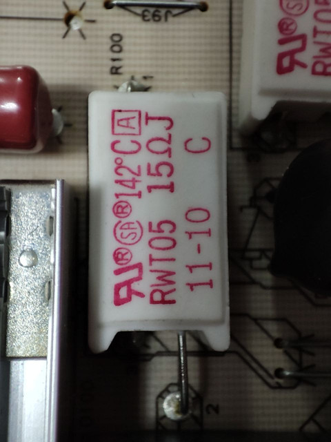

    I am just triying to fix this Panasonic. I will tell what I have done until now.
    I have checked the SN BOARD and I found some Transistors shorted and I changed them all.
    At the same time I saw that the PSU is also broken as it blows the T4AH250V FUSE. So I will have to change the 2 R6015ANX MOSFETs, so I need to buy them on internet because here I could not find them
    I am confused about fixing this Panasonic. What I know is that the SN BOARD is not in Shorted if I check the main source connector. I also checked all the connectors to the screen but are all ok.
    I am a novice and not professional for that reason I am looking forward to hearing some advices from all of you.
    What do you recommend to do? First, I need to wait the 2xR6015ANX.

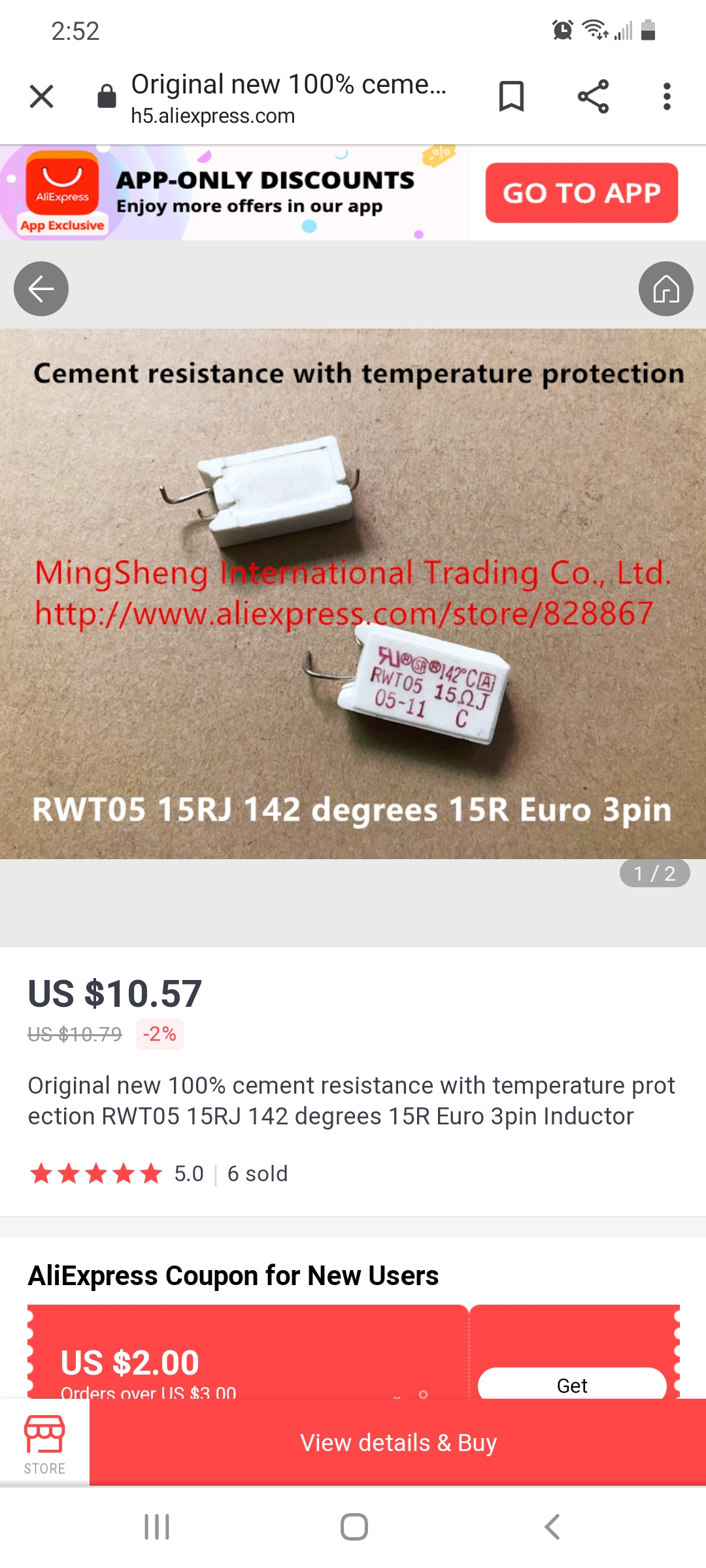

        I have been following the Alpengeist-tvrepair.blogspot Blog.
        But I have discover a problem with the powerboard.
        There is a Thermic Resistance(3 legs) that is impossible to find I wonder if there is a way to handcrafted one
        • tvtimmy
          • Mar 2015
          • 1160
          • usa
          Re: Panasonic TX-P42VT30E 7 blinks of death
          Here you go.
