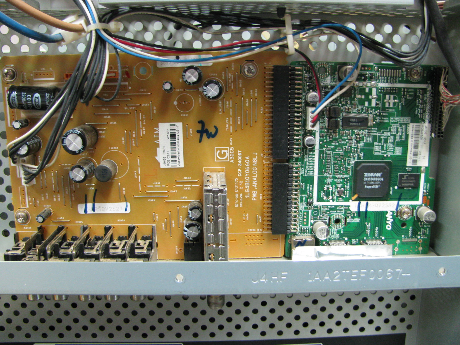

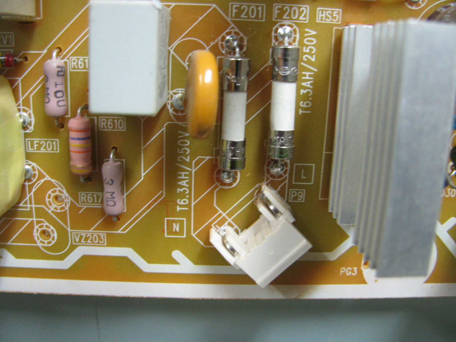

    Sanyo DP42740 keeps blowing the two fuses at the main power cord connection. I have replaced both and they continue to blow when I plug in the power cord. With everything disconnected from the power supply board, I connected each cable one at a time to try to determine when they blow. When I connected the analog board the fuses blew. Don't know if this has anything do with it or not. Any ideas? Thanks in advance.

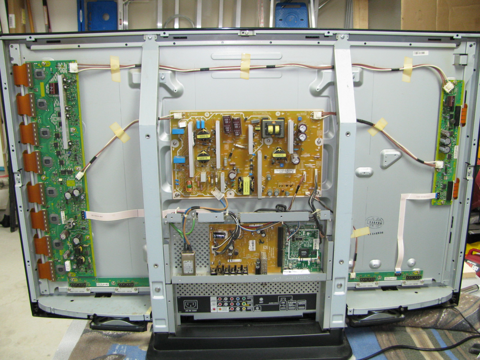

        Re: Sanyo DP42740 keeps blowing fuses
        Need picture of whole back of tv
        • JunkmanJimbo
          • Mar 2017
          • 194
          Okay I will get it now, thanks.
          • JunkmanJimbo
            • Mar 2017
            • 194
            Here's the picture you asked for.

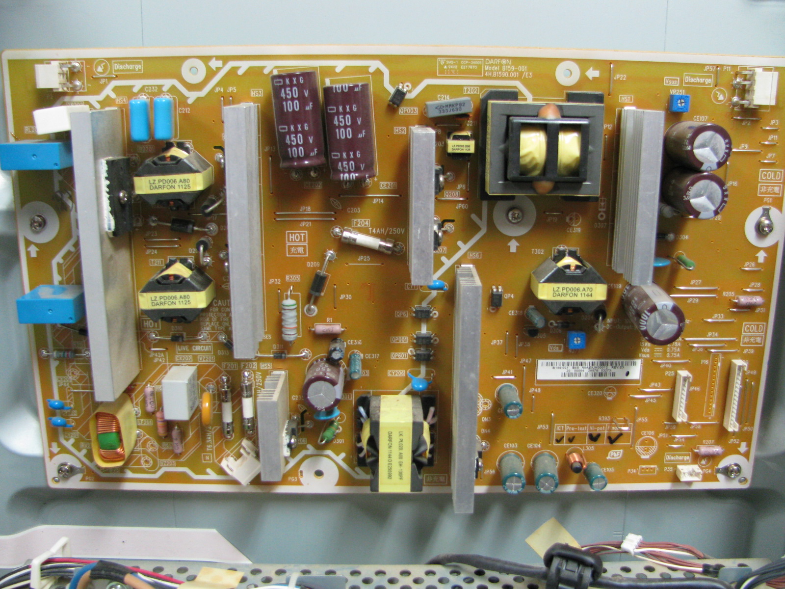

              If you look at this TV as a Panasonic Hybrid it makes sense. The Analog board would be sending the command to latch the 2 relays which applies mains, sounds like the power board FETs will be shorted out and who knows what else. That's where I'd start. shopjimmy does a kit for common failures.
