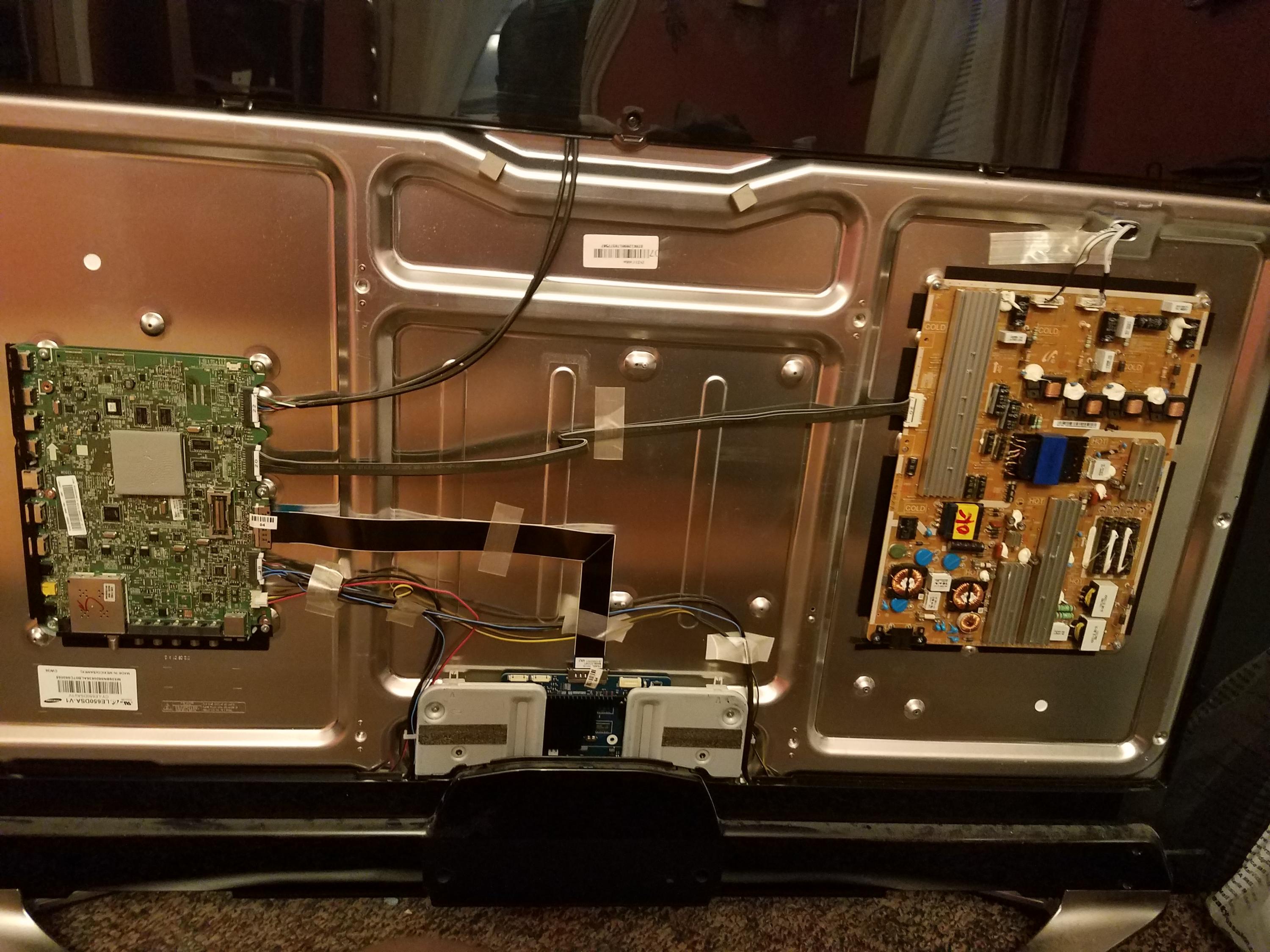

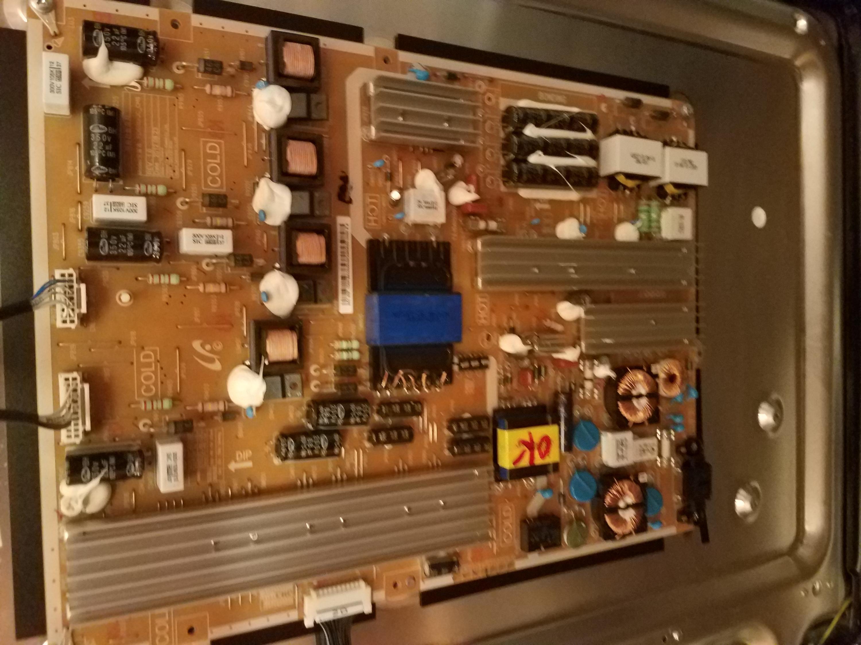

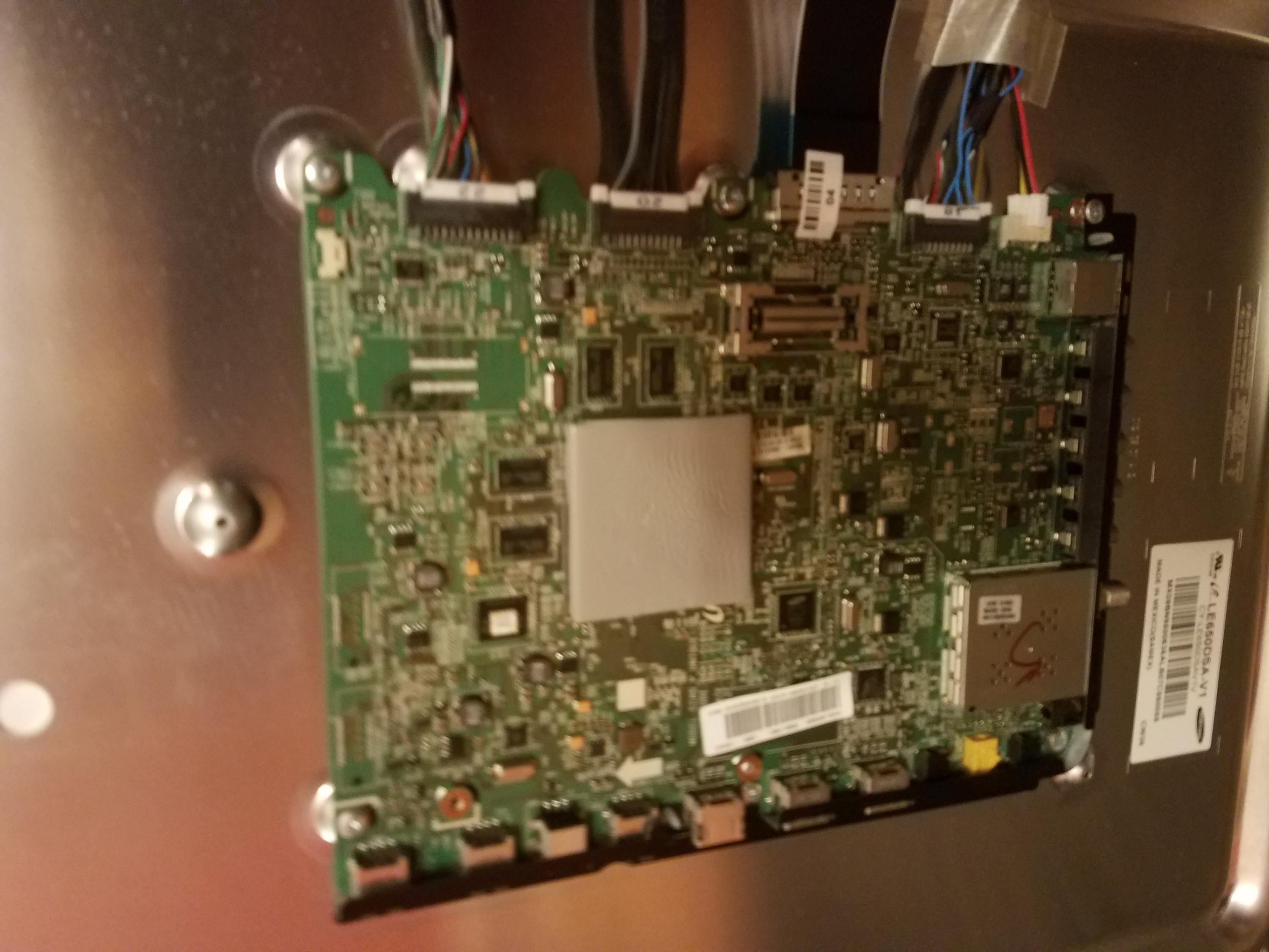

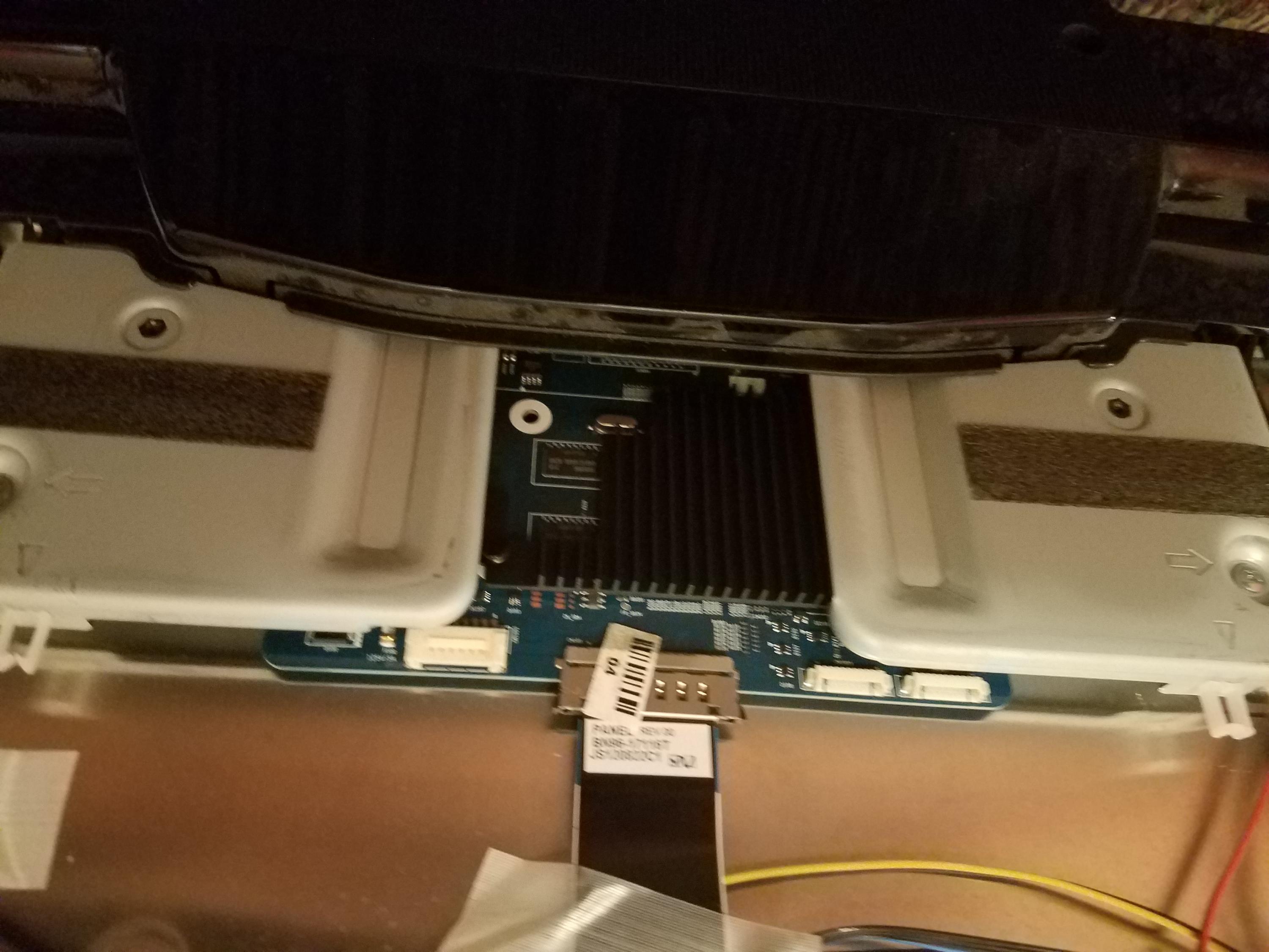

    Samsung UN65ES8000
    Tv powers on and then backlights fade out. Still has sound. Any help
  • dick_barton
    • Aug 2015
    • 6643
    • Wales
    Re: Samsung UN65ES8000
    Photo's & voltage readings from led connector would be a good start?
    • nelson6861
      • Jul 2016
      • 67
      Voltage checks coming
