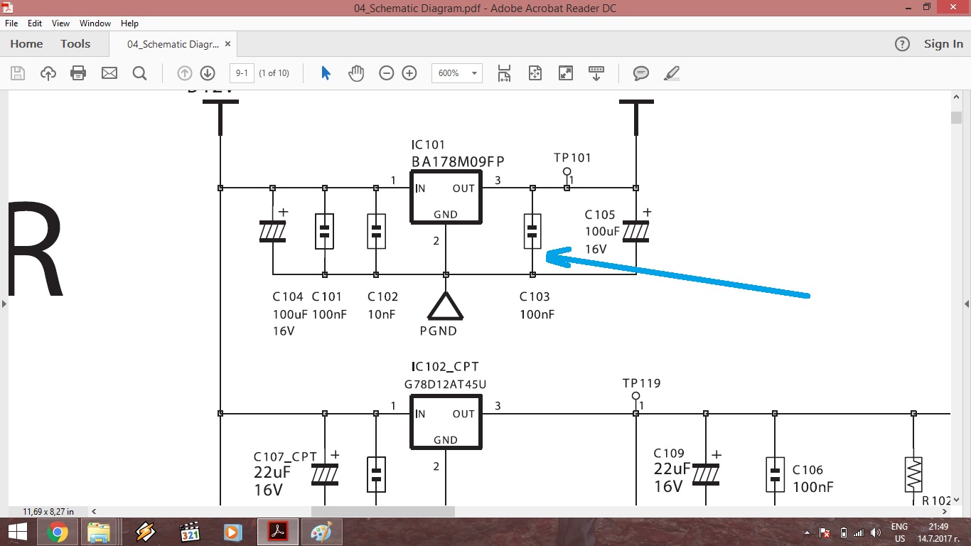

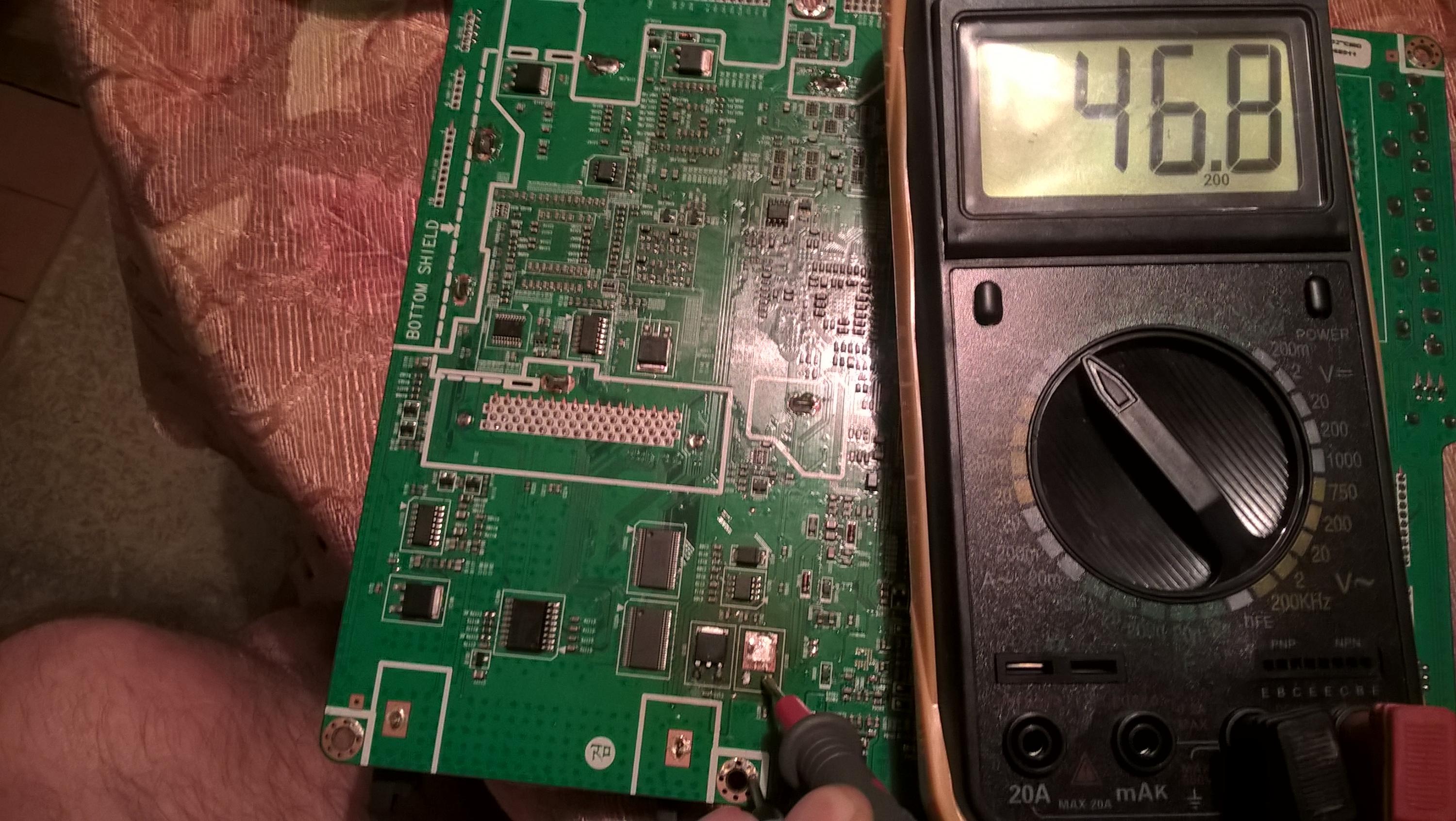

Re: Samsung LCD TV 8 times blink red diode /wont turn on/
IC1105 may be shorted. Ic101 output feeds input of ic1105
