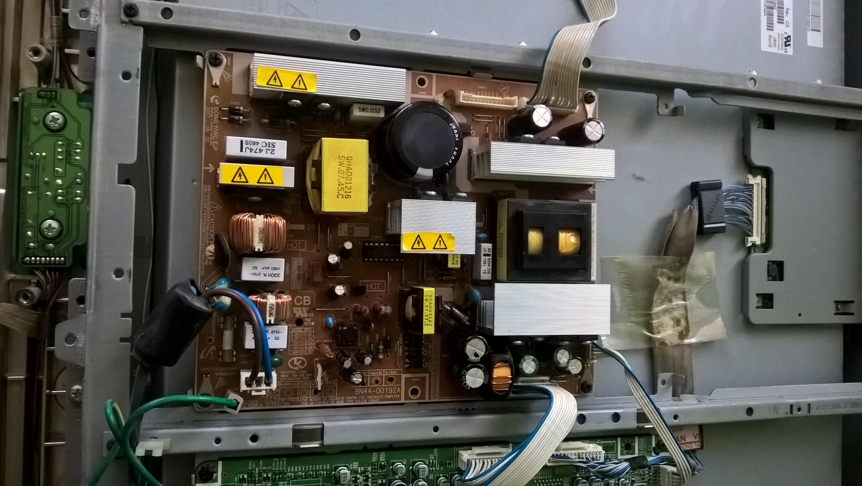

    Samsung le32s86bd, Power Supply: bn41-00879b . Tv won't turn on. If i press power button, red diode on stn by blink 8 time. Black screen, no sound. On every button from remote red diode blink.
    I open tv and i have 2 caps 1000/35v bad. I replace them, and after that check all caps on power supply with esr meter, they are perfect
    Voltages from PS:
    I have all correct voltages on inverter /24v/ stable.
    5v -correct
    13v -12.2v
    12v-11.8v

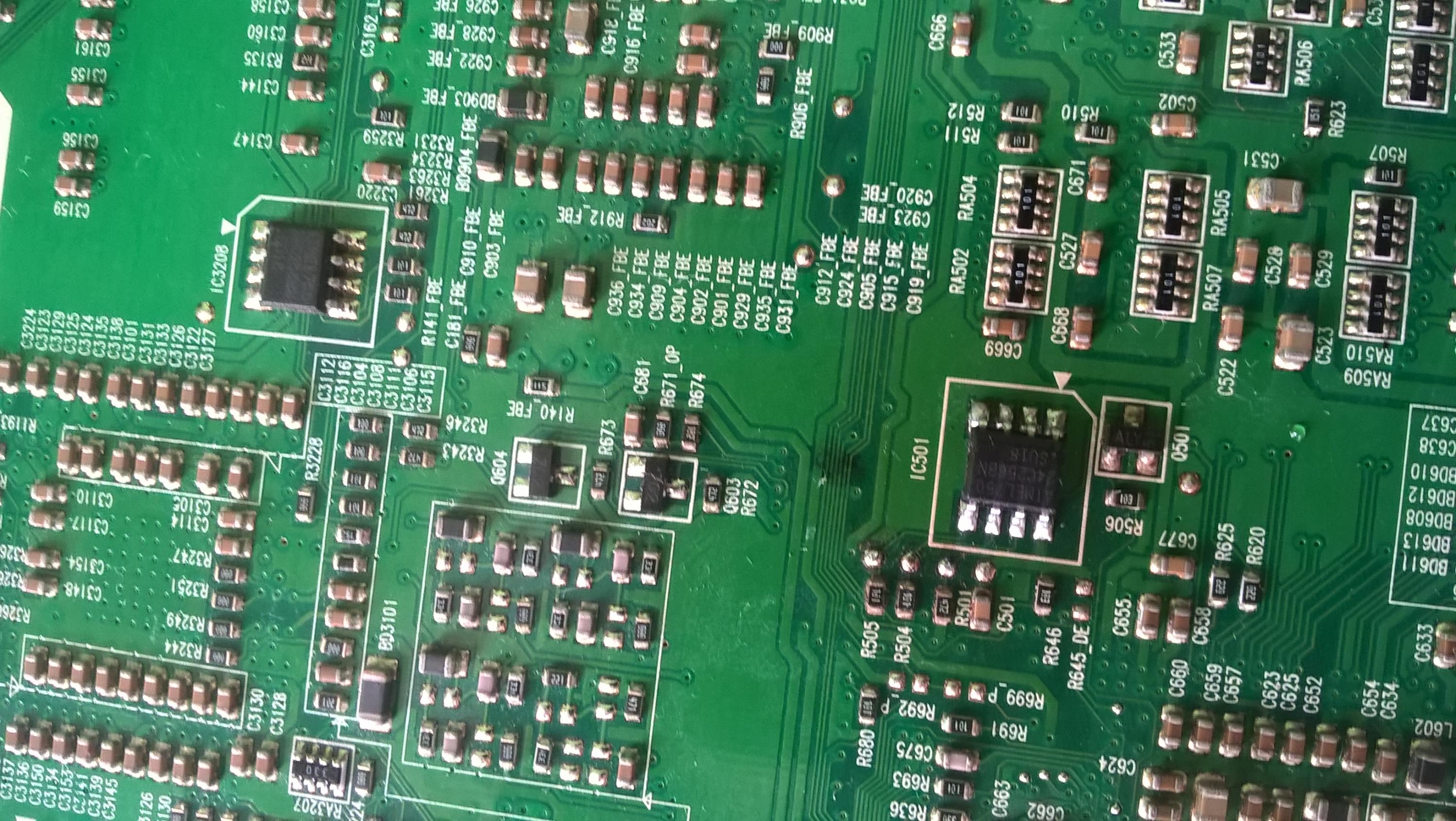

    After replacing caps, i remote eeprom /delete eeprom/ and put again empty, but the problem was same.

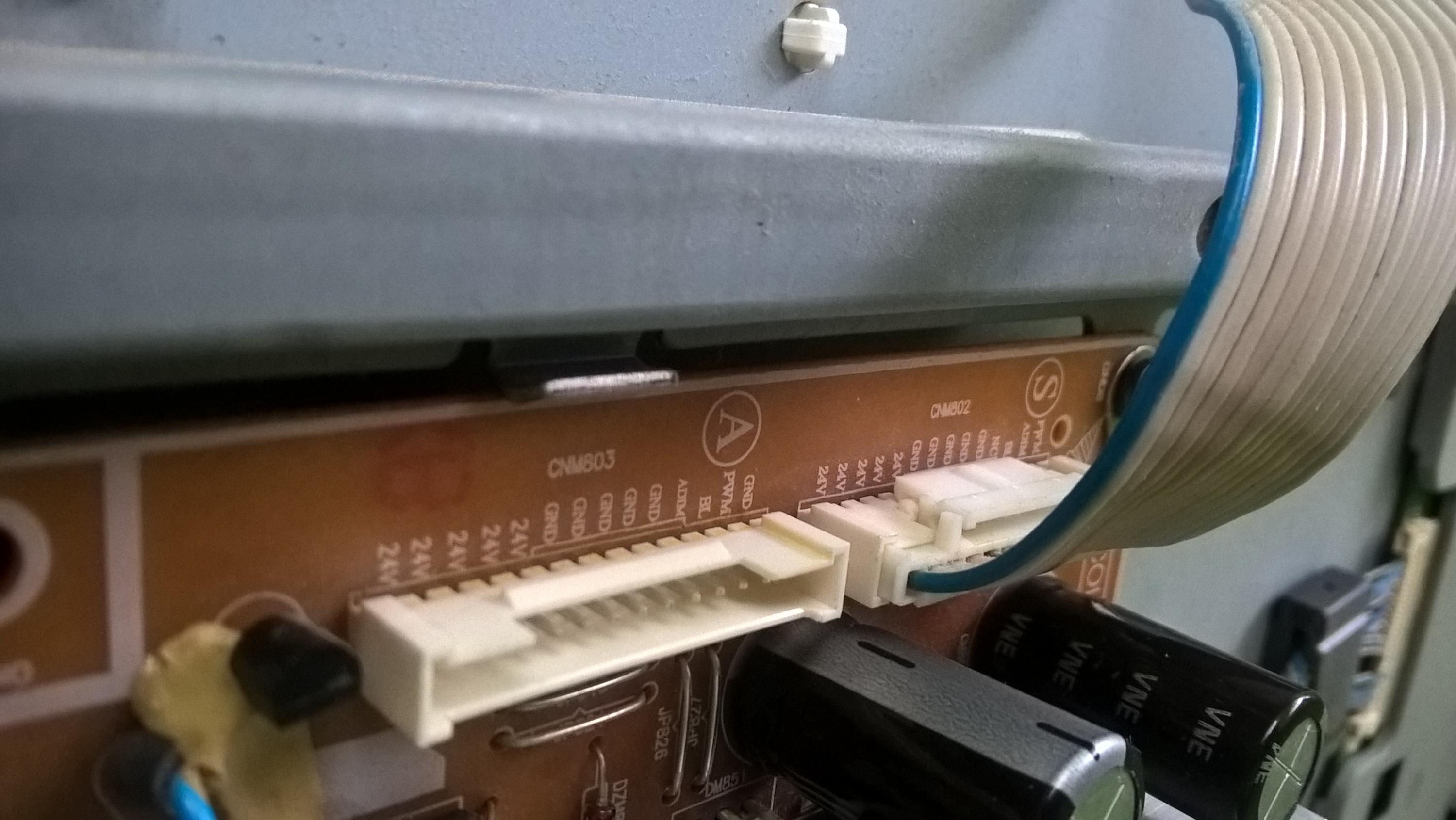

              Re: Samsung LCD TV 8 times blink red diode /wont turn on/
              Hi. I don't know where i can find PS_ON /BL_ON.
              BLU-5V
              ADIM-0V
              DET-5.3V
              GND-0V
              PWM-0V

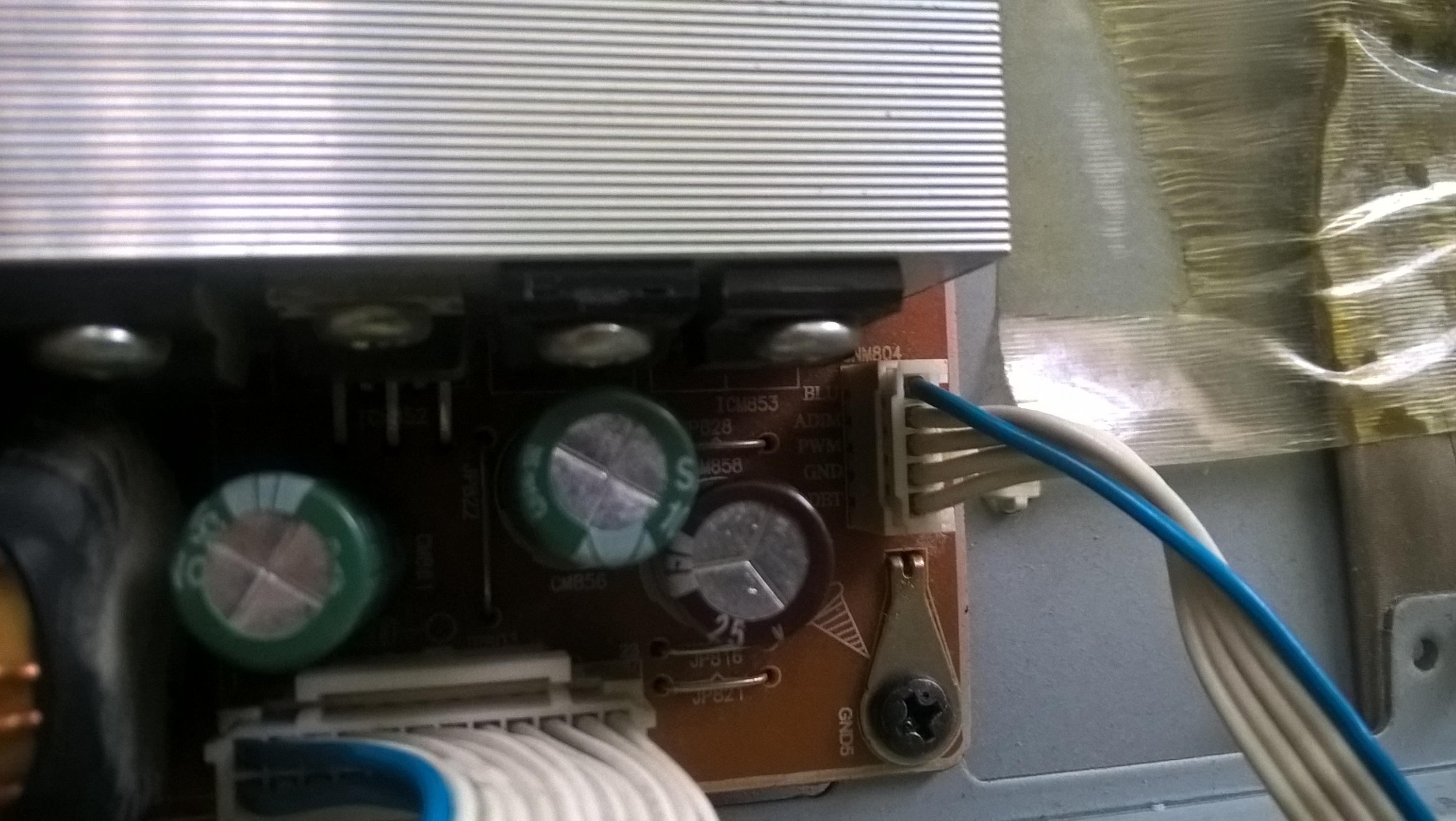

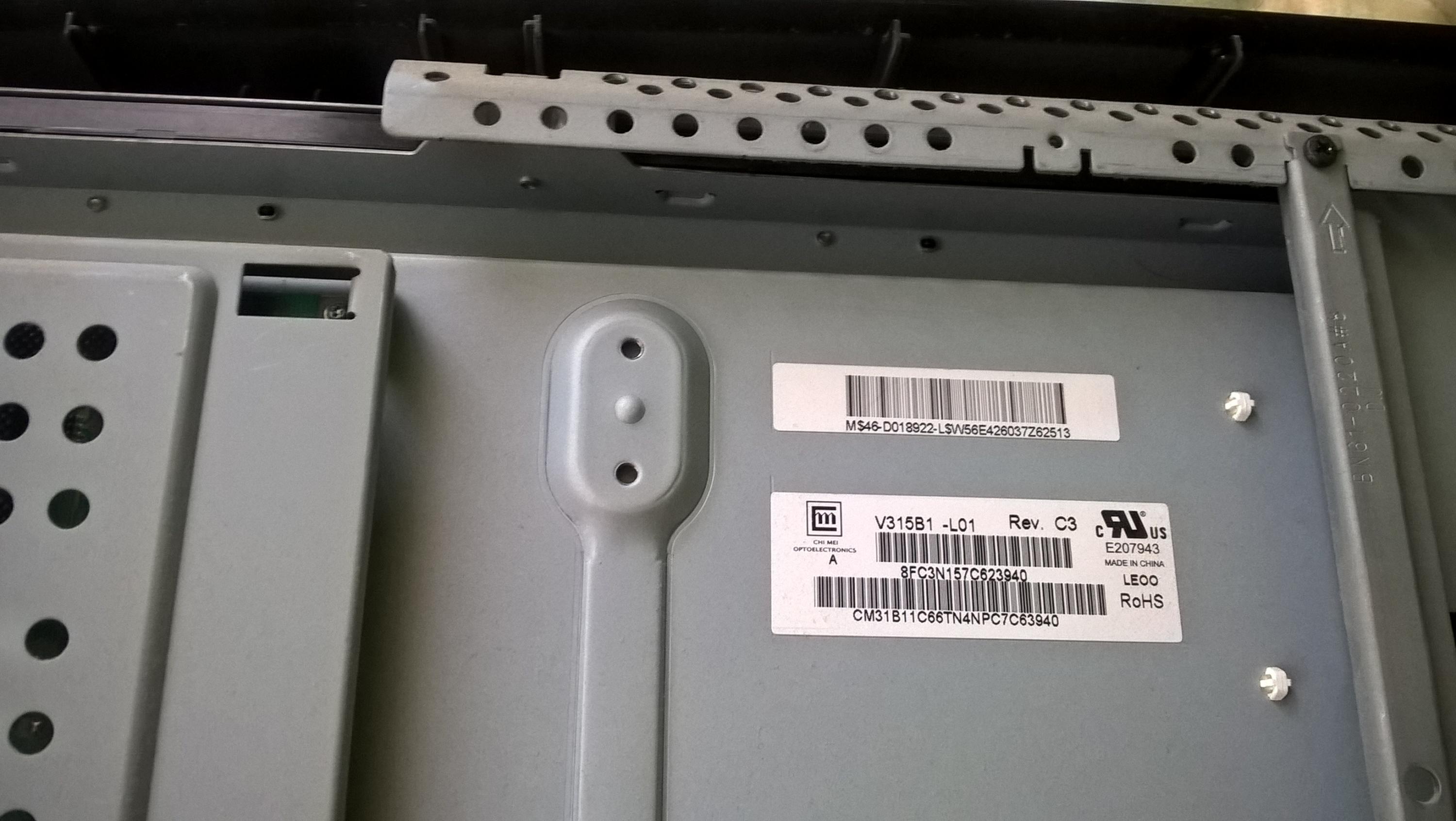

                There's service manual which may be of your power supply
                The power supply number shown in the picture in post #7 does not match the model number given in post #1 which you say was bn41-00879b
                Check the voltage on connector CNM801, pin1 = Power_On/Off

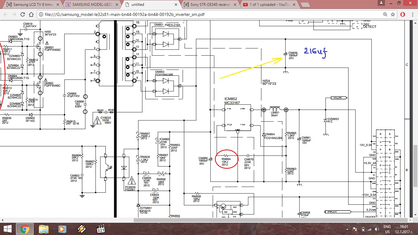

                  Sorry. I see a lot of Power supply in Internet...
                  On connector CNM801, pin1 = Power_On/Off I have stable 3.3v. CM856 (1000MF/25V) was very bad (216mf ) i check with esr meter. After this procedure i remove IC501 (eeprom) and from my laptop with programmer i delete eeprom and put it empty the same chip. In this mainboard i see also IC3208 (on my pic) which is also the same like IC501, but delete only IC501.
                  Here upload short video with 8 blinks: https://www.youtube.com/watch?v=eBS-...ature=youtu.be

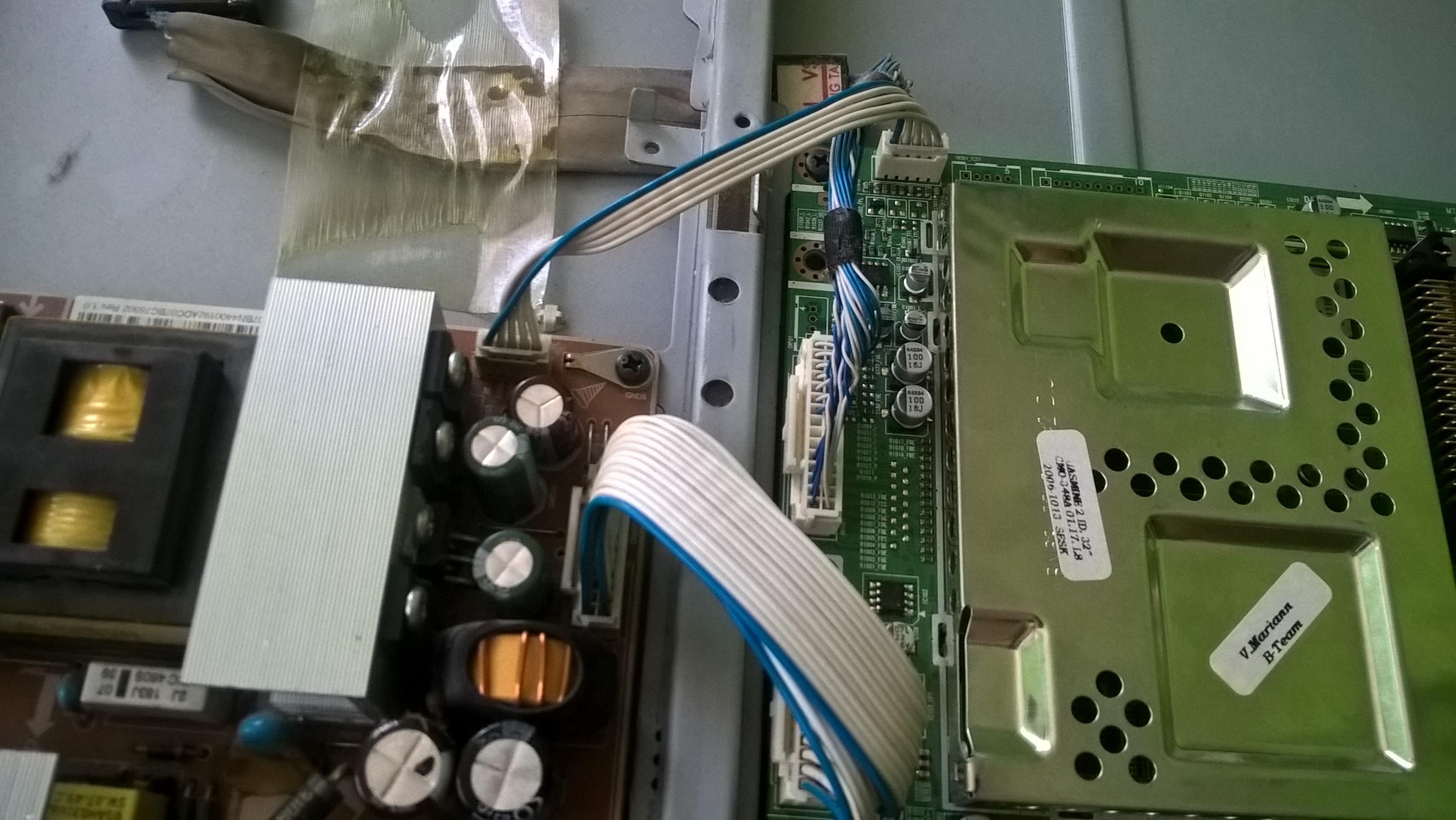

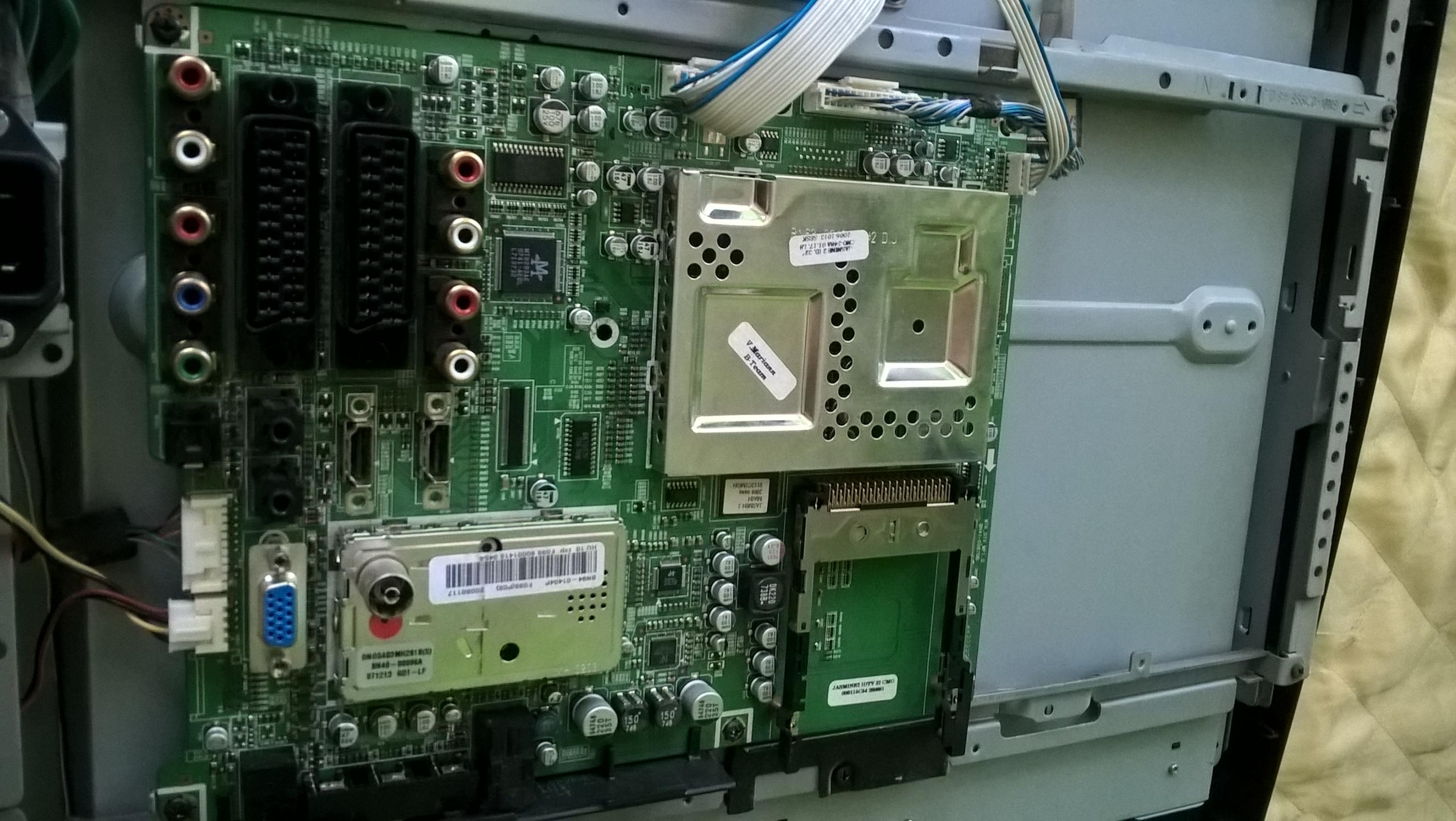

                    Need picture of connector from power board to main board. With connector unplugged what voltages do you get?
                      You have all the correct power supplies output Voltage per your post #1. You do have 24VDC for the inverter and the BLU 5V (bl-on) to turn on the inverter circuit but no dimming control signal from either Analog dim or PWM dim.

                        The Samsung sets always blink when turning on but it does not blink any error codes.
                        Did you save the data from the EEPROM because I would write it back to the EEPROM and test the set again.

                          I suspect you need a replacement EEPROM but I don't know which one of the two need to be replaced, possibly both.

                            Yes, i save the old eeprom file. On my file has some (FF) may be is bad.

                                  Ok i will try. I upoload fully two eeprom files LE32S86 IC501 AT24C256BN SOIC8 150mil and LE32S86 IC3208 AT24C256BN SOIC8 150mil

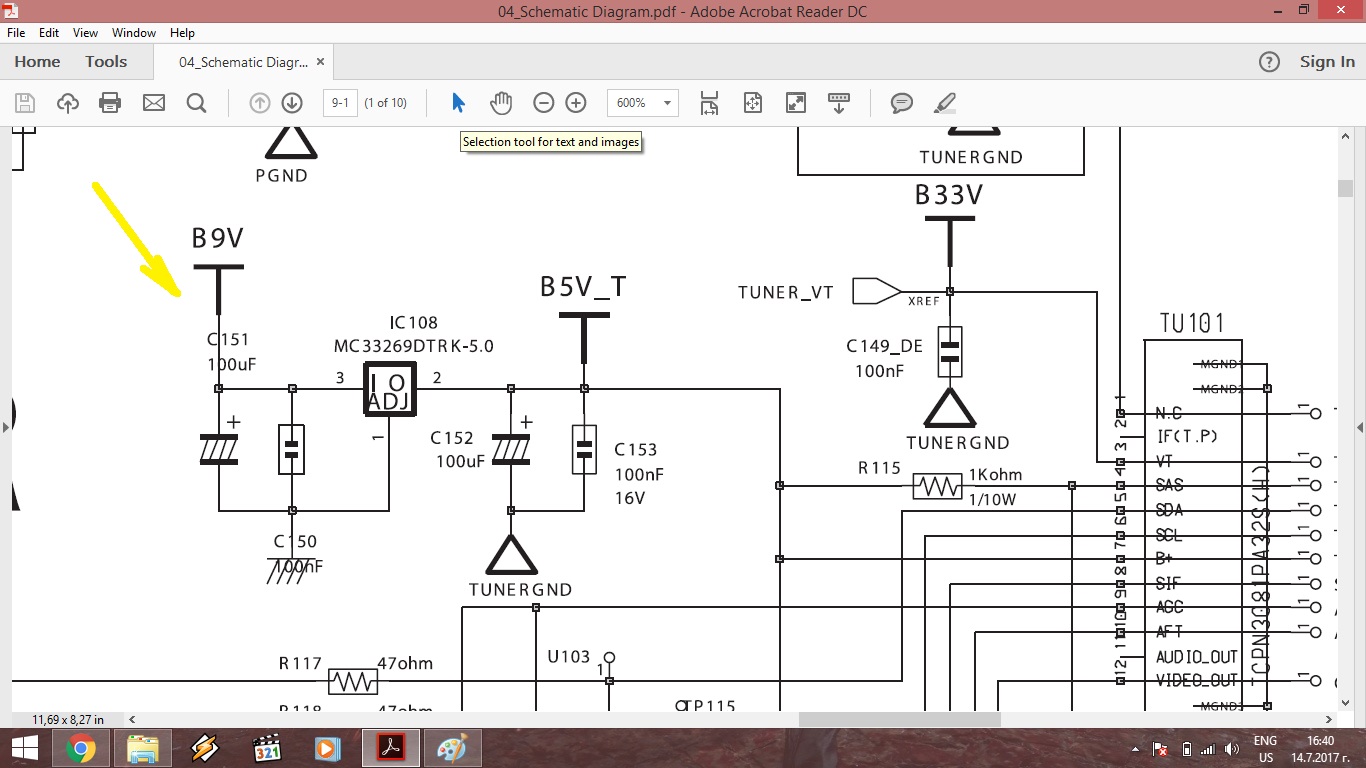

                                      One more question: Where i can find STBY_5V pin?

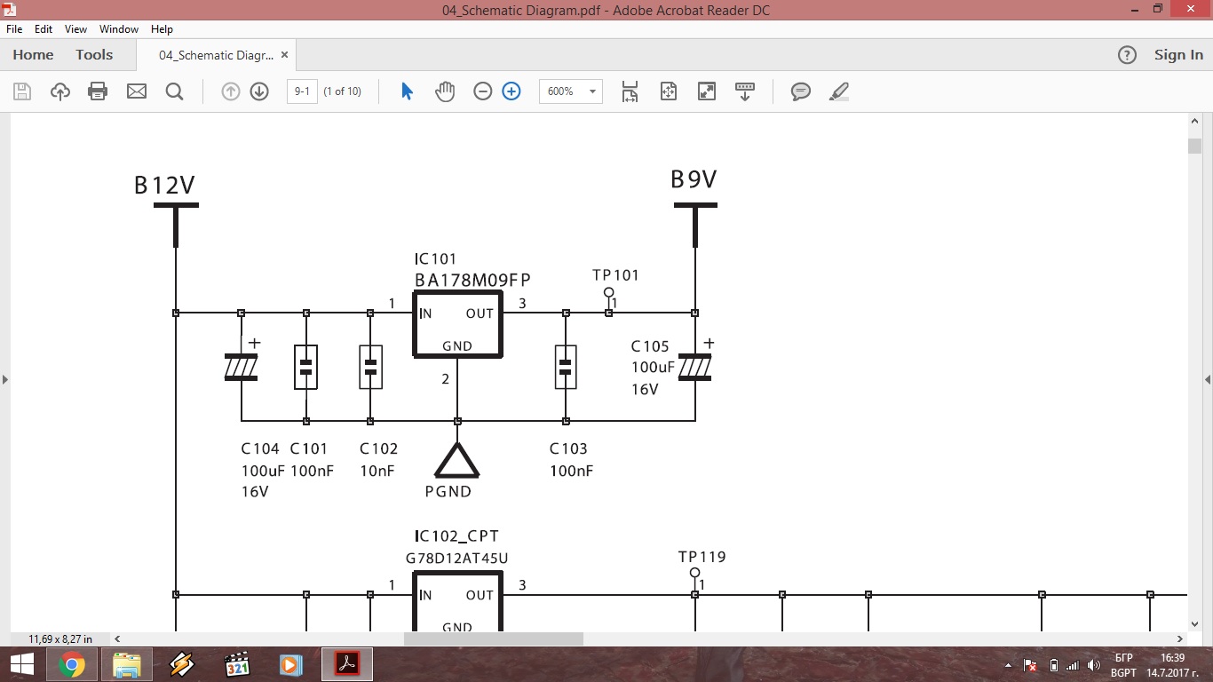

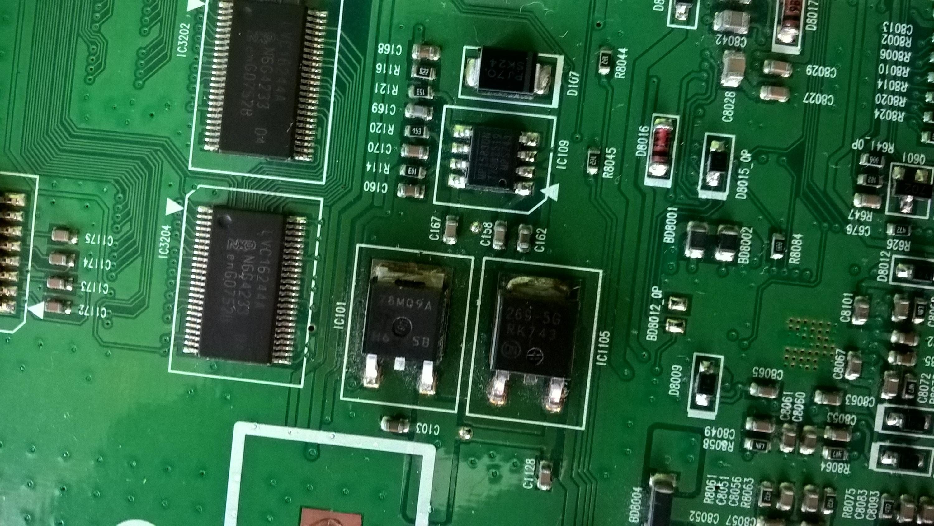

                                      I think i found one problem but i don't know yet. On ic101(78m09) on mainboard on OUTPUT i have 1v stable, on Input i have 12V, on IC1105(269 5G) on mainboard near to IC101 on OUTPUT i have 0.2v, on Input i have 1v. Is it normal??? All other regulators have correct voltage on outputs.
                                      • coojoe_213
                                        • Nov 2015
                                        • 105
                                        • bulgaria
                                        I change 78m09 with brand new, now voltage to output is 1.30v, the problem is a same, 8 blinks, no backlights. Why i have 1.30v on output?
