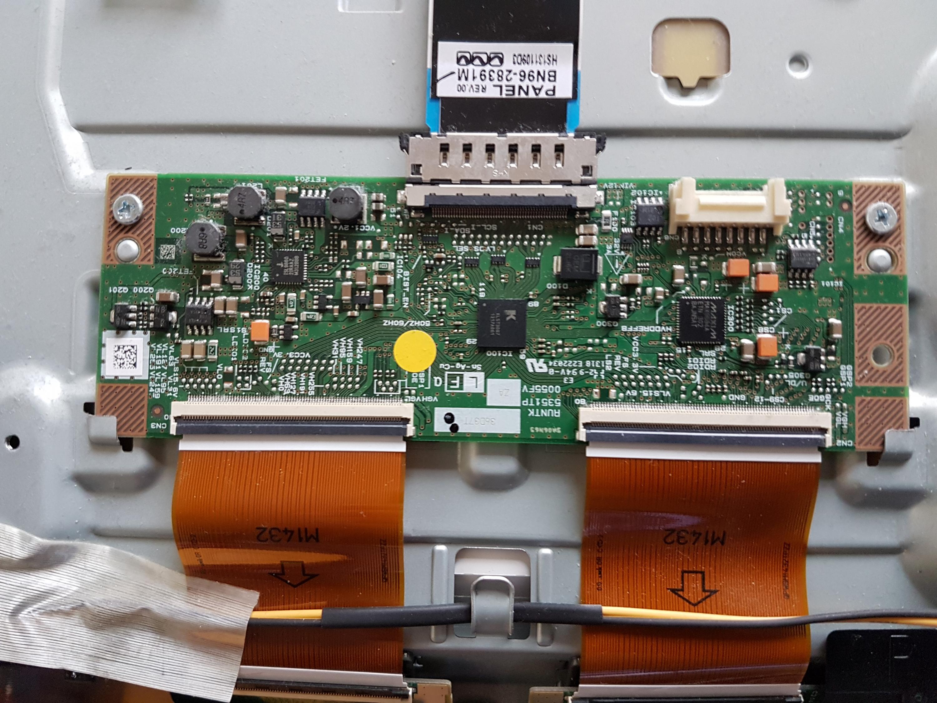

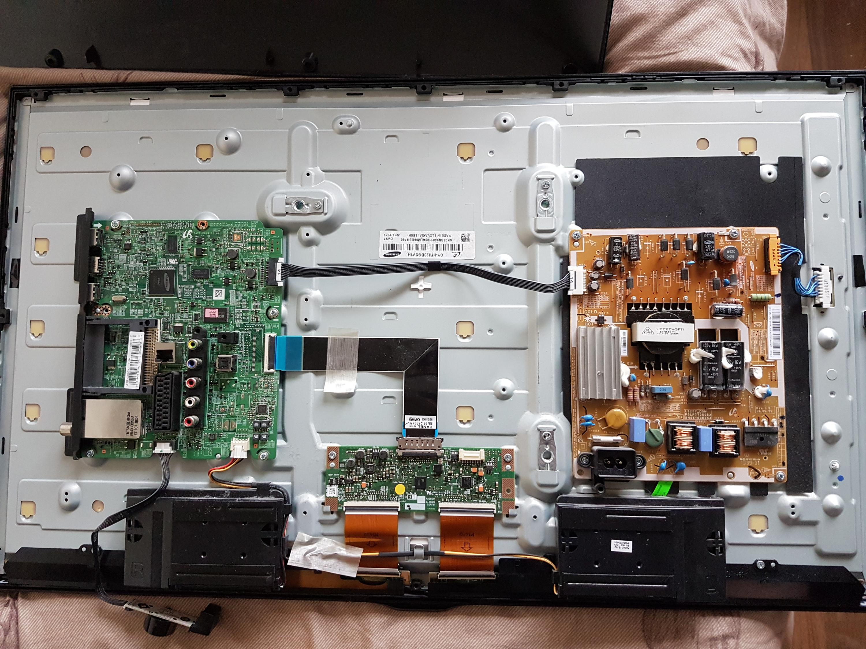

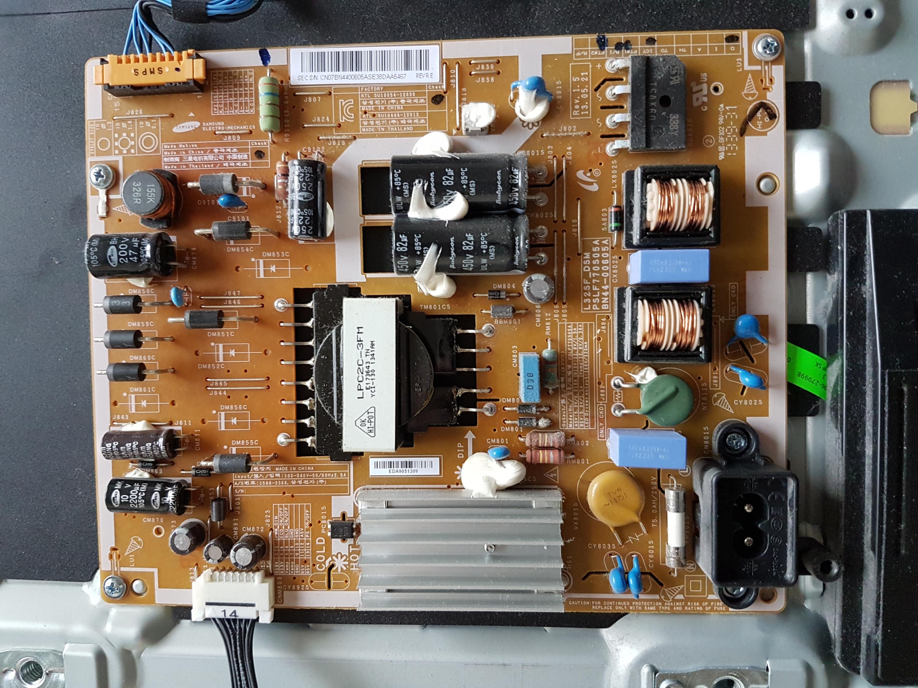

    Hi I have been reading other threads but Im getting odd reading on the CNL802
    With cable in CNL802 and connected to backlight readings are.
    1+ =200v fluctuating to below 180v
    1- = 0v
    2+ =0v
    2- =0v
    3+ =0v
    3- =0v
    4+ =0v
    4- =0v
    With cable removed from connector readings are
    1- = 0v
    2+ =0v
    2- =0v
    3+ =0v
    3- =0v
    4+ =0v
    4- =100v fluctuating to below 80v
    Would this be a strip issue or powerboard?
    Re: Samsung UE32F5000AK Backlight issue
    You have open circuit in the LED strings.
