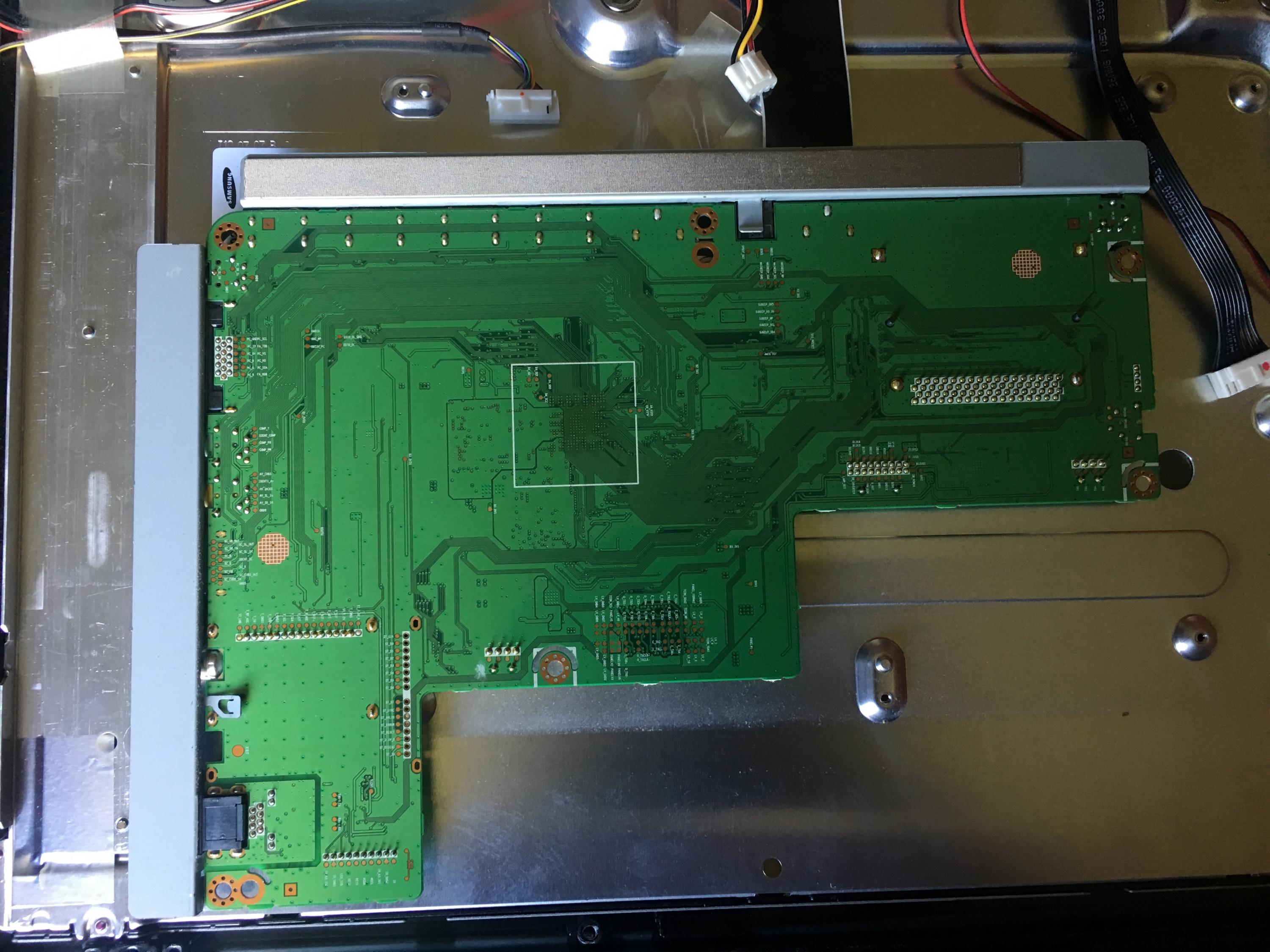

UE32C5100 Standby Only
+ More Options
Posts
  • StephenU
    • Dec 2013
    • 230
    • United Kingdom
    Re: UE32C5100 Standby Only
    Mainboard
    • dskall
      • Oct 2016
      • 2905
      • usa
      You can try to narrow it down to specific area of board by heating sections at a time. I suspect maybe 3.3v regulator, ceramic cap or transistor bad
      • Andrew F. Ali
        • Jan 2014
        • 2450
        • Trinidad & Tobago
        From my experience...When a section of board is heated up and set starts to work.....it is some e-cap bad....
        • dskall
          • Oct 2016
          • 2905
          • usa
          This board is pretty lacking in Electrolytics
          • Andrew F. Ali
            • Jan 2014
            • 2450
            • Trinidad & Tobago
            +1...Sure right.....Made my comment without looking at the Bd. Perhaps then a solder connection expanding and reconnecting temporarily then contracting on cooling??......Hardly be a semi-conductor or resistor/
