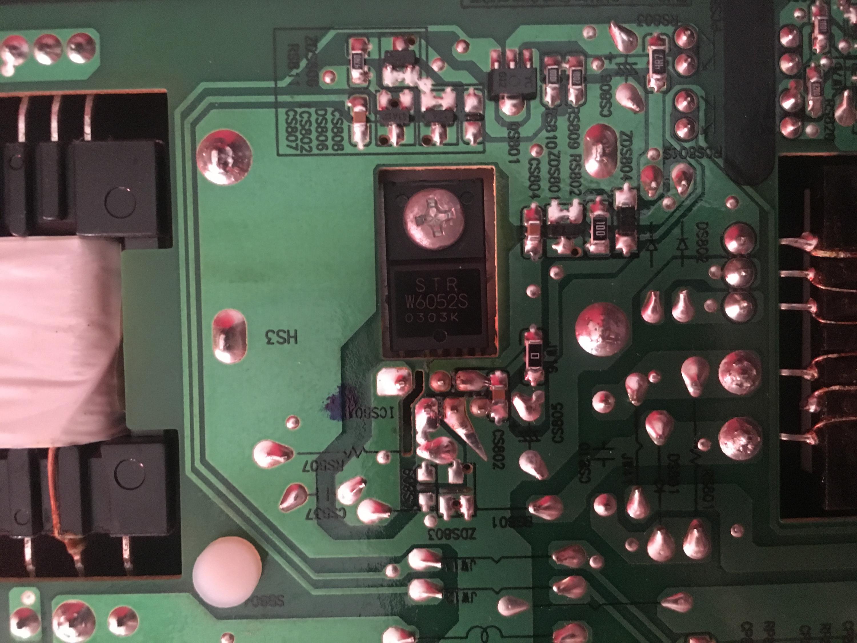

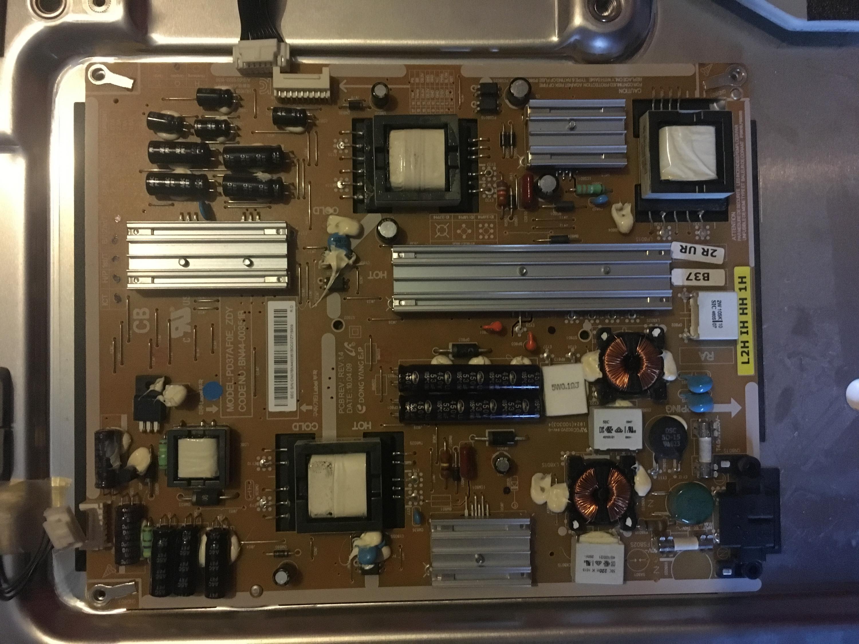

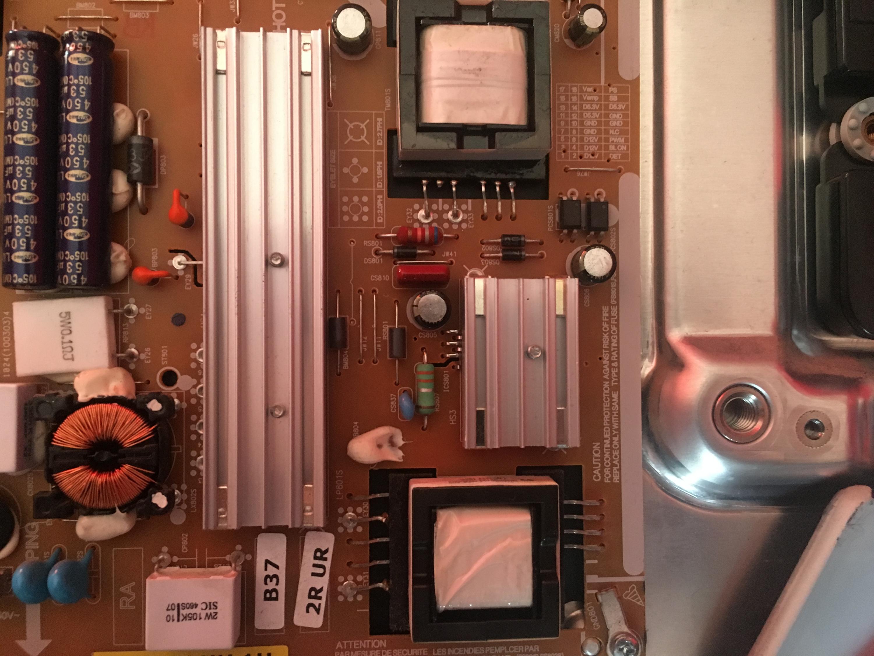

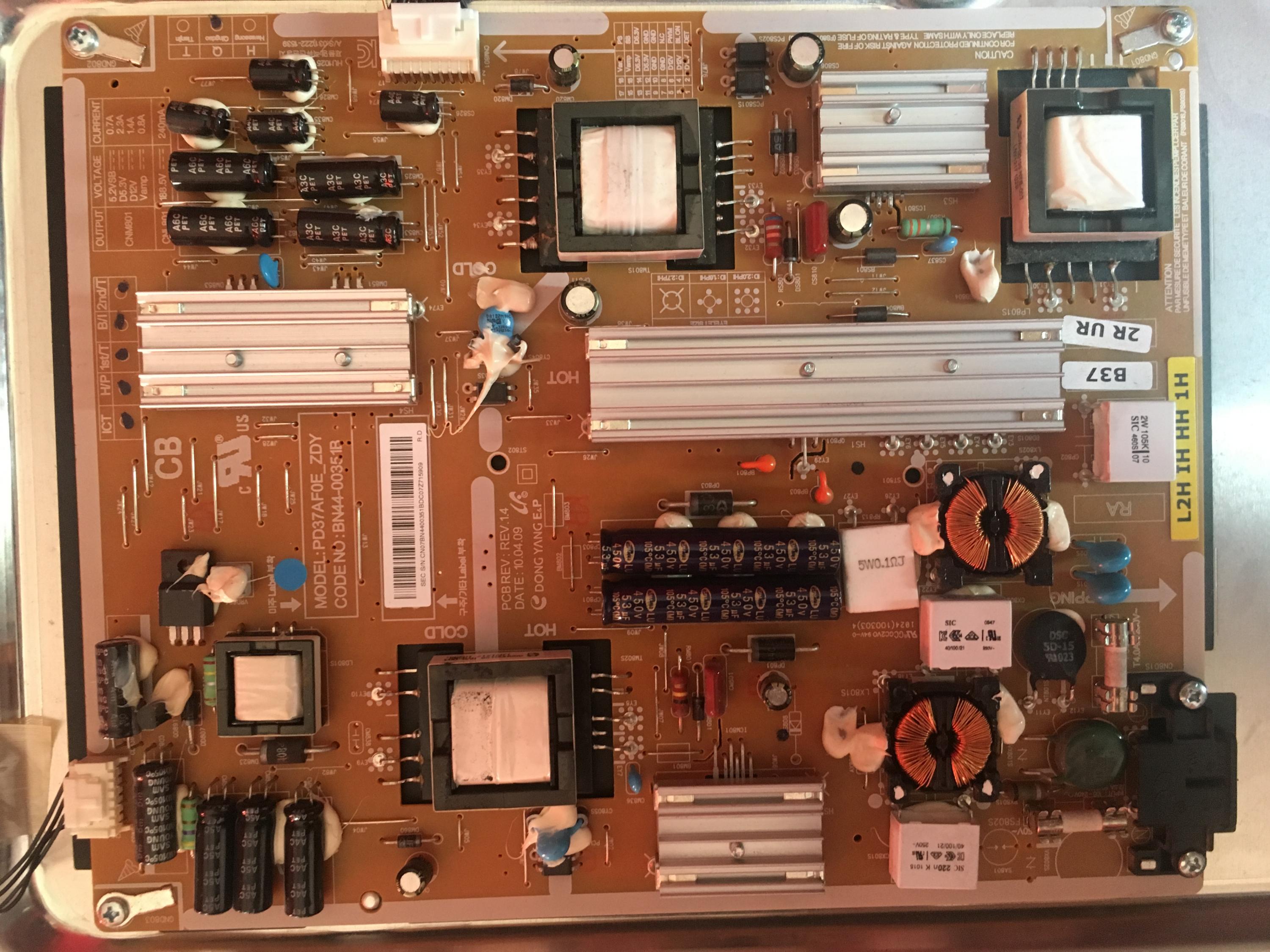

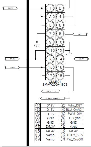

    Hi all I have the following TV which I'm trying to repair. I'm only getting 5v standby on the output of connector CNM801 (pin 16). No other voltages present and TV won't come out of standby. Both fuses are fine and I've also checked the backlights are working and they are fine.
    PSU - BN44-00351B
    Any help would be appreciated, thanks in advance.

    Disconnect the mainboard and connect pin 16 to pin 18 using a 1K resistor. Then check you have all the voltages on that connector.

                  Readings took with 1K res in place across 16-18
                  Pin 1 - 13.27
                  Pin 2 - 0
                  Pin 3 - 13.27
                  Pin 4 - 2.951
                  Pin 5 - 13.26
                  Pin 6 - 5.126
                  Pin 7 - GND
                  Pin 8 - GND
                  Pin 9 - GND
                  Pin 10 - GND
                  Pin 11 - 5.279
                  Pin 12 - 0
                  Pin 13 - 5.279
                  Pin 14 - 5.279
                  Pin 15 - 13.26
                  Pin 16 - 5.279
                  Pin 17 - 13.26
                  Pin 18 - 1.164

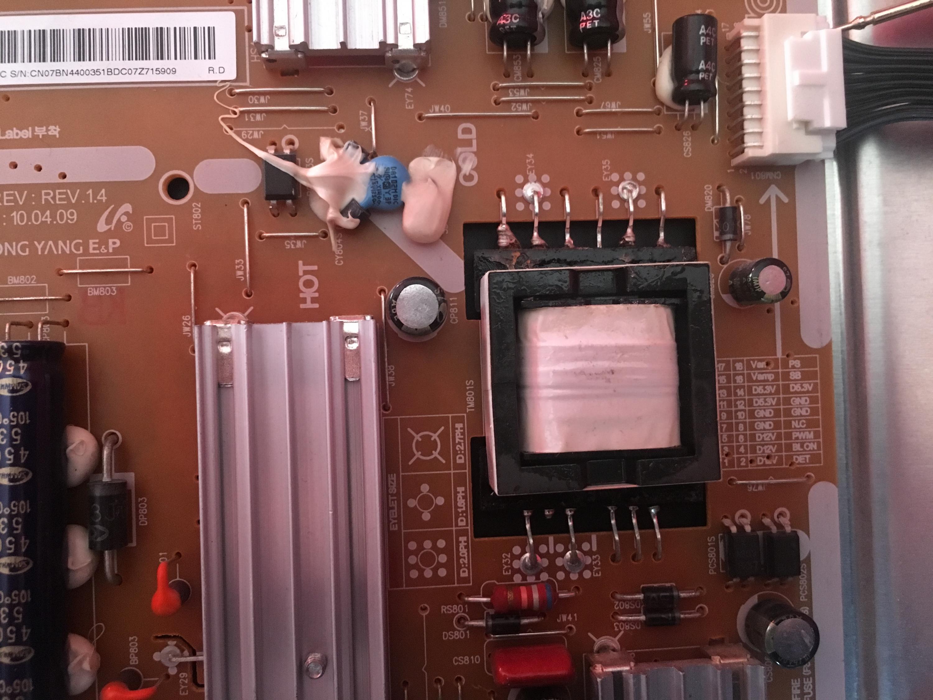

                    You will make it easier on us if you give us pin descriptions
                    • StephenU
                      • Dec 2013
                      • 230
                      • United Kingdom
                      Re: UE32C5100 Standby Only
                      Silkscreen on the PCB
                      Pin 1 (D12V) - 13.27
                      Pin 2 (DET) - 0
                      Pin 3 (D12V) - 13.27
                      Pin 4 (BL ON)- 2.951
                      Pin 5 (D12V) - 13.26
                      Pin 6 (PWM) - 5.126
                      Pin 7 - GND
                      Pin 8 - GND
                      Pin 9 - GND
                      Pin 10 - GND
                      Pin 11 (D5.3V) - 5.279
                      Pin 12 (GND) - 0
                      Pin 13 (D5.3V) - 5.279
                      Pin 14 (D5.3V) - 5.279
                      Pin 15 (Vamp) - 13.26
                      Pin 16 (SB) - 5.279
                      Pin 17 (Vamp) - 13.26
                      Pin 18 (PS) - 1.164

                          Those voltages all look fine except for Pin 2 (DET) which I'm unsure of what value it should be.
                          So once again disconnect the mainboard and connect pin 16 to pin 18 using a 1K resistor and also a 1K resistor between pin 16 to pin 4 (Backlights On) and see if the backlights come on?

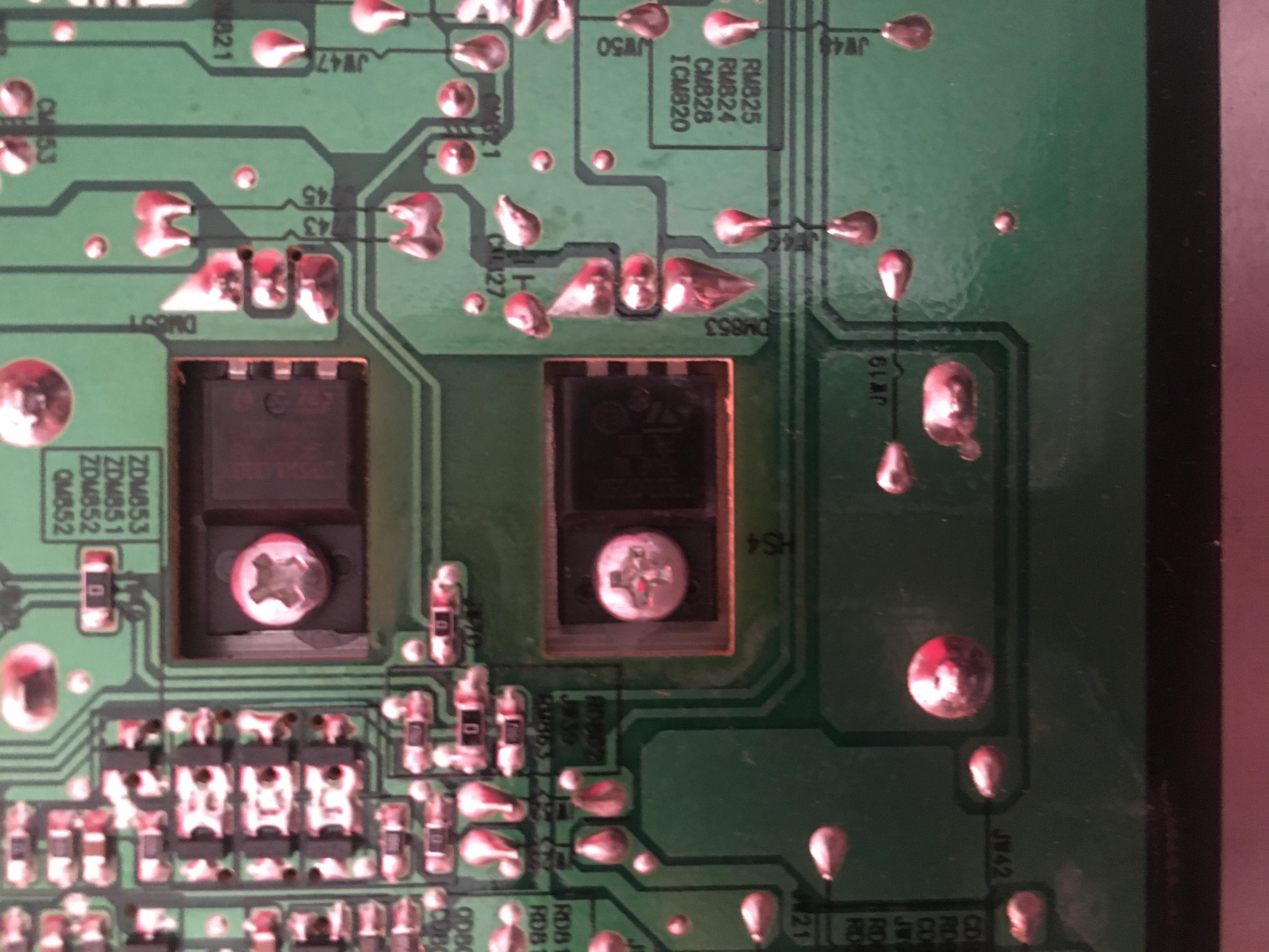

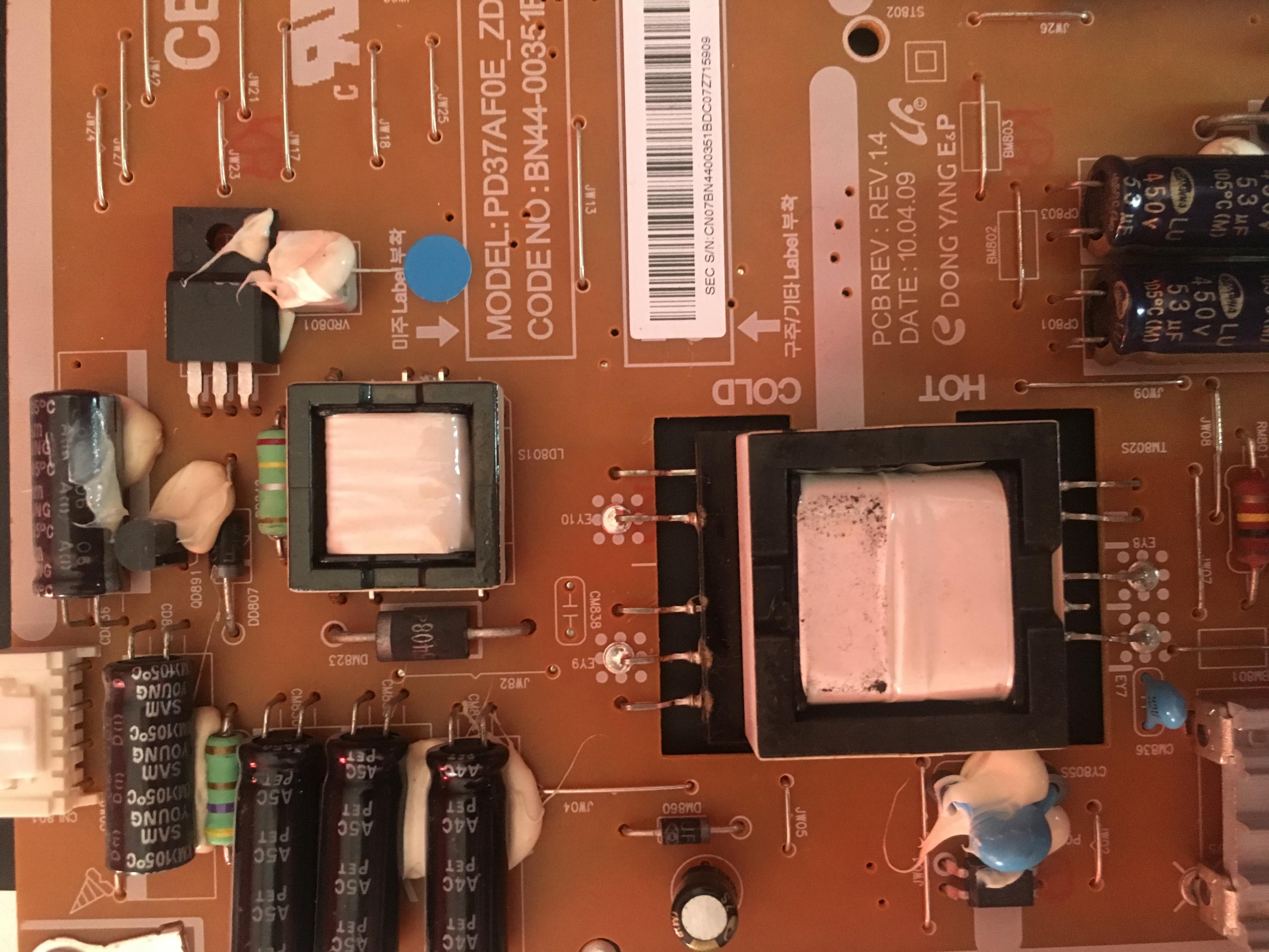

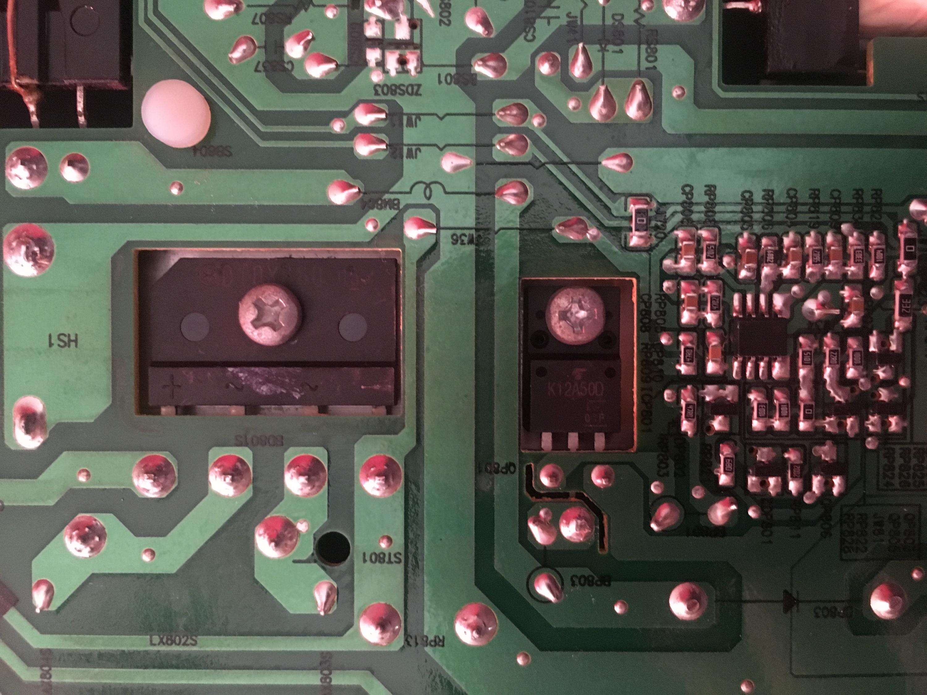

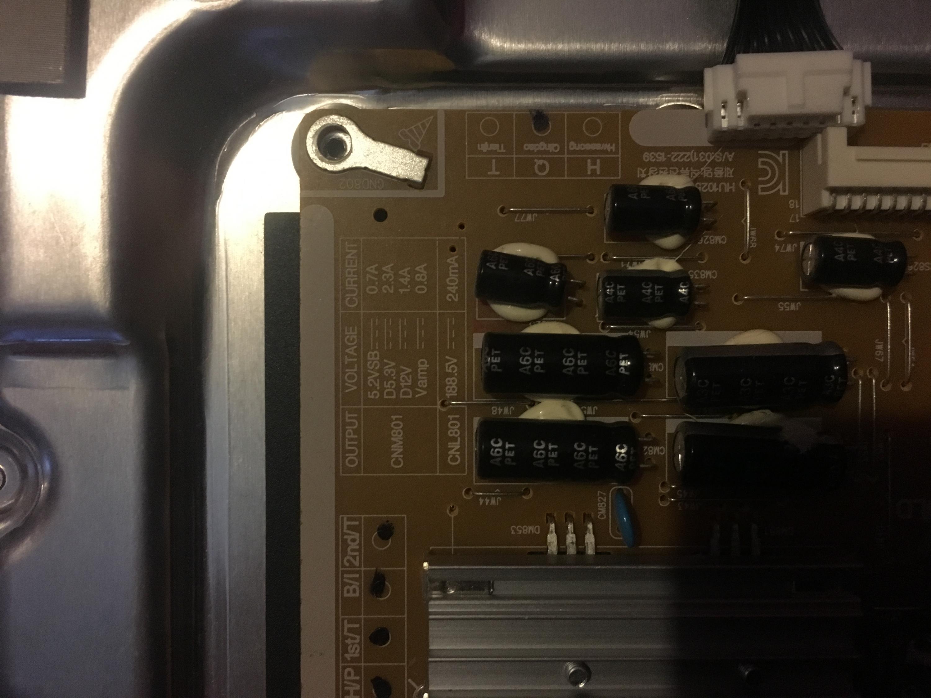

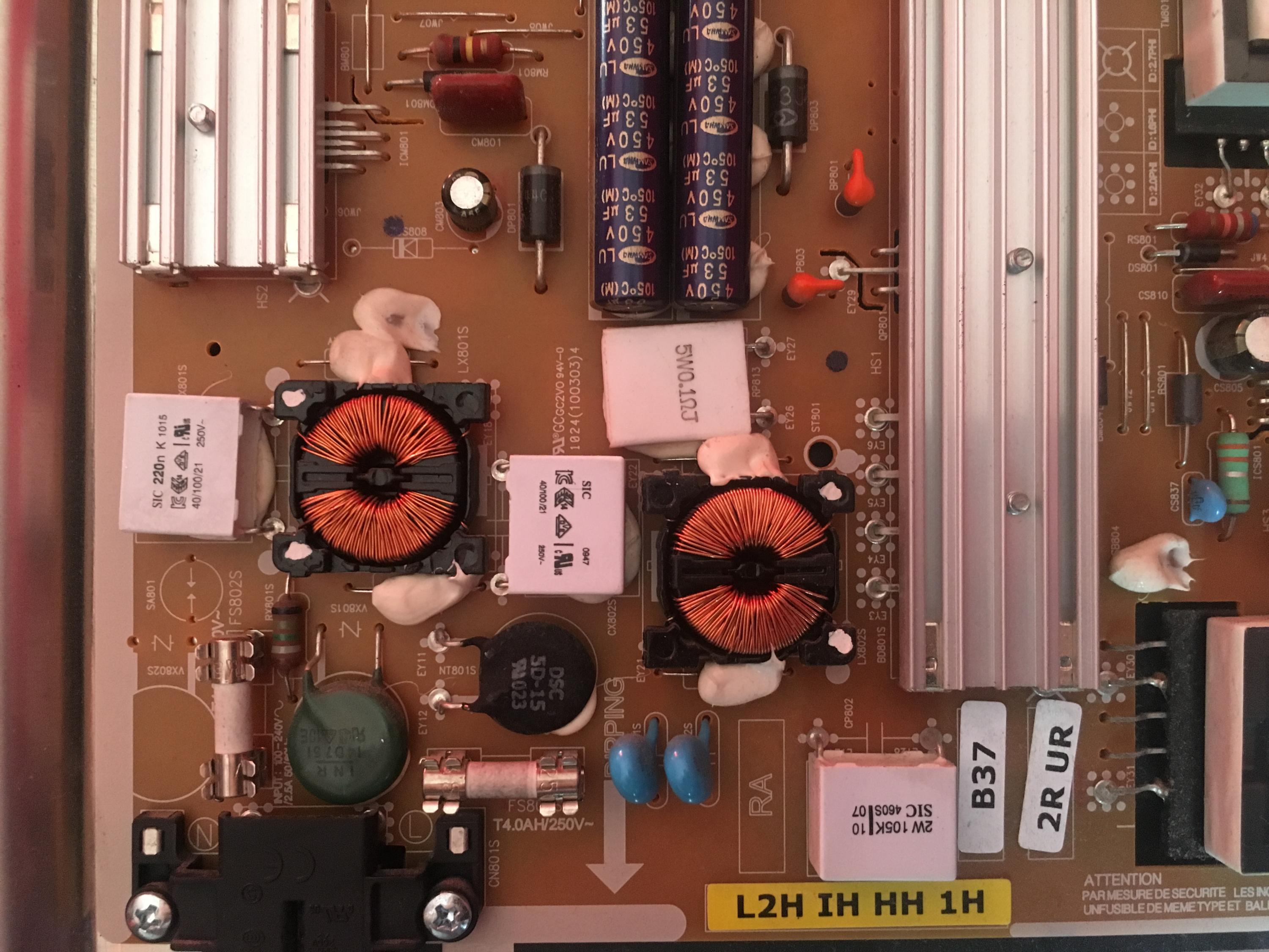

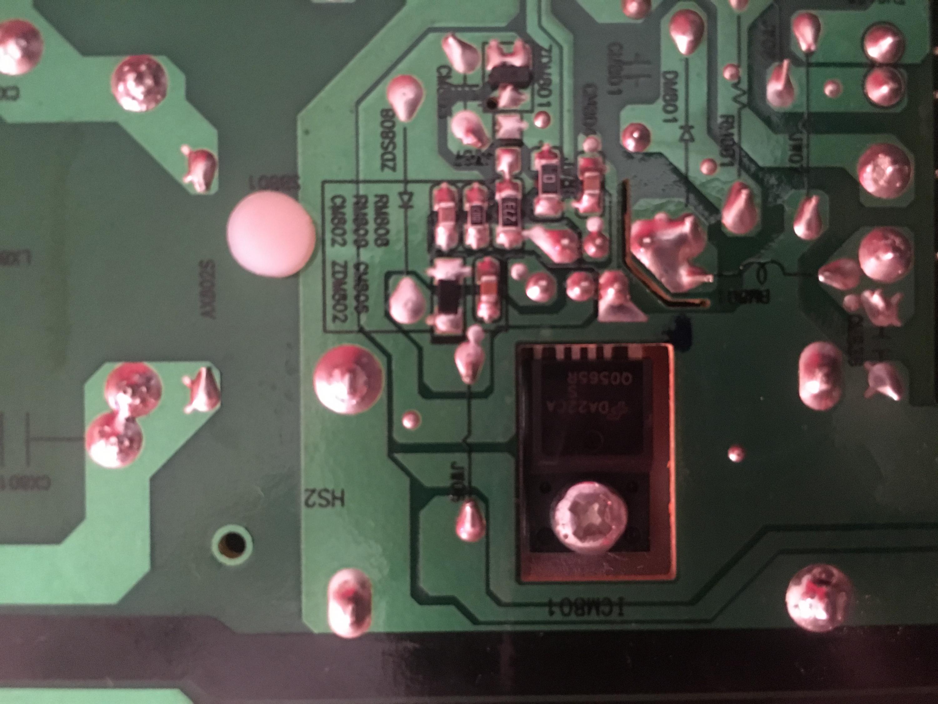

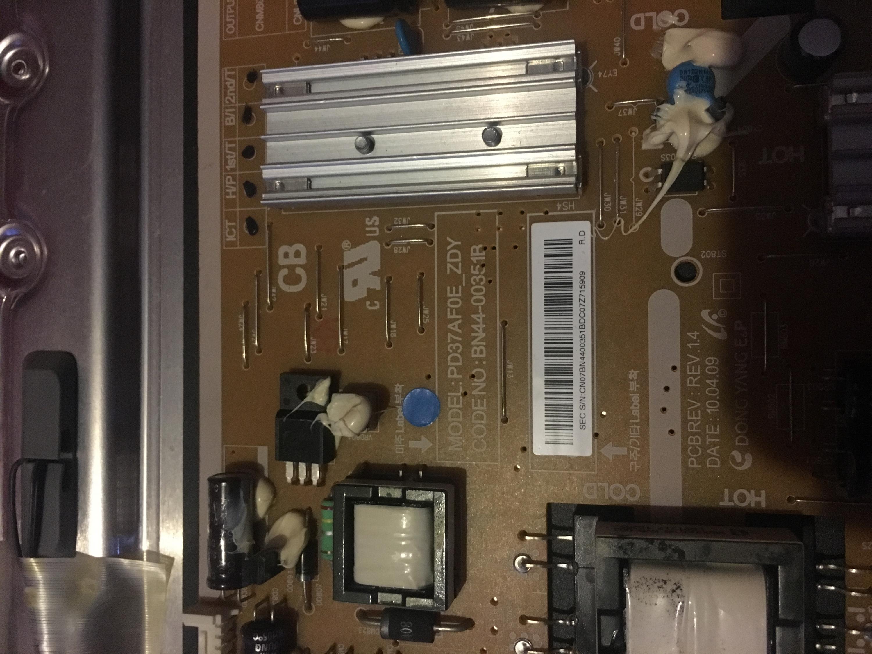

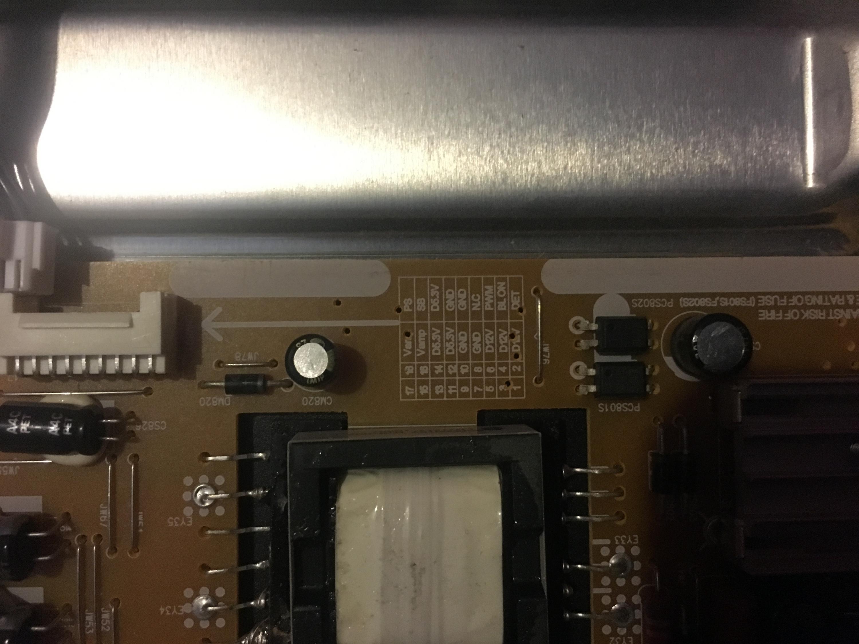

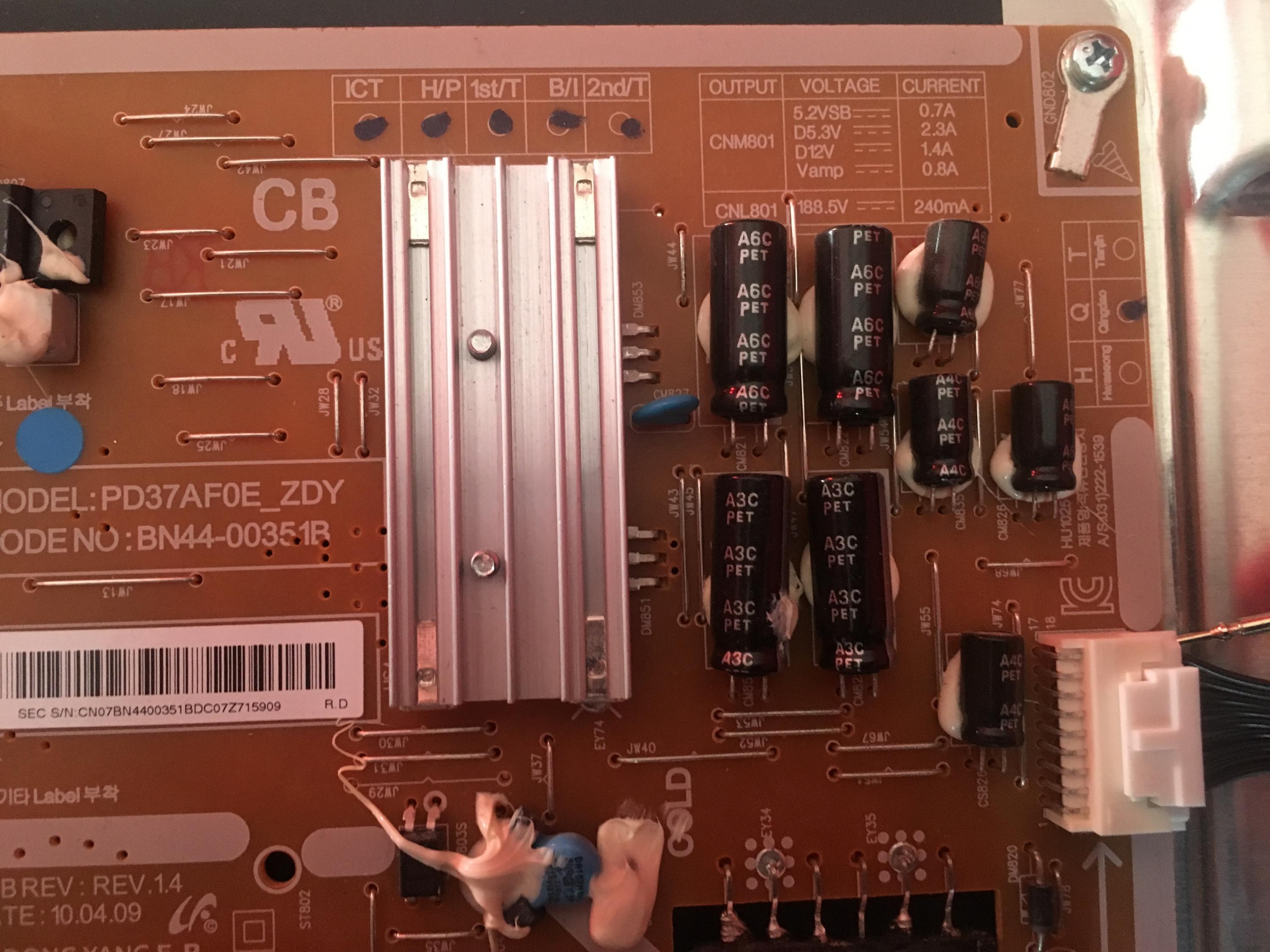

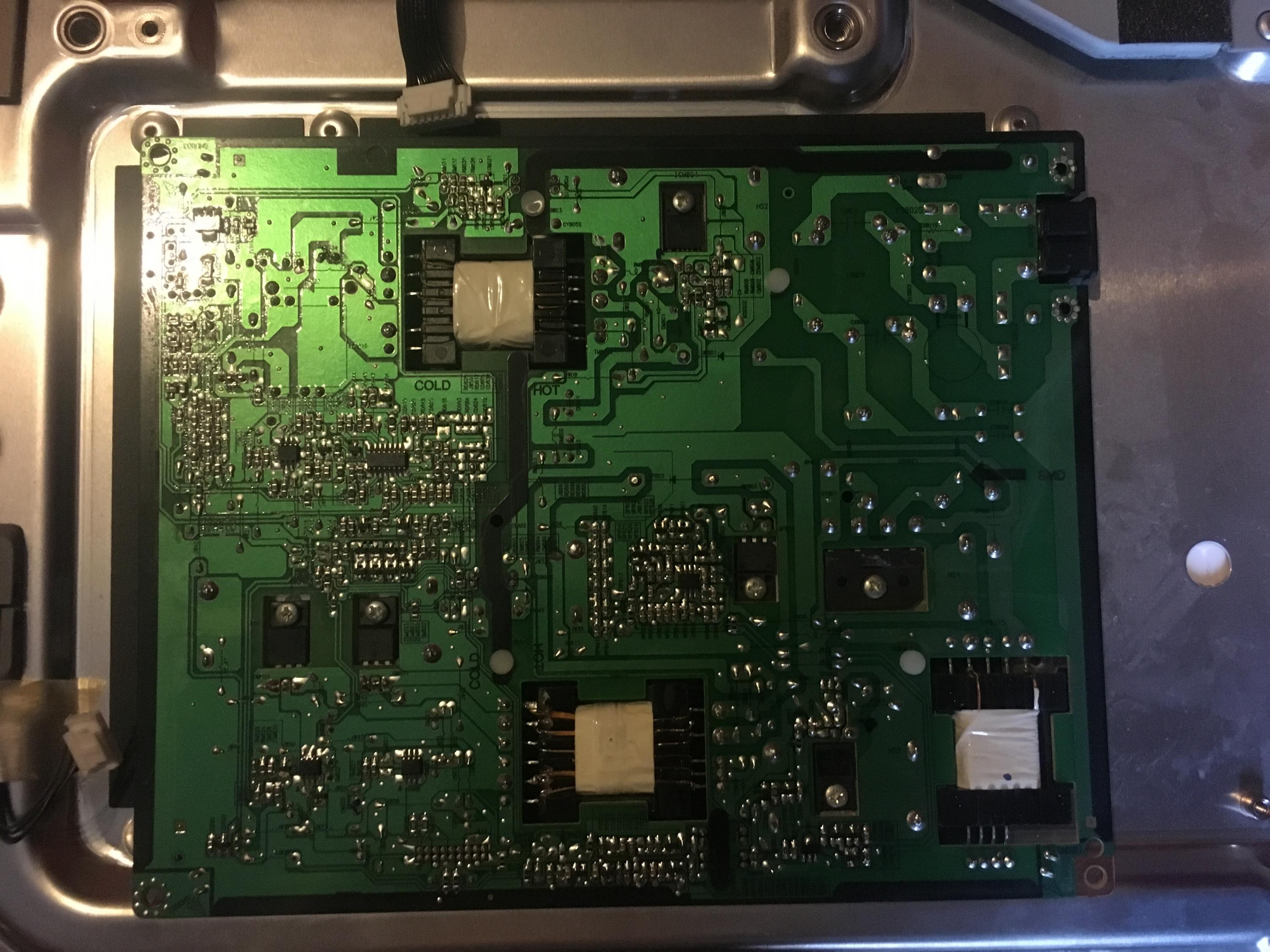

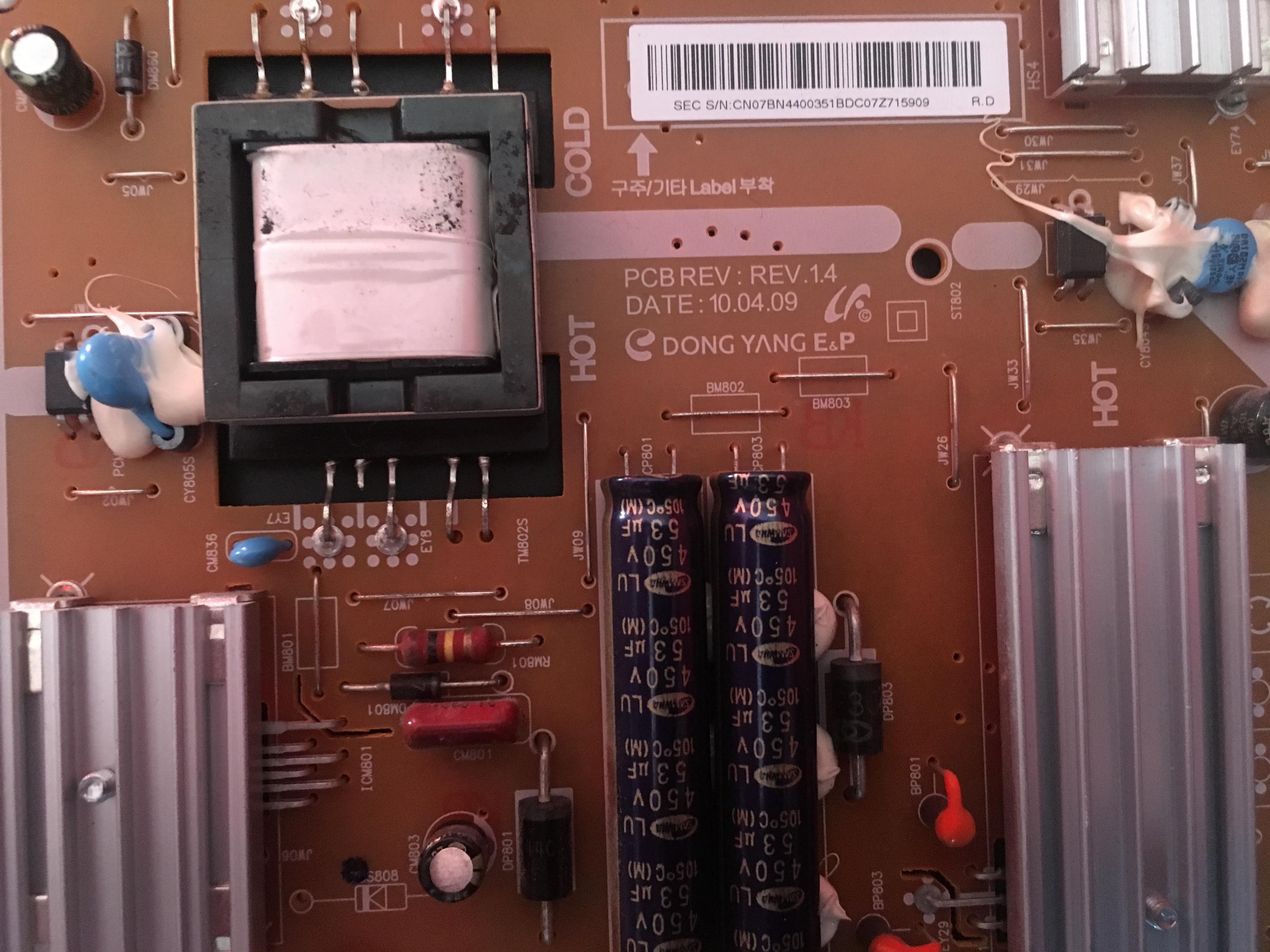

                                You may have a bad voltage regulator on main board. Maybe some good pictures of main board.
                                • StephenU
                                  • Dec 2013
                                  • 230
                                  • United Kingdom
                                  Hope these help guys, thanks.
                                  • dick_barton
                                    • Aug 2015
                                    • 6642
                                    • Wales
                                    It looks like you are not getting PWR_ON from the main board so whatever the problem is it's not the power supply.
                                    Some good photo's of your mainboard would be good.
                                    • StephenU
                                      • Dec 2013
                                      • 230
                                      • United Kingdom
                                      heh guys, plugged it all in and run a hairdryer over the mainboard and within 30 seconds tv booted up fine, so most definitely mainboard issue....
                                      mainboard number - BN41-01549B
