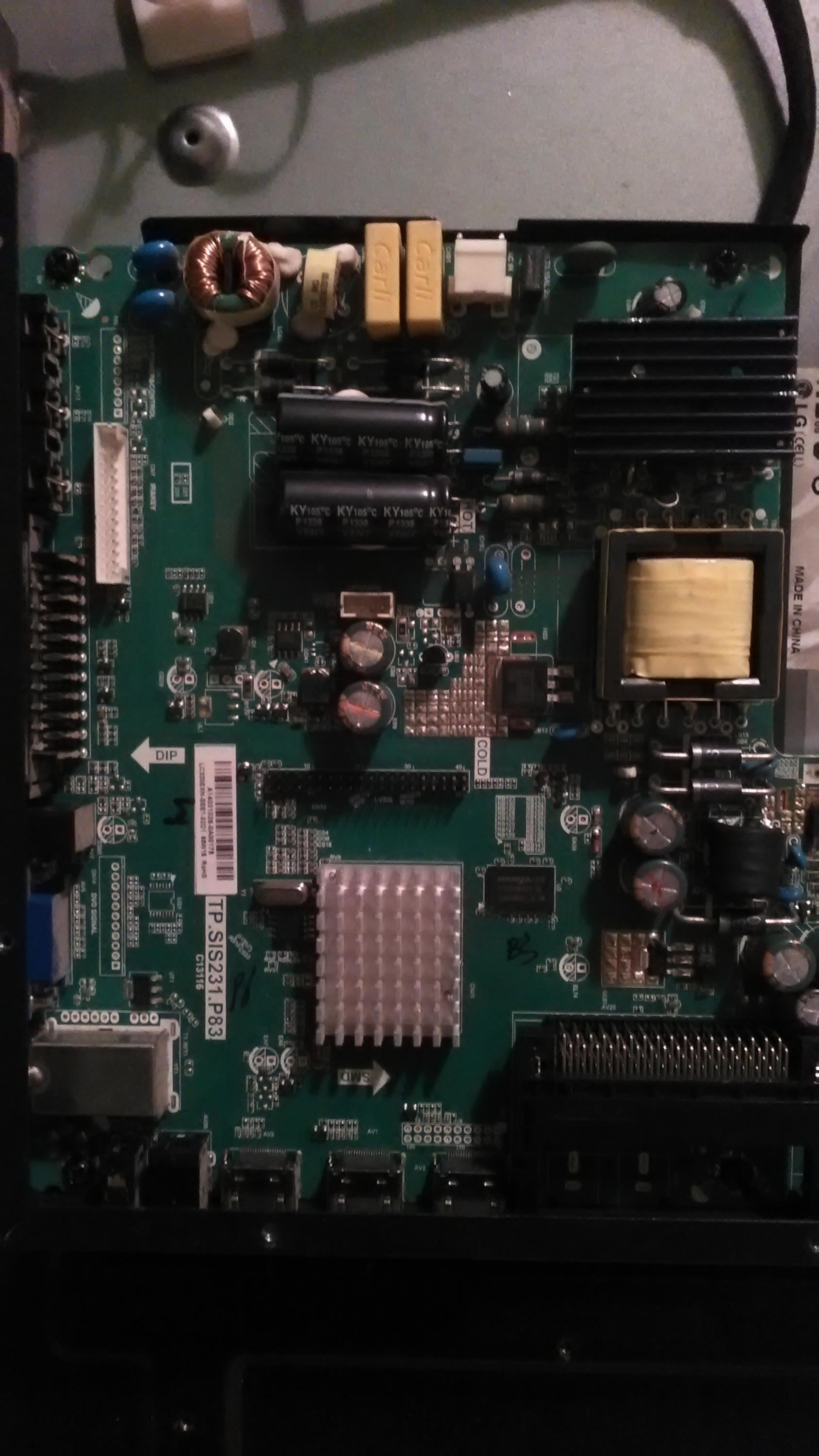

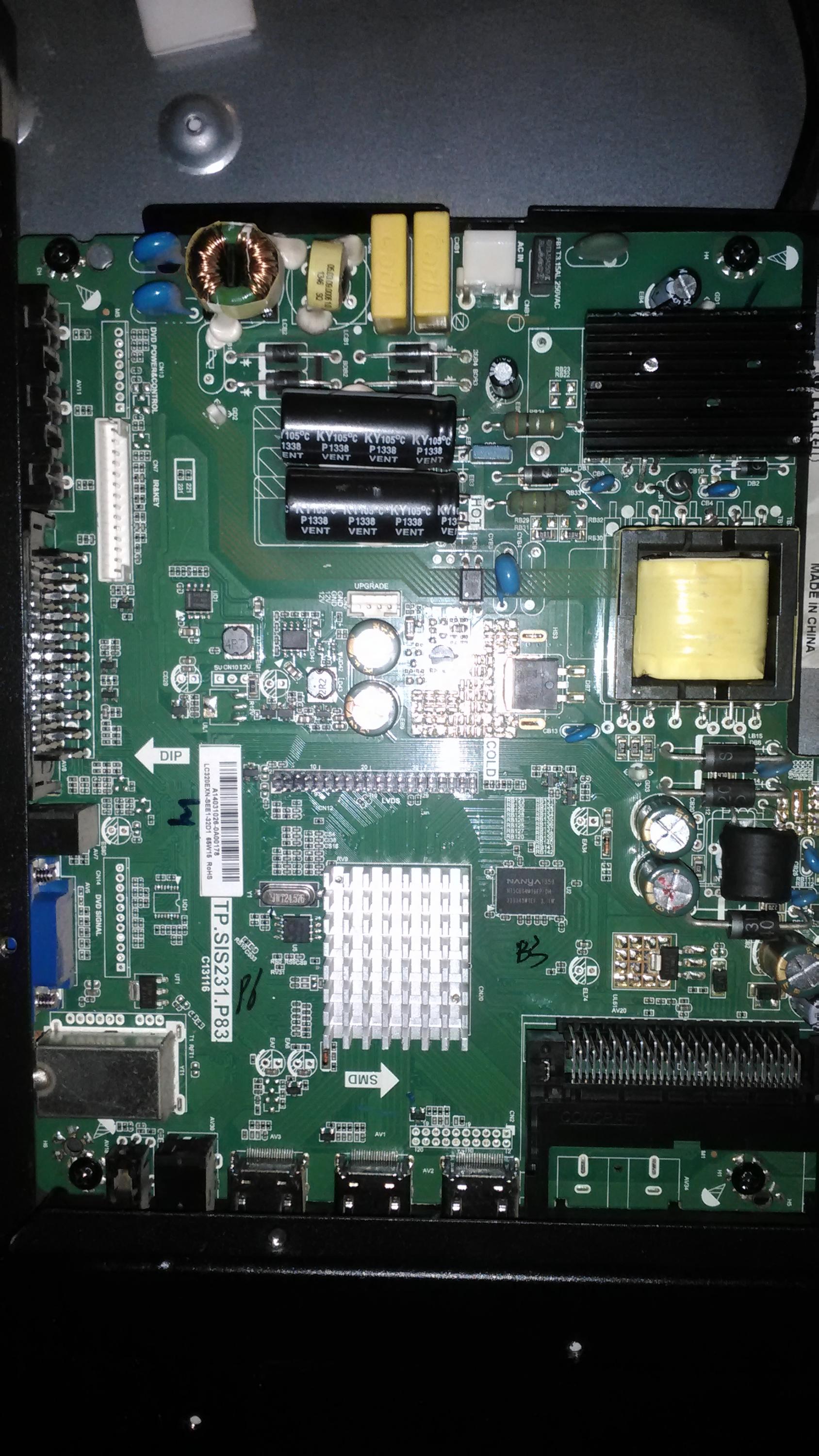

    Hello folks, I layed my hands on FOX 32DLE250 TV which is stuck in startup loop. I opened it up thinking its an board problem. I have checked every cap and transistor there is and it all turned up to be absolutely fine nor there are any damage marks.
    I googled this problem and found that it could be a firmware fault. I've found that there is a full reset pin on TV boards but I can't seem to find it on this one. Also I tried to reinstall/repair firmware with USB stick but nothing new happened. Anyone had a similar TV problem?

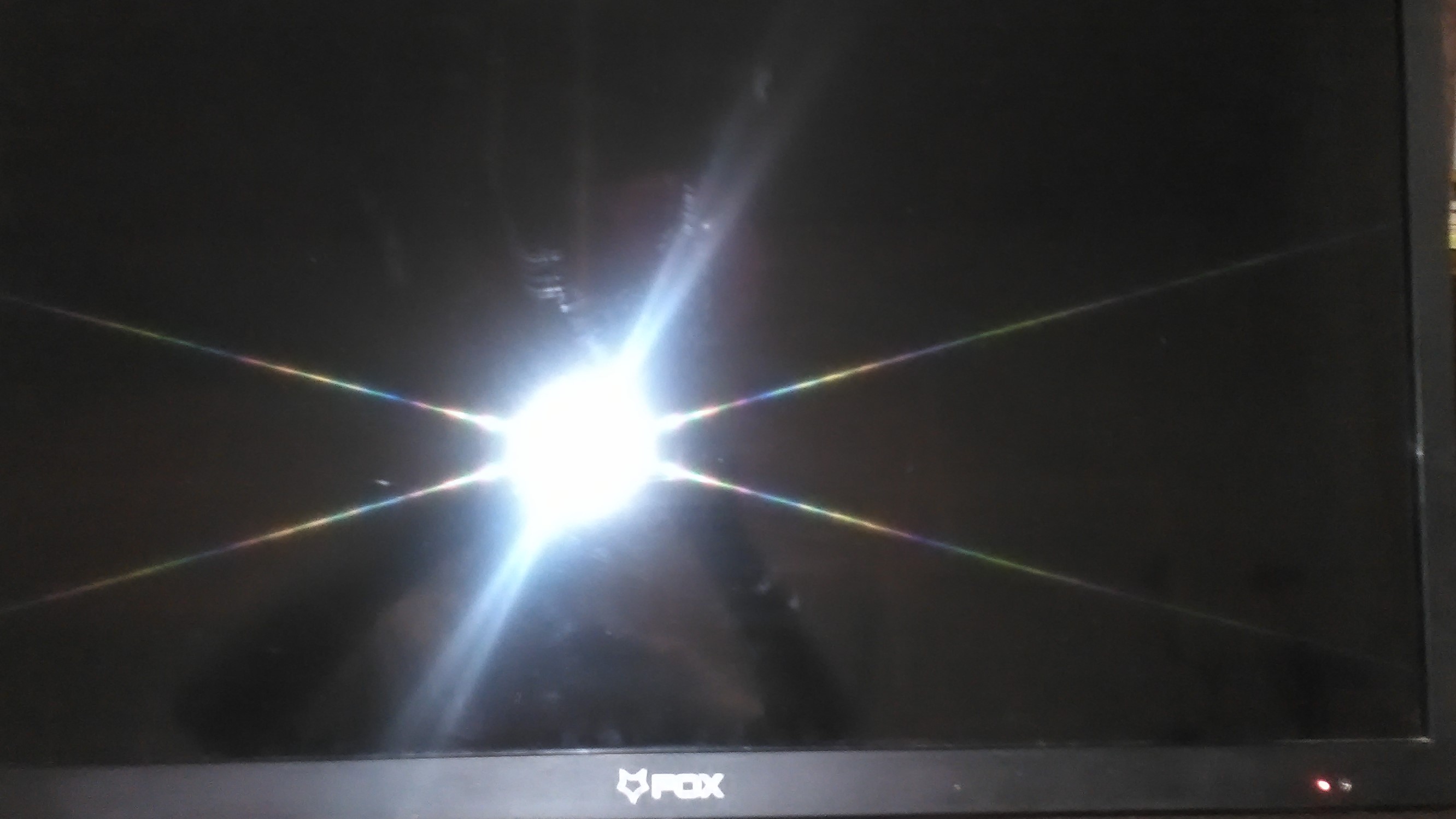

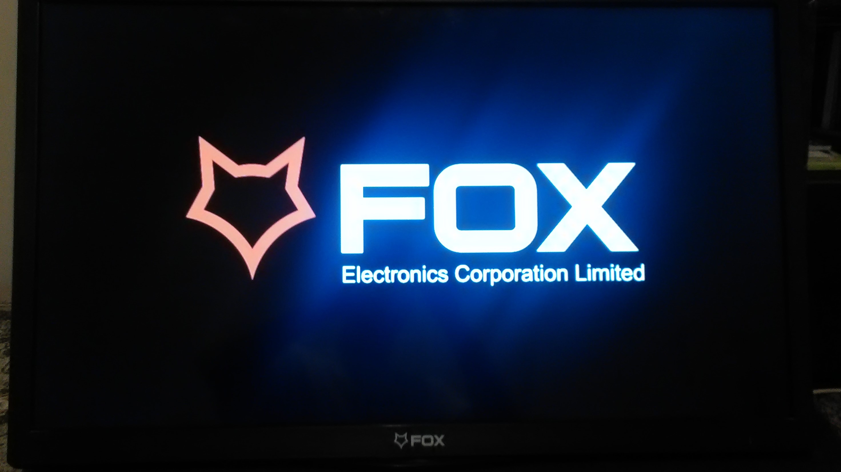

    Is it stuck on your first picture or does screen go off like your second picture?
    • Morsus
      • Nov 2016
      • 96
      • Serbia
      Re: Fox 32DLE250 startup loop
      Sorry about not explaining better. So when I plug it in it shows the FOX logo for like 5 sec and after that screen goes black and red led diode lights up for also a few seconds. This process repeats.
        Seems to be eeproms for various models of this board. Try freezing eeprom and see if it will start up.
        • Morsus
          • Nov 2016
          • 96
          • Serbia
          Sorry I have never encountered a problem like this (with eeprom) can you explain how to freeze eeprom?
          Thank you.
          • tvtimmy
            • Mar 2015
            • 1160
            • usa
            Take a can of computer keyboard duster(compressed air) and hold it upside down.
            Spray the part. It will start as a liquid then freeze on contact.
