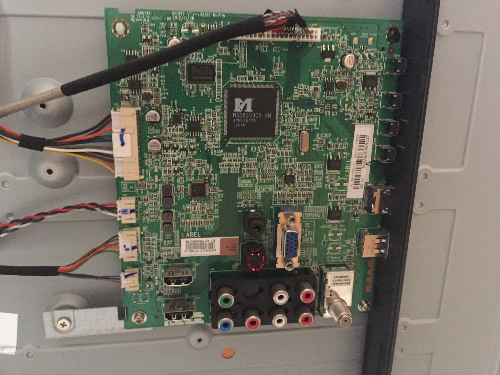

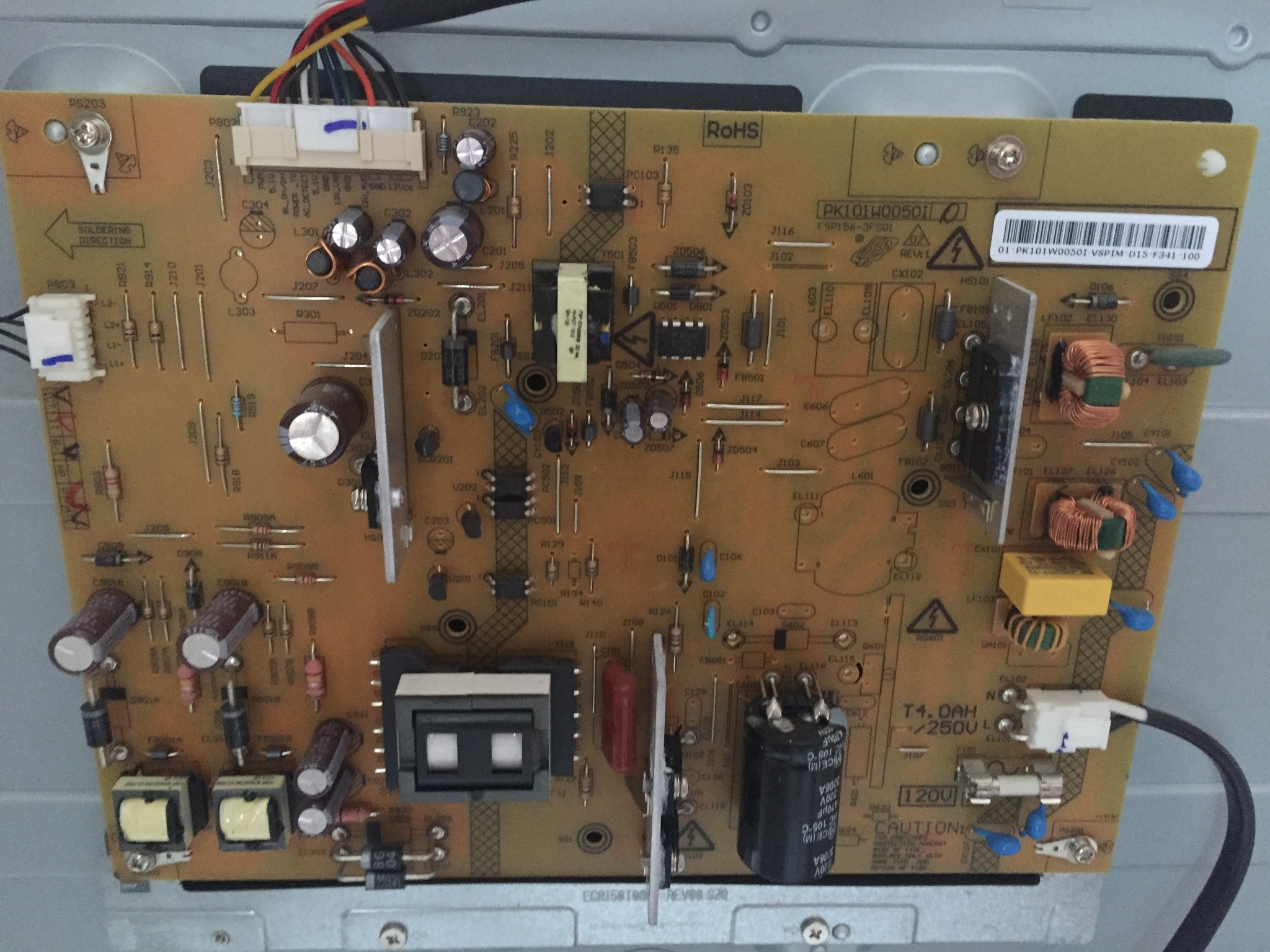

    Good evening Forum People. I just got finished fixing my plasma and now my led has died. Done some searching and some testing and I rushed out and replaced the t-con board thinking that was the problem. Mistake. I have sound but no picture. Right now it's too light out to do the flashlight test so I will post that later. Here's the test results.

      Couple of photos attached.
      Backlights flash on for a second and then nothing.

        You have open circuit in the LED L1 string, you can verify that swapping the set of L2 LED string wires with L1 LED set of wires to see if reading will follow.
