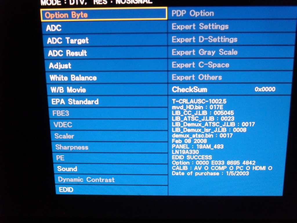

    i have a samsung LN19A33OJ1DXZA that i just replaced the caps on the power board ...but when i turn it on my audio is low and can't turn it up or down it is set at 9% volume any help ??Please.

    Factory reset?

      Re: Samsung Low audio
      How does one do that ?Thanks.
        I got it working! Thanks!!
          What did you do to get it working again??
            Factory reset ..i pressed -- mute ,1,2,8, power and went into 'option byte' and there is where the factory reset option is.
