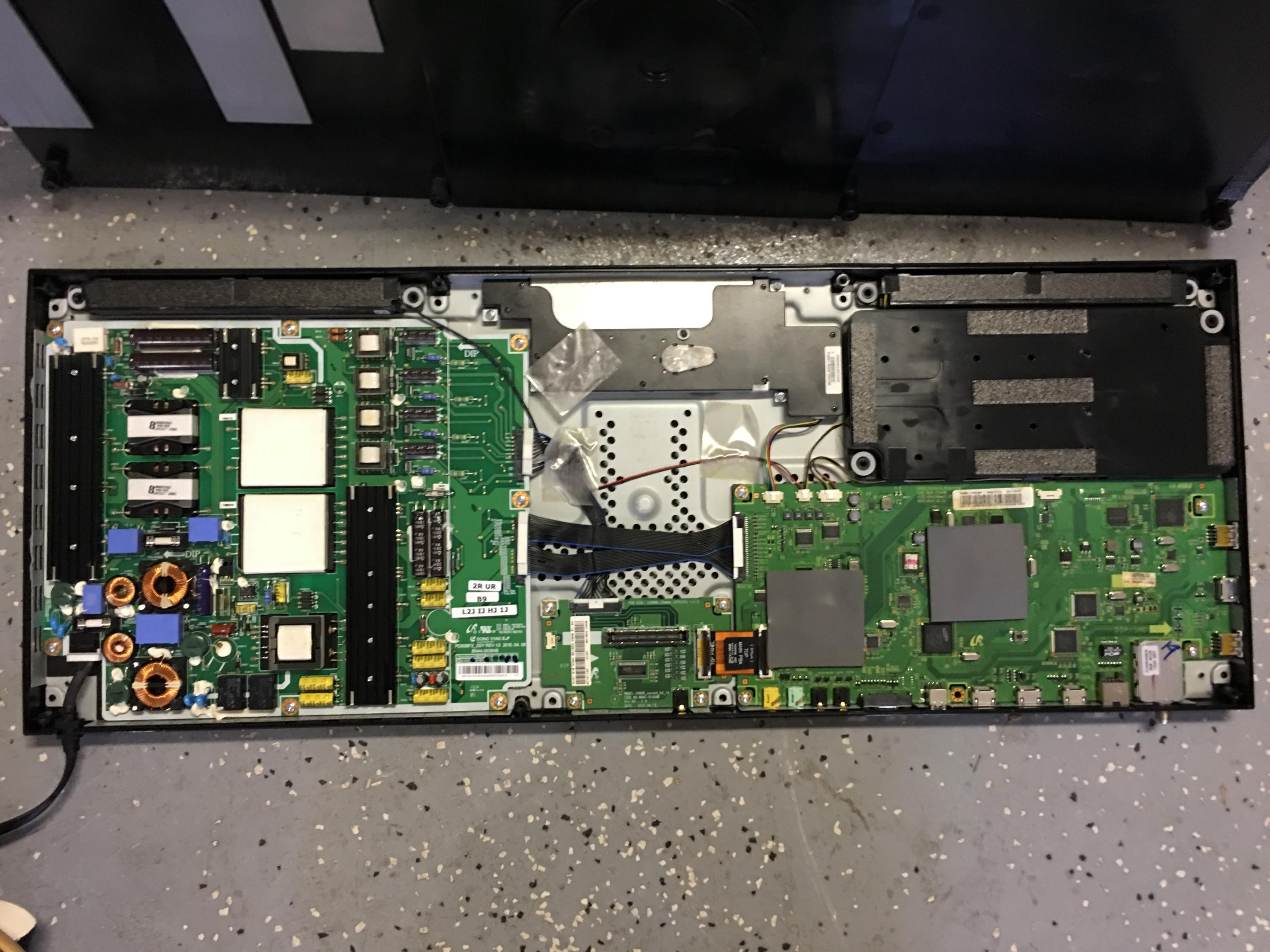

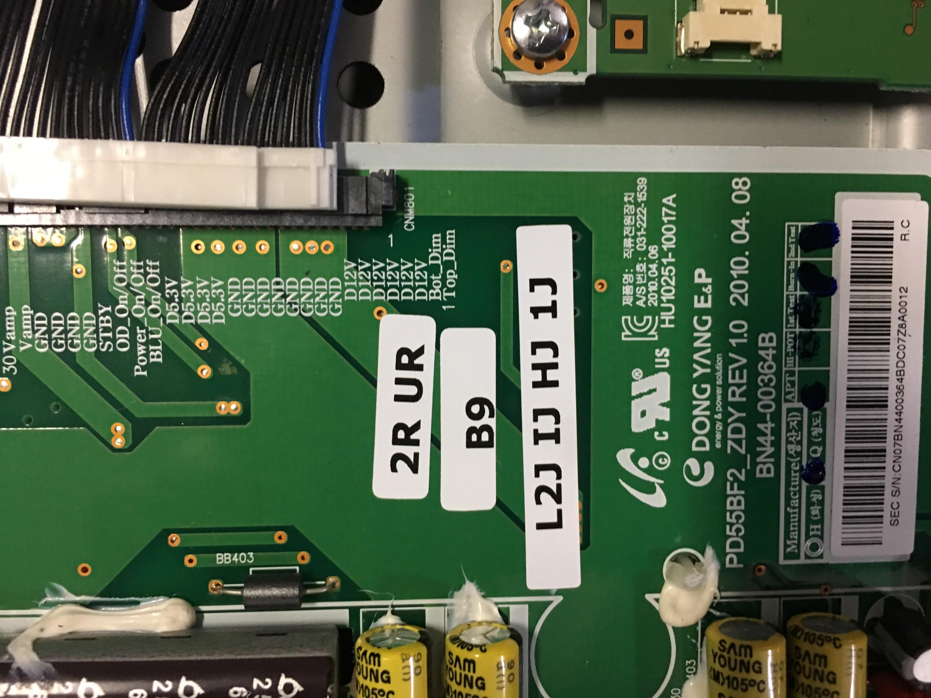

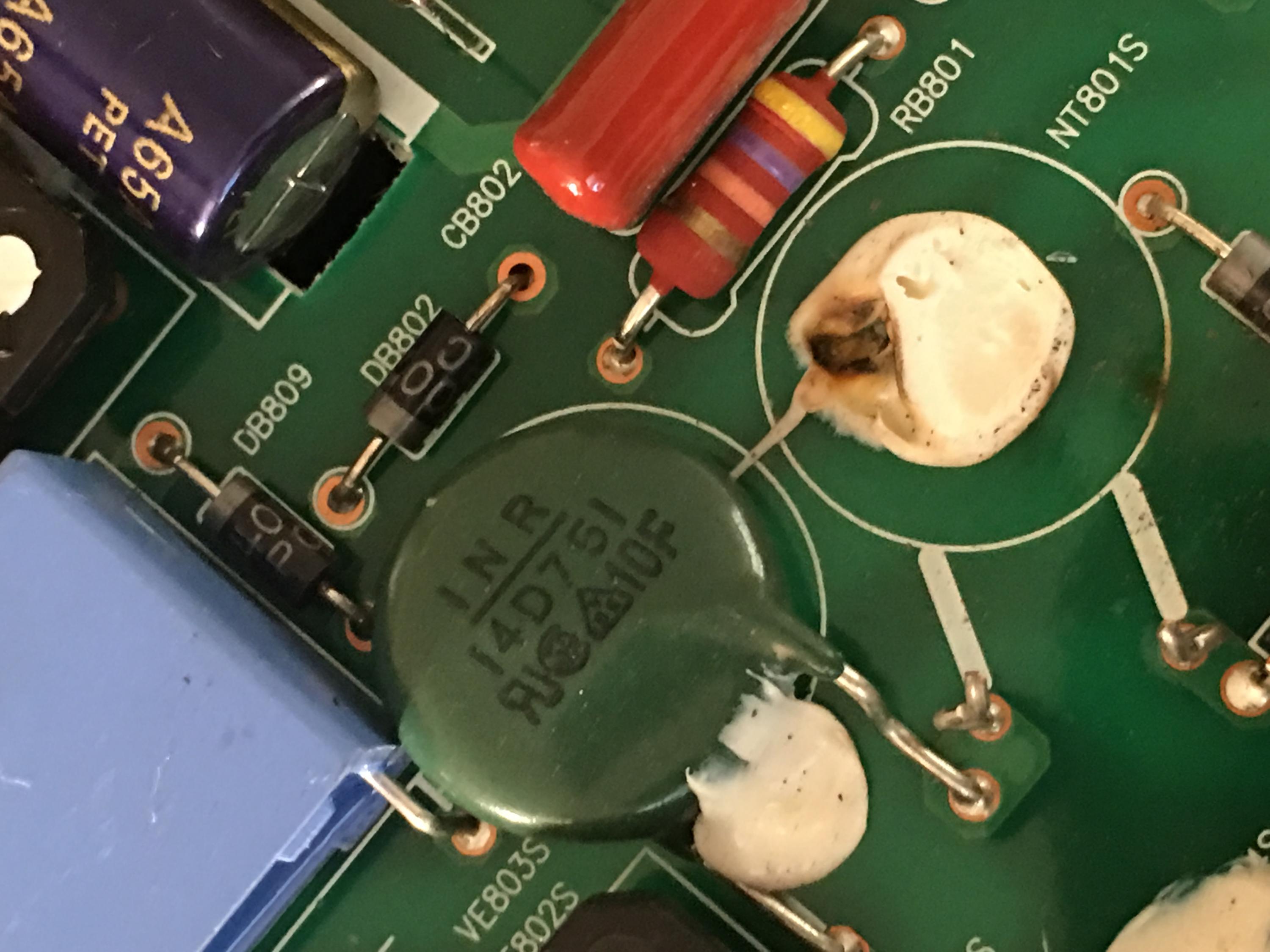

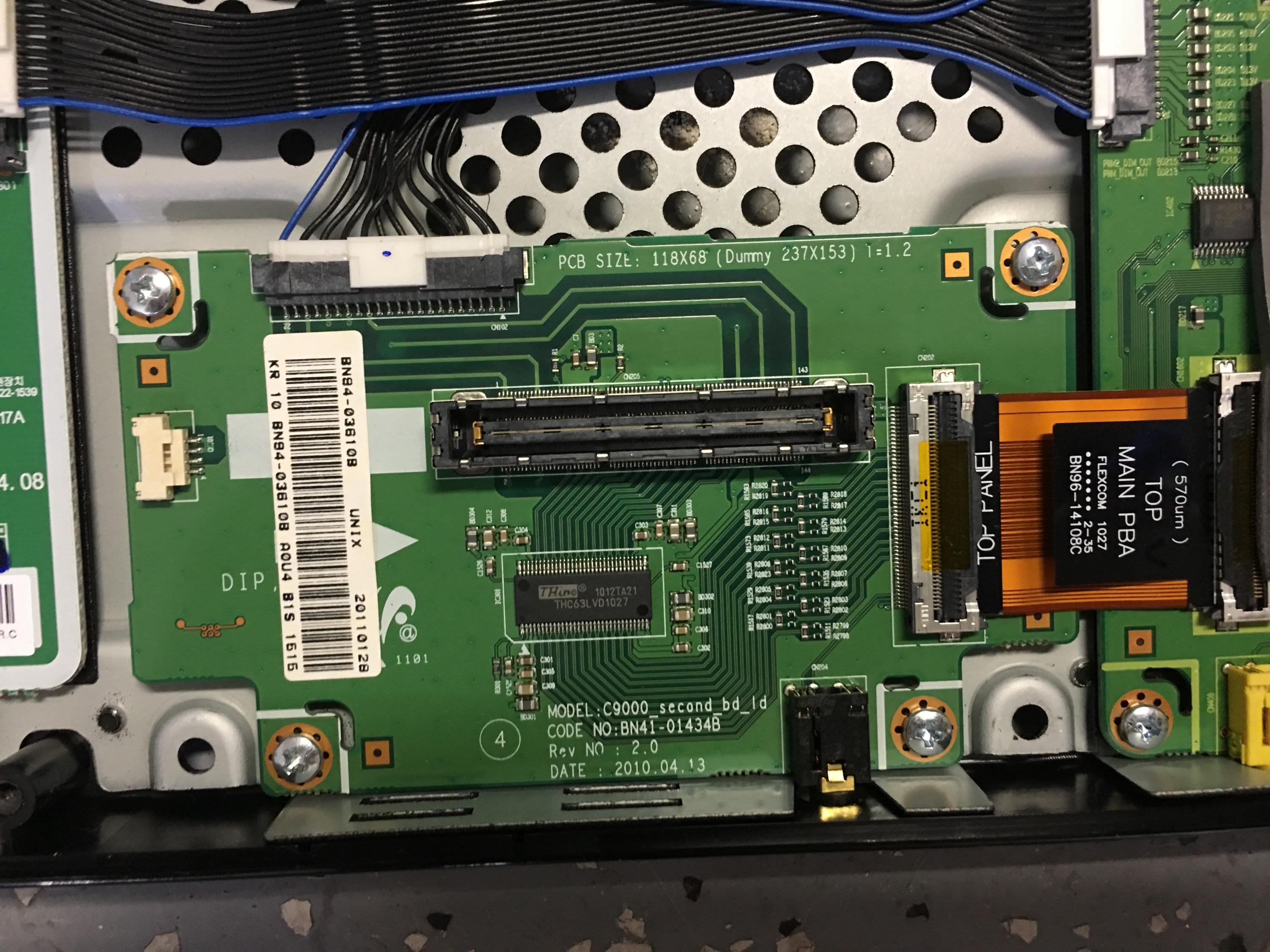

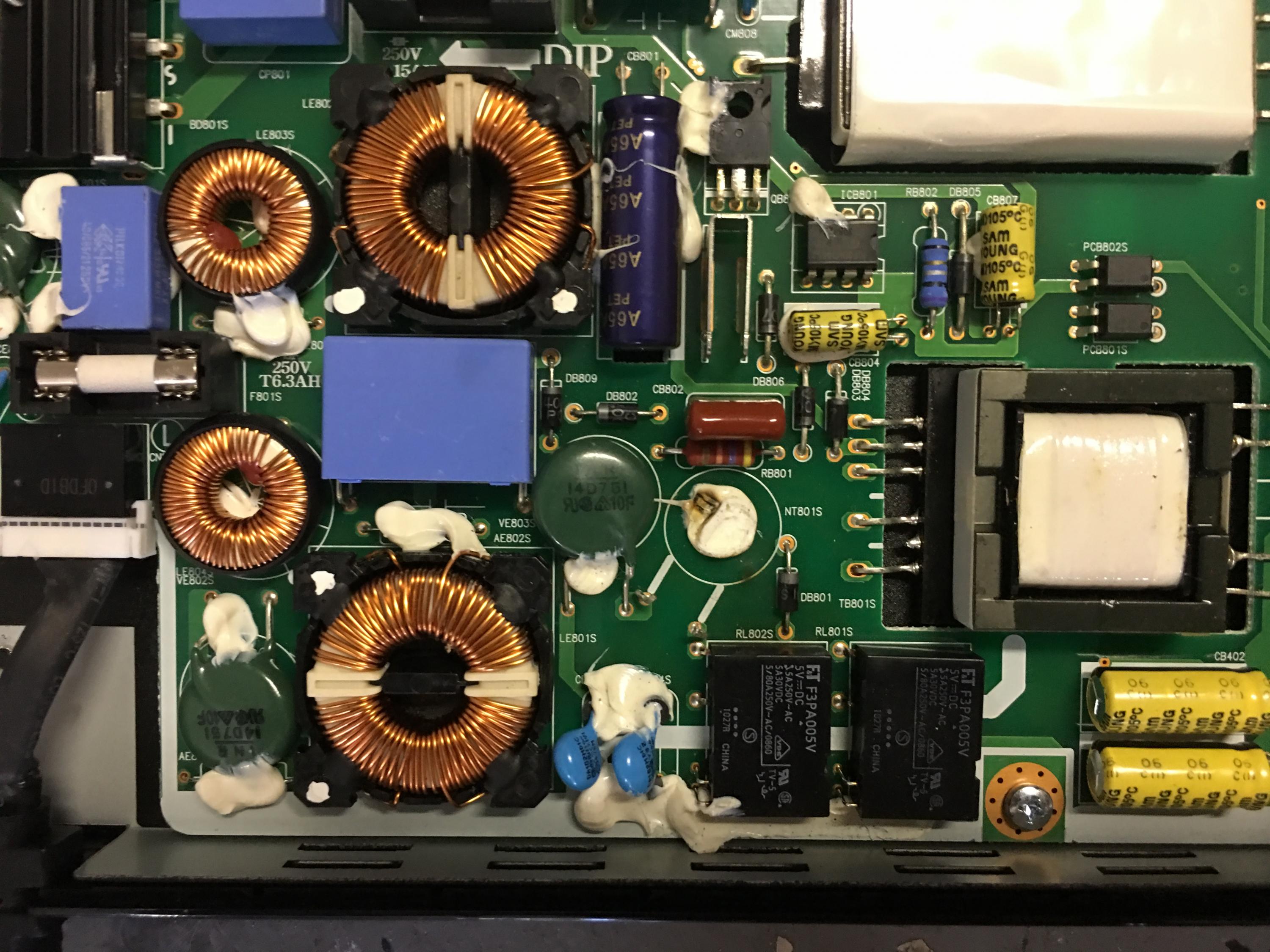

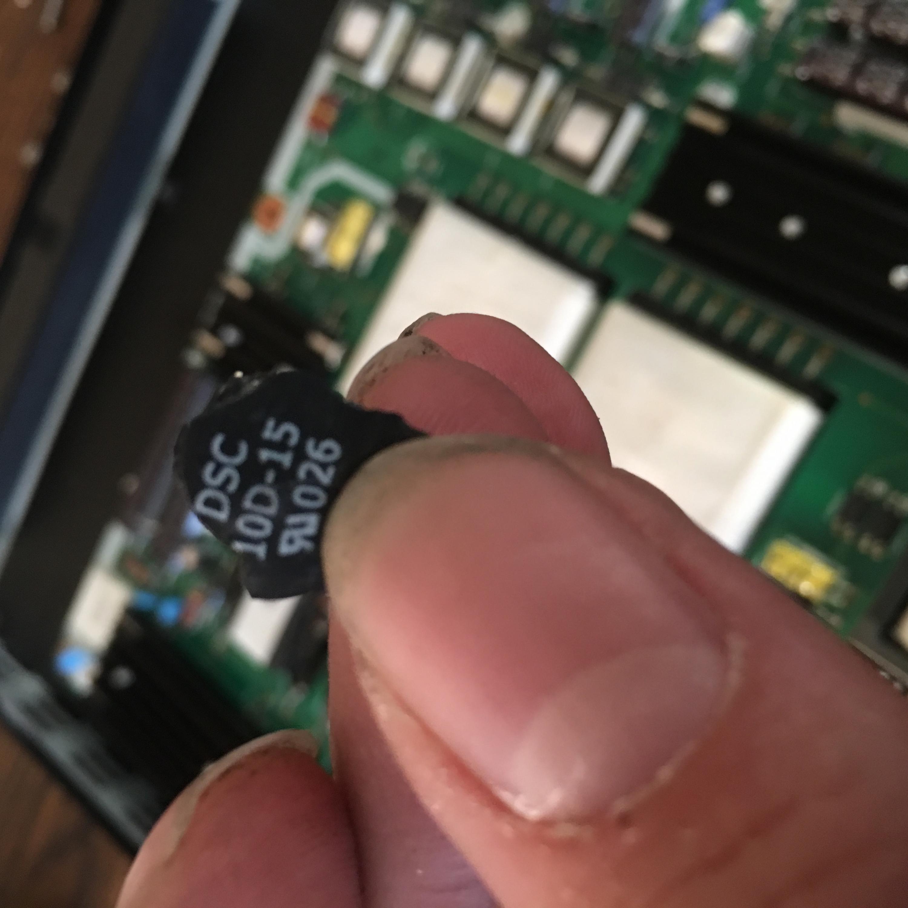

    Hi folks, having an issue with my Samsung TV, when I connect the N240 docking board to the main unit the supply 6.3A fuse blows. I'm looking for the schematics to help me out. side note during the troubleshooting I managed to blow out the NT801s DSC 10D-15 Thermistor quite spectacularly would love to understand why!
    Re: Samsung UN55C9000
    Any good clear pictures of what we are dealing with to see how all the boards are connected together?
    NTC will blow if the load is shorted I.E. bridge rectifier, PFC Power MOSFETs, etc.
