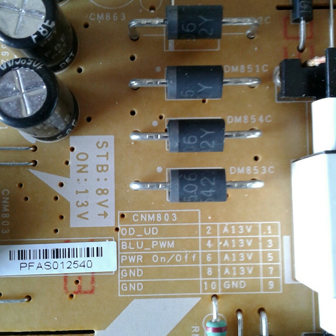

    Have a Samsung here that seems dead.. checked the power where it says standby it only reads at 1.8 volts no visible sign of bad caps on board..output to video board is also 1.8..
  • dskall
    • Oct 2016
    • 2905
    • usa
    Re: Samsung un58h5202af no power..no clicks or lights
    What is voltage across your main cap?

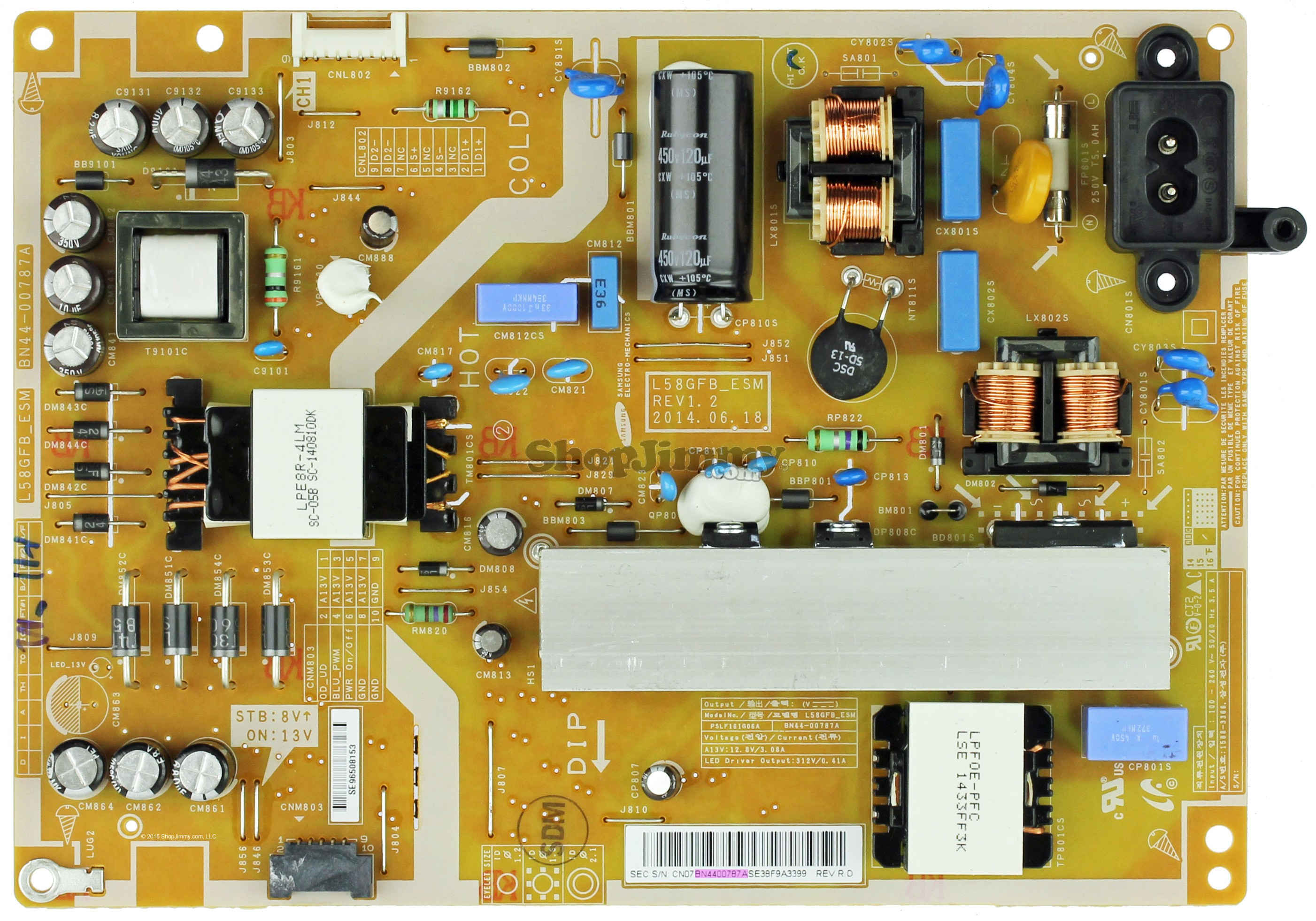

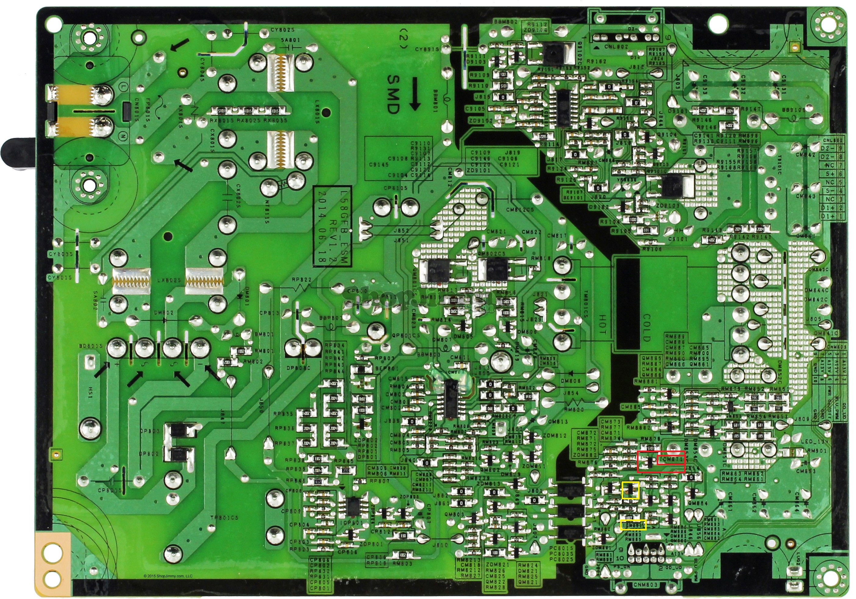

        Any good clear pictures of the whole back side of the TV showing all the board?
        Pictures of the whole power supply board?
        Power supply board P/N BN44-???????
        • jackfish
          • Dec 2016
          • 89
          • canada
          Power supply bn44-00787a Have to get another pic..
            So if you disconnect the cable between the power supply board and the main board then power up the power supply board, what DCV do you get on jumper J846?
            http://www.shopjimmy.com/catalogsear...?q=bn44-00787a
            Pictures provided by shopjimmy. BN44-00787a

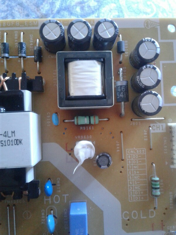

                            The big cap is kicking out 170vdc...i can do soldering anremoval..im trying to post a pic but for some reason it won't let me..the small transformer on the cold side looks discolored around it..
                            • jackfish
                              • Dec 2016
                              • 89
                              • canada
                              Area looks heated...
                                That section is the Voltage Boost Converter for the Backlights LEDs.
                                So you do have the main DCV to run the primary drive circuit.
                                At this point start by checking those black rectifier diodes in the cold side to make sure they are OK first, you have 9 of them.
                                BTW, there is SMD Power MOSFET on the bottom side of the board where there is sign of heating, check and see if that MOSFET Q9101? is OK or not.

                                  Piped off one leg on each diode to test.. .they only read in one direction...the mosfet under the burn reads at both legs.. all others read only on the right leg..took it off the board to make sure..

                                    Replaced that power mosfet ..picked one off a 55 inch Emerson tv that had a broken screen..working for five hours so far....wonder if heat killed that chip..

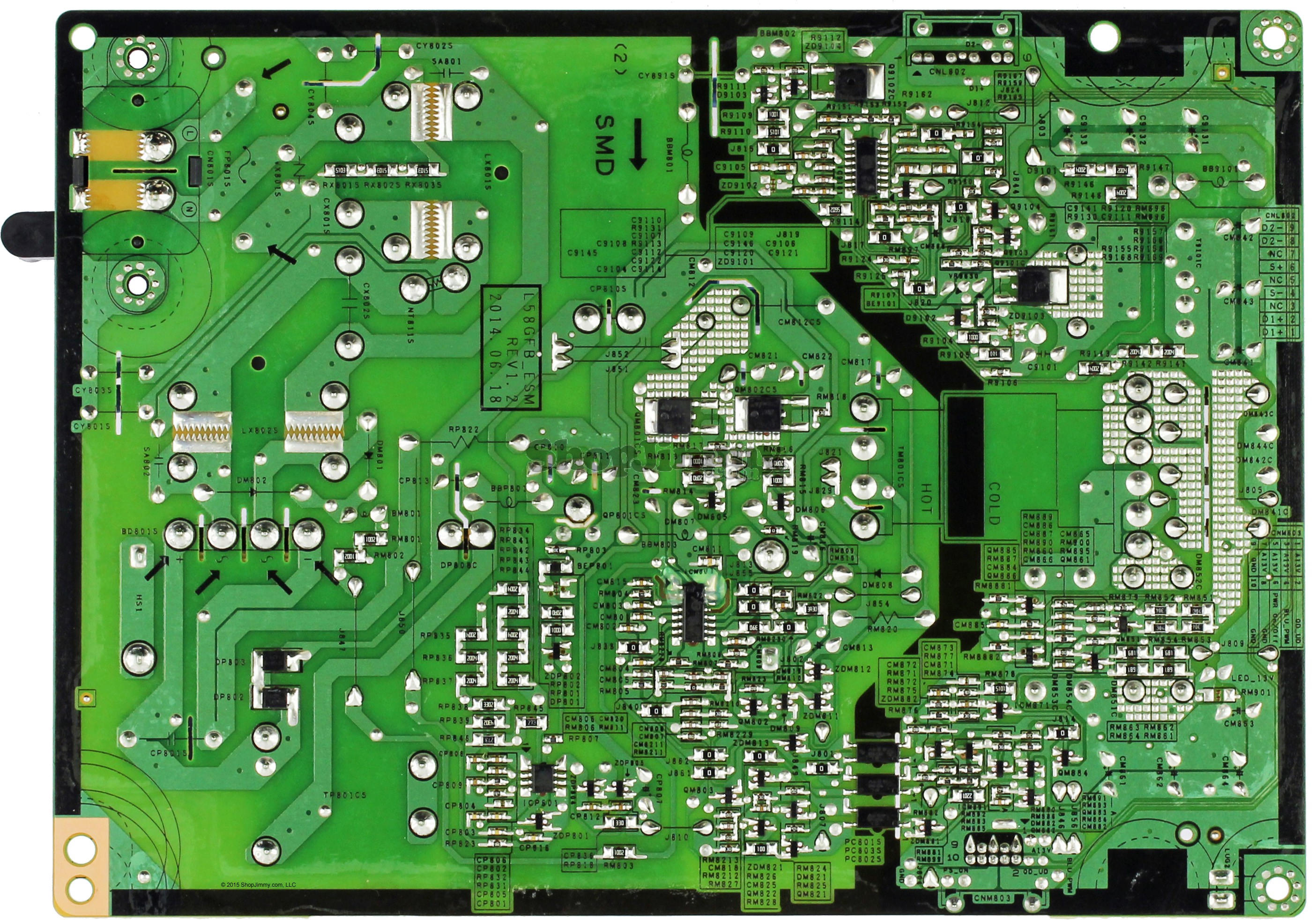

                                      hi , ive read this thread is resolved , i have this tv , mine blowed main psu fuse , blowed 2 smd switching mosfet st14n50n wich i replaced by 2 21NM60N to-247 ,added some hole to the board to fit them and 2 small heatsink ( just to be sure), tested it with a 3A fuse insead of 5 to let anychance if the primary goes wrong ,and cap filled up , primary circuit are alive but no standby , after some visual inspection , i have find ICM871 chipped out (circled in red on the budM pic ) the only thing left its the dye , did anyone can help me to find the value of this transistor , maybe if im lucky , its the same as icm801 marked 3A ( circled in yellow ) , but , can't moove without be sure
                                      thanks
                                      • Jeff Pepin
                                        • Jun 2014
                                        • 103
                                        • CANADA
                                        he! good news!! ( At least for me)
                                        a friend have same tv and it permitted me to take an eye on his psu board , found that ICM871 is the same as 801 , marked 3A , and look like general pnp transistor with first finding ,. lets hope mainboard are ok lol
