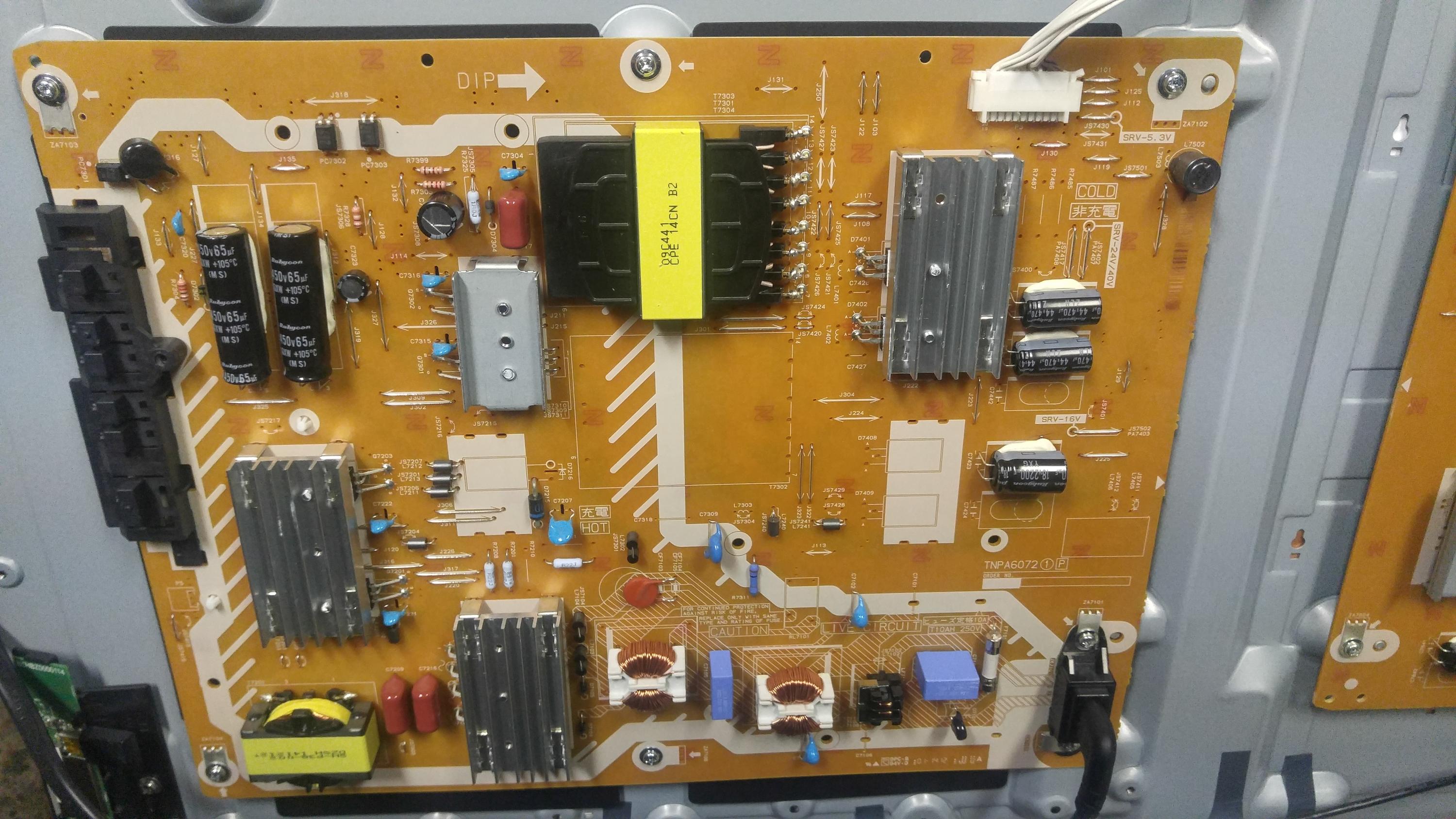

    Pulled this unit out of an e-waste bin. I've already replaced the power supply and still have no sign of life whatsoever. No blink codes, no standby light and no backlight. I've included some pics.
    I've got a multimeter and ready for testing if anyone has any advice on what I should be testing.

    Re: Panasonic TC-55CS560C (Dead No Standby or Blinks)
    Need voltages from connector that goes from power supply board to main board. Will need pin#- PIN DESCRIPTION -Pin voltage in standby-Pin voltage when pushing power button and picture of connector on power supply board.
    Format:
    Pin# - Pin Description - Pin Voltage standby - Pin voltage power on
    1 - XXXXXXX - XXv - XXXv
    2 - XXXXXXX - XXXv - XXXv
    3 - XXXXXXX - XXXv - XXXv
    4 - etc.

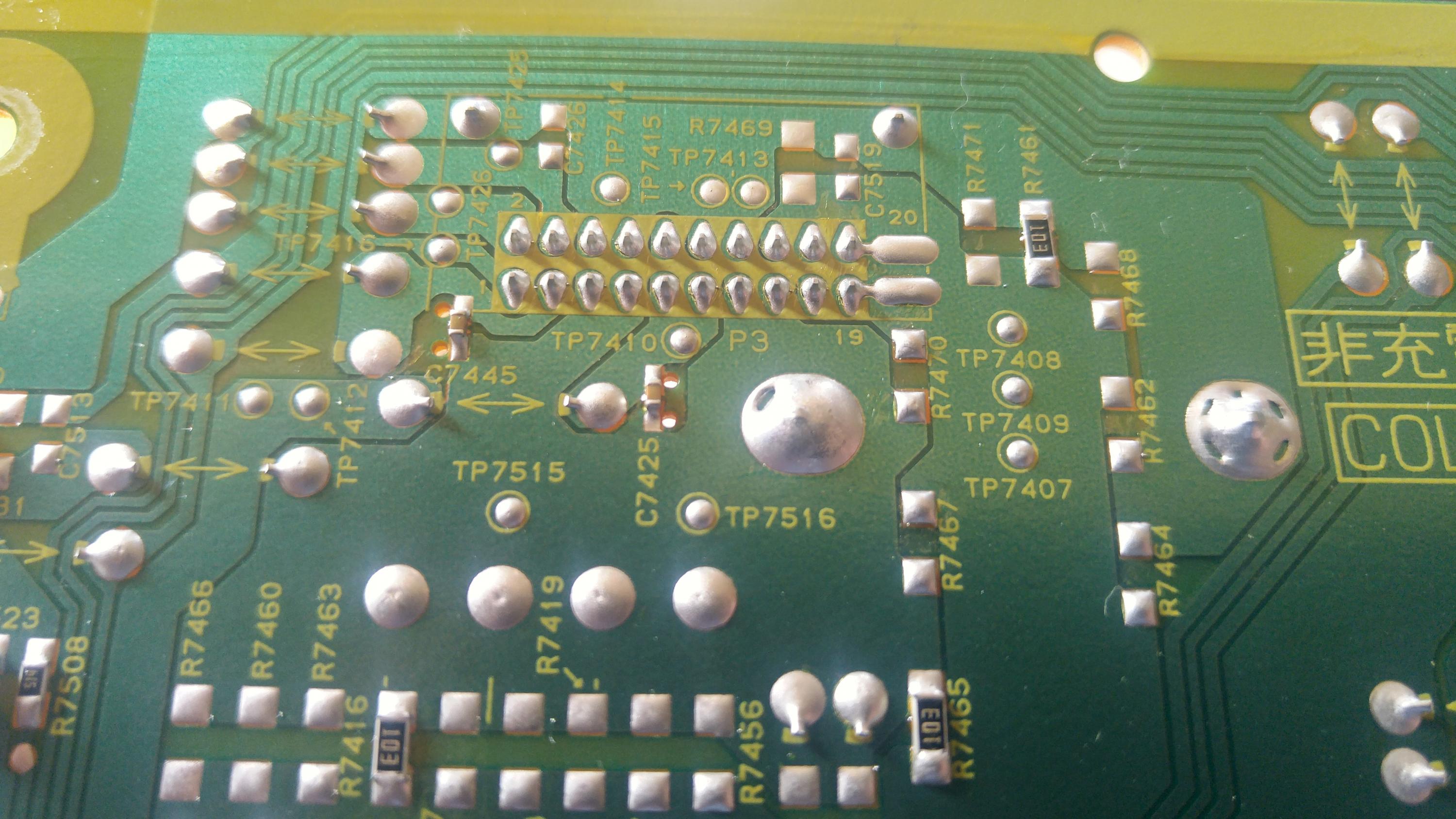

      I don't see any descriptiion for the pins but there there are 10 of them.
      Going from left to right all pins read zero except for pin 9. Pin 9 fluctuates rapidly in voltages between 1.3-10 volts.
        From what I see pin 9 is 5vdc standby. You can measure across leads of main 450vdc capacitors and see what voltage and if it steady. Pull power board see if any pin markings on back and check solder connections from pin 9 back to transformer. Resolder anything that looks bad especially at transformer connections.

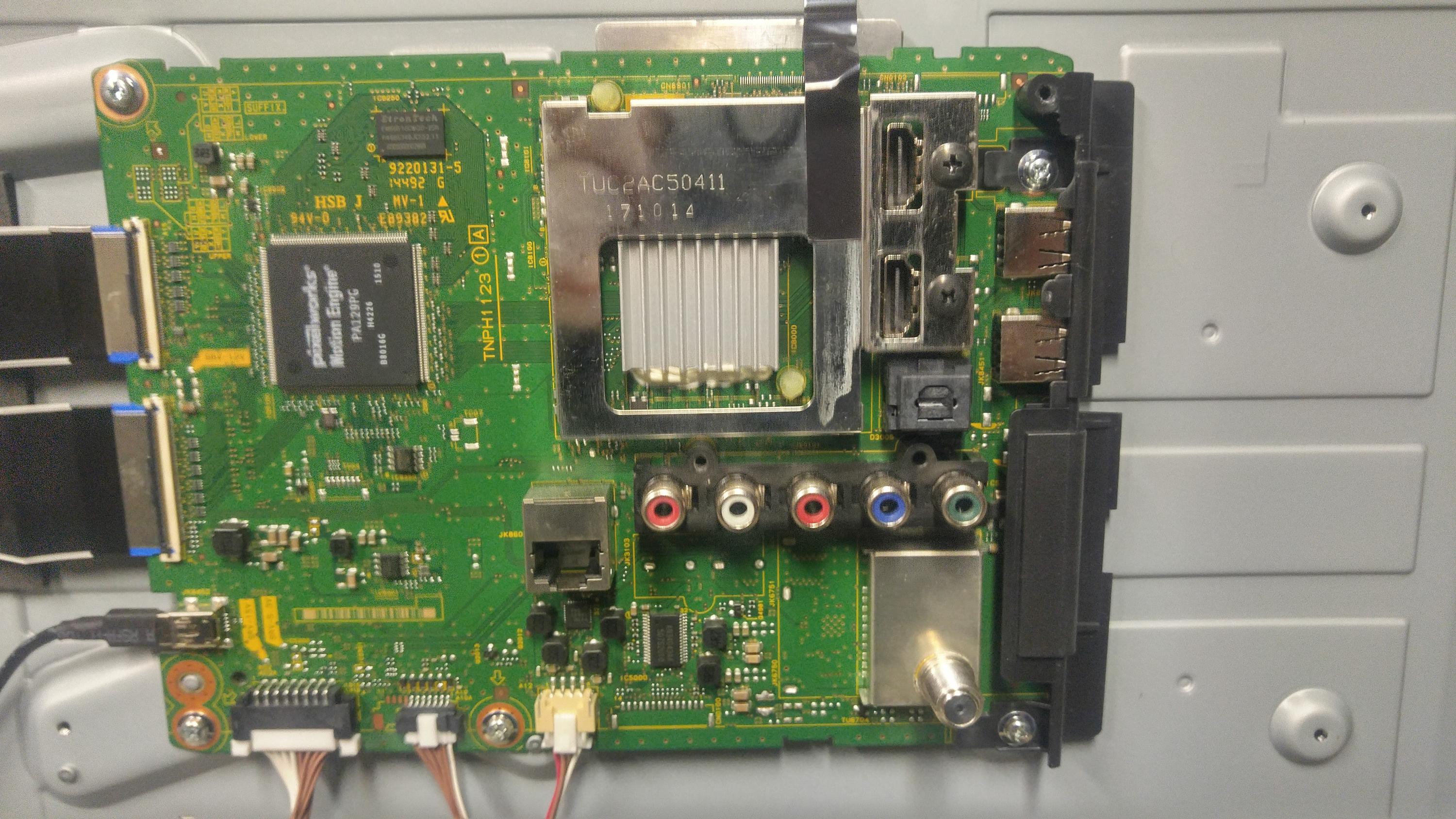

            No markings on the back. Solder connections all look good and I've already replaced the power supply board.
            Originally posted by attainteddragon
            also disconnect the connector that goes from the ps to the main board and see if your stby becomes stable.
            The stby voltage is steady at 10.5 when I disconnect the main board.

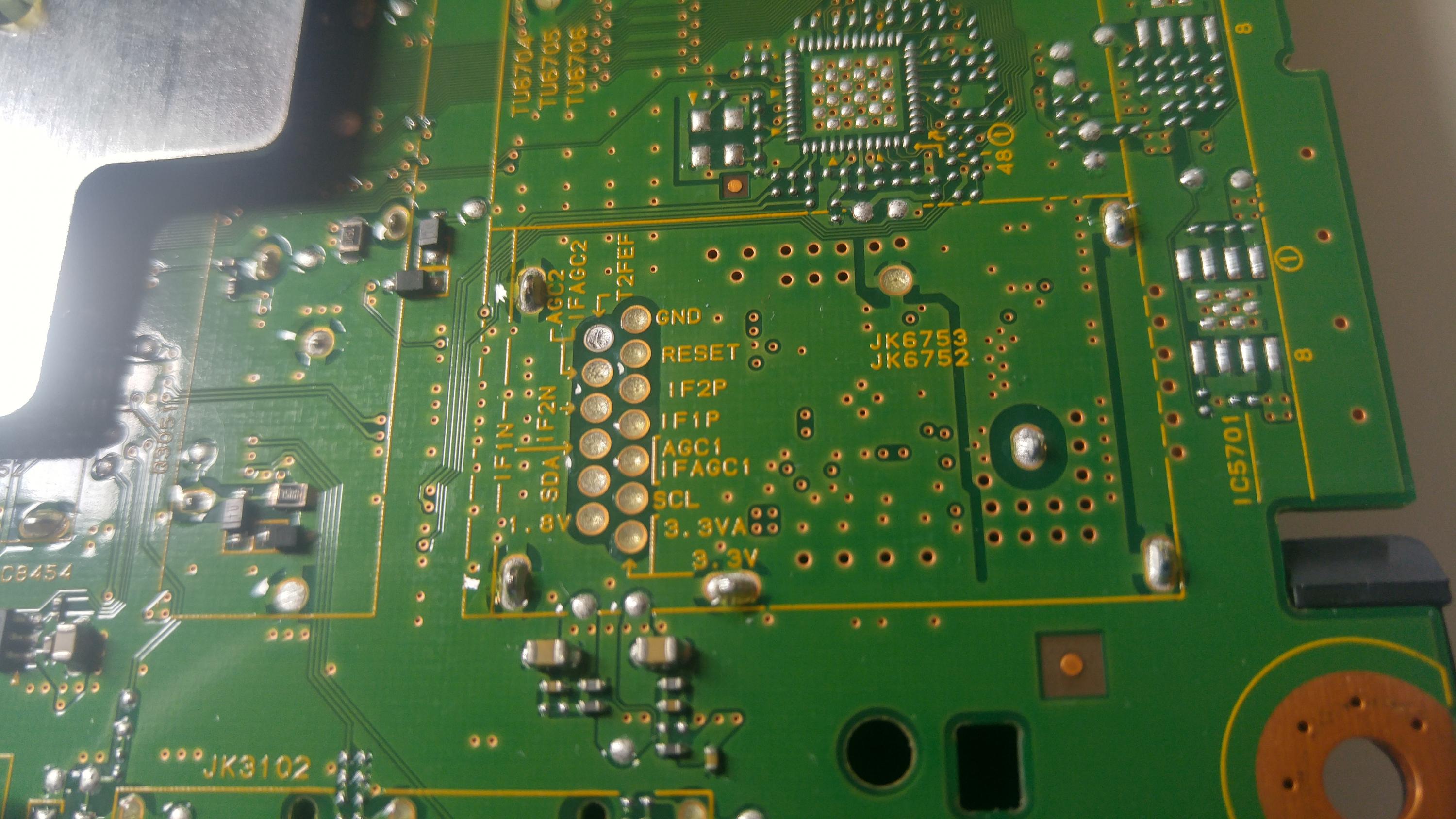

            The second picture is the back of the main board. Not sure if it helps at all.

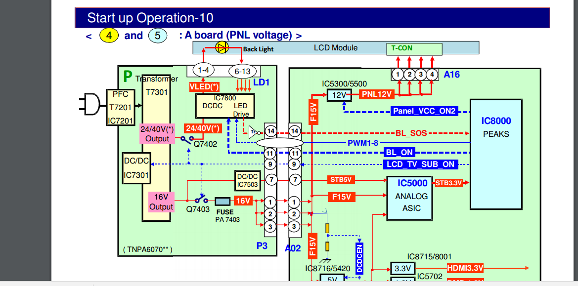

              Found this probably newer models but may help.

                I'll have a look at that now. This TV was in fact manufactured in 2015.
                That was the technical guide for my TV. Based on the trouble shooting steps for no power and no led it looks like I need a new main board. I've found one on ebay for $25 so I'll order that and hope for the best.

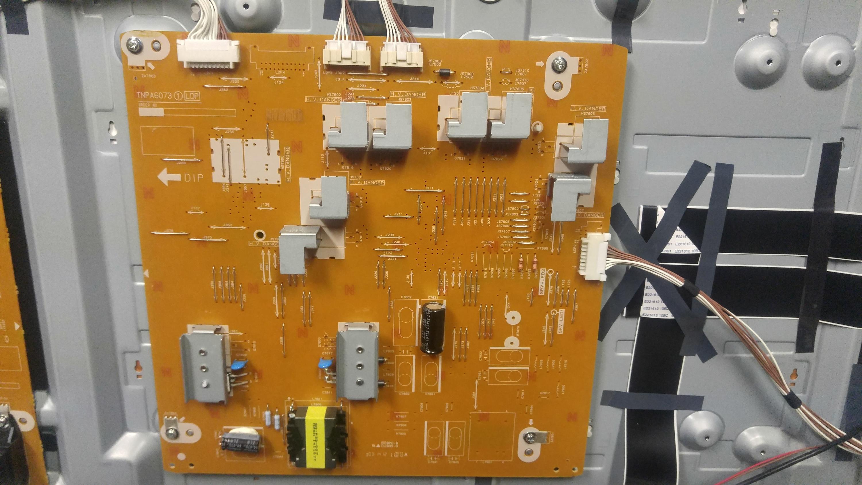

                      I got the new board today and the TV is working, however all isn't right yet. The main plugin for the main board isn't the same. The original has 16 pins and this one only has 14. It's plugged in and working but the TV is brighter on on the top half than it is the bottom half. I suspect the 2 extra pins are the issue. Any ideas?

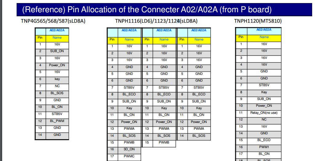

                          Decided to double check and it turns out I didn't buy the correct board this is for a TC-55CS540C. Foolish mistake on my part.
                          Here is a diagram that might help. A02 is the plug for the main board.
                          • tbj12
                            • May 2016
                            • 22
                            This pic might be more helpful. Both boards are TNPH11231A. Pin 15 is PWMB and pin 16 isn't showing.
                              Think you will need to get correct board.

                                It is the correct board it's just from a different model tv. I just pulled the board out of the tv and there are empty slots for pins 15 and 16. Looks like I just need to swap the connectors from the old board to the new one. That's not an easy task with my soldering skills though.
                                What's the difference between PWMA and PWMB?

                                    Probably Pulse Width Modulation A / B. Control of Brightness to backlight?

                                      Would I be taking a serious risk to run a jumper from PDM A to B?

                                        Decided to just go with the jumper from pin 13 to 15 and the picture is perfect now. Just gotta hope it holds up.
