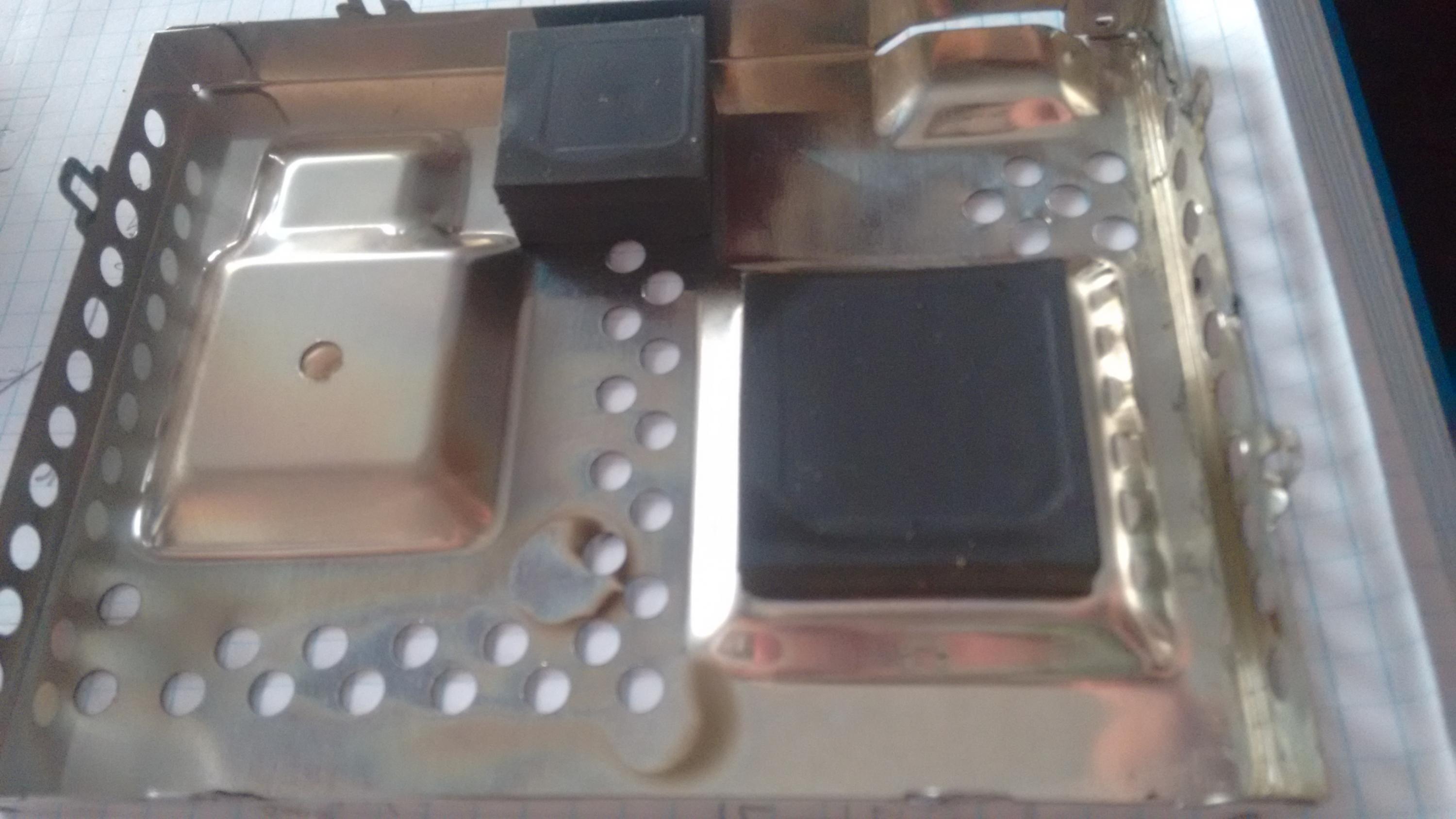

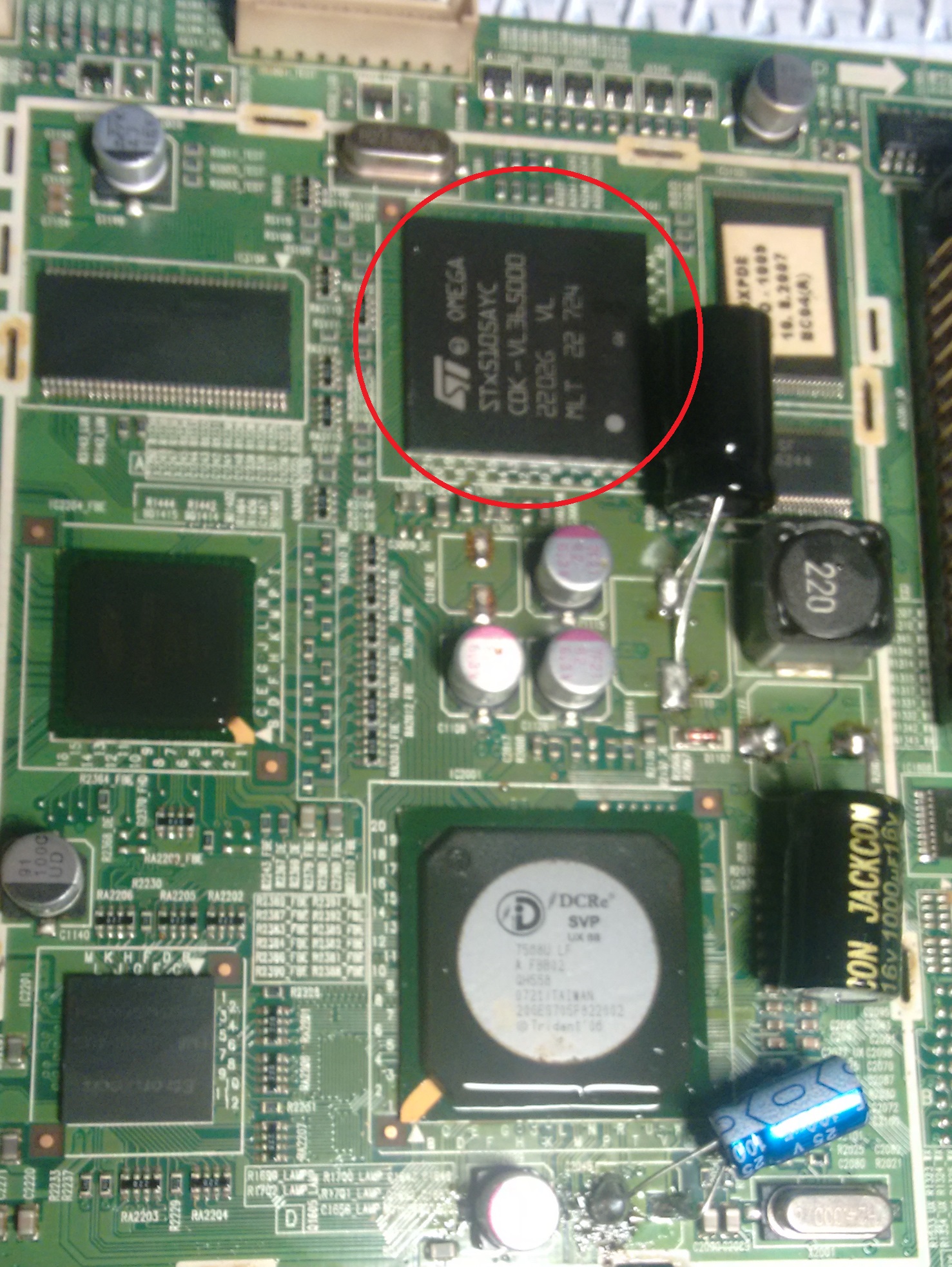

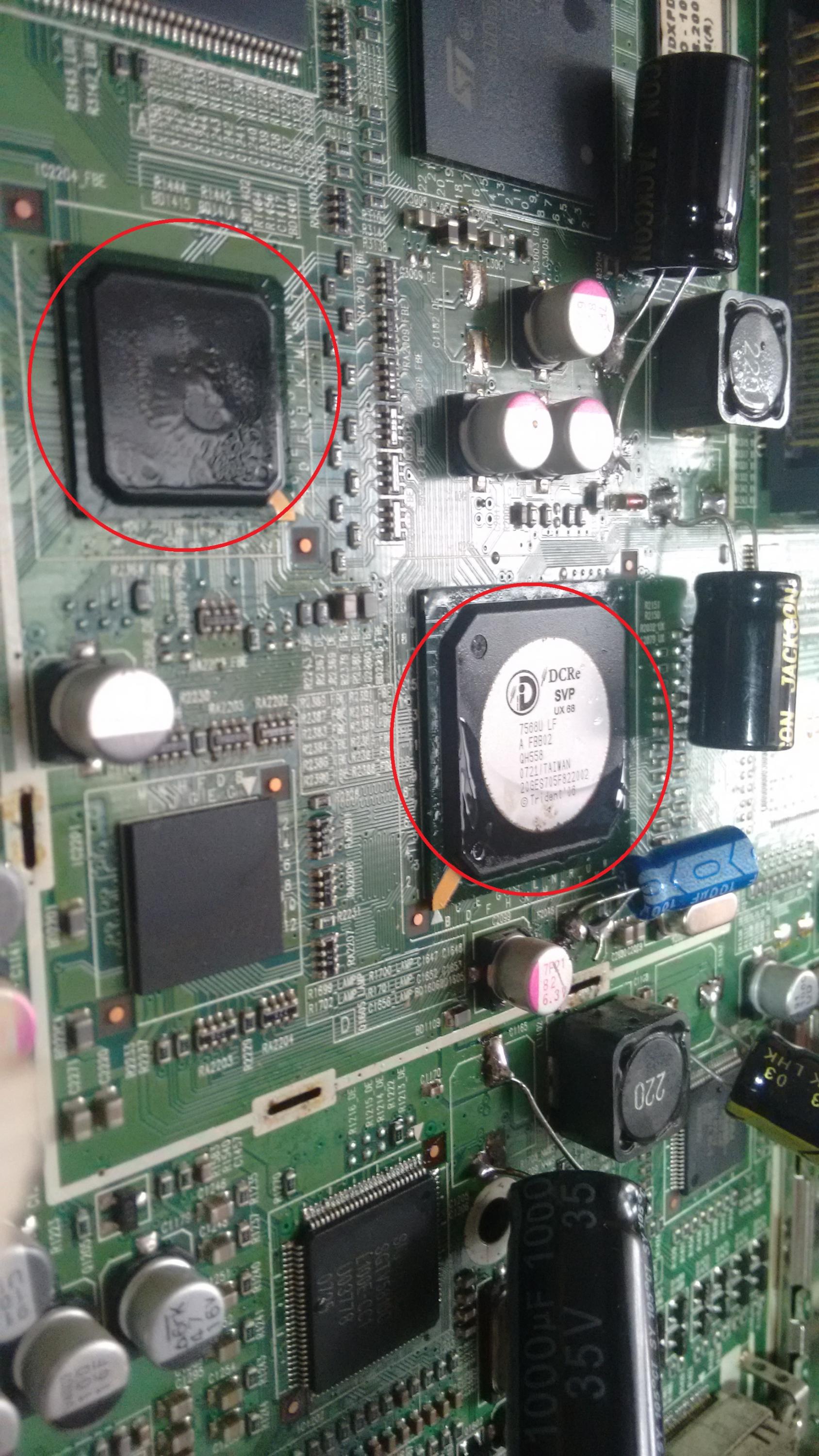

          New update:
          I tried cooling down mainly the main board with a manual fan xD (FML) and I can get the tv on.
          Now, without stopping, DTV mode image is perfect, no lines, BUT I can't find any channel, it tells me to check the antenna conexion. In RGB mode, the color pumping remains, and in AV mode image is perfect as always.
          Under the shield T5 labelled there are two chips with a sticky liguid and a square thing on top to refrigerate. Could it be a problem there?
          I don't know, Ill try to get a fan from a pc and narrow the problem down a little bit more later.
          Edit: I've attached some pictures, one half of a chip is dry

            That board is a mess. Were the heat pads gone for those chips?
            • Leplus
              • Apr 2017
              • 47
              • Spain
              #66
              Re: Samsung TV LE32M87BD image issue, turns off by itself, works perfectly after warm
              Those pads are on top of both chips (red circles in picture 1) touching all the time, they always were there, and the shield can't go any deeper, it's in its position already so I guess the pads are touching the chips.

                          Update.
                          Now with the usb fan pointing to the shield area (removed) tv stays on again, i wasn't able last night. But as soon as I take the fan away the cycle begins, it doesn't admit any temperature.
                          Also, in dtv mode, when pressing one or two chips on the shield area, I can get the no signal image properly, because sometimes it freezes before the reboot. But in RGB the color pumping issue remains.
                          I will end up ordering the board anyway so we can voodoo this one looking for a solution XD. I'm opened to oven methods also if required xDDD
                            I think You need to re-ball the BGA chips

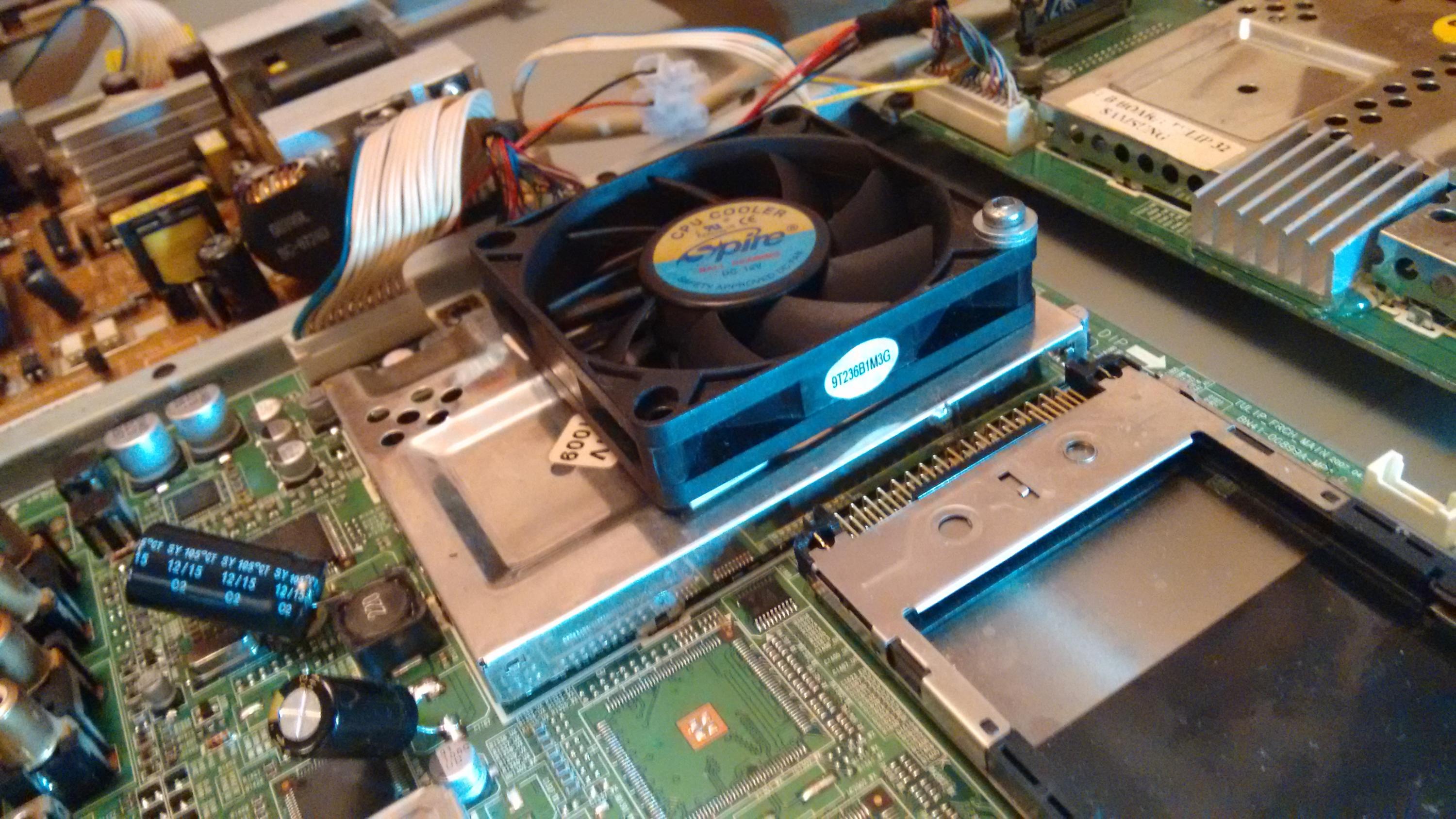

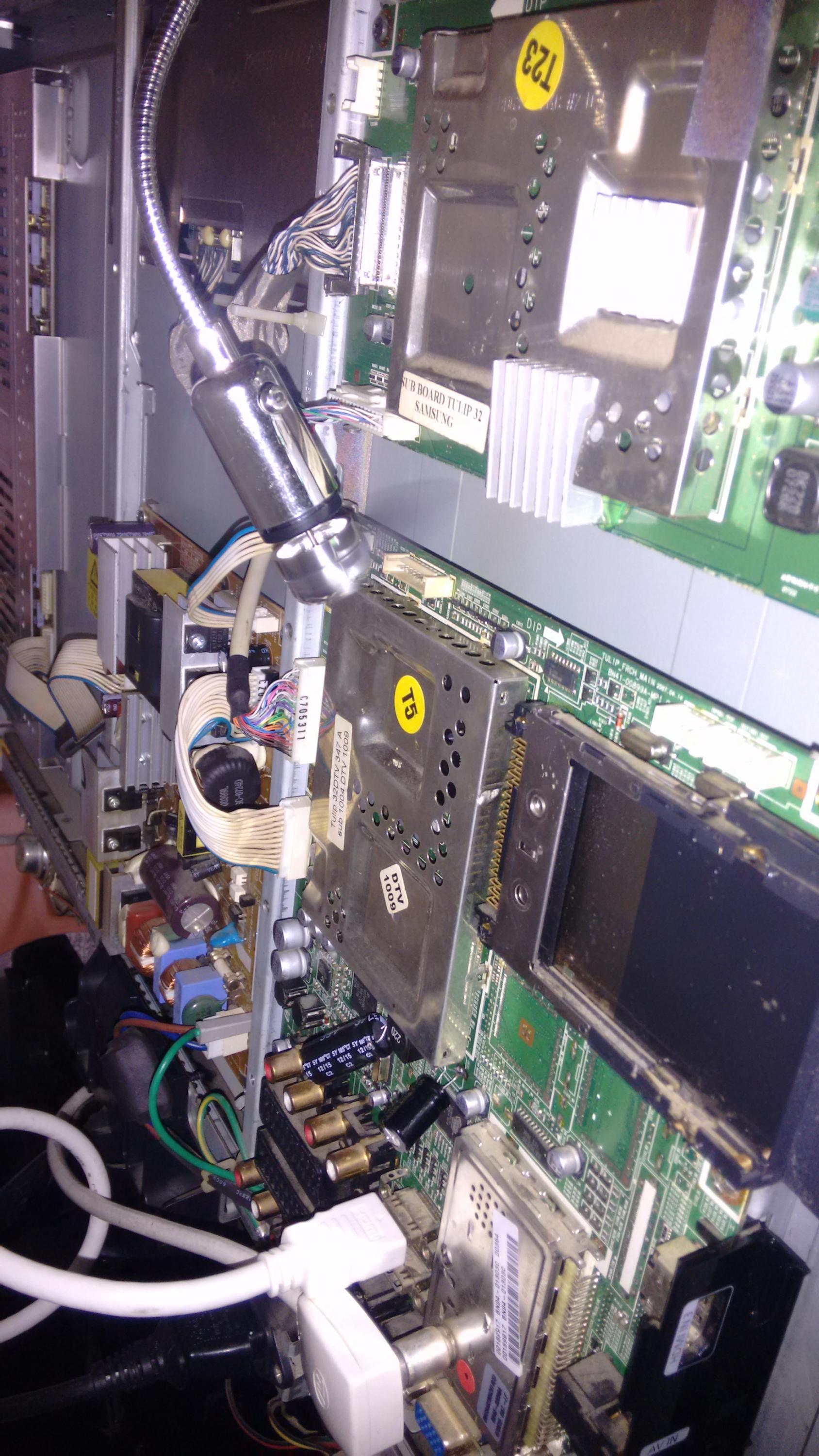

                              Now I have a fan pointing to the shield (I can keep it) but in fact after several trials I think the critical point is the chip in the red circle: IC3101 IC-DECODER;STI5105,PBGA,324P,23x23mm,PLA
                              So, that is the final stage I think, with the usb fan like in the second pic:
                              - DTV mode no signal from the antenna
                              - Ext 1 (RGB), perfect image
                              - Ext 2 (AV), image pumping the colors
                              - HDMI 1, a bit cut at the bottom
                              - HDMI 2, perfect
                              Now I'm looking for buying a cheap pc fan and put it inside, more quiet, because the chinese one that I have now is like a drone in a room.

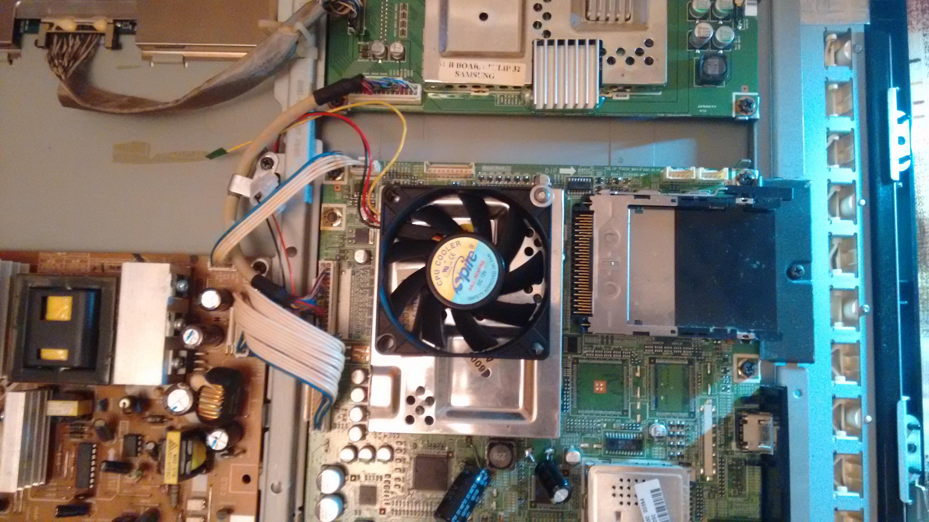

                                Update.
                                Well, this is the final stage for this board. In the picture I'm showing the pc fan that I put on top of the shield, so now the tv stays on and I can watch ext 1/2 and hdmi. DTV is not possible.
                                I think I'll get a new board soon but for now, this is ok.
