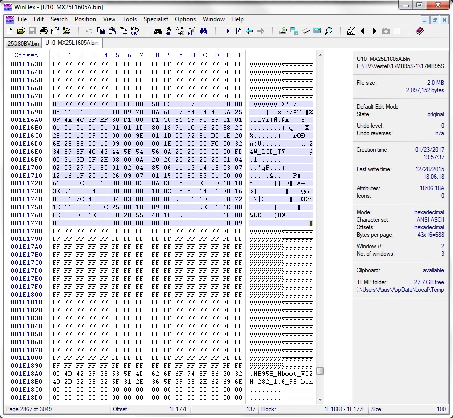

                      • gabiz_ro
                        • Mar 2011
                        • 167
                        • Romania
                        Re: TOSHIBA 48L1433DG no display
                        I can't find firmware 10082828_27092518_40D1333B
                        On Toshiba support is only firmware with upgrade_mb90.bin file ,no mboot.bin.
                        What mboot.bin you used? Dumped by someone or from other firmware,most of dumped are 2MB but from other firmware may have only 1MB to preserve some setting,panel type,logo etc.
                        On mboot.bin at offset 0x01e1680 are 100h bytes with EDID.
                        Compare that area from original dumped bin with what you have now in mboot.bin.

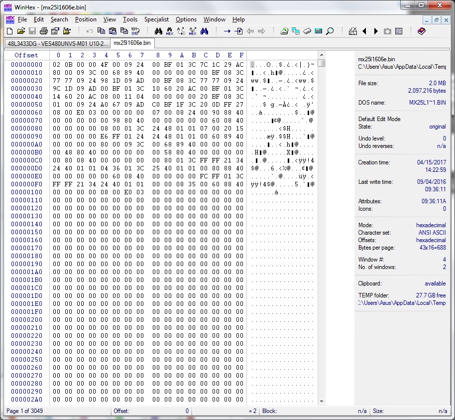

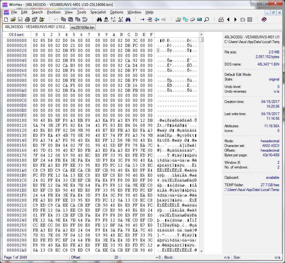

                        • fpatrice2008
                          • Oct 2015
                          • 16
                          • FRANCE
                          Hy,
                          I used mboot.bin with 1MB not 2MB
                          no data after FFCCB, 1MB of course.
                          In the elektroda.pl forum, I find 2MB files for the 48L3433DG, same TV family
                          Topic is : Toshiba 48L3433DG wsad SPI
                          It's for same panel VES480UNVS-M01
                          Problem : I have not point enough to download this.
                          If you can or someone, thanks you ,very much.
                          • fpatrice2008
                            • Oct 2015
                            • 16
                            • FRANCE
                            I get the file.
                            At address 0x01e1680, it's good
                            I will do the test

                                • gabiz_ro
                                  • Mar 2011
                                  • 167
                                  • Romania
                                  From quick look at mboot.bin there are two kind.
                                  Like one you posted earlier
                                  On another one from other TV
                                  You can't swap them,are incompatible and result as kernel panic,doesn't know how too boot firmware from NAND.
                                  If dump are really from same type of TV try to upgrade again.
                                  Post your original,untouched dump first time made.

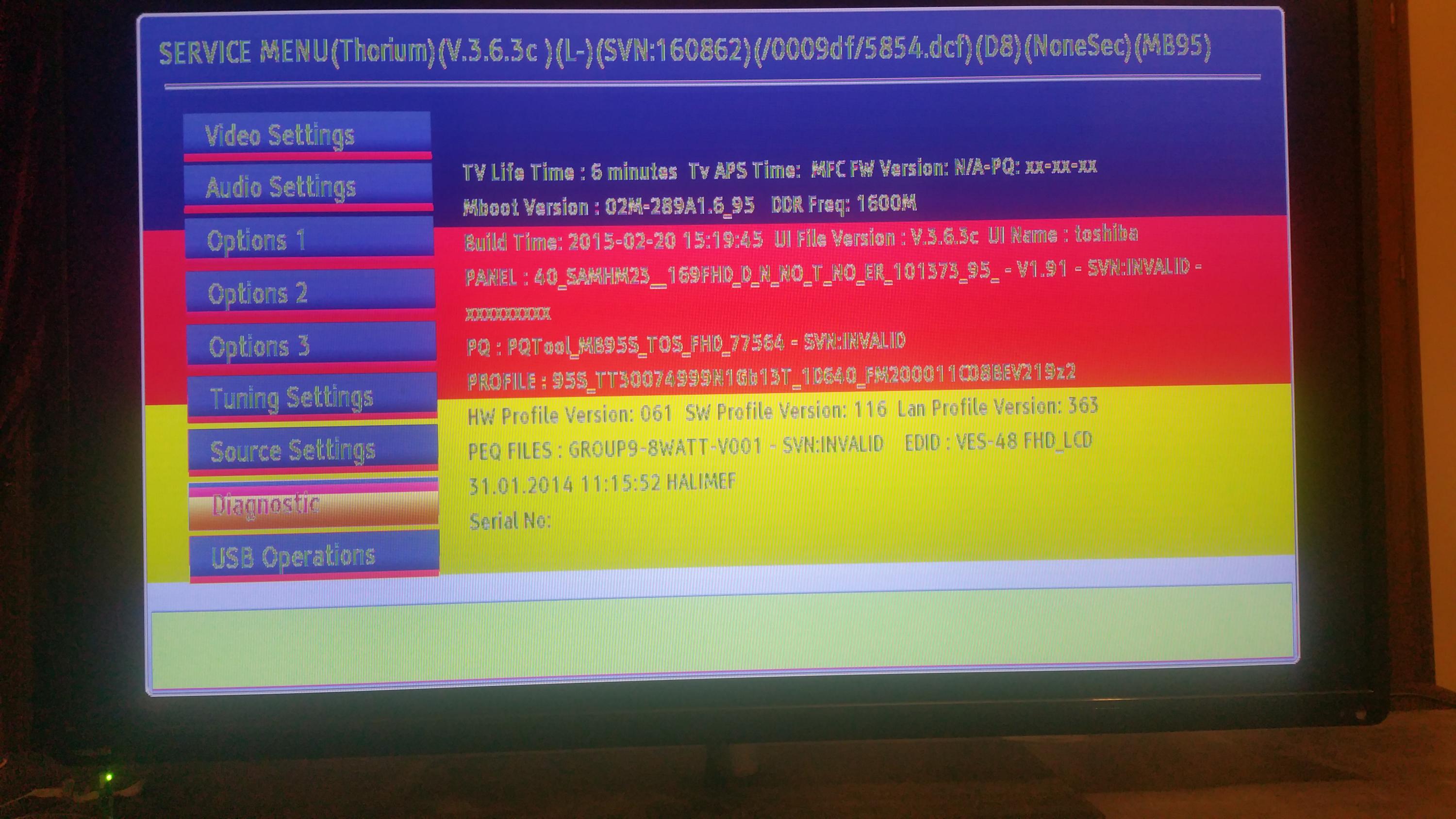

                                        I received my mainboard Vestel 17MB95S-1, second and.
                                        I copy and saved the bin file of MX25L1606E whis CH341A tool.
                                        Unfortunately, the used board is KO, no start TV.
                                        I recopy the MX25L1606E bin file into old mainboard and tested.
                                        The TV start correctly and I have sreen now.
                                        But the picture is bad.
                                        I suppose the panel detect is not good. see the picture
                                        What is the factory reset mode ?
